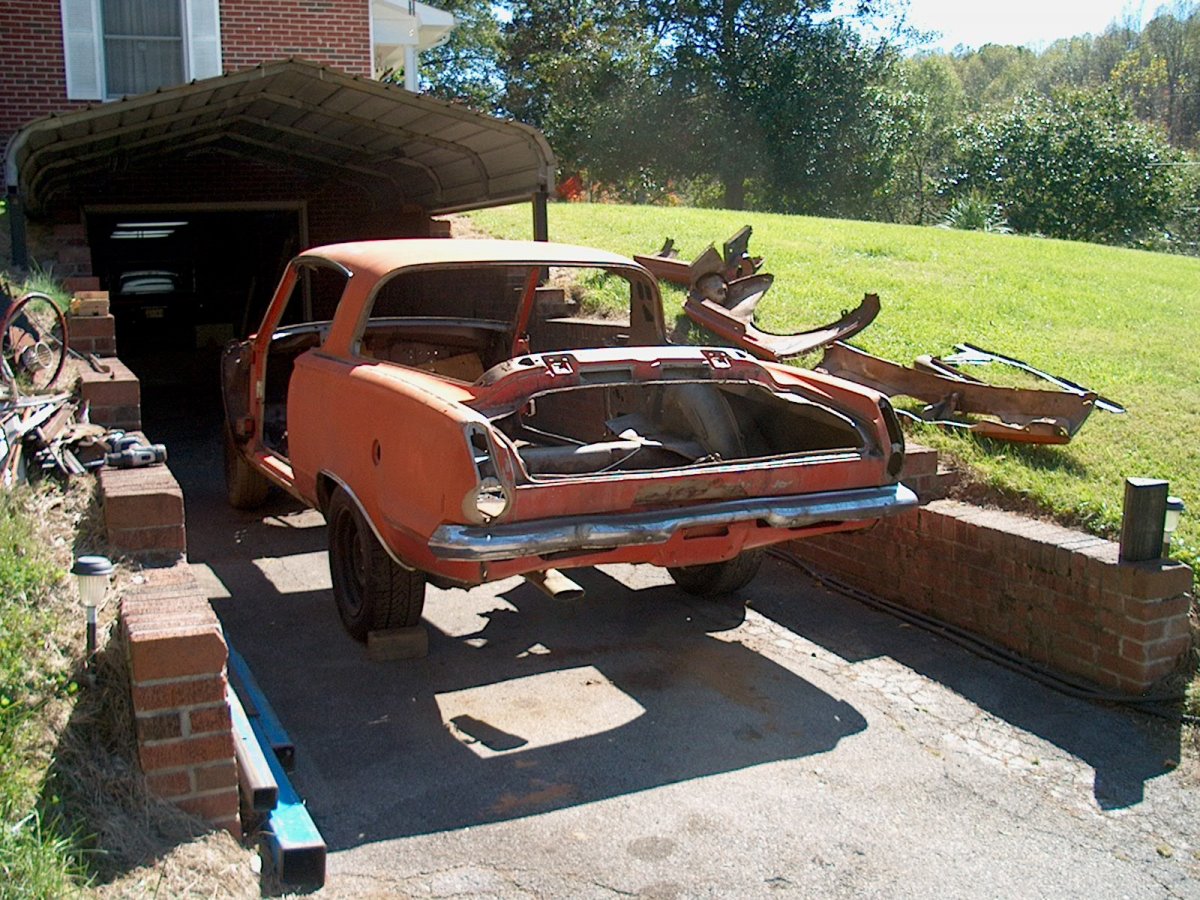

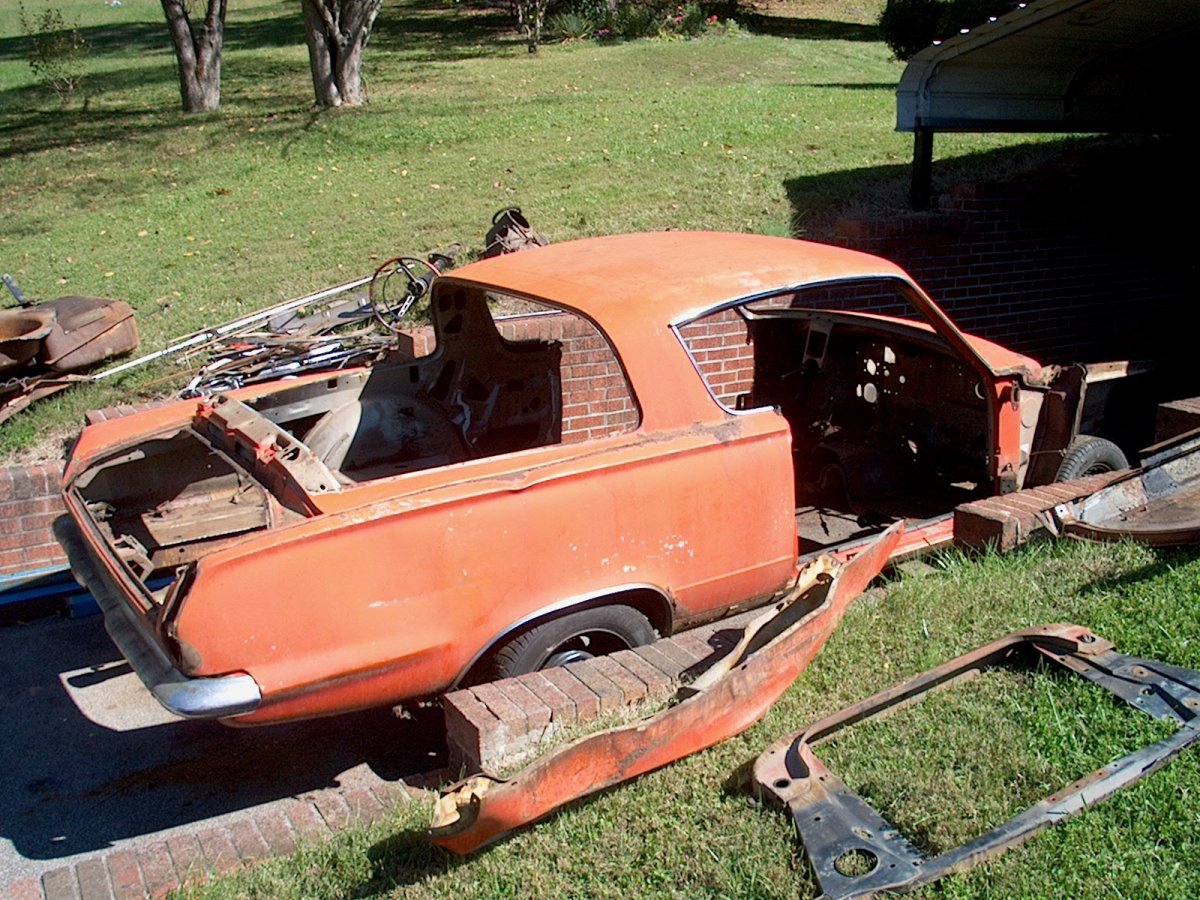

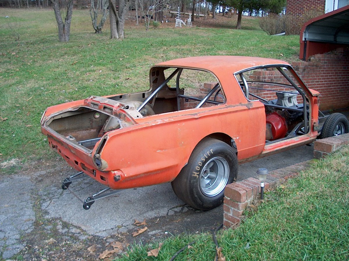

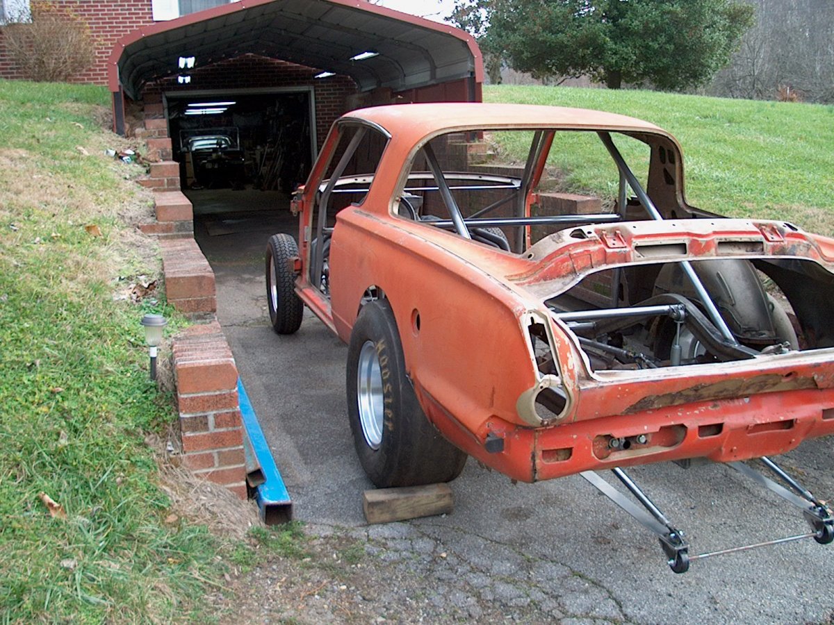

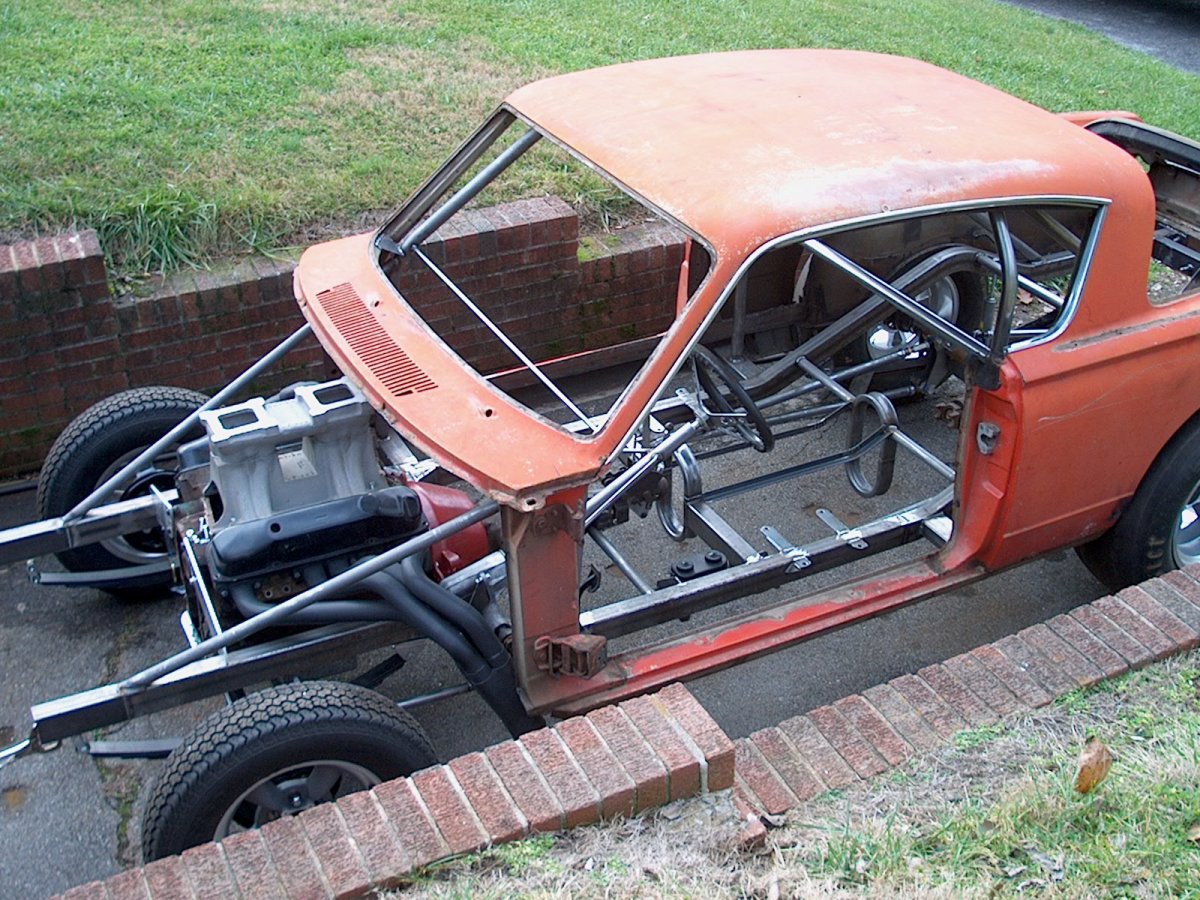

    OK. After 2 months work , this is what we have. BEFORE1.JPG BEFORE2.JPG AFTER3.JPG AFTER6.JPG AFTER9.JPG
  12. Quain Stott
    Joined: Nov 21, 2006
    Posts: 2,068
    Quain Stott
    I'm so impressed, everything is like it should be even the wheelie bars.

    What material did you use for bottom flat plate on the wheelie bars?
  18. HEMIBERT
    Joined: Jun 30, 2013
    Posts: 416
    HEMIBERT
    I used 2" x 3/16" 6061 T6 aluminum
