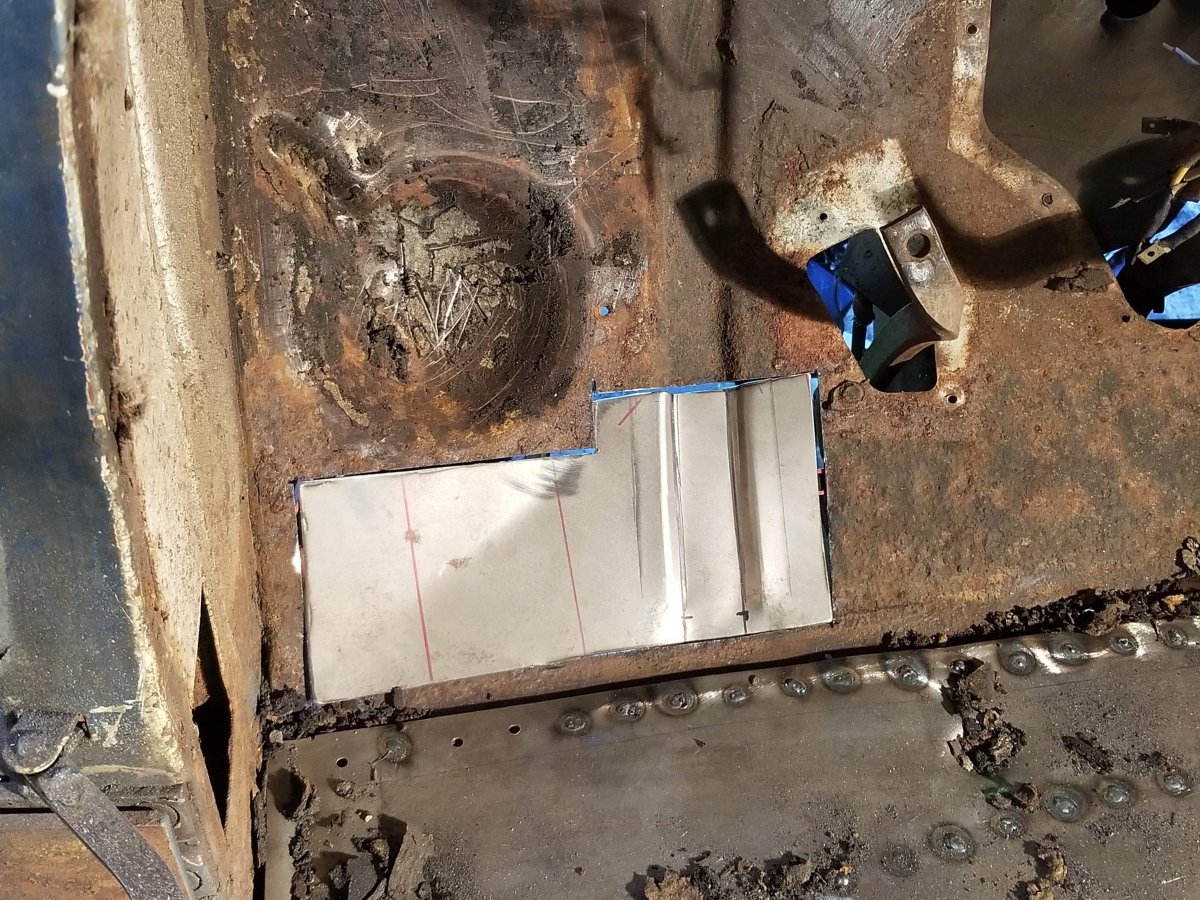

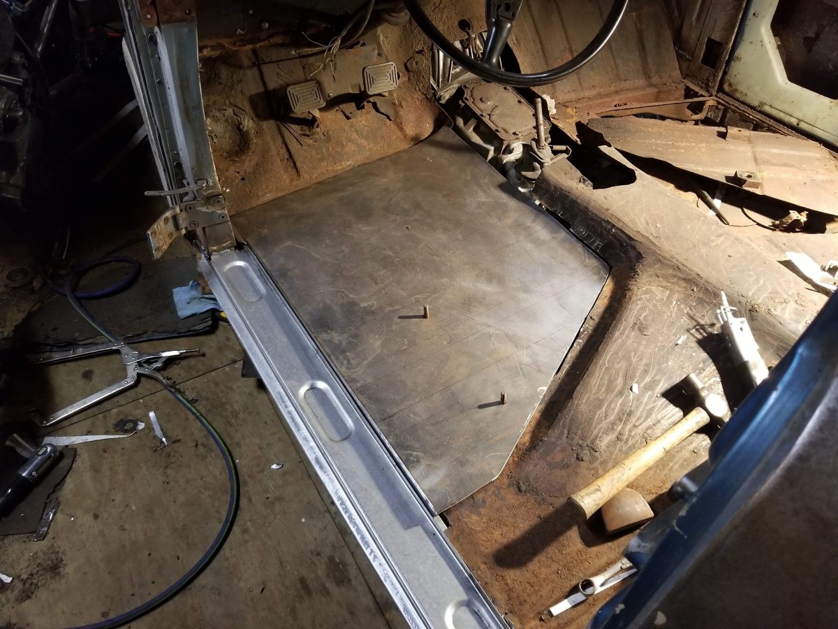

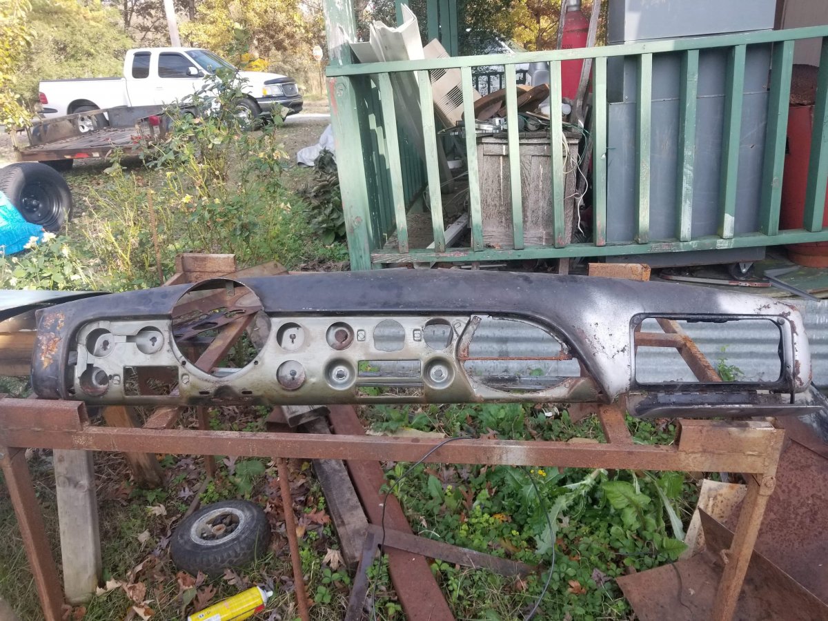

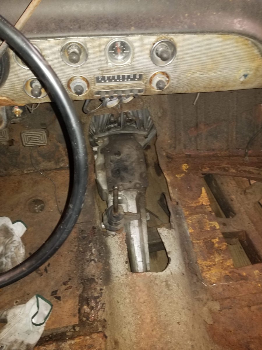

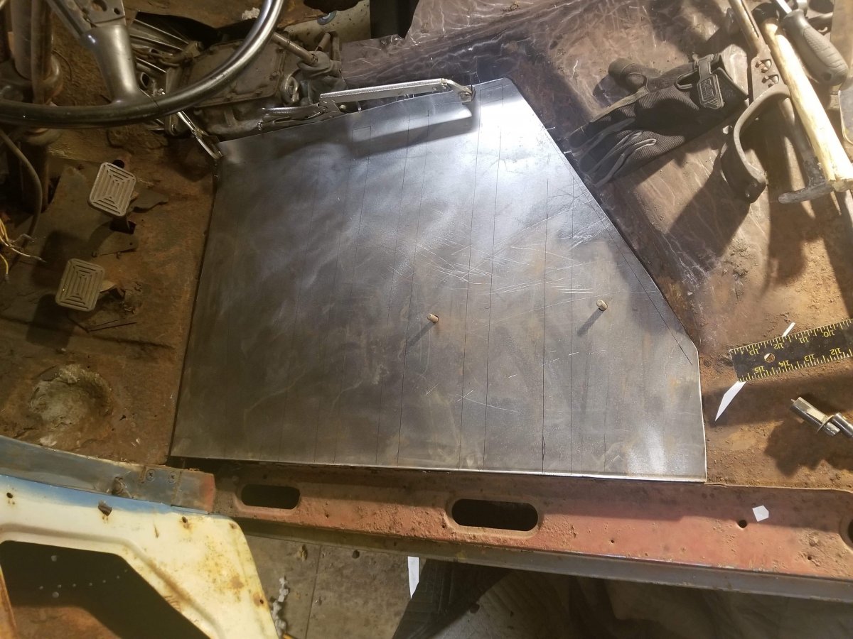

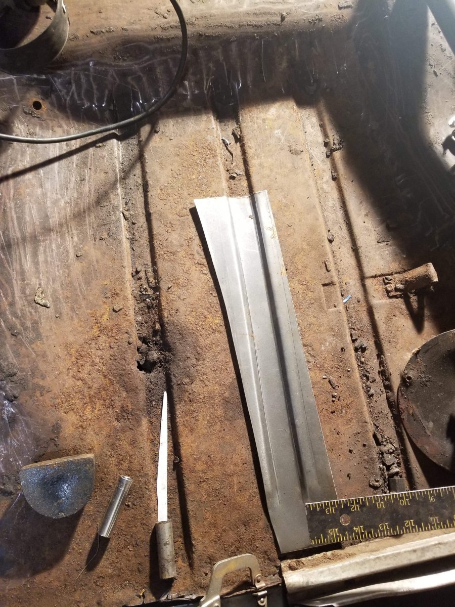

    I’ve not got a lot done in the past couple of weeks. I did manage to get the dash removed and stripped. The dash, inner fenders and a few other parts are off getting sandblasted.
    I also got most of the old sound deading material scraped off the floor.
    I started working on the drivers floor pan. I got the edge bent and the location of the beads laid out. I still have some trimming and fitting to do.
    I’m hoping my custom set of bead dies are ready to pick up in the next day or so....so I get get the floor pans finished up.
    86BAB10B-DFCD-4849-AC03-CB036BE1778E.jpeg 0B1534A6-91D3-4F50-8B0A-827CD0ED5A0A.jpeg
    I will need to patch the back of the rocker panel some before I install the floor

    Nice start! Just a little advice: cut a slightly oversized piece of sheetmetal and do all of the beadroller work first. The sheetmetal shrinks a bit after you have rolled it with the beadroller. Its hard to say that is there enought extras on those pieces you have already cut, but you can see it when you have rolled them. Keep it up!

    Wait..I've seen these cool looking beadroller dies somewhere before:D
    The material choice is excellent, i think those will last longer than the original set i did ages ago. Have you rolled any panels yet with them?

    I've not rolled any panels yet. Hopefully I will get the chance this weekend. I hope my panels turn out at least half as good as yours did.

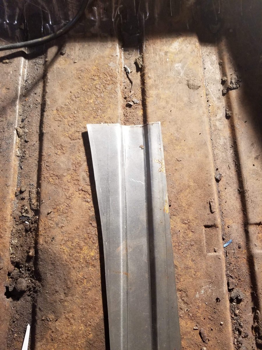

    This came to my mind. When rolling panels, the metal shrinks and the panel will get a slight curve. If you have an access for planishing hammer or english wheel, i recommend to do some pre-stretching before the beadrolling. This helped me a bit, so there wasnt so much "banana" shape on the floor pans.
    This video will show you what i ment:
    It sure is a pain in the ass to make big size panels without the pre-stretching them.

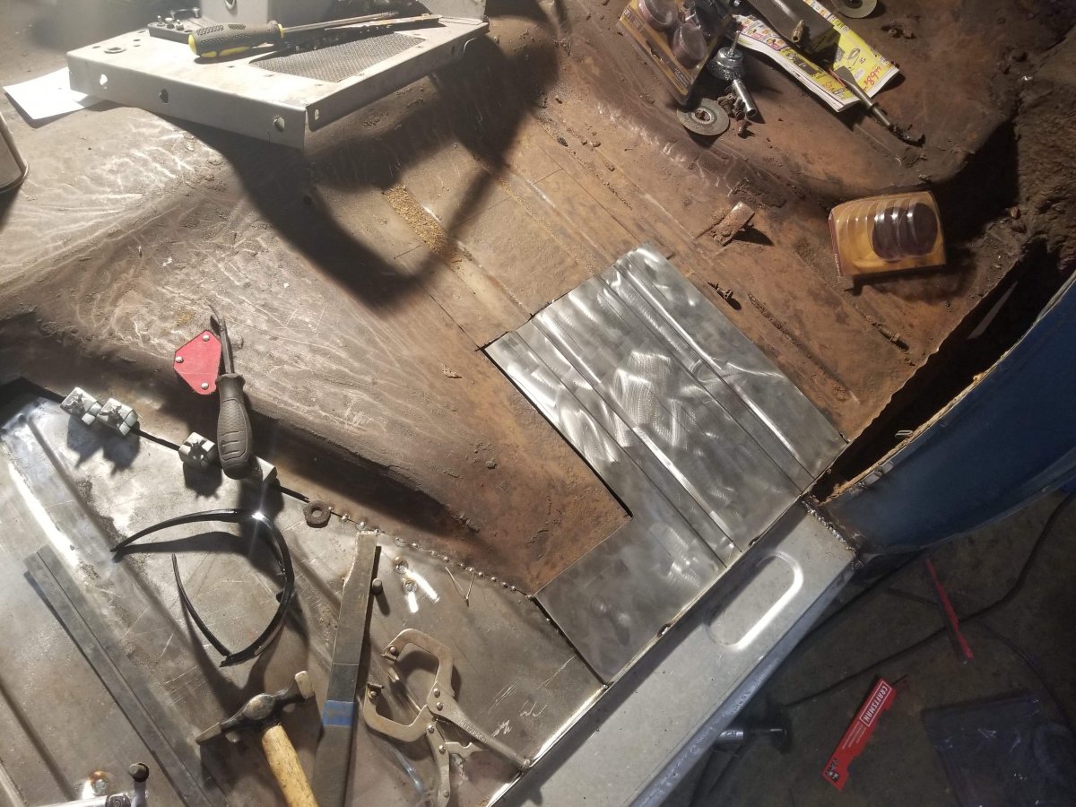

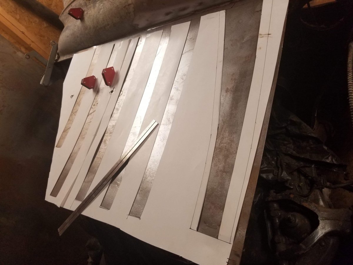

    0A084D28-0C08-4C12-B2CC-8392CEB48644.jpeg E0514088-C474-484A-B7A0-64F6FF3230BB.jpeg Here is my 1st test run with the new dies. Not bad for my 1st time. I need to build a stand for the bead roller before I can make my floor pans.

    Thank you for the advice. I plan on picking up a plannishing hammer in the very near future

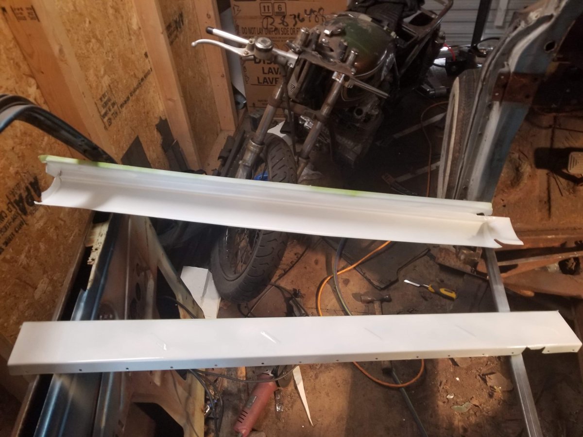

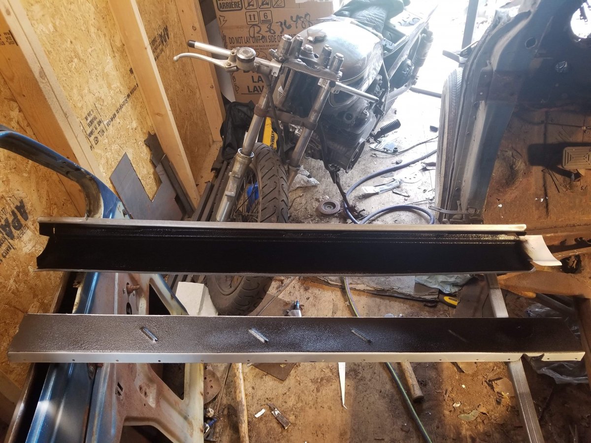

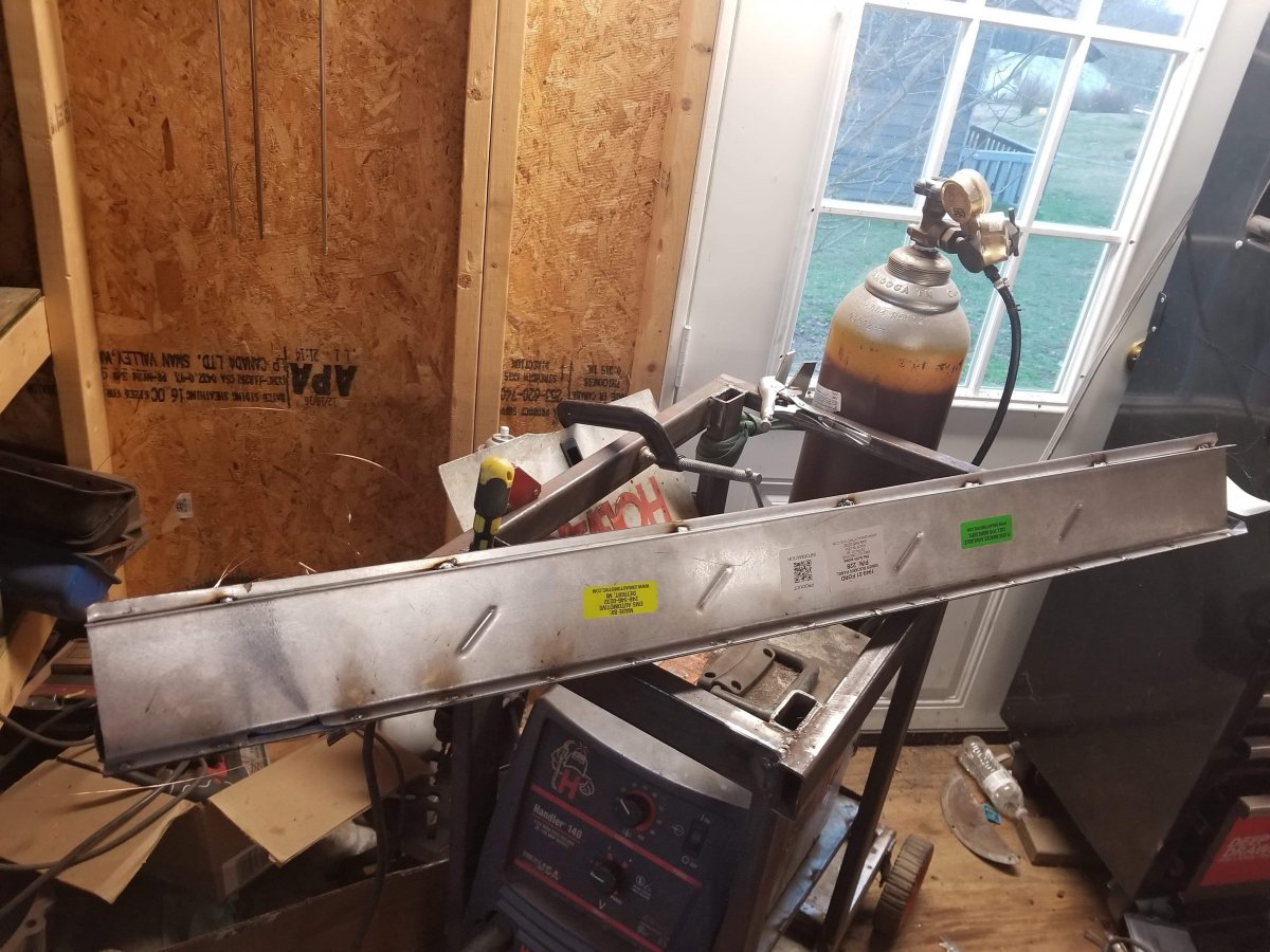

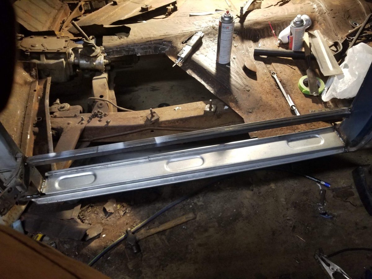

    After a few crazy months I was finally able to get some work done on the 51.
    I spent a few hours test mocking up the inner and outer rocker panel. Once I was happy with the fit I primed and undercoated the inside of rocker panels. Then I welded them together. I still need to go back and finish weld the rockers in place. I set in my floor pan just to get a look and I’m very happy with the fit.
    288F9601-39B2-4590-A539-02F25E8C9DC3.jpeg 8EF6A429-1FF9-4ECE-8D55-D8CB240FD7E5.jpeg 4F1AC1E0-243B-42C2-8B58-CAF39F669116.jpeg 7A8F8E79-C396-4C96-A462-6DD413F81D37.jpeg
    I am finishing up a stand for my plannishing hammer. Once it is complete I will get started running the beads in the floor pans.

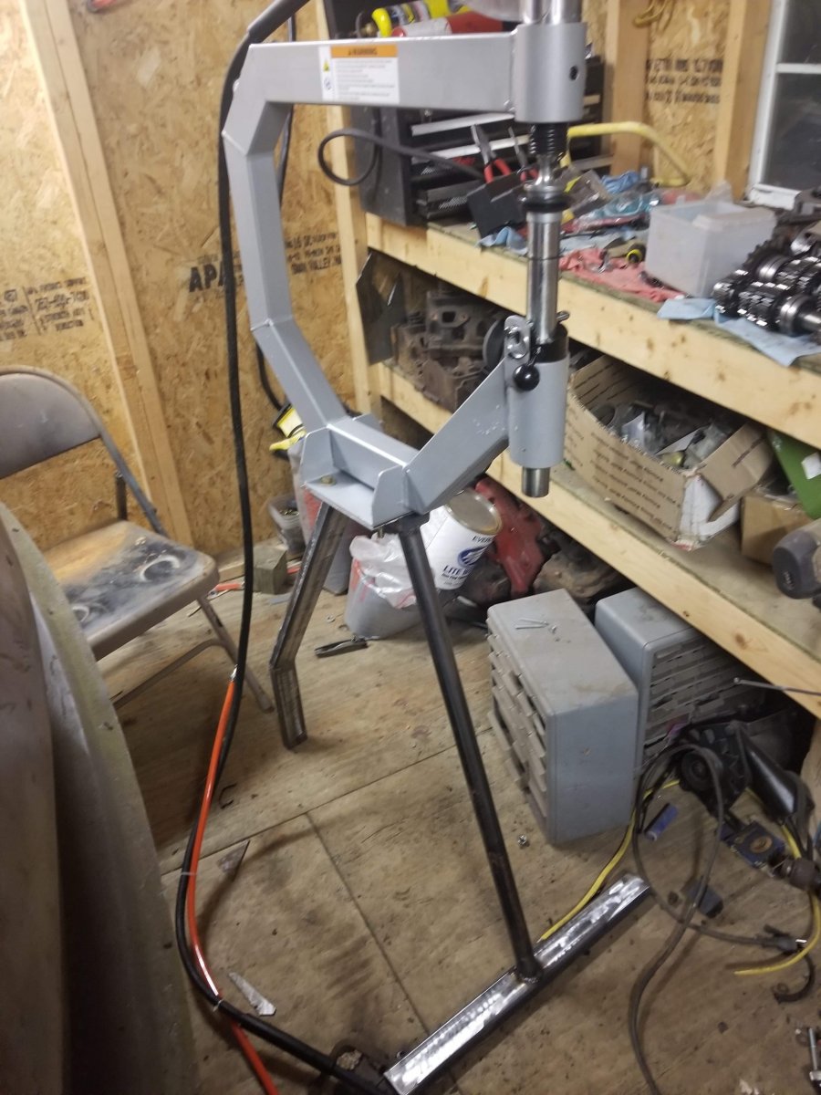

    Finished up my plannishing hammer stand this evening. I’m happy with the way it turned out. Weather permitting I’m picking up an English wheel tomorrow or Sunday

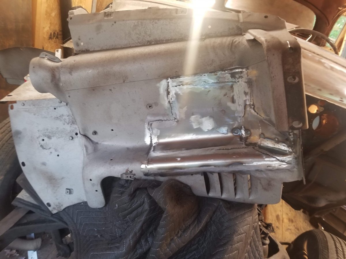

    Not much to report. I’m currently in the process of building a new house....and a bigger shop (if the budget permits) and that is taking up most of my spare time right now.

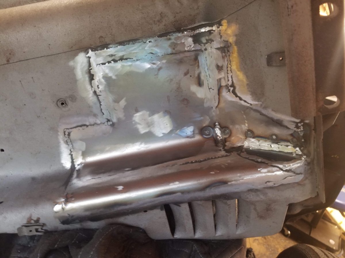

    I did manage to start repairs on the drivers inner fender. So far I’m happy with the way it is turning out. But I’m debating about building a custom set of inner fenders....mainly for a smooth cleaner look.
    F96D1F46-1602-4538-B1FA-B532A3AA93BE.jpeg A1CA20C3-6EAE-4258-A542-C8A48230F5AC.jpeg

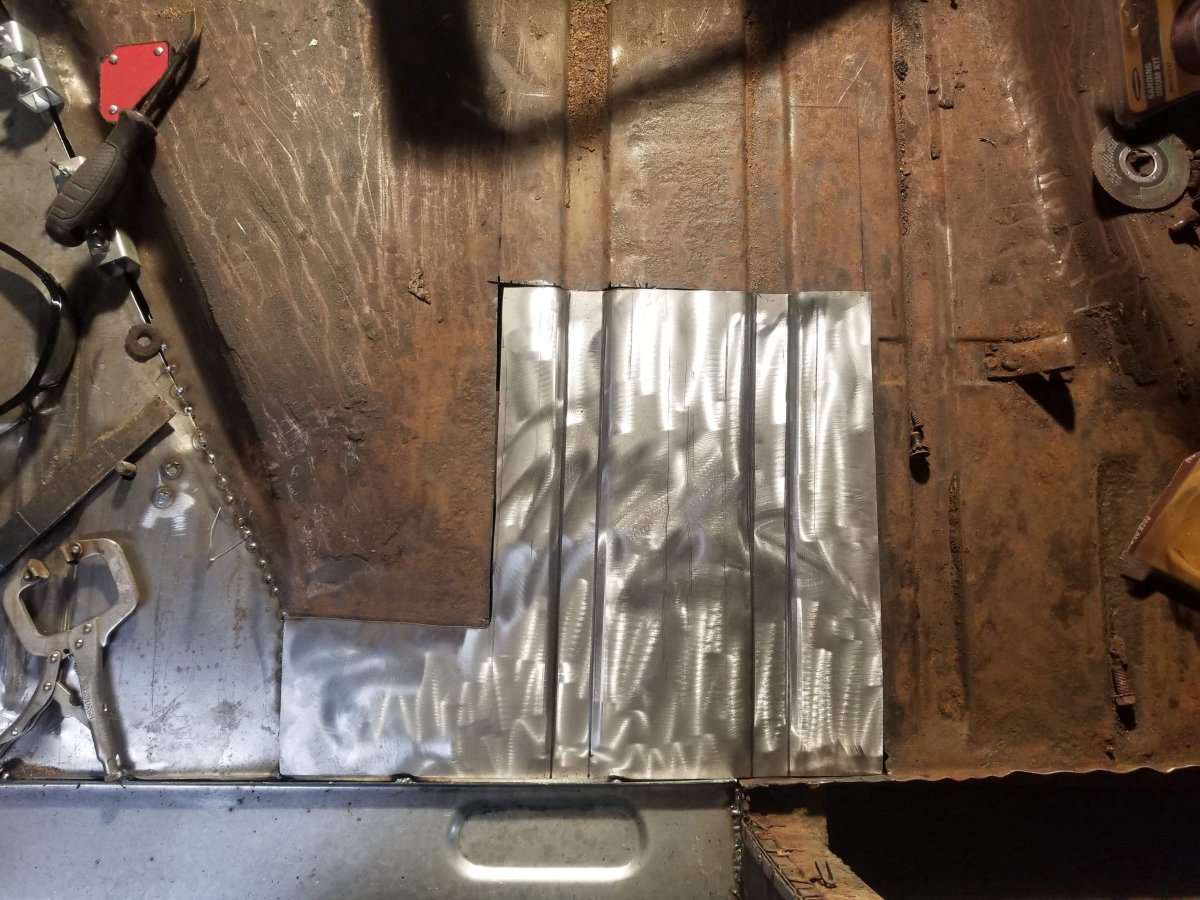

    I have made a little progress on the floors. I made a patch for the rear floor. I still need to clean up the body brace under it before I can weld it in.
    BDDD313E-F1F7-4888-9759-D762A0F93135.jpeg E639C306-C317-463F-86DA-4BD842A52EB8.jpeg

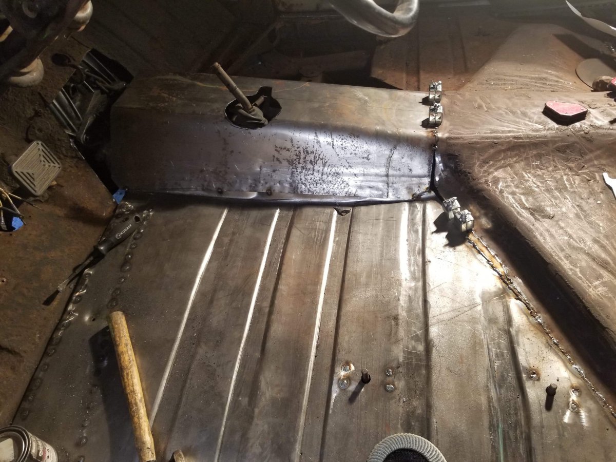

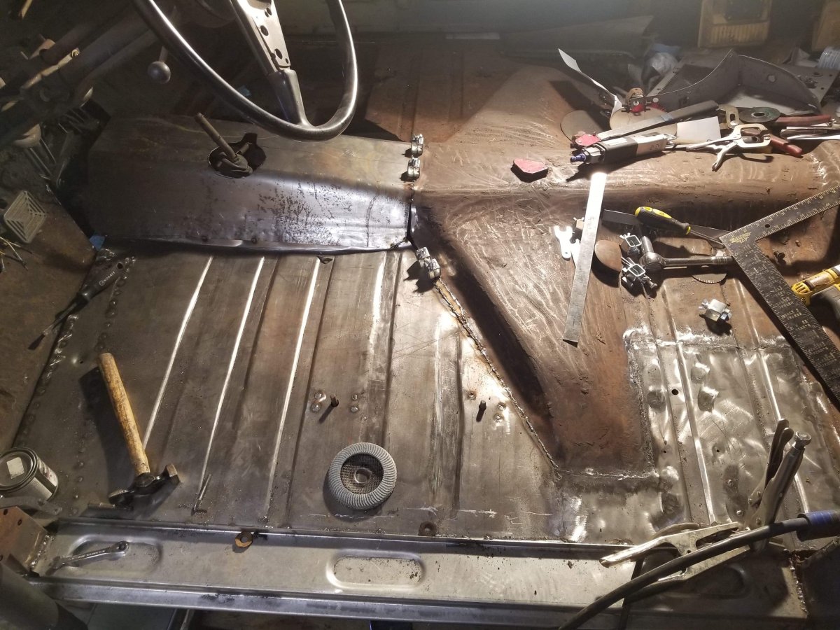

    Most of the drivers floor has been welded up. Fabricated a trans cover. I still need to make the bellhousing cover for the trans.
    I will finish weld the trans tunnel after I make the passenger side floor pan

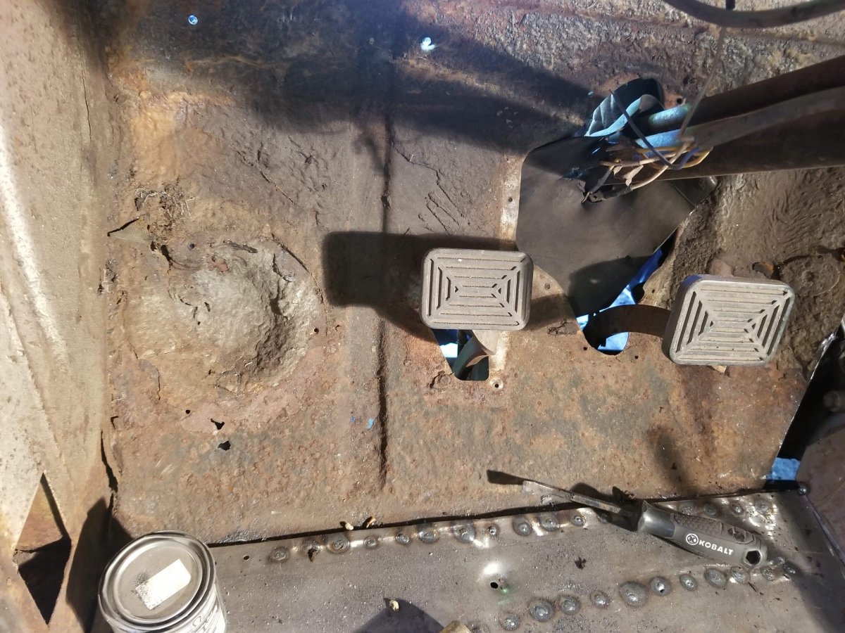

    I also started patching the drivers toe board.
    A6C806F4-984C-4CC5-94C8-D9A172B3C60E.jpeg 1240C998-F3BD-418F-A277-9AF4686B043A.jpeg
    Once I finish the toe board I will start repairing the trunk floor and welding up the body seam on the rear quarter. I will probably take this opportunity to go ahead and French the rear tail lights.....I just need to decide on the method I want to use to French them.....Any suggestions/recommendations?

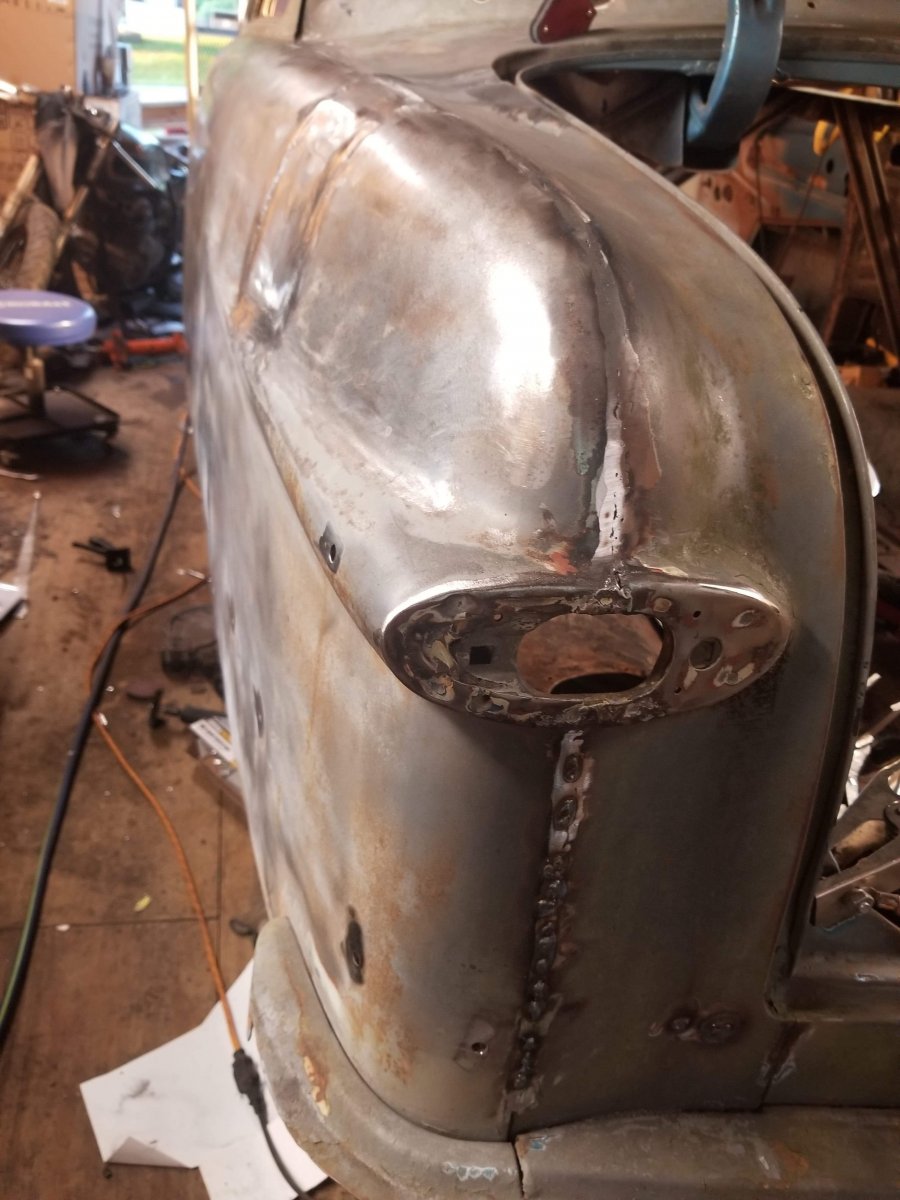

    I like how the tail lights are frenched in my car. It was done before i bought it, so i have nothing to do with them. They are '50 lights, but i guess its possible to do with the '51 lights too if you are going to keep them. Personally i like the '49-'50 tail lights better than the '51's. Here's a link how it was done:
    https://www.jalopyjournal.com/forum/threads/another-shoebox-goes-under-the-knife.379161/page-4
    I think there's pics missing of that thread. There is a tail light shaped rings at the trunkside of car. That ring is formed from roundbar and its welded there. That ring supports quarterpanel, when tail lights are bolted against them.
    The frenched panel edges are formed against that ring. I hope that helps.

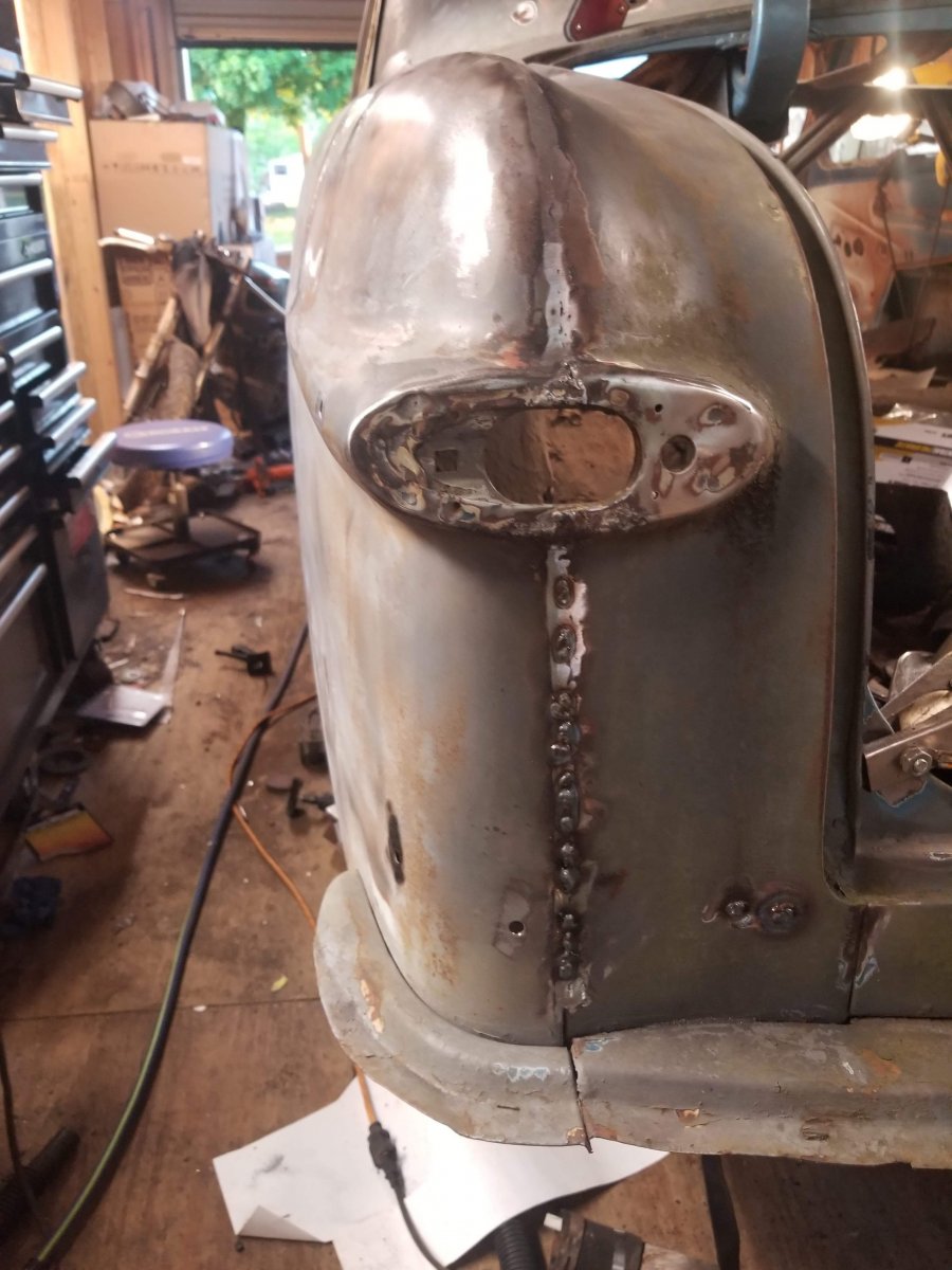

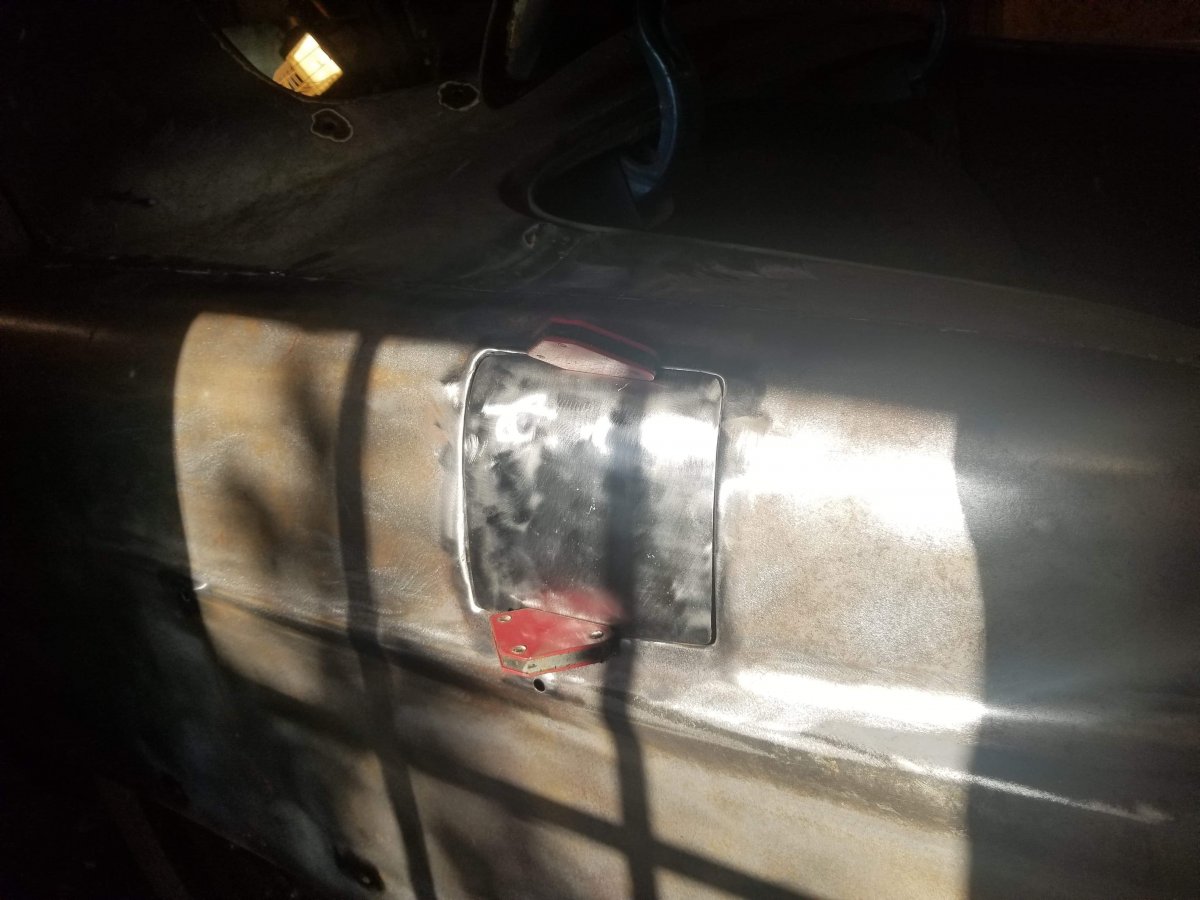

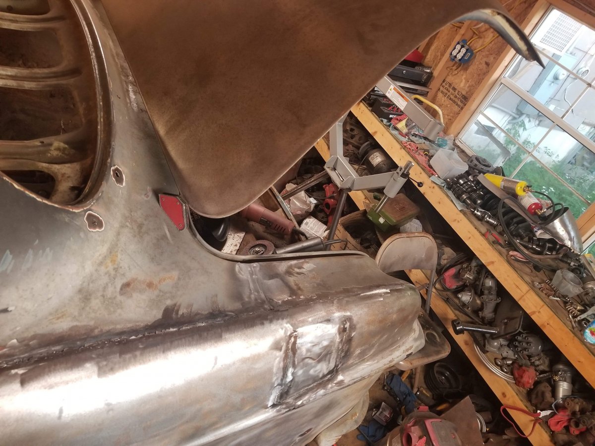

    Took a break from the floor and filled in the old gas door and started welding up the body seam.
    BBB733A1-8C7B-4F8F-871A-AC9F638B49DE.jpeg DB62D6AB-2C95-4705-BAA1-6B3D83831378.jpeg CD0618BE-1413-44C2-965F-D695225E39AD.jpeg A94314D1-ADDC-4A1B-8E30-B63A298D17E3.jpeg
