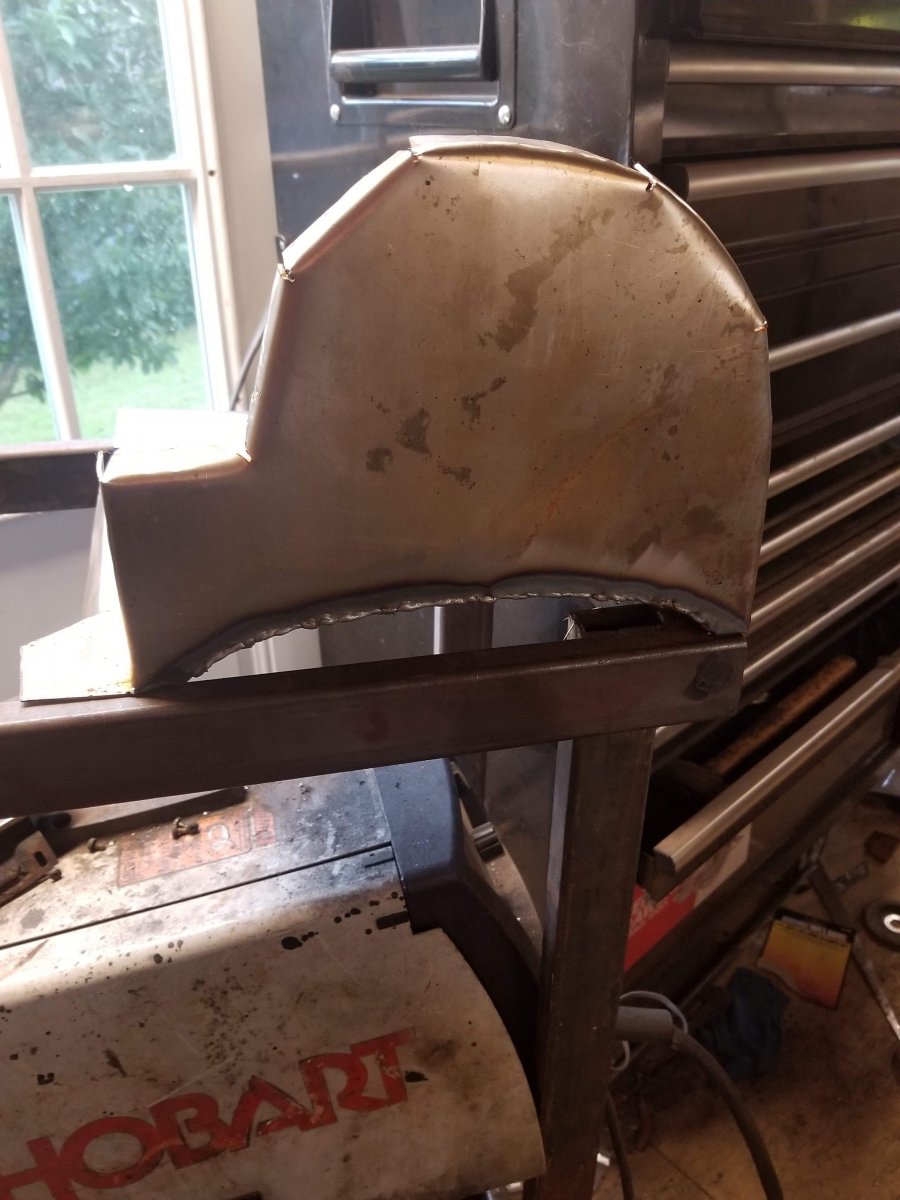

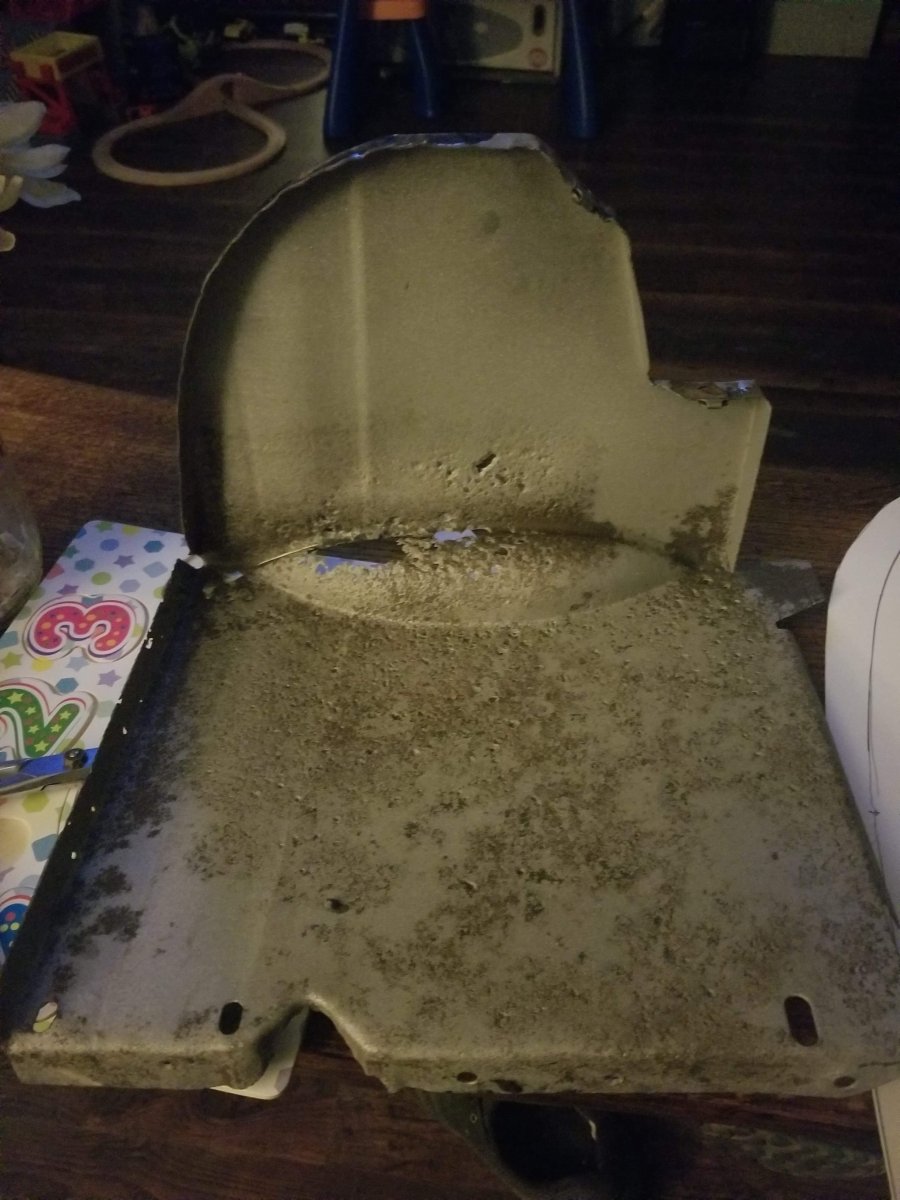

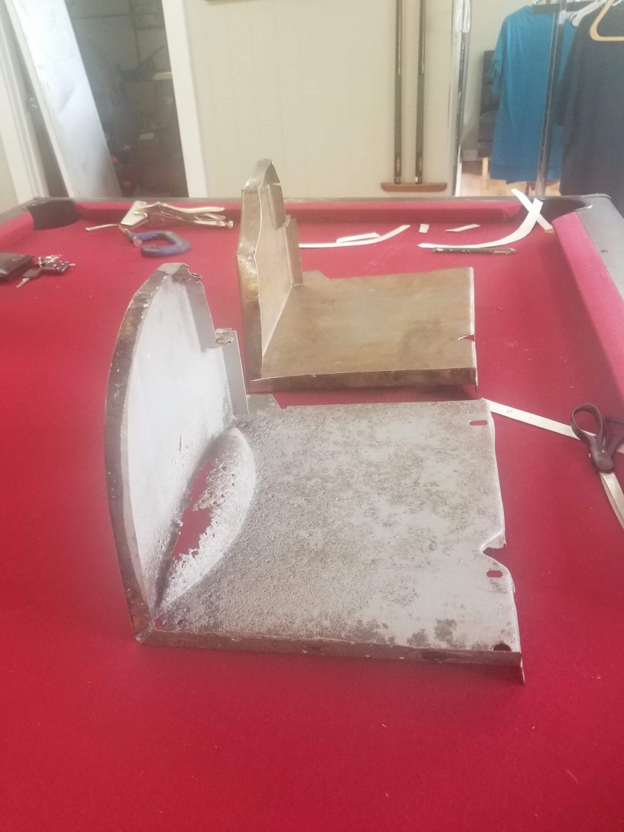

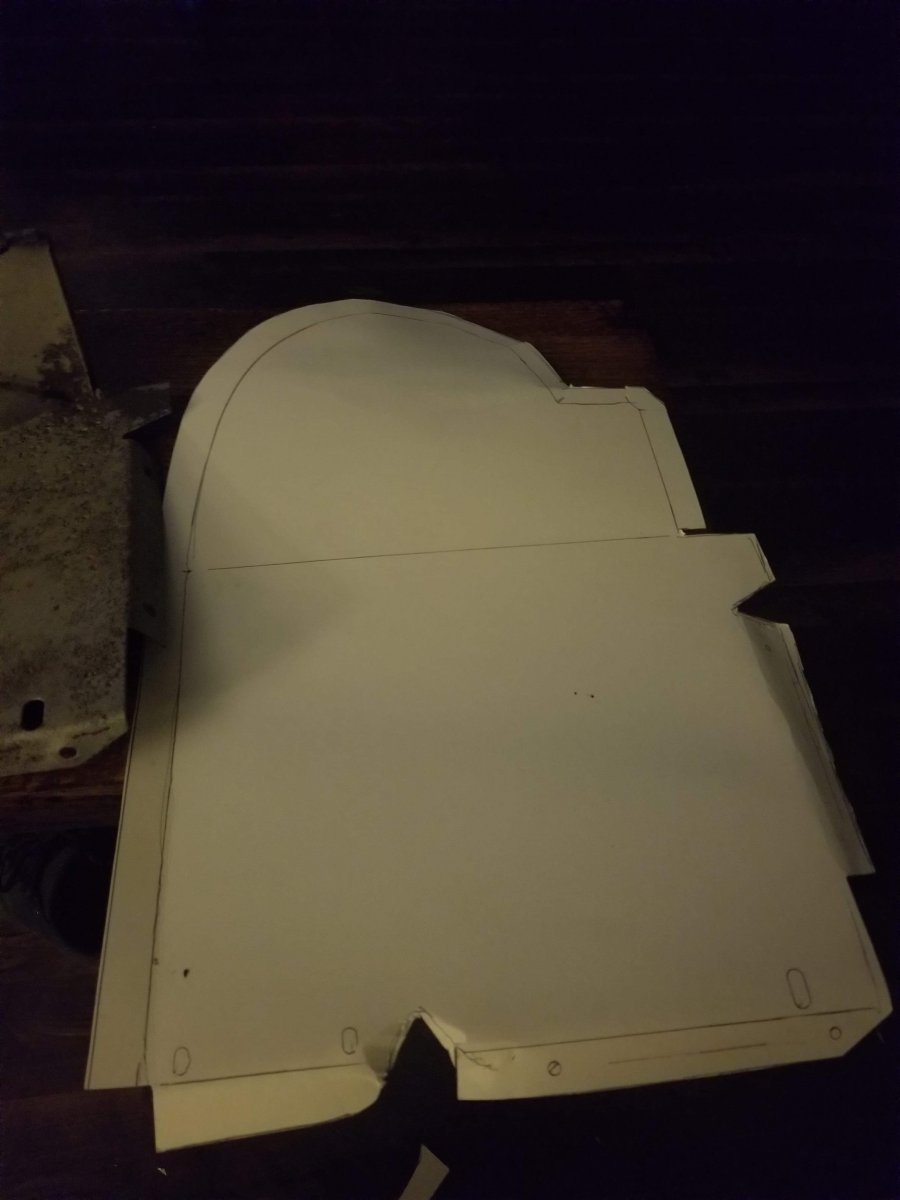

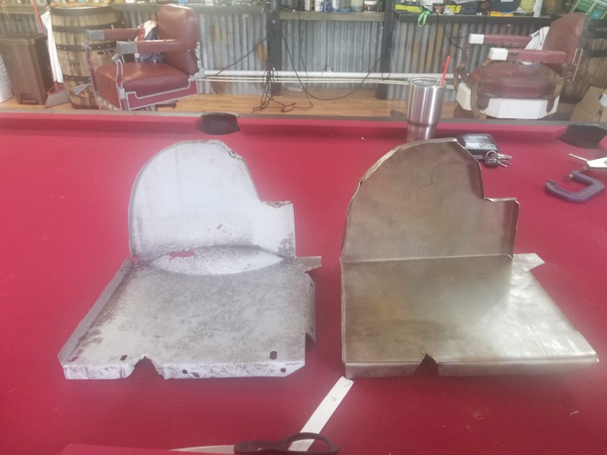

    The back part if both of my inner fenders are pretty rotten. I’m going to attempt to make a new set....working on my pattern right now. I’ll make a wooden buck to help form the lip.
    I will also make the bump separate and add it after I get a good fit for the rest of the panel.

    Made a little progress on the rear inner fender panel...it’s coming along nicely. I still have some t******* and some hammer and dolly work, plus drilling holes. What do you guys think?

    Cool, dont forget to make those oval holes for hood springs, like someone did..

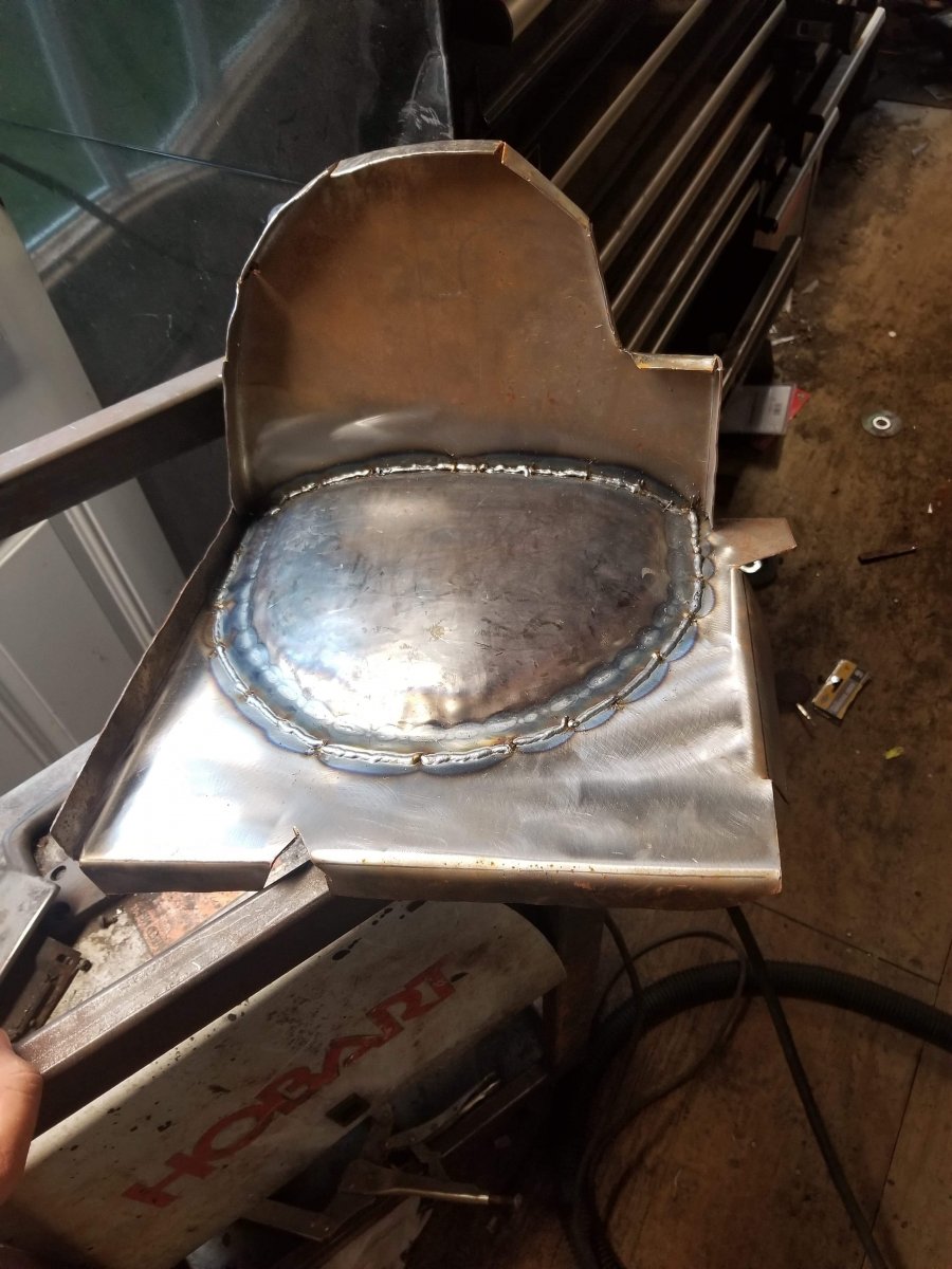

    Slow progress....seems like I can only get an hour or two in the shop at a time. But progress is progress

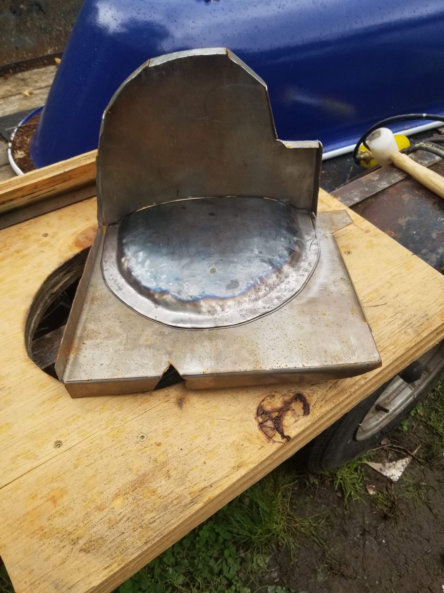

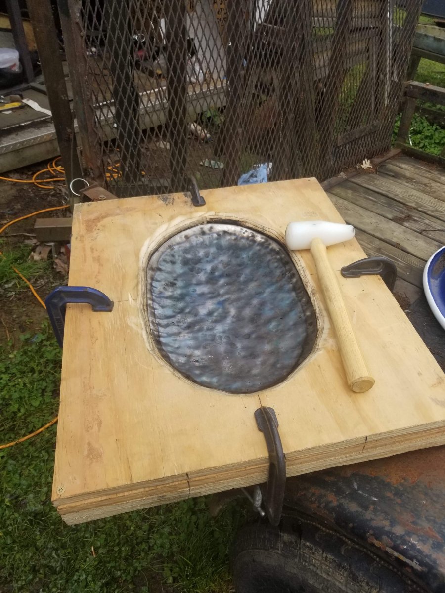

    Made a wooden buck and hammer formed the blister
    E475EA83-2345-4371-937C-FE57958D49AD.jpeg 5CE682D3-7EB1-421A-9786-7544BF43D9FF.jpeg
    Used my plannishing hammer and English wheel to smooth it out then I cut it in half.
    Fit was good...welded it up. I’m happy with it so far. I still have to clean up the welds and add the mounting holes.

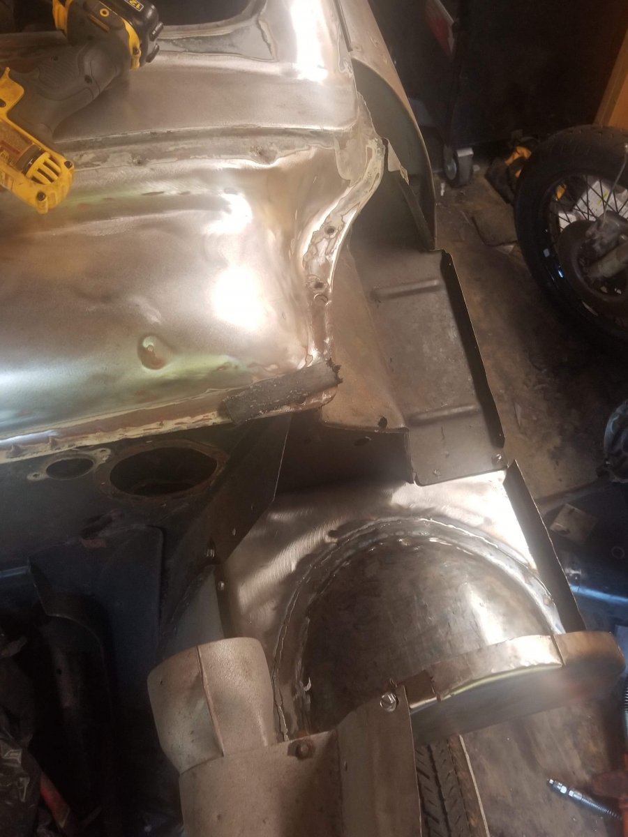

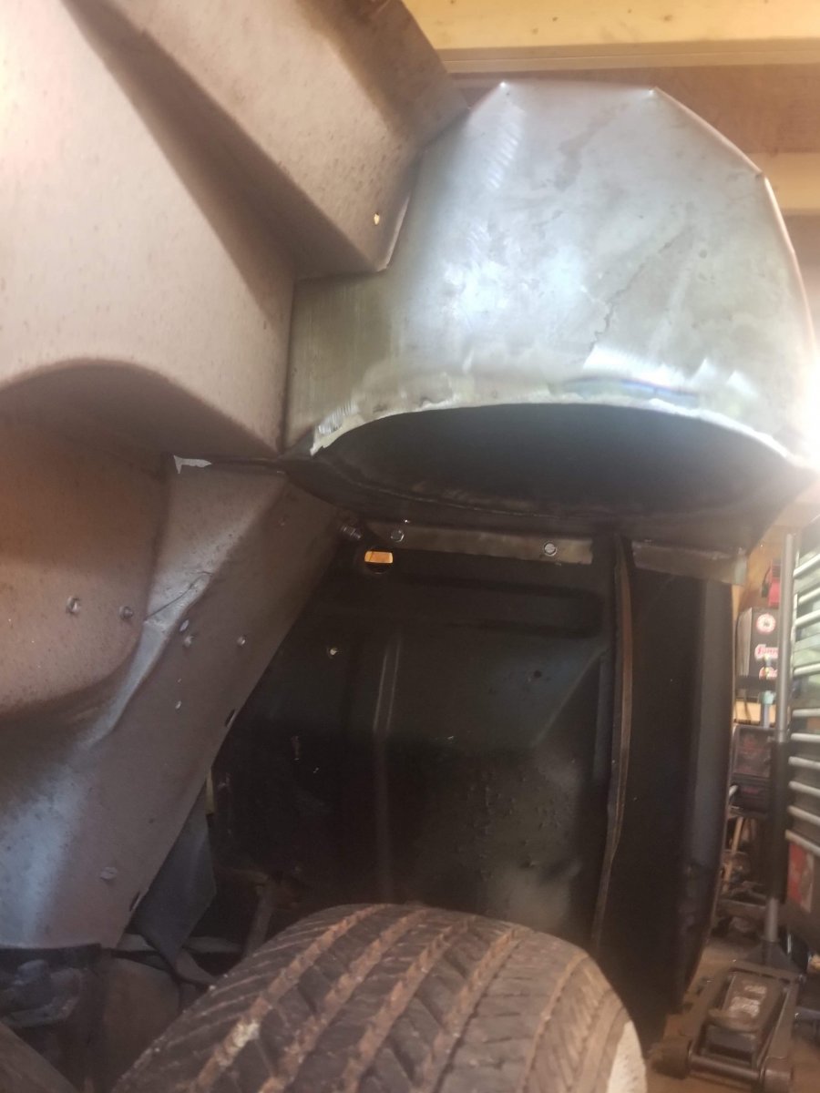

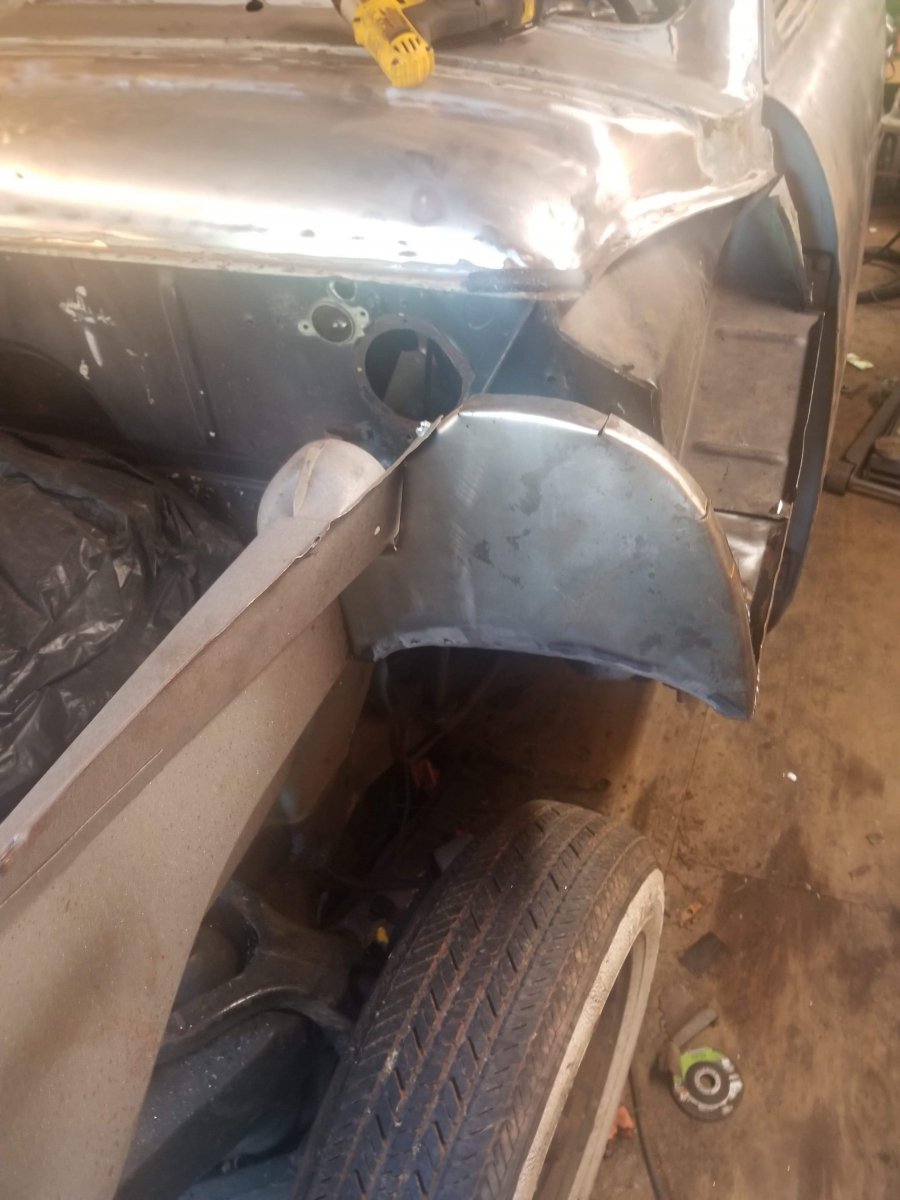

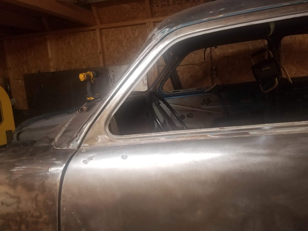

    Initial test fit was ok...had to make some minor adjustments....Then I put the fender on... I’m definitely going to have to modify the top ridge to fit the fender a little better.
    5758F542-D4B9-48B4-B9B9-2A9CE138CE76.jpeg DA1DFFC8-9338-4336-90CE-415FF4C71C6B.jpeg 97A3B501-A956-478F-97B3-4DC1C472ACD3.jpeg 850EC482-3B59-4E6D-A74D-3285B55175F5.jpeg

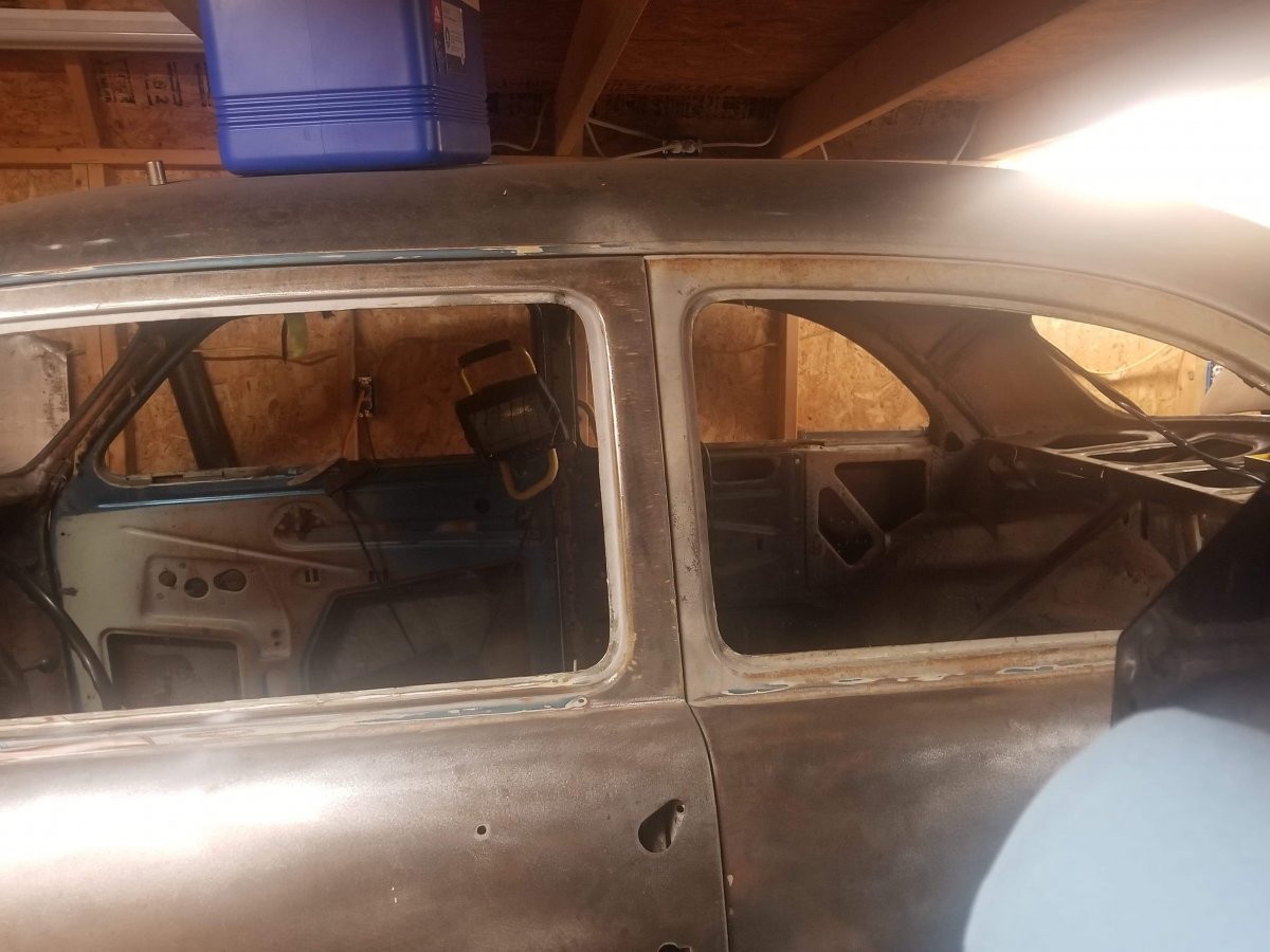

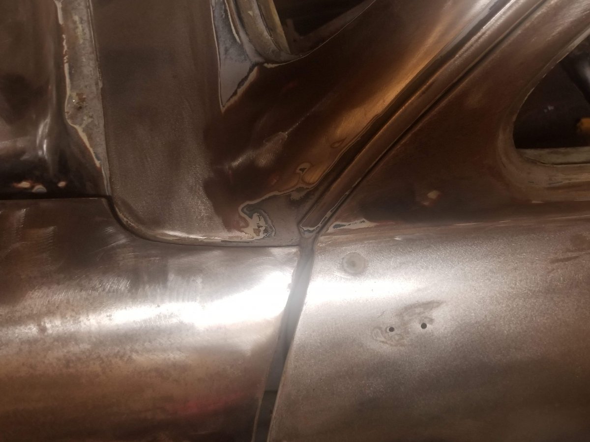

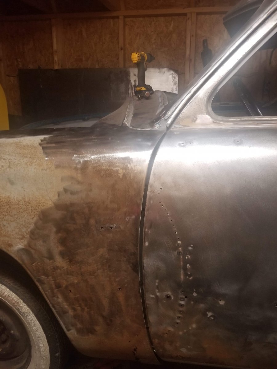

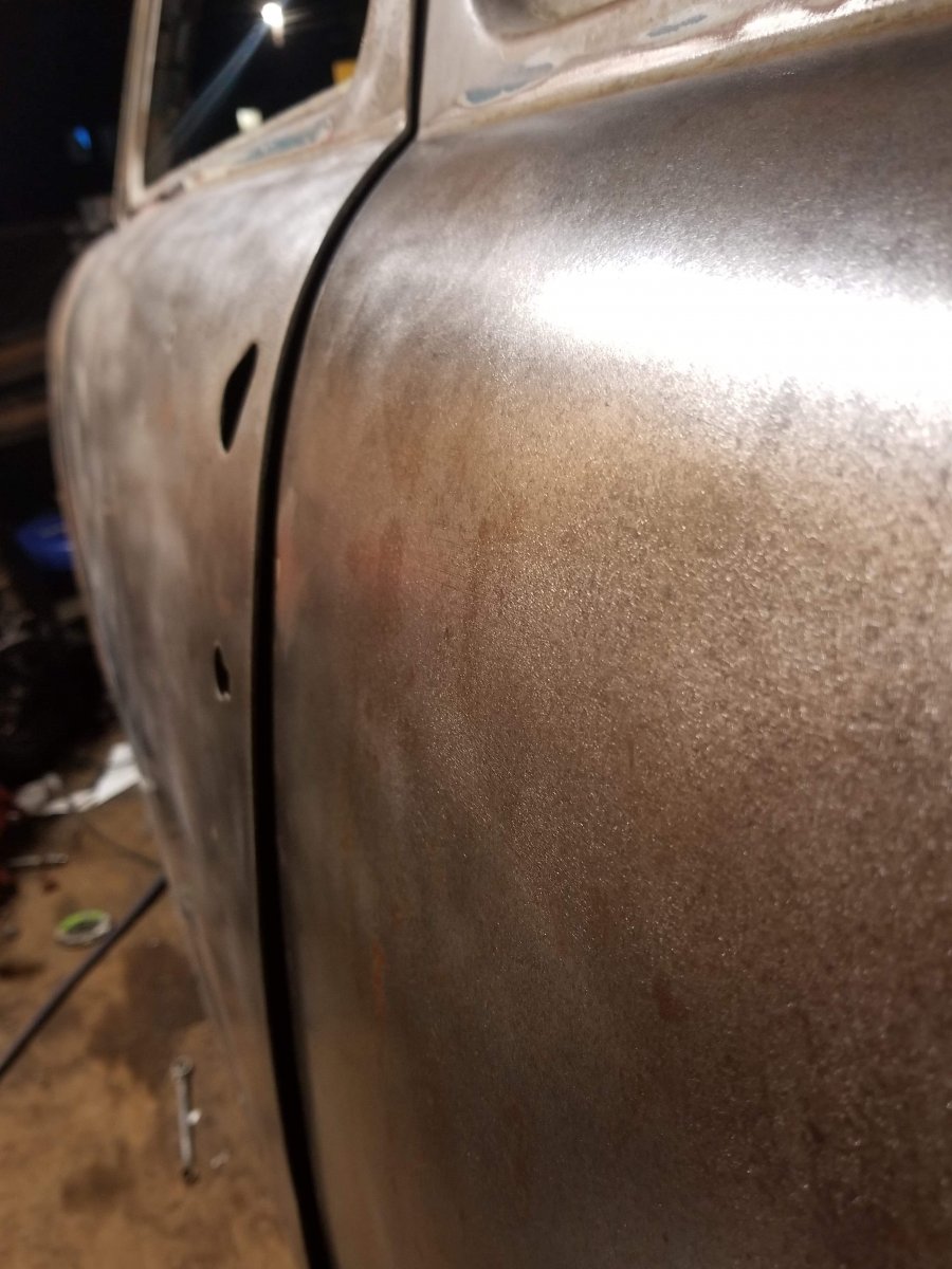

    I’m still having a big issue with my door gaps. The door sits to far to the rear...other than machining my hinges down to make them thinner...I’m open to suggestions.
    956F1EBE-8051-40AC-9E3E-F2C5CE413665.jpeg DDCC1D2F-29F3-4BFA-90CB-07F7CB00333F.jpeg
    Door seam overlaps at the back
  6. Finnrodder
    Joined: Oct 18, 2009
    Posts: 2,971
    Finnrodder
    from Finland
    Looks like you used same method than i did with the inner fender humps. About that curved part of the panel, i think it doesnt have to match 100% perfect with the fender shape. And thats because the anti-squeak welt will forgive some of the gaps between the panel and fender. I think they werent perfect even from the factory, like many other things on these cars..
    That door overlapping looks bit weird. Have you tried to straight the hinges, so the door could move forward?
    I am not sure is machining the hinges good idea, maybe cleaning them a bit and checking that there isnt any **** between the body and hinge. You dont have the factory green bible?
    There was shown few good tricks for the gap problems.

    I’m about to order a copy of the green bible. I’m going to keep working on the rest of the body until it shows up. The door gap has been that way on the driver side since I got the car...as long as I get it aligned before I chop the top.

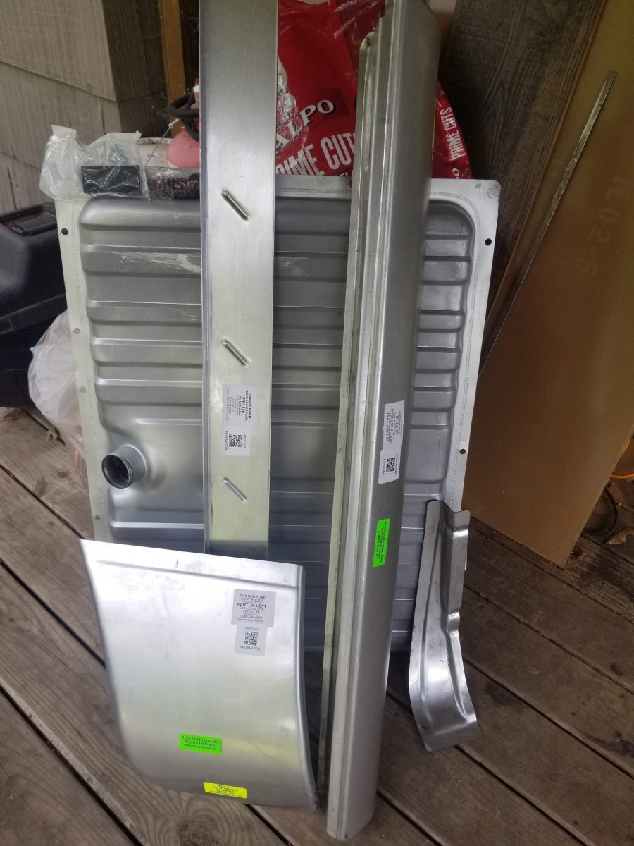

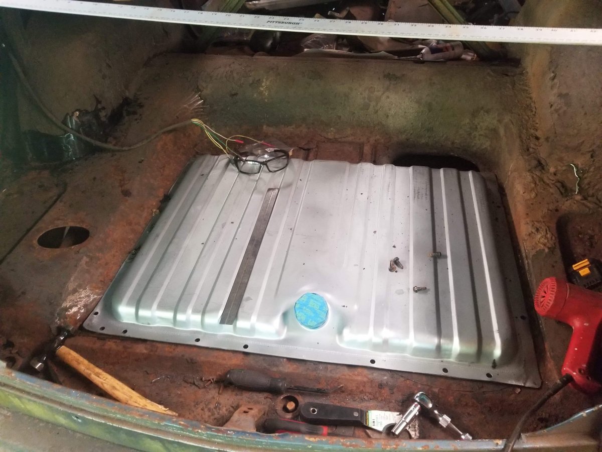

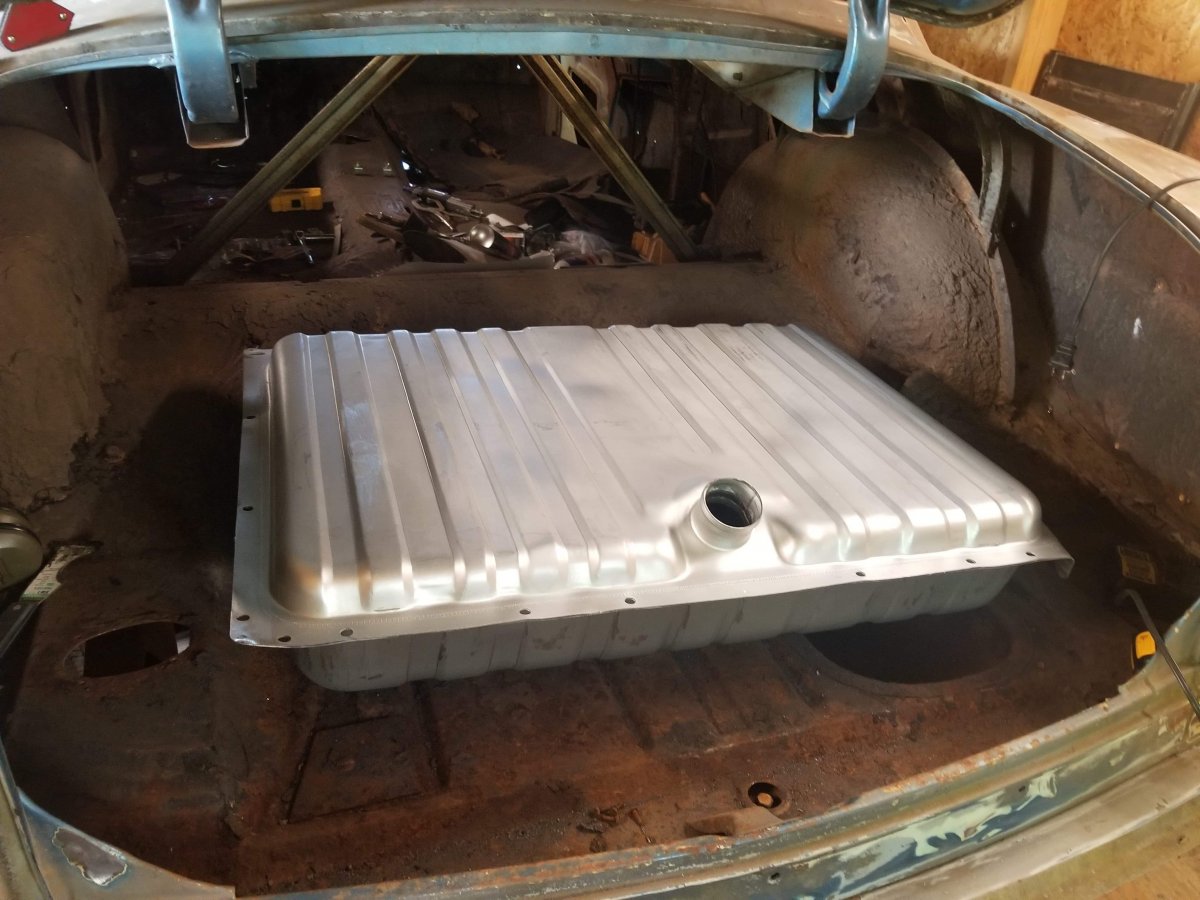

    Christmas in May....got some parts in for the 51 today.
    The edges of the tank got bent during shipping...nothing a little hammer and dolly work can’t take care of

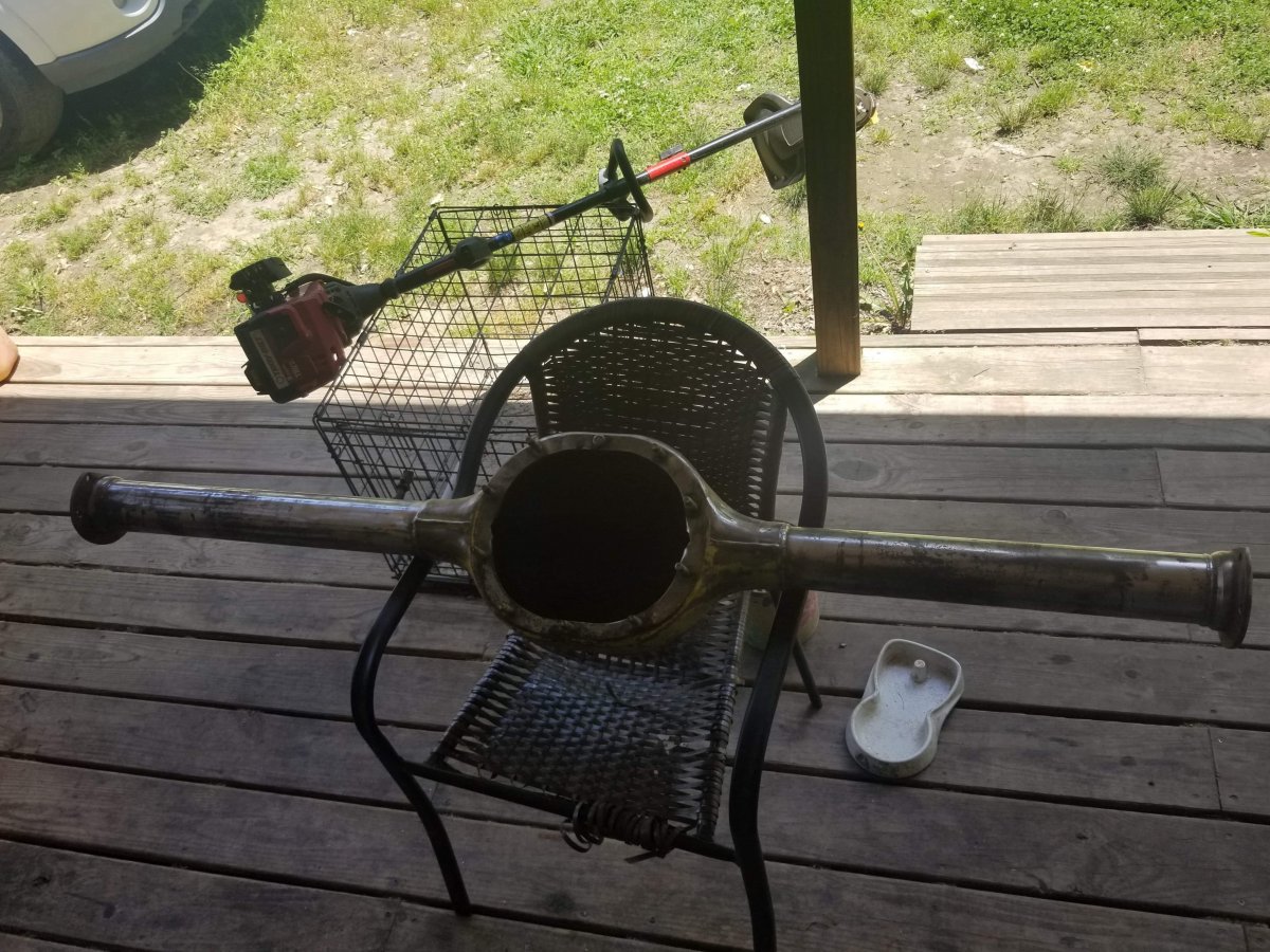

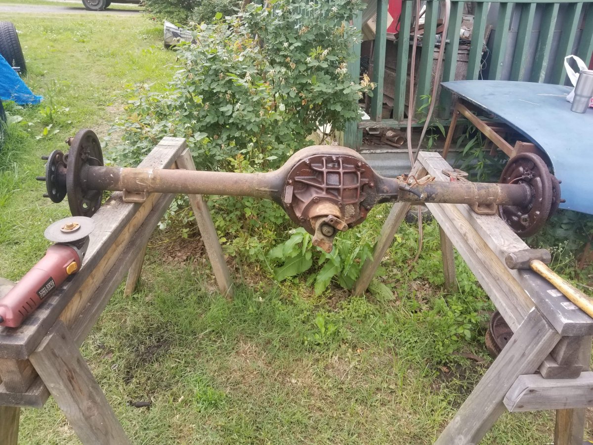

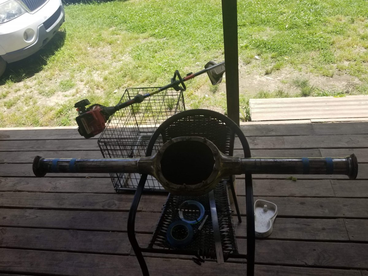

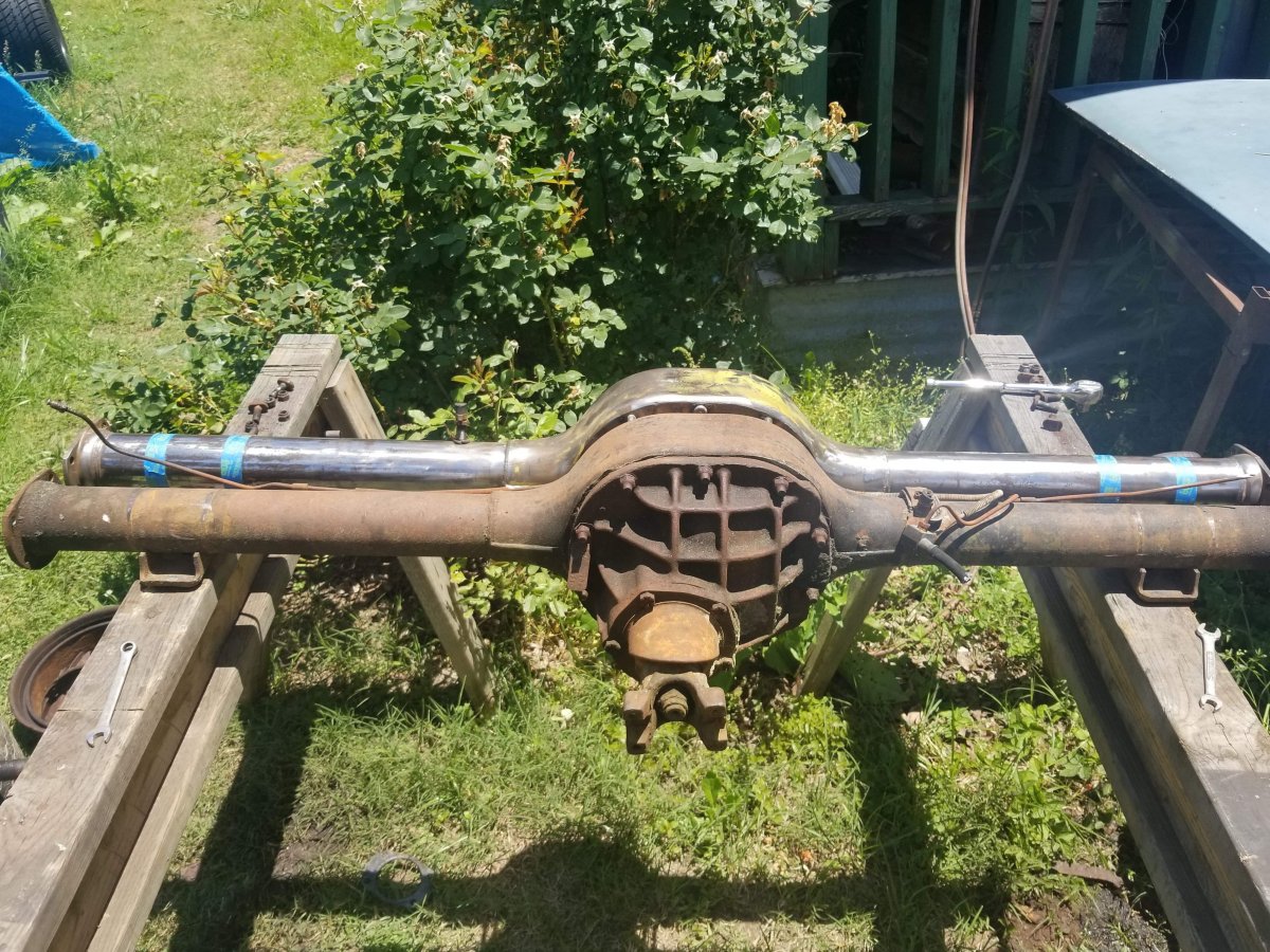

    A little while back I picked up “what I was told” was a Maverick 8” housing at a swap meet. This past weekend I scored an 8” out of a 73 mustang...the original plan was to take the backing plates and chuck out of this rear and put them in the “Maverick” housing.....well after stripping the brakes and axles off the Mustang rear I realized the housings were the same width...and my supposed “Maverick” housing had wider spring perches on it...I’m thinking it came out of a truck....not a Maverick.
    I have had a hard time finding a Maverick rear end for a decent price. And no luck at all finding a 90-92 ranger 8.8. So I think I will just order some new axles and narrow one of theses housing.
    So I did some measuring. From wheel mounting surface to wheel mounting surface I got a measurement of 61 1/4. A Maverick rear is 56 1/2. Sooo....I need to remove a total of 5 1/4 inches from one of the housing...equal 2 5/8 inches off each side of the housing. I’m going to put the weld seam in the center of the spring perch. So my 1st order of business was to mark the spring perch centers. I marked and taped the area off. Then I measured 2 5/8 to the out side of the perch centers, then marked and taped it off.
    I’ll probably check all the measurements about 10 more times before I start cutting.
    The Mustang rear came with a 3:08 gear....trying to decide if I want to keep it or swap to either a 3:55 or 3:73 gear. The car will mainly be used for cruising and highway driving.

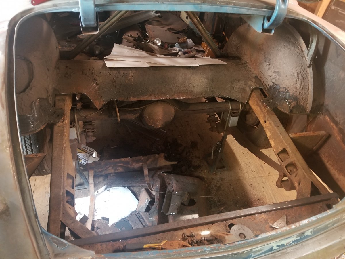

    Got started on the truck floor. I’m going to be redoing most of the trunk pan...the drivers side is pretty rough.

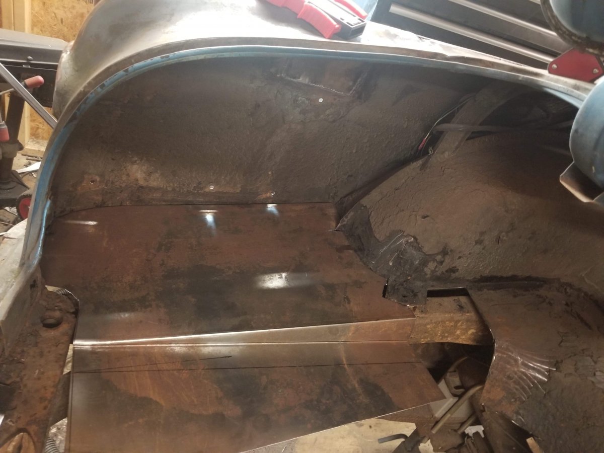

    Trunk pan was worse than I originally thought. So I went ahead and cut it out. I should get started fabricating the new floor pan this weekend.

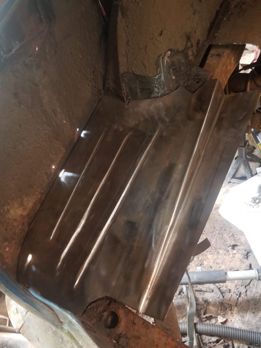

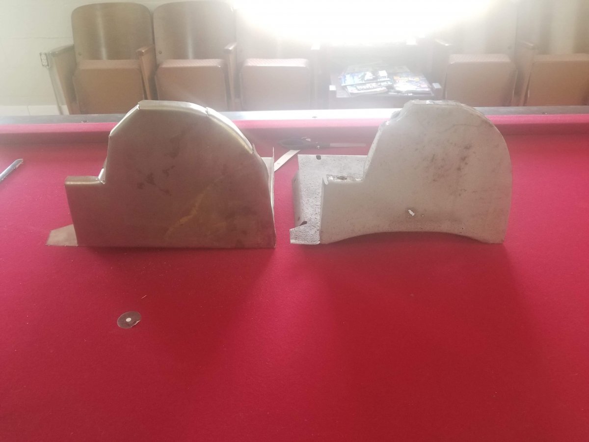

    Test fitting the left trunk panel. I still have to trim the excess off the right side and put some beads into it.

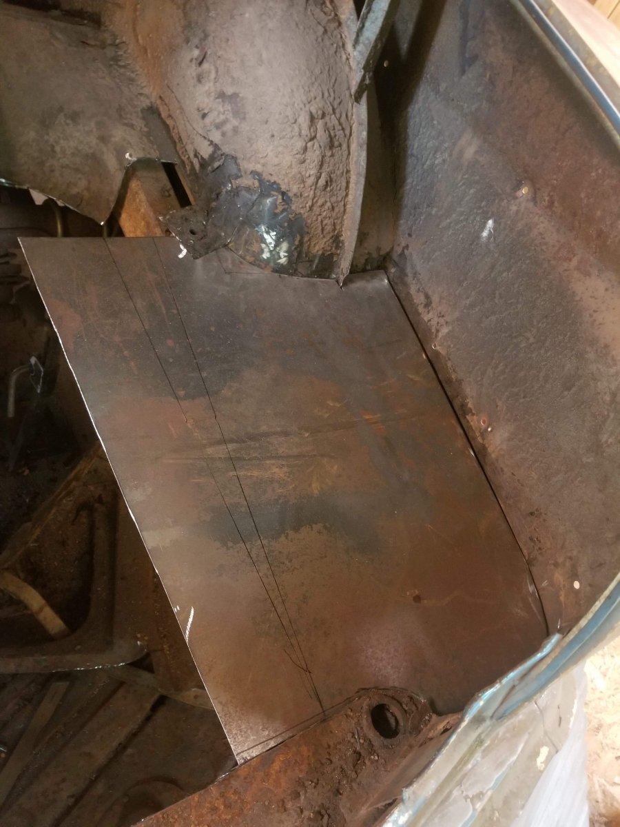

    Left side is basically finished....started mocking up the right side. Should get the bends in it tomorrow. I’m not going to start welding anything in place until I get the rear panel and back half fabricated.

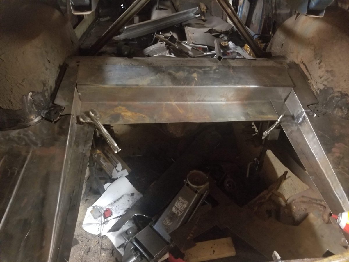

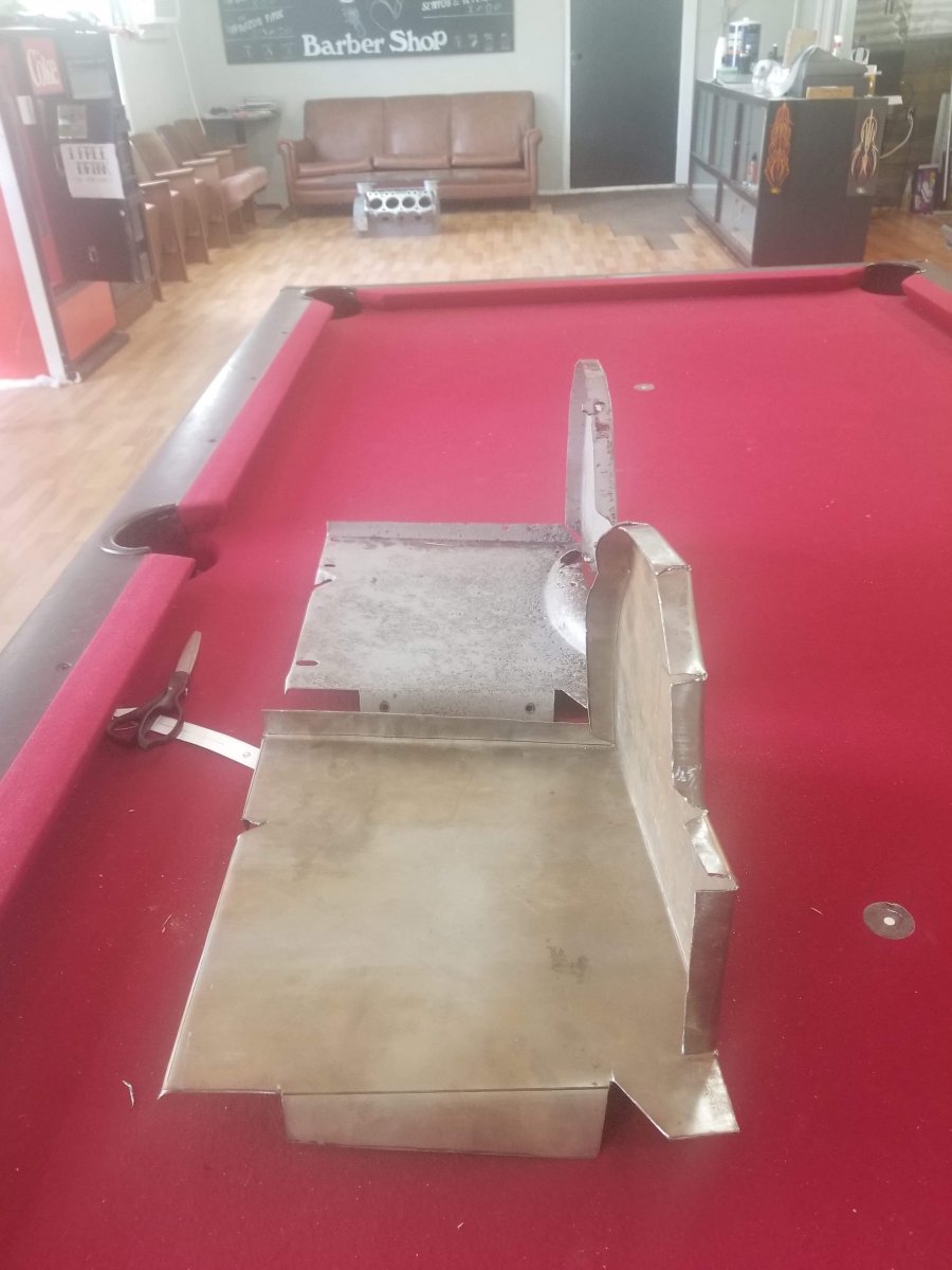

    Not much to report...got another trunk panel made and mocked up.
    Unfortunately time is in short supply for me right now...between building a new house, truck broke dow, my daughters up coming sweet 16 birthday and family vacation, I haven’t had much time in the shop. I’m going to try to get a couple of hours in tomorrow and a few hours this Saturday before I leave for Savannah on Sunday.

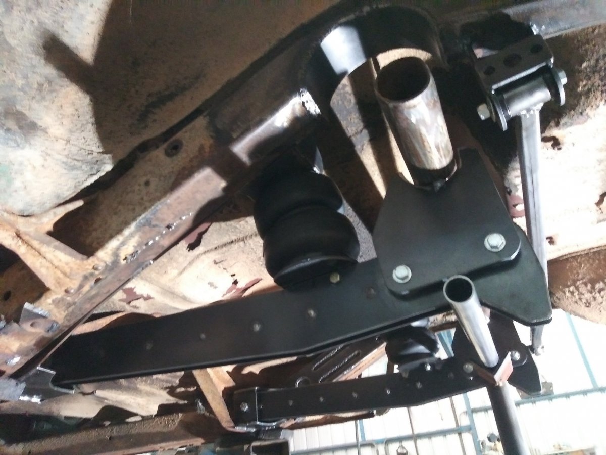

    But I’m also considering doing a 2 link with air ride from Extreme Kustoms. (Pictured below)
  21. parabola
    Joined: Mar 31, 2010
    Posts: 256
    parabola
    from OR
    That's the setup I plan to install

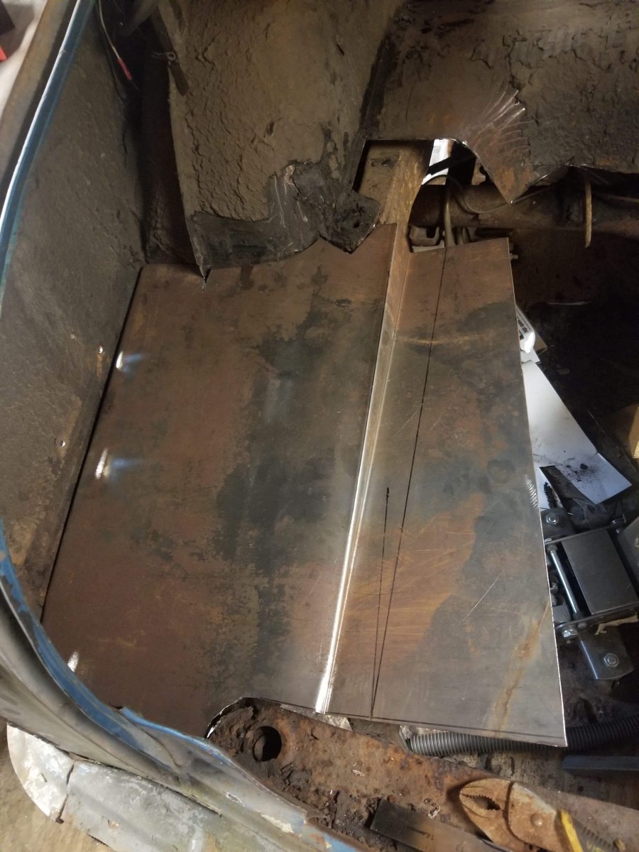

    Got a couple hours in tonight. Got the last trunk panel fabbed up. I still have some t******* and fitting to do before I start welding it all up.

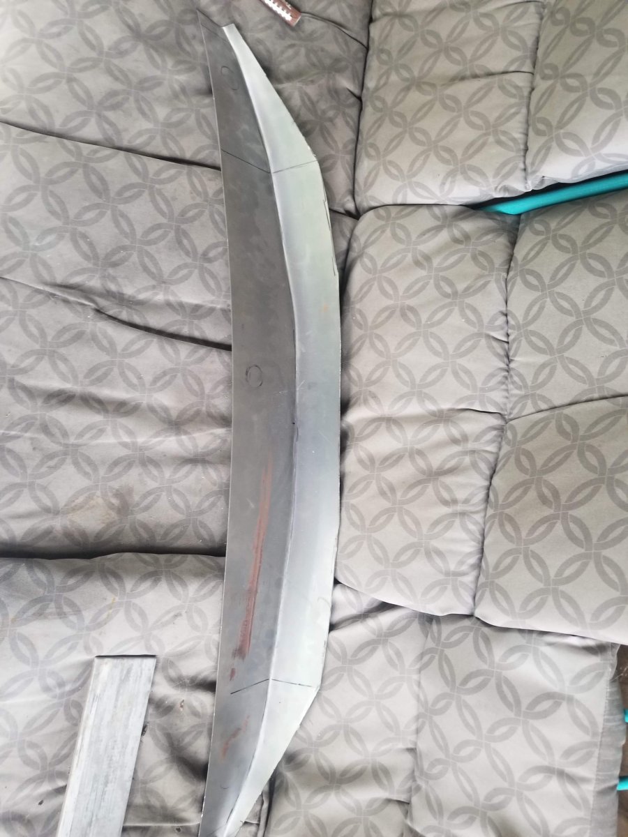

    Rear trunk pan 2.0. Decided to make a one piece rear section so I ordered a tipping die set. I think it is turning out pretty good. I need to find away to take the arch out caused by the tipping process. ....I would kill for a deep throat shrinker stretcher right now. Lol

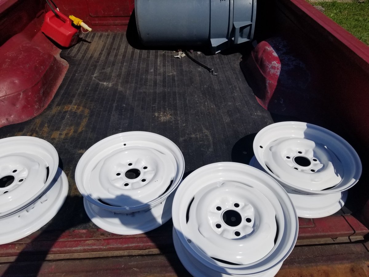

    Not much to update....I have a deep throat shrinker stretcher on the way so I can finish up the rear trunk pan. And I picked up my wheels from getting powder coated. I think they turned out great.
