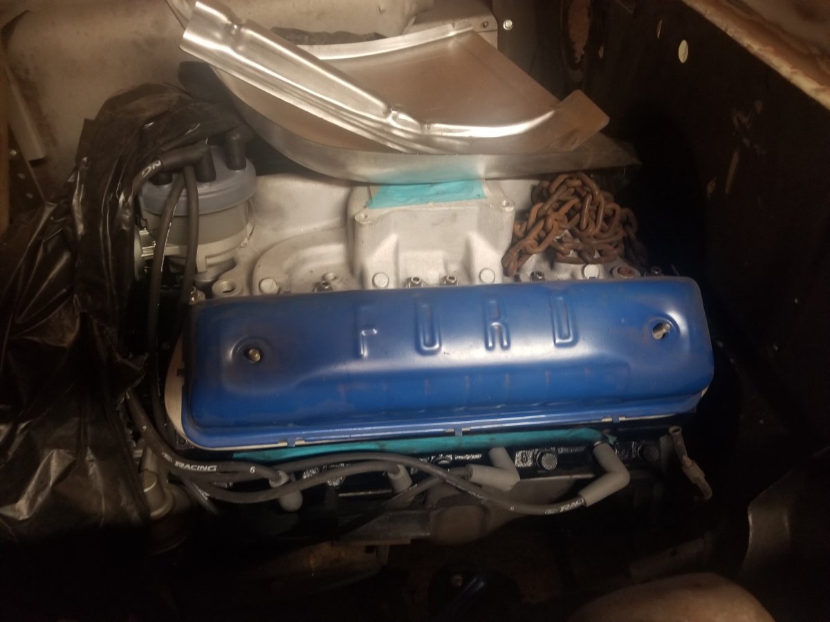

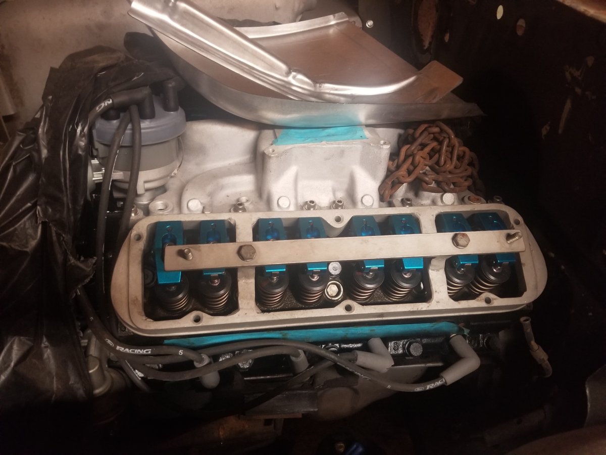

    I’ve not had a chance to work on the 51 lately. But my good friend Dan Cain hooked me up with this set of valve cover adapters his dad (Ted Cain) made back in the day. They will allow me to mount Y-block Ford/Mercury valve covers to my SBF. Now I need to decide which set to run. I have the Ford stamped cover (pictured below), a set of the Mercury stamped cover, and a smooth set. I also have access to a thunderbird set. Im also considering an aftermarket set with slanted fins.....so many options.

    Cool adapters!
    Those will confuse the crap out of people

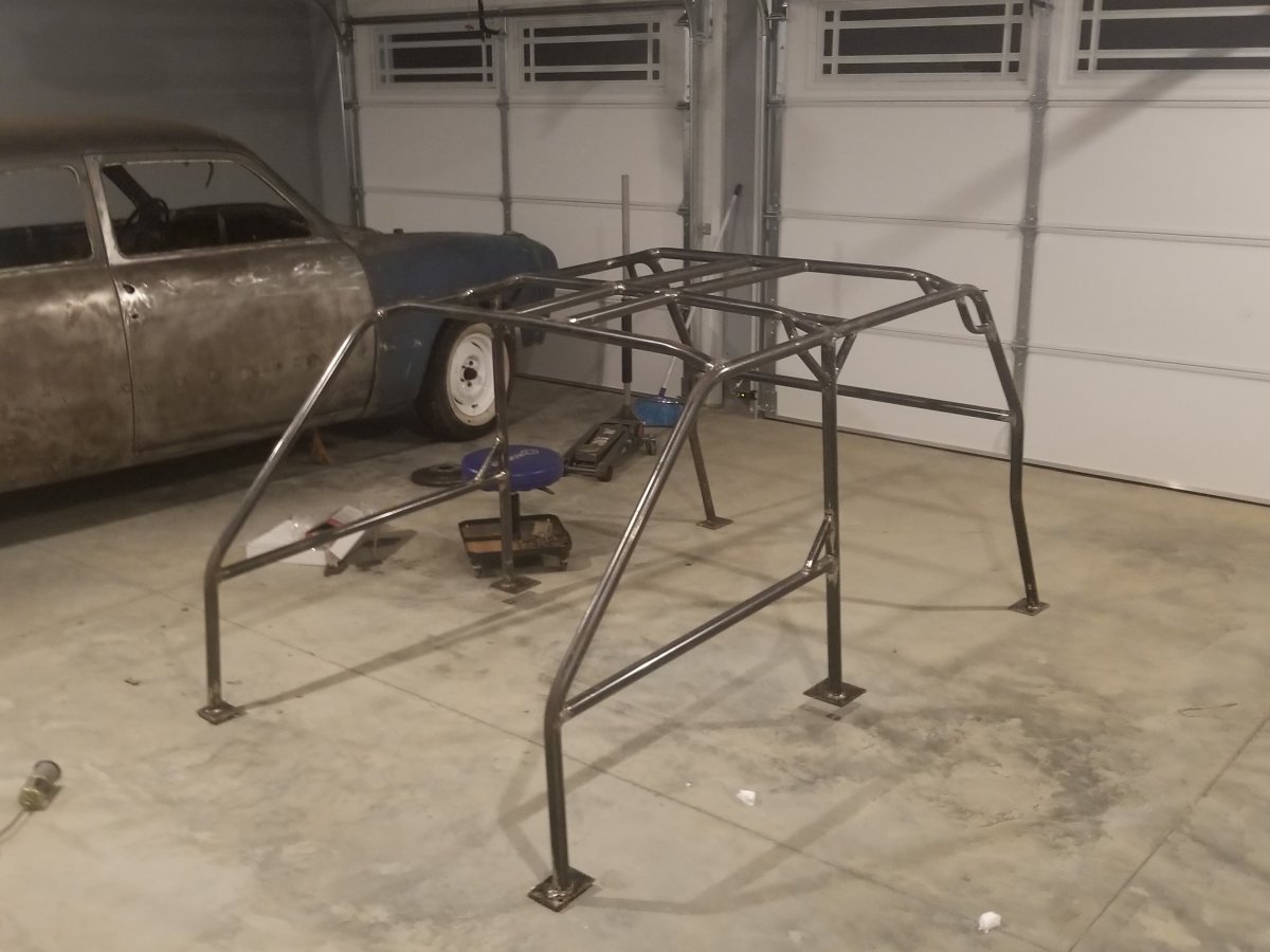

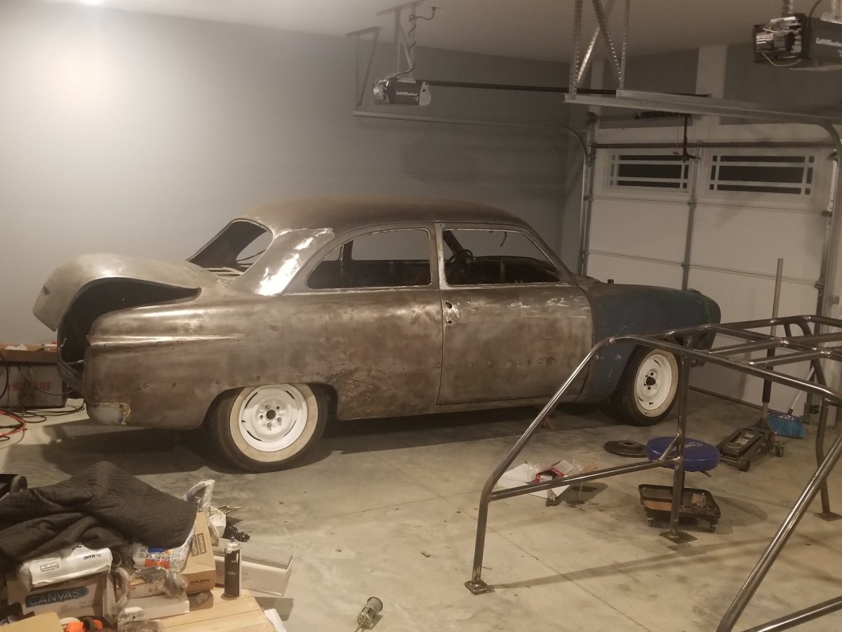

    No work progress on the 51...but I did get her moved to the new house...she is in here temporary home in the 2 car garage. Unfortunately the misses won’t let me work on the 51 in the new garage. Just more motivation to get my little shop building moved up here and to get started on building my new shop.
    I also have my dads roll cage in my garage. It is for his 1st gen. Bronco. I have to clean up his welds and make them look “Pretty” before the cage gets powder coated.

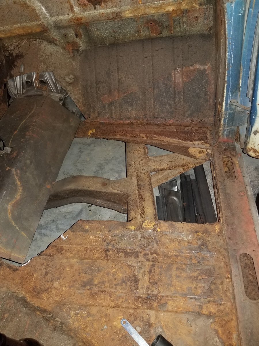

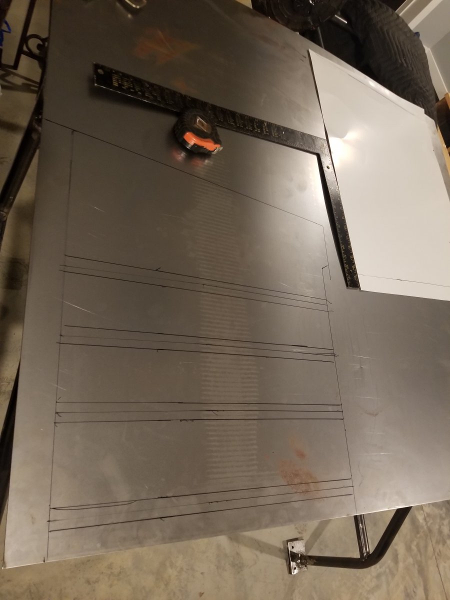

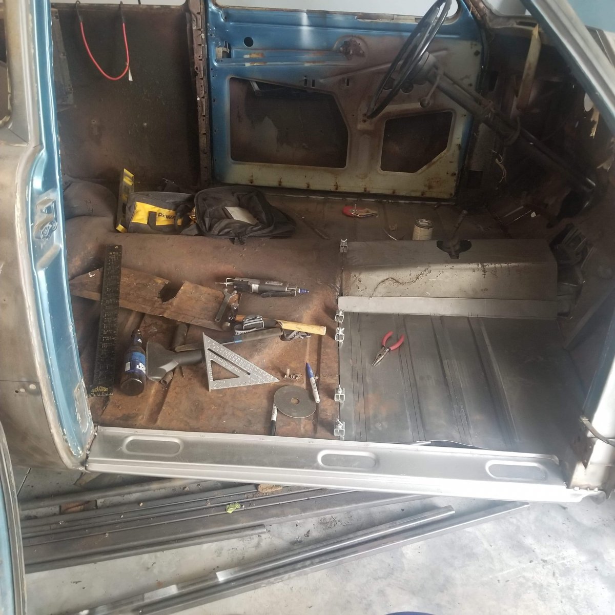

    Well....Since the 51 in the garage of the new house....and I have to walk by it every day...I can’t help but want to work on it. So I started laying out the new floor pan for the passenger side.
    I got the basic pattern laid out. I’ll get it cut out later this week and start bead rolling it.

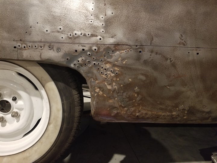

    The passenger side quarter is pretty banged up but the metal is solid (except for the drilled holes). I think I’m going to cut out the panel and use the English wheel to smooth it out....worst case...if that doesn’t work I’ll buy a replacement panel from shoebox central. ....just in case I have to use a replacement panel....does anyone know how high above the wheel opening this panel goes.

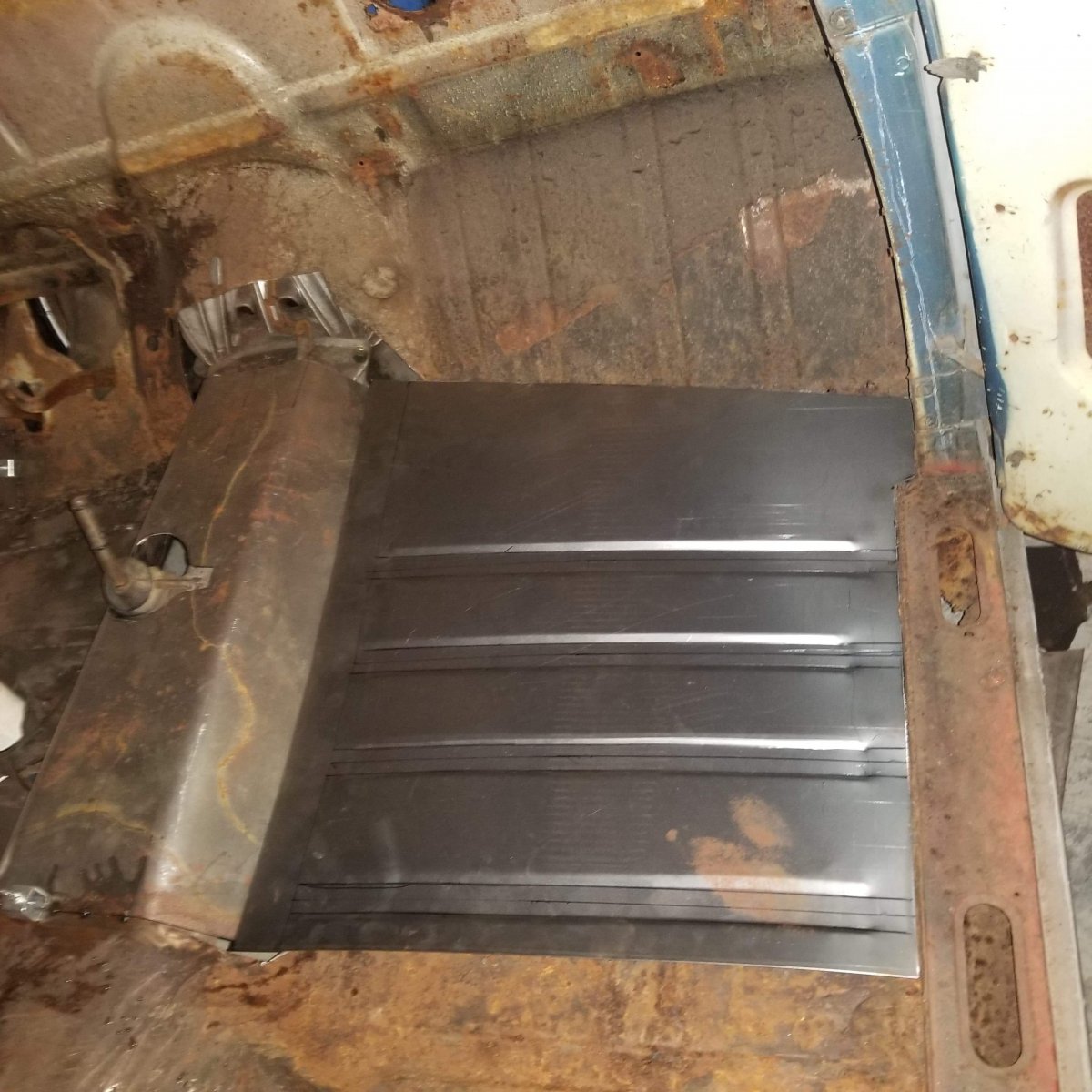

    I got the bead ran on the passenger side floor pan. I still have to add a bend on the left side to connect to the trans tunnel.
    And I also still need to trim some of the old floor.

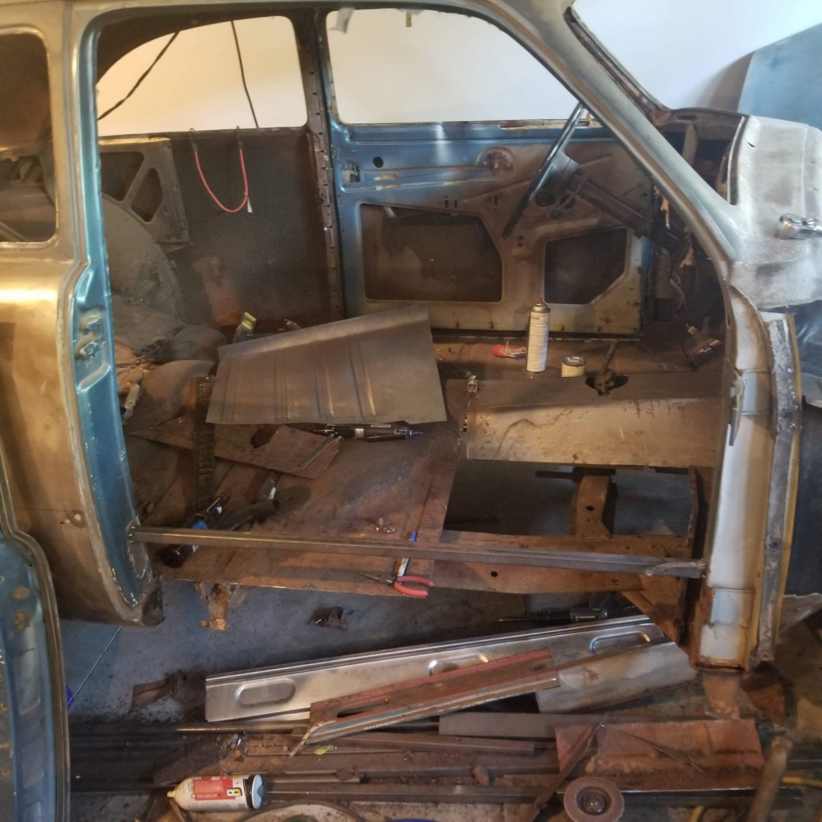

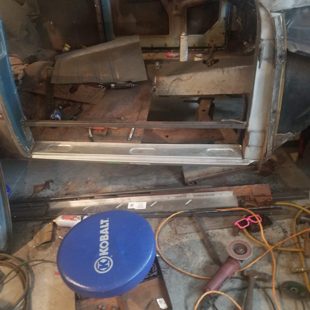

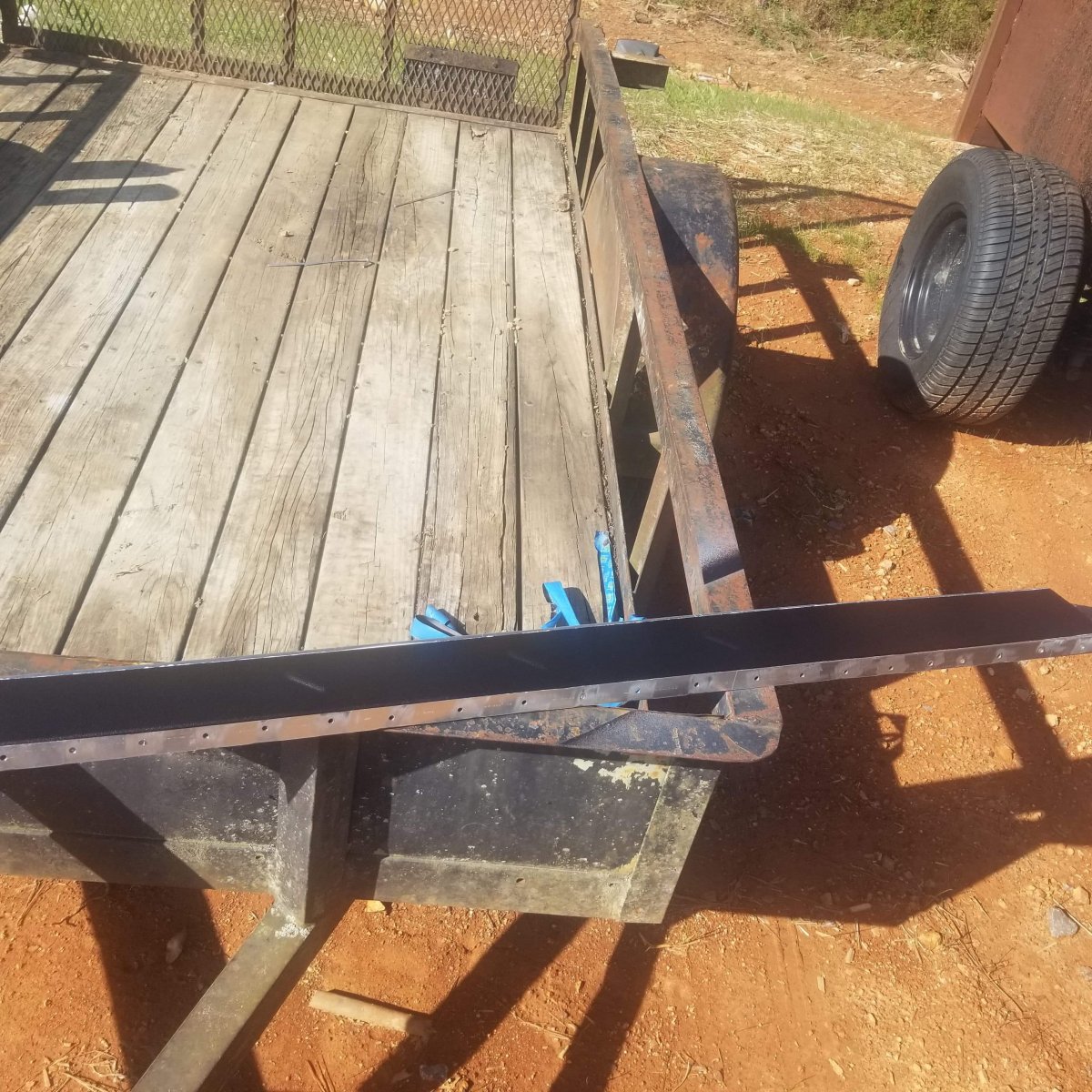

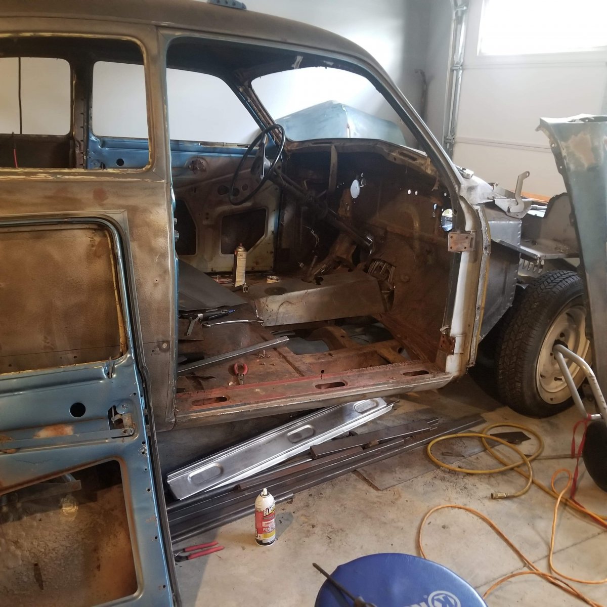

    I finally got back to work on the 51. I removed the door, then welded in a support brace and started removing the rotted inner and outer rocker panel.
    80EDC47E-6C59-437A-81E0-9376F8BAC4E2.jpeg AC4A687D-8F5A-4B9C-AB6D-8280A3773EEE.jpeg
    Next will be to clean up the body mounts and start test fitting the new rocker panels

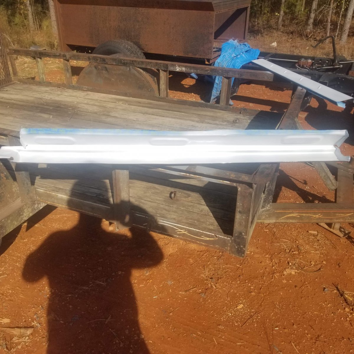

    Started test fitting the rocker panel this morning. It’s fitting nicely. I have to get the inner rocker fitting correctly then I’ll get everything welded up. 5328D685-0B89-496C-9E15-F48C85ED7604.jpeg

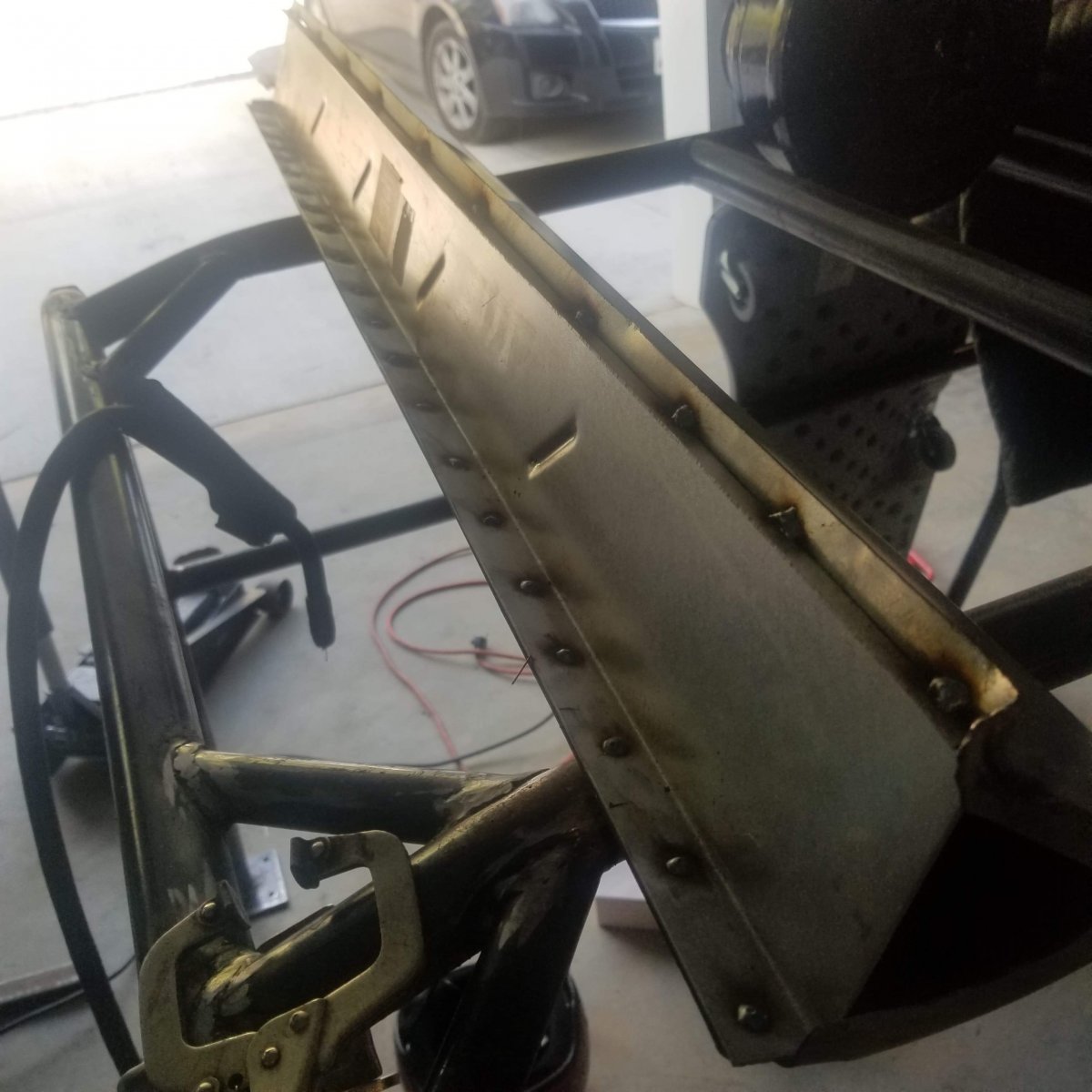

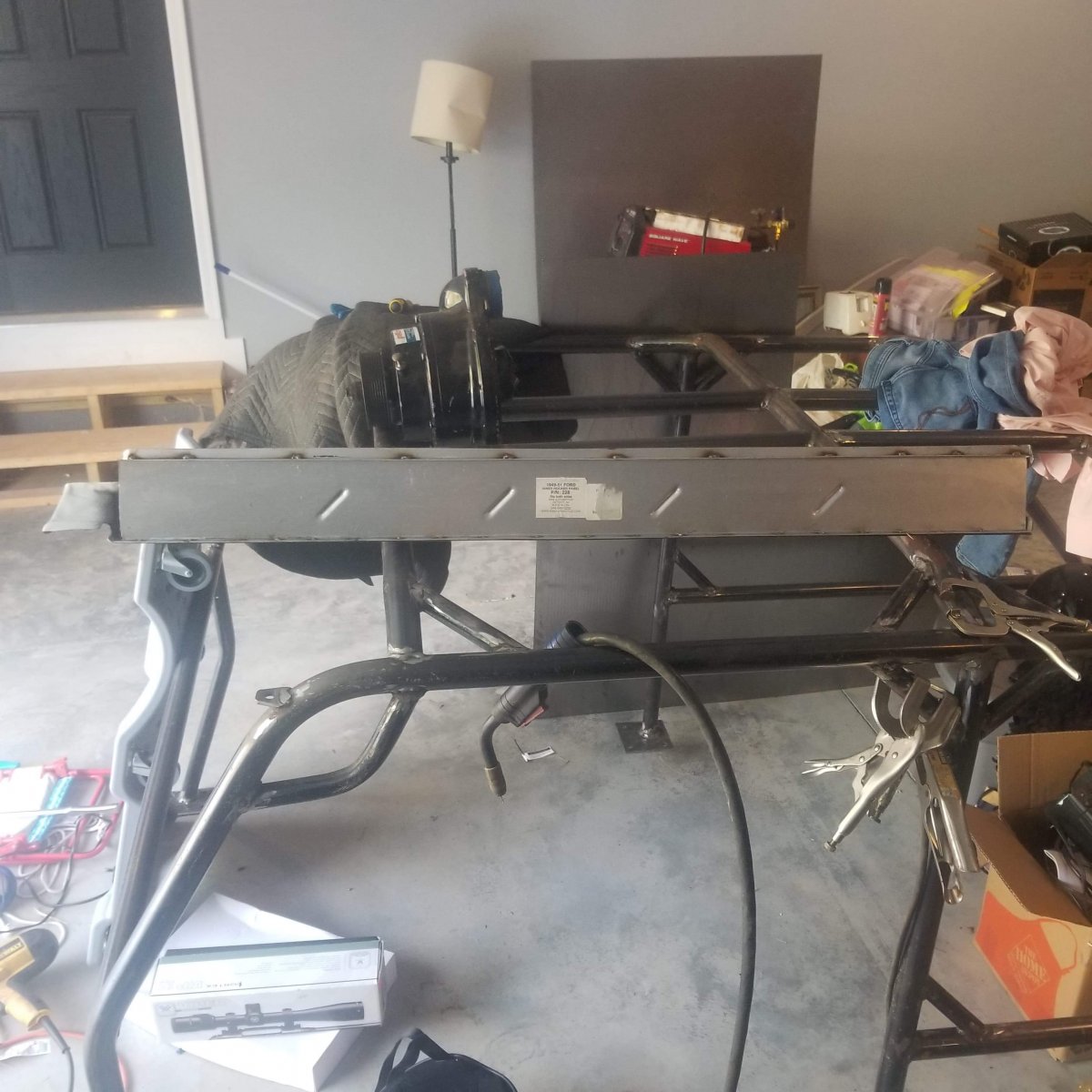

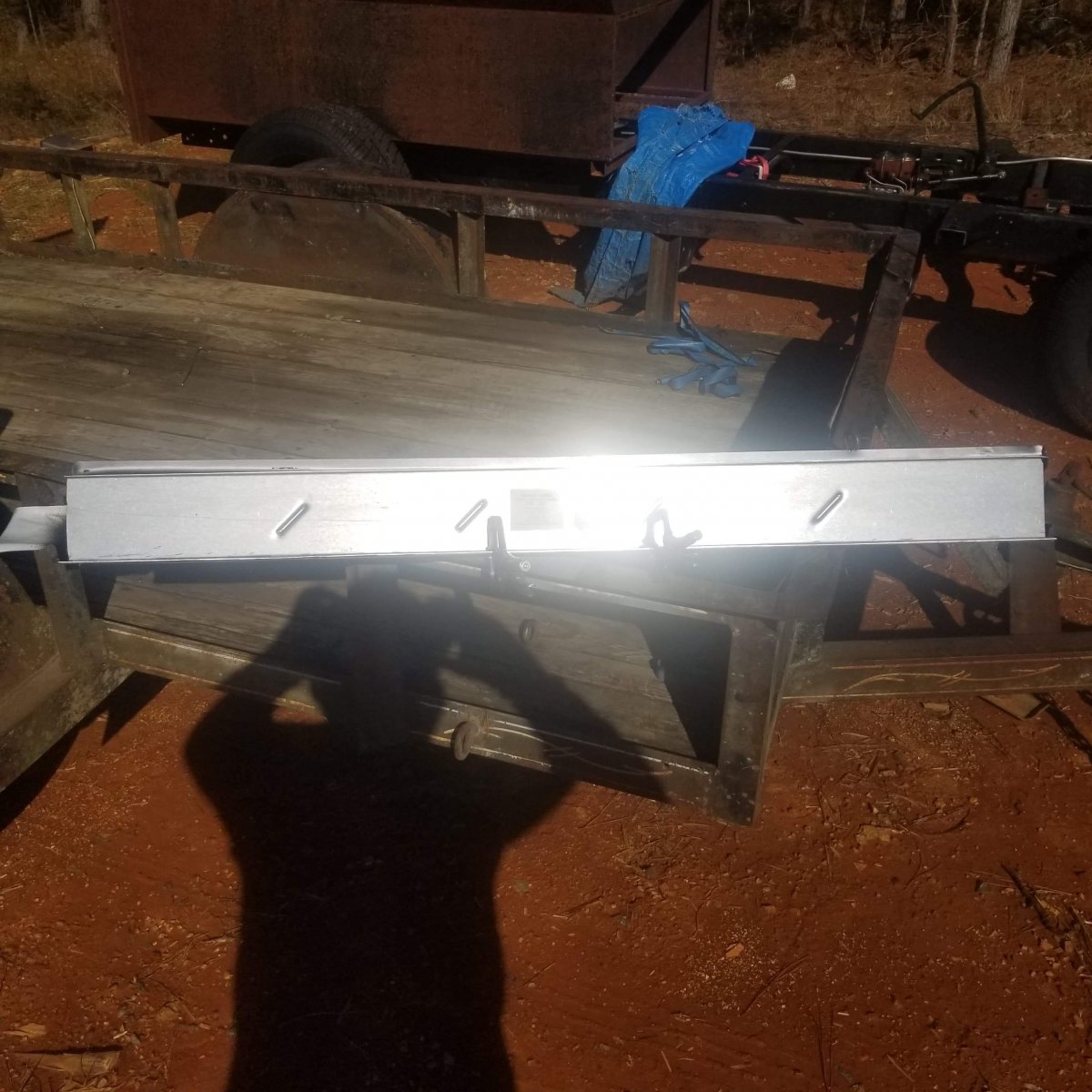

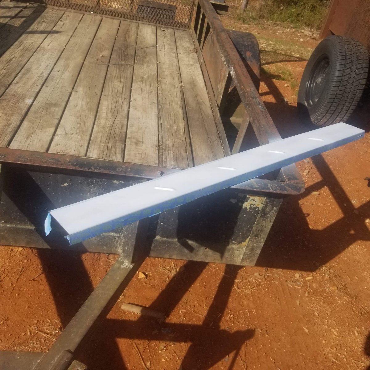

    Finished test fitting the inner and outer rocker. Now it was time to prep the 2 to be welded together.
    1st I primed the inside of each panel after I had taped off the edges that would be welded together.
    8B871252-9186-40A9-9701-11C02C951358.jpeg 8D5293F9-1348-4433-BEEC-5A1C3823F4C4.jpeg
    next i sprayed a rubberized undercoating on the inside of each part
    0AE79614-6D20-4734-A931-0DB4DE643FB4.jpeg F13ED762-5293-44A3-B204-69E0762A0150.jpeg C23518C9-86FB-4CE0-9A1F-DF7F91F9FE0E.jpeg
    parts welded together
    B22A1000-338F-469A-AC41-A866F94CD705.jpeg 73719404-CADF-49DC-A7C4-AD73B878C383.jpeg
    and finally welded into its new home.

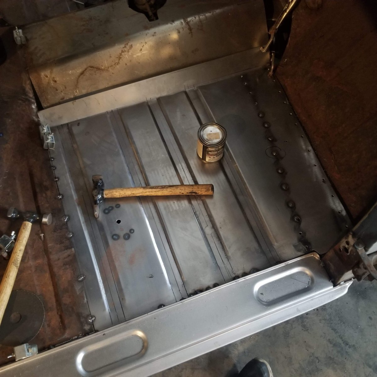

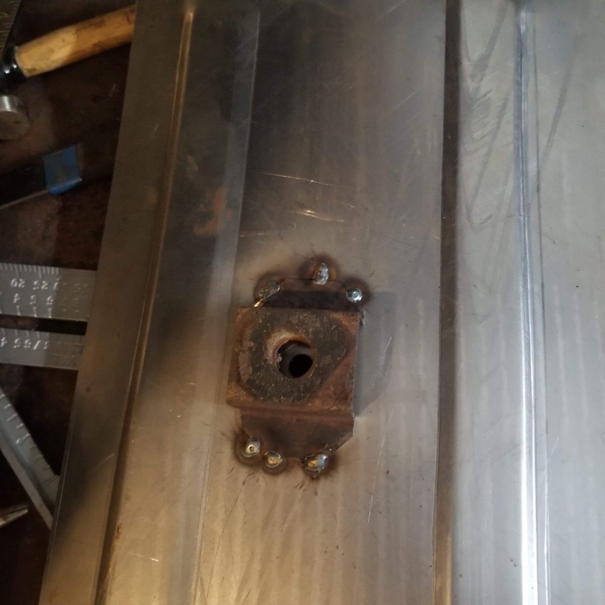

    Was able to get a little work done on the floor pan this morning before work. Started off by locating the original body mount spacer on the new floor pan and welding it in place.
    Next was lining up the floor pan and tacking it in. It is looking pretty good...in my opinion...especially for a novice metal fabricator. Lol

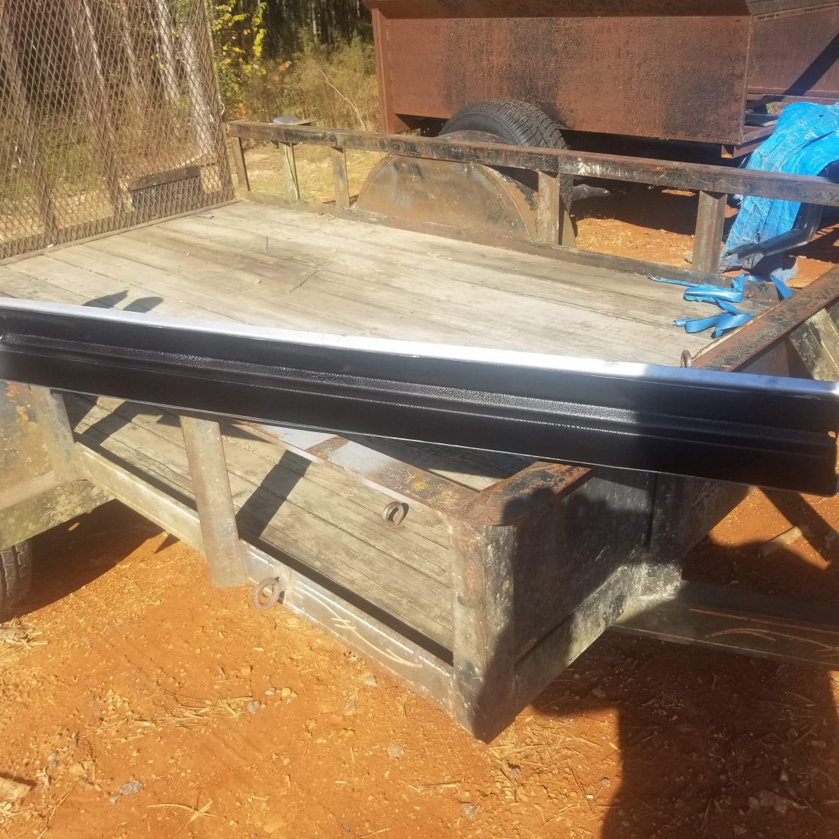

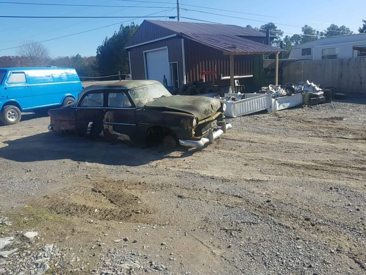

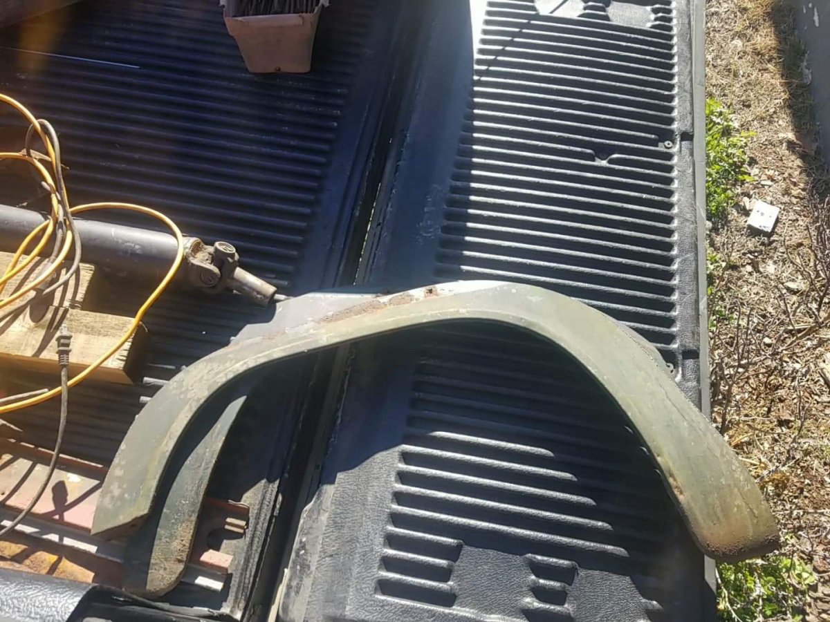

    Just Scored a set of 52-54 ford fender well lips to grapht on to my shoebox for $3.
    Someone had drug in an old 4dr to the local scrap yard. Unfortunately there wasn’t a lot left worth saving on it
    But these fender lips should look great graphed on to my 51
    brEad, loudbang and Finnrodder like this.

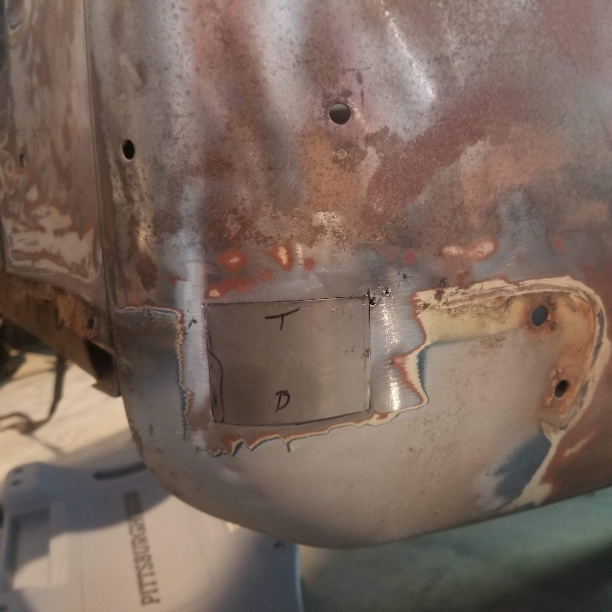

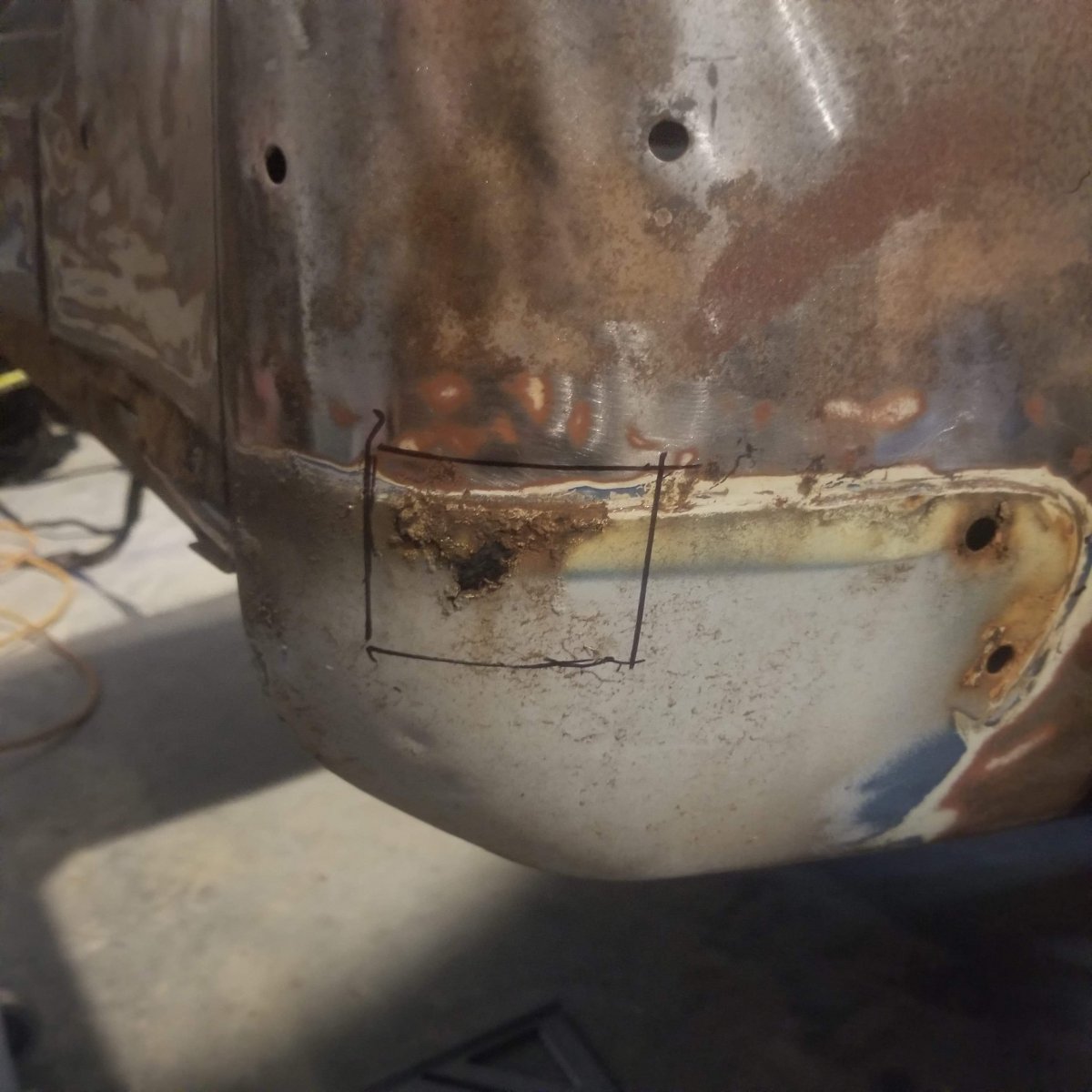

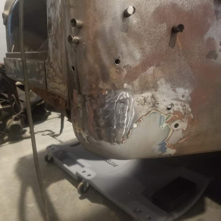

    Got some time in on the 51 today. Did a small patch on the end of the passenger quarter panel.
    E0F204DB-3601-414B-8877-76B633B9847D.jpeg 7EFEA44E-3429-45D9-9F3F-89BC77F40AFF.jpeg DB5FB2D9-13FD-4441-96F6-D63603D46529.jpeg
    I also got some work done on the rear trunk pan. Ill get some pics up of the progress on it tomorrow.
