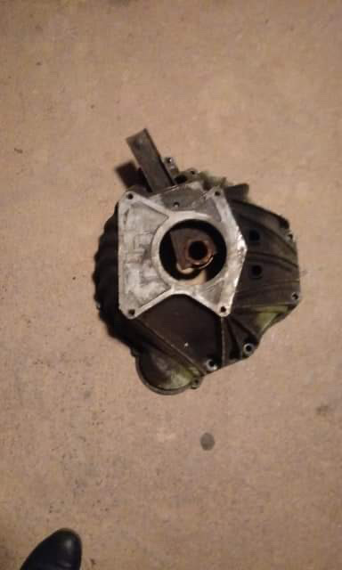

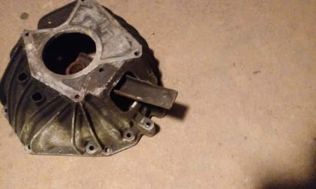

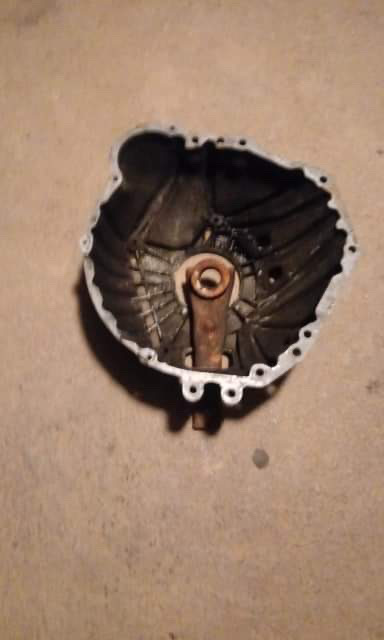

    Here are some old pics I had on my phone from the day I picked up the bellhousing.
    ill be pulling the motor and trans soon and will get a better pic.

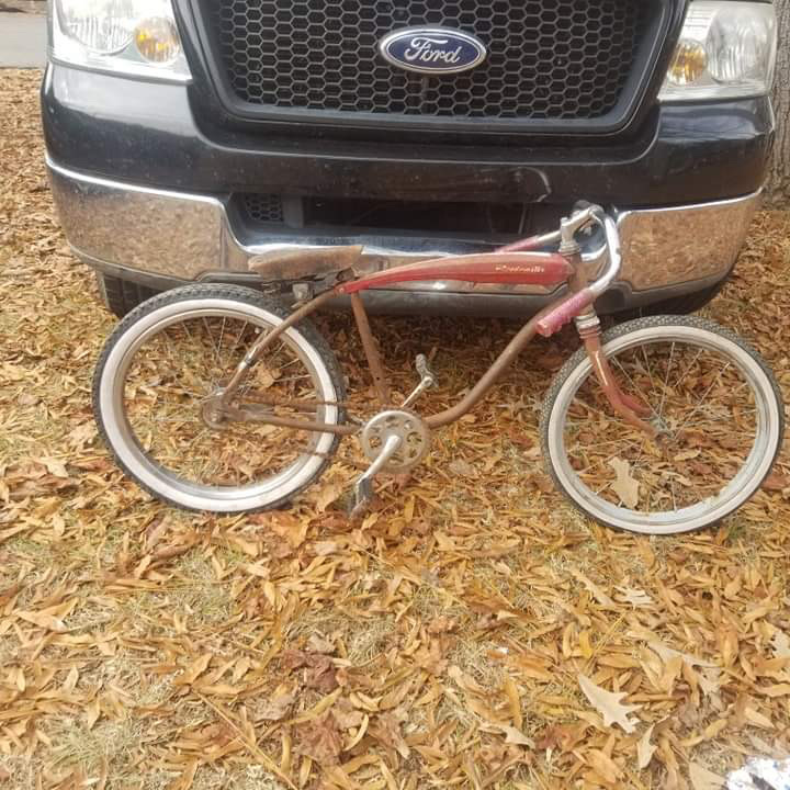

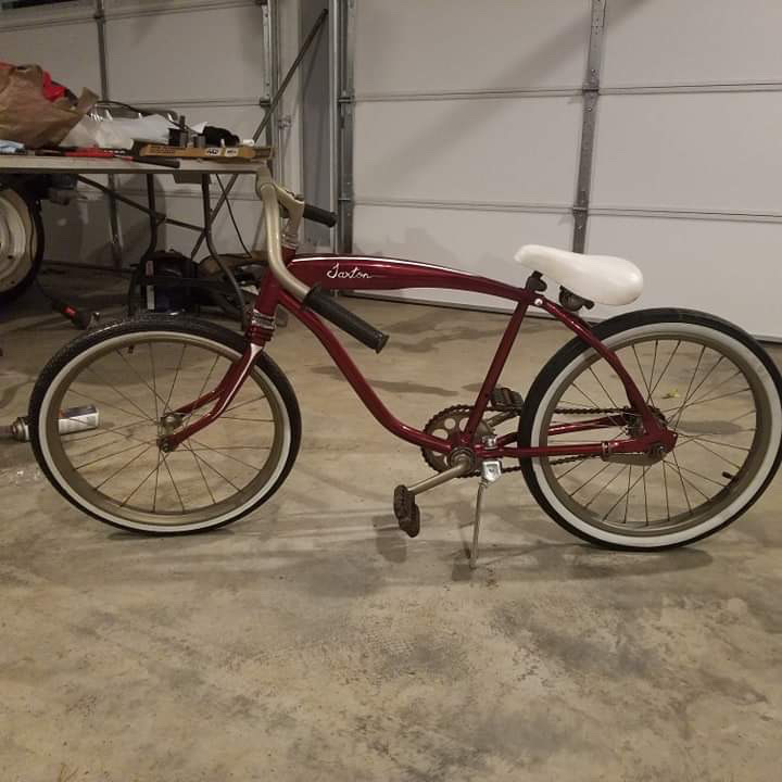

    No work on the car here lately..(because of a back injury) but I did manage to finish redoing the bicycle I picked up at the last swap meet.

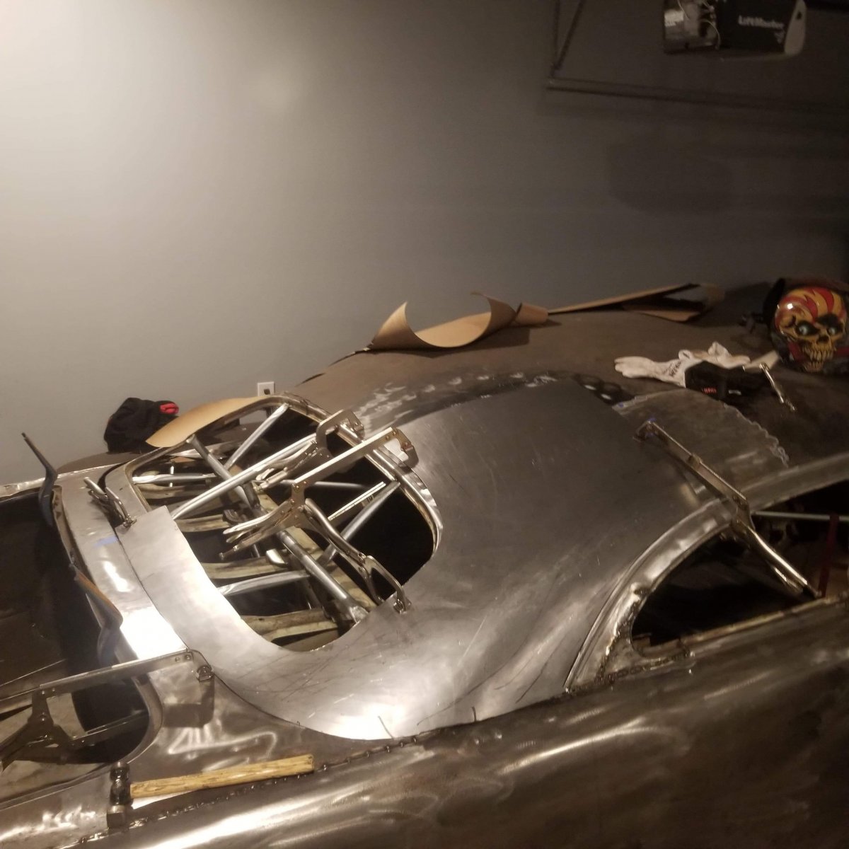

    Finished up the trans tunnel today
    I think it turned out pretty well. I still have a couple of small patches to make.

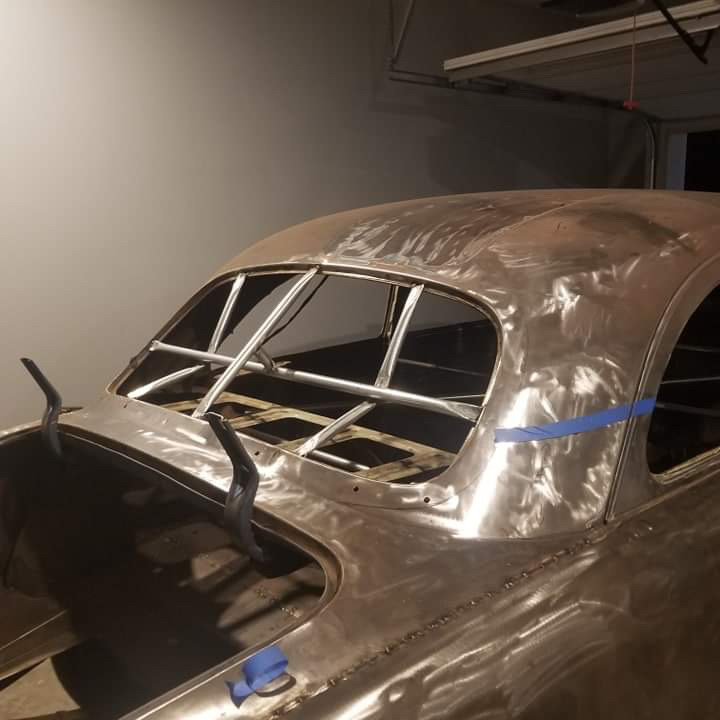

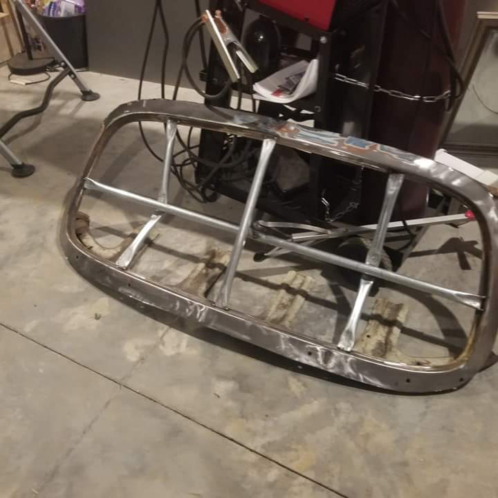

    laid out all my cuts for the chop.
    finished bracing the rear window
    Now the fun really begins. Started by cutting out the rear window.
    BC795D58-43A8-44BC-89A9-EF30F229821A.jpeg D4AE6E01-E6A9-4EB9-B30A-D60D7CC28DE8.jpeg

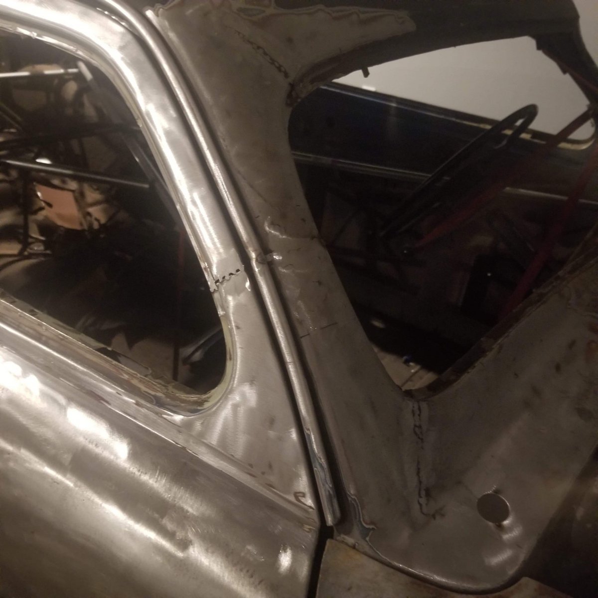

    Then I cut out the B-pillar
    I set the top back on to get a look at it.
    I’ll start working on the front post alignment this weekend.

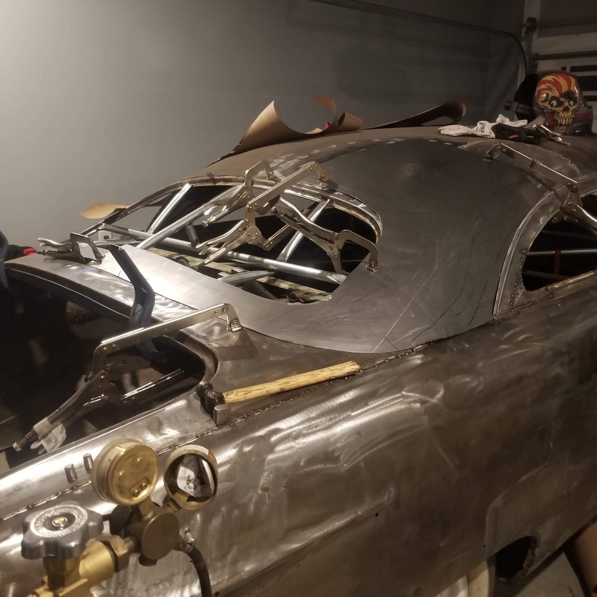

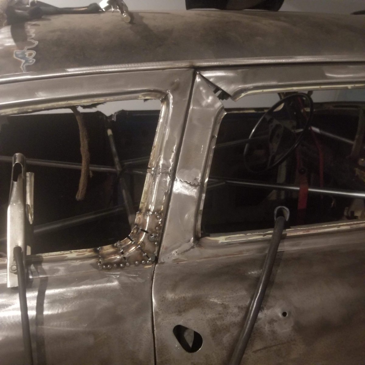

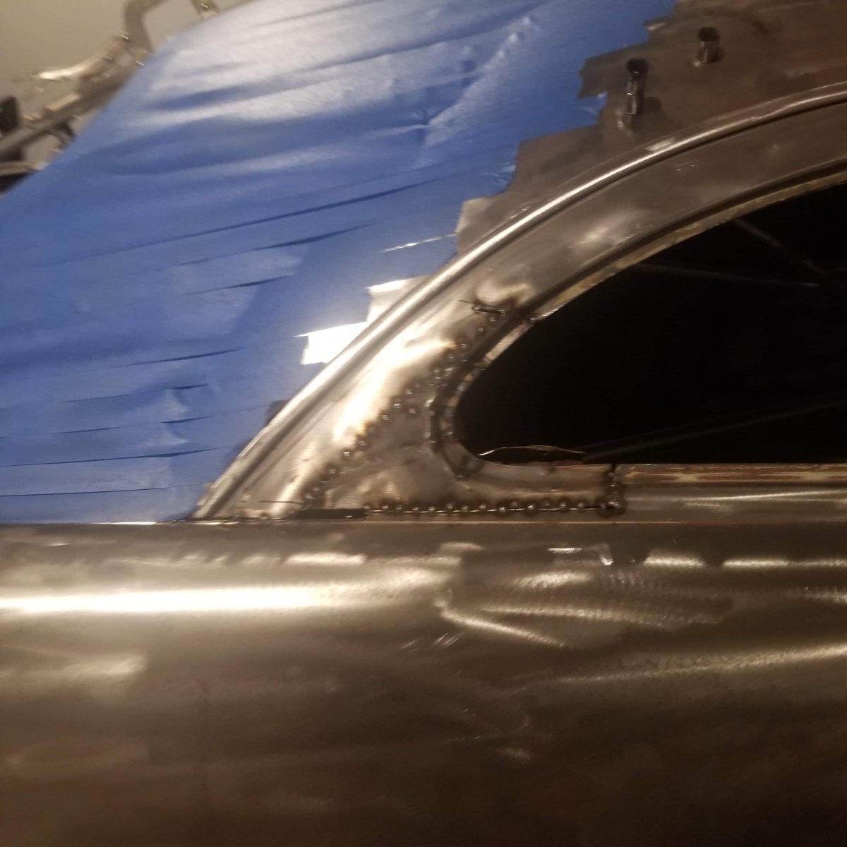

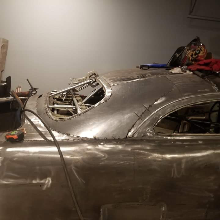

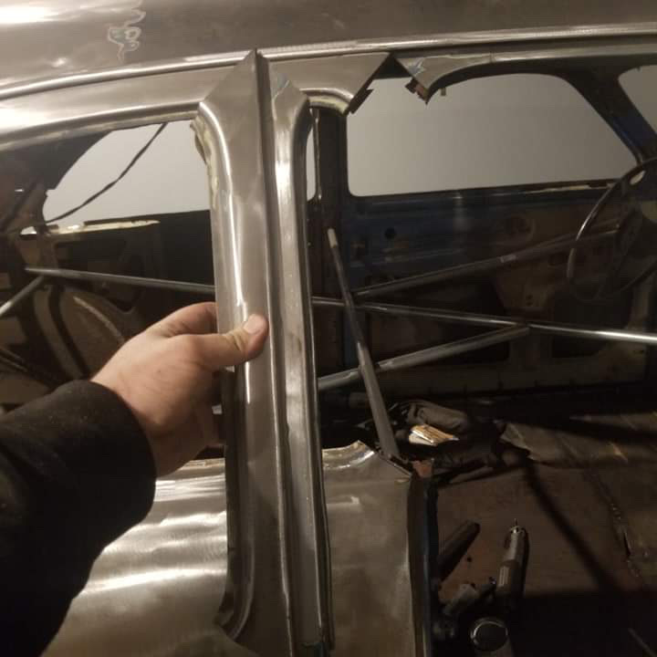

    Got a little more work done on the chop. Front post are tacked in place. Rear window is set were I think I want it. And I started working on the B-pillar and door post. Used some tape to get a better idea of the profile. More to come.

  7. harley jim
    Joined: Mar 12, 2012
    Posts: 591
    harley jim
    Nice profile Kage, I like it

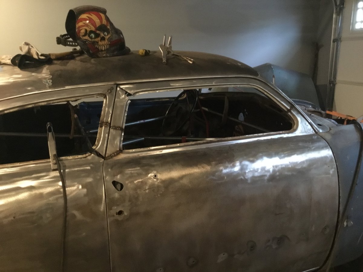

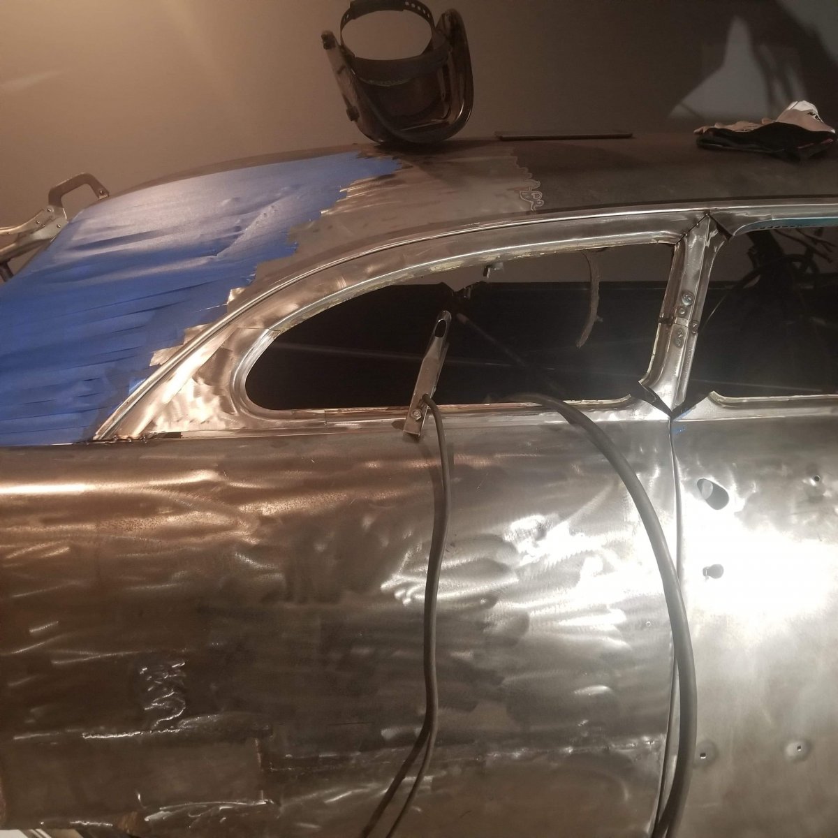

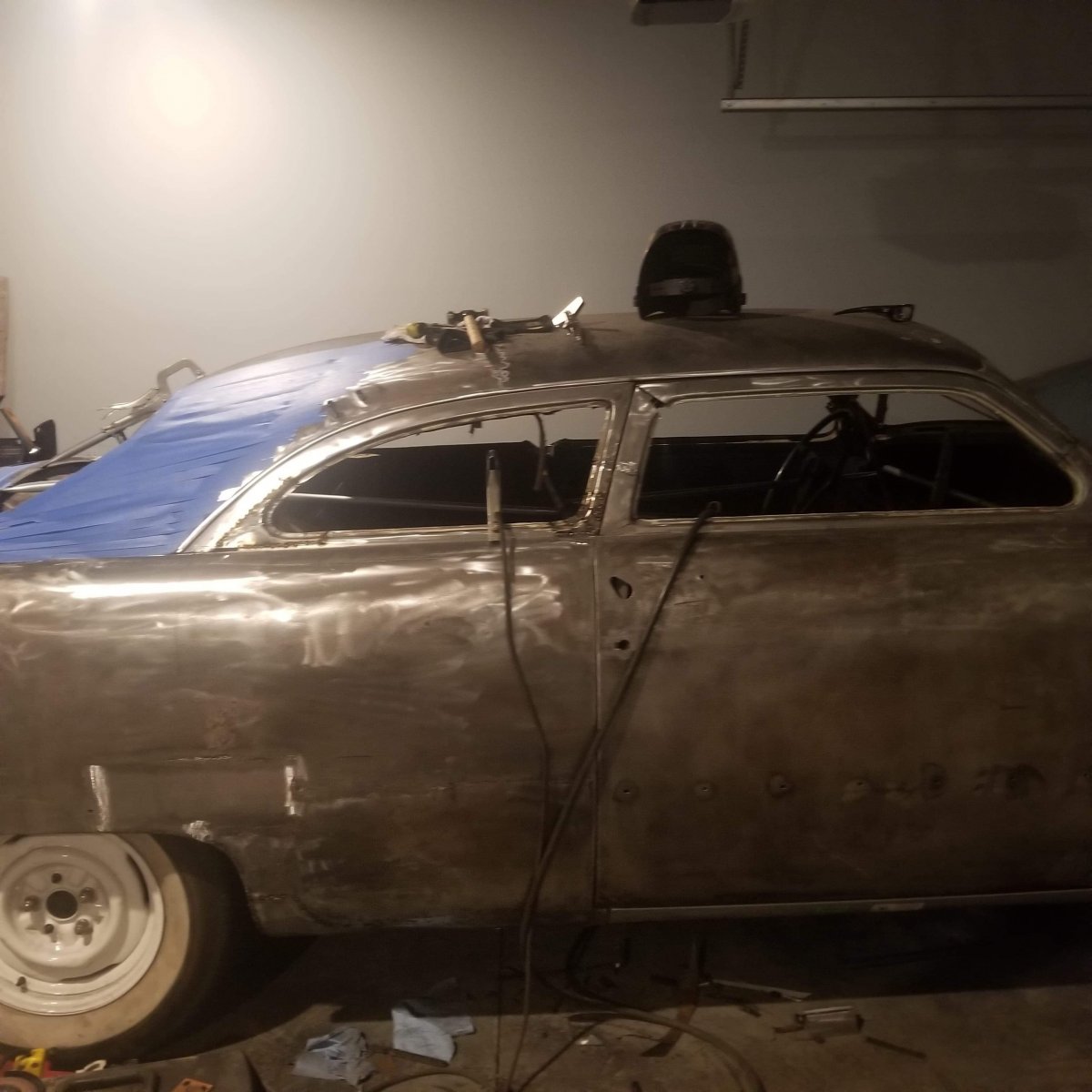

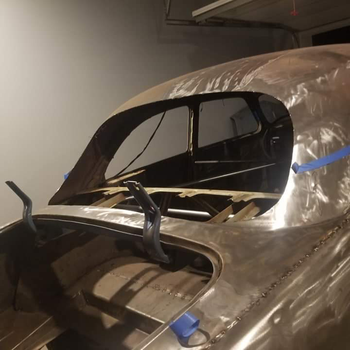

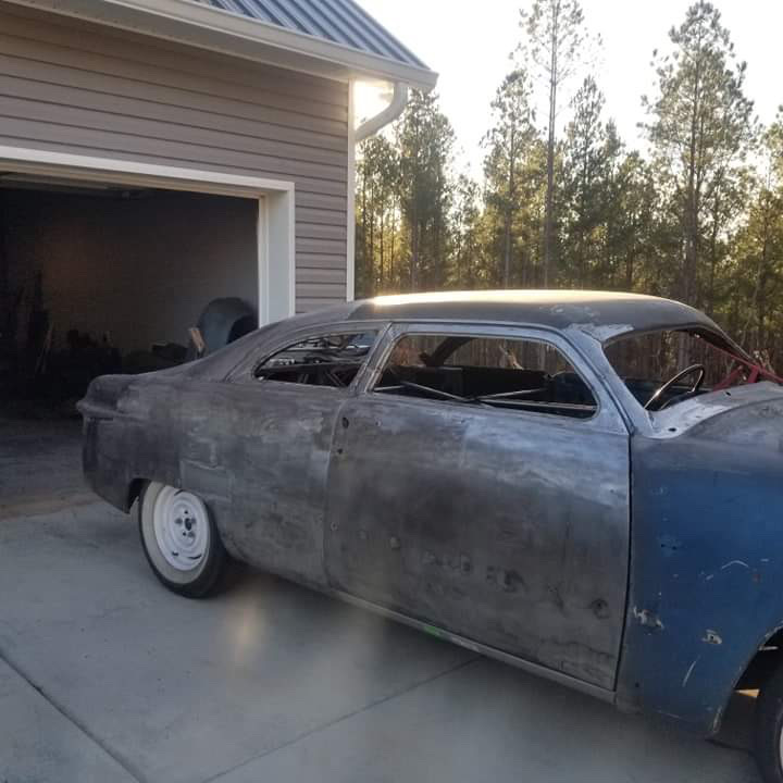

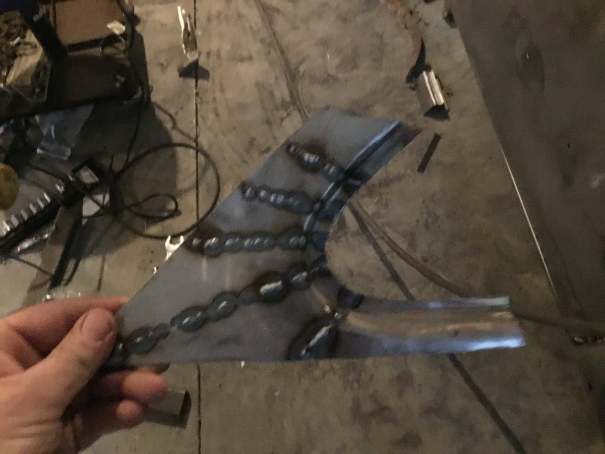

    More progress on the chop. P***enger side B-pillar, A-pillar and door window frame are almost finished, and back window corner installed.
    Luckily I have a whole extra donor roof...I cut a section out of its B-pillar to make the curve on the bottom flow better. I will do the same with the top corner of the door frame.

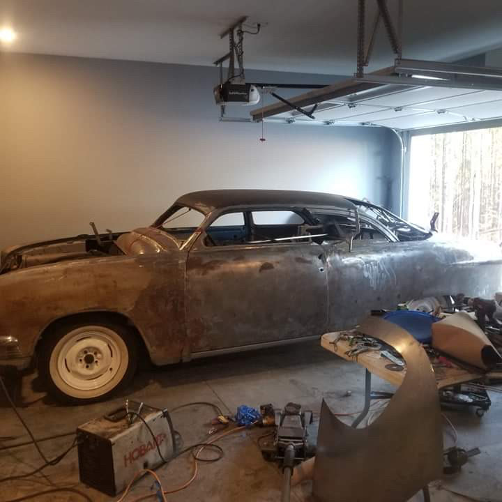

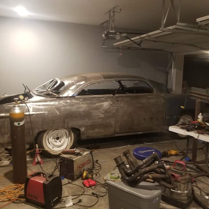

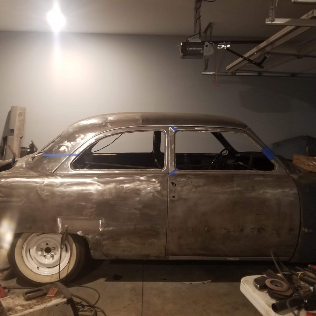

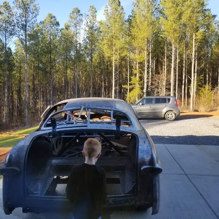

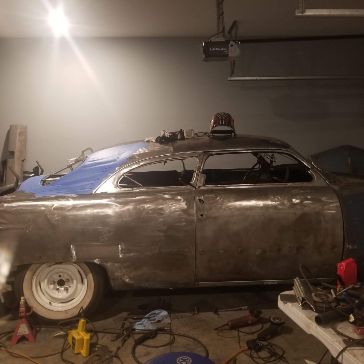

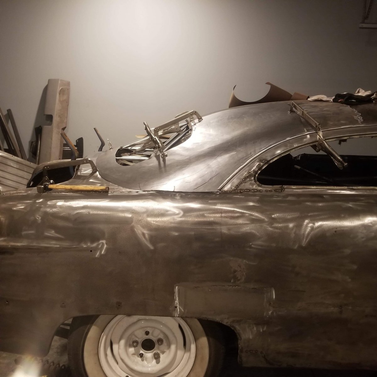

    Not much to report. I did finish fitting the p***enger side sale panel. It’s all tack in place. I will tig weld when I go to finish weld it.
    I pushed the car out side...took a couple of pics and then turned it around so I can work on the drivers side.
    my little helper was helping me push the car.
    I think the chop flows pretty well.

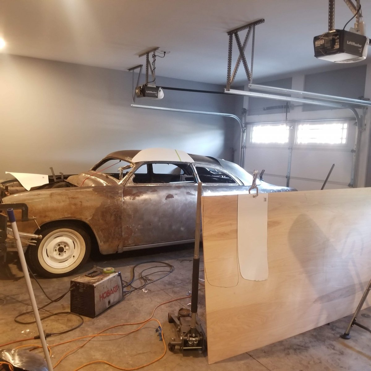

    Not much progress as of late. Currently making templates of the p***enger side window opening so I can make sure the drivers side matches perfectly.

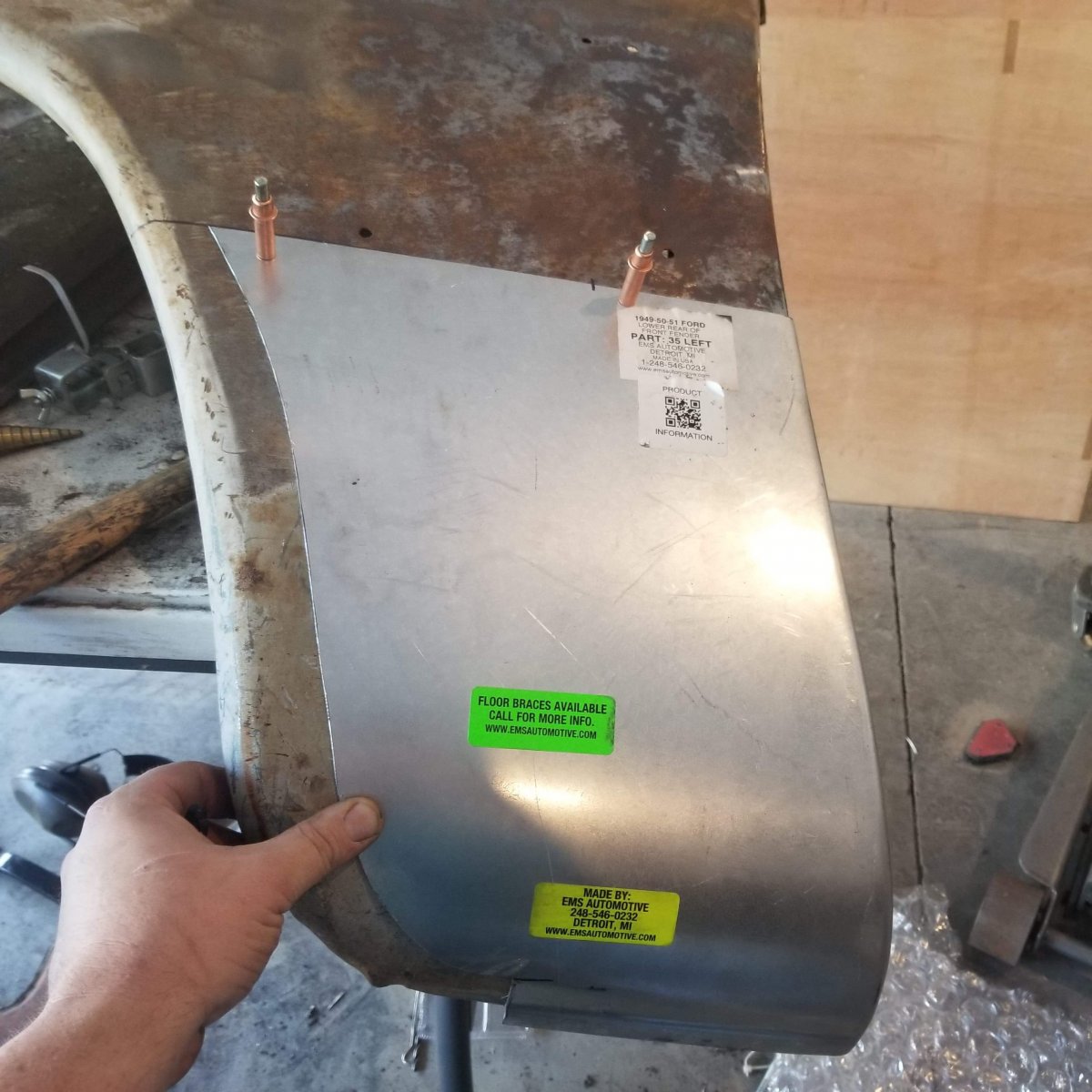

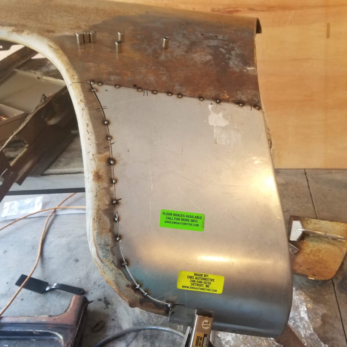

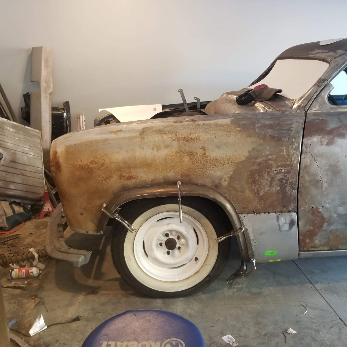

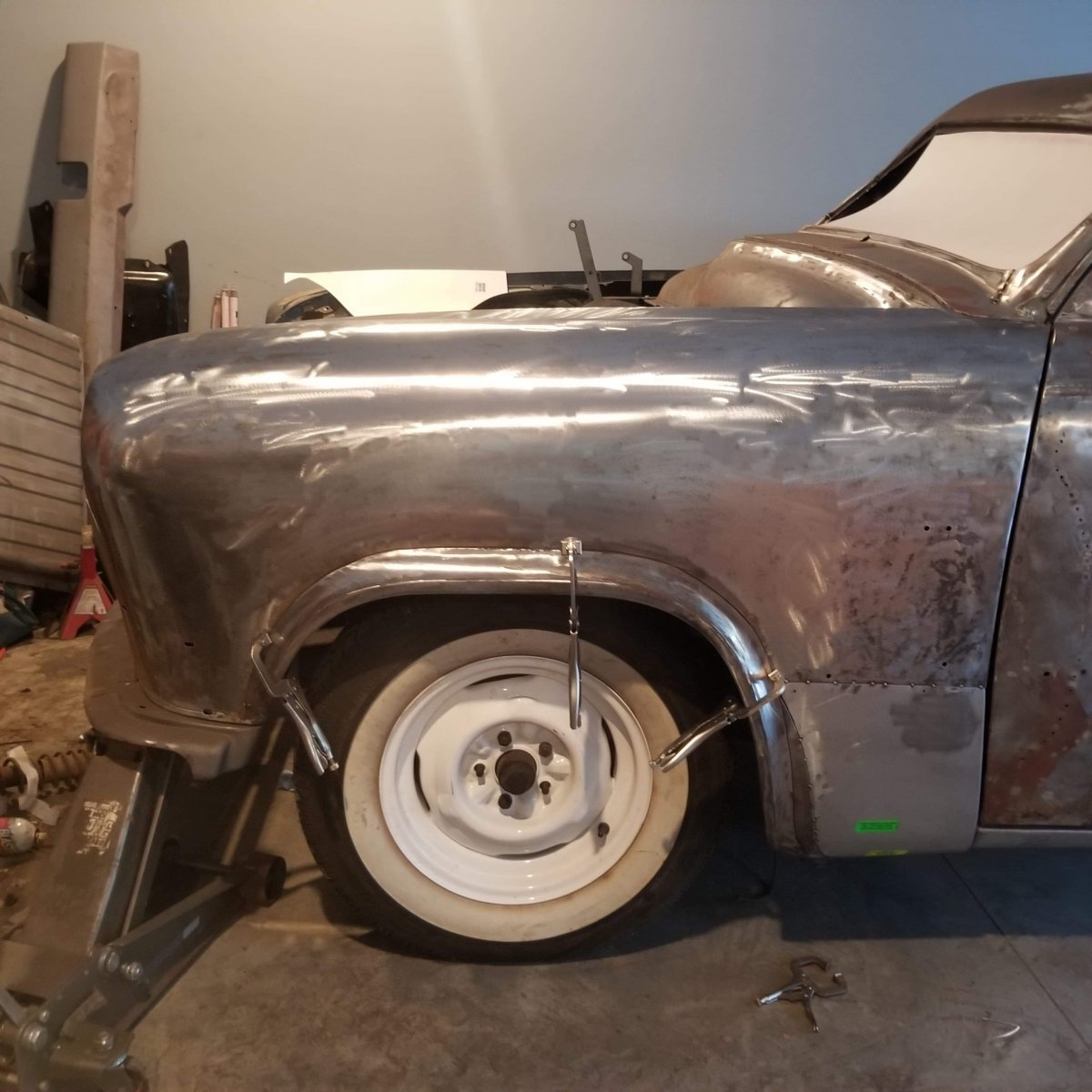

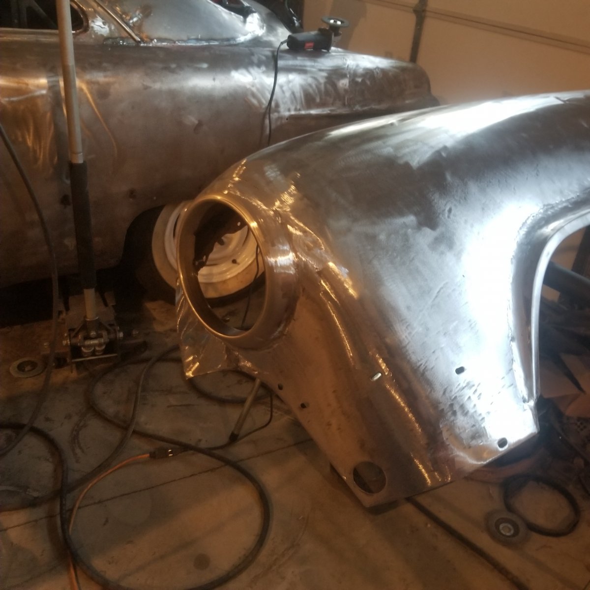

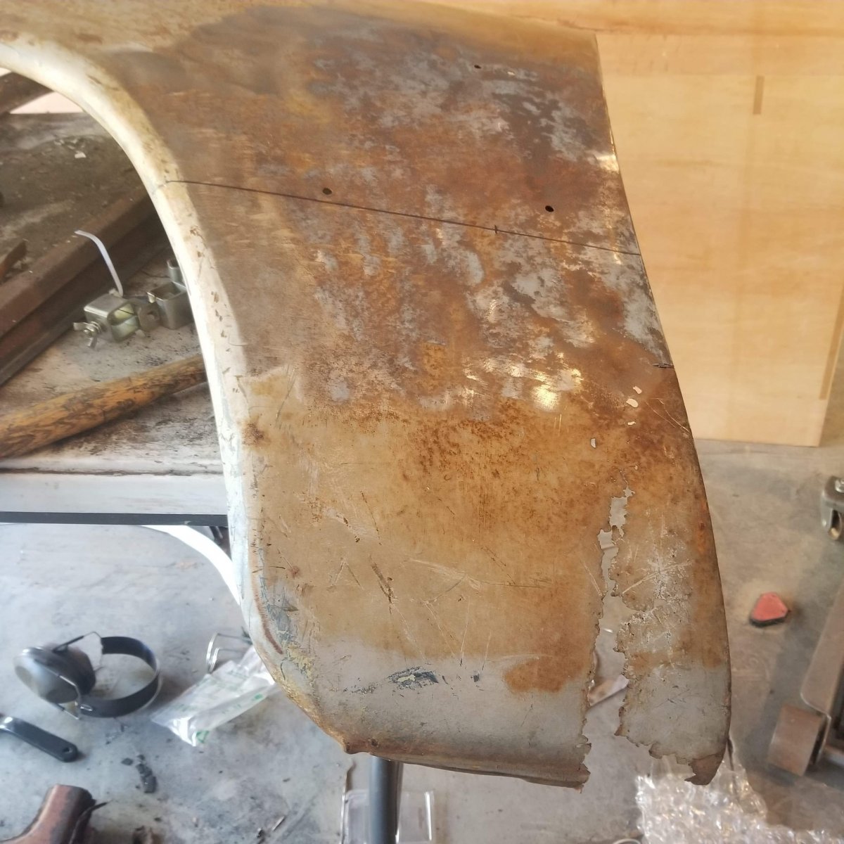

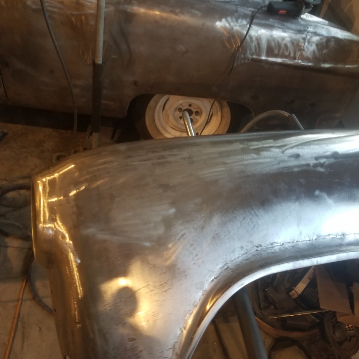

    Took a break from working on the chop to work on the drivers fender. Also working on grafting the 52-54 fender flares onto my fender
    B0BD7E3B-DDD1-4450-96CD-C216F7F44177.jpeg 54BDCAAC-FFBF-4586-B084-6A7A1D163A0A.jpeg 430F523F-62E7-42AF-9A54-A050A176B0DE.jpeg 93839CD5-40D1-459F-9F25-29635150F601.jpeg 76C76F16-7B9D-495C-97C6-F4573FC0790E.jpeg 6C31E710-E33A-496F-B261-967D418C05CE.jpeg FC03FF49-C750-413F-94A4-C015E0056F6C.jpeg 6860B3D1-7B70-4030-8E38-19ED1DA2CE34.jpeg

  22. brEad
    Joined: Dec 23, 2016
    Posts: 2,039
    brEad
    Those flares will look great!

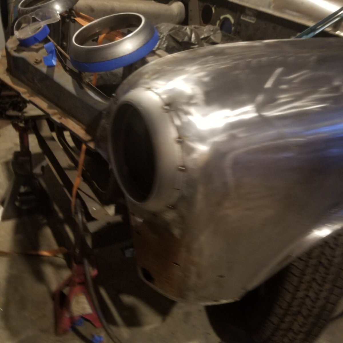

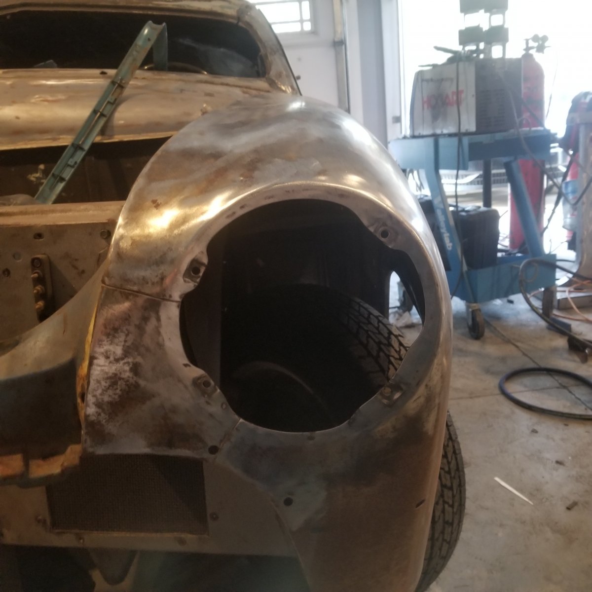

    Well...I'm finally back to work on my 51.

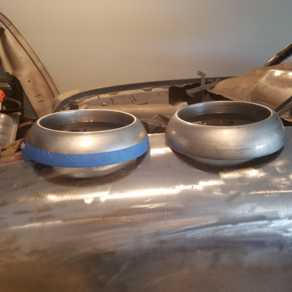

    since I last posted I have finished welding on the fender flares and frenched the head lights. 20200409_185618.jpg
    the new headlight rings were to think and gave the car a bug eyed look so I cut about an Inch out of them
    20200409_191237.jpg 20200409_200543.jpg 20200410_192005.jpg 20200410_191945.jpg

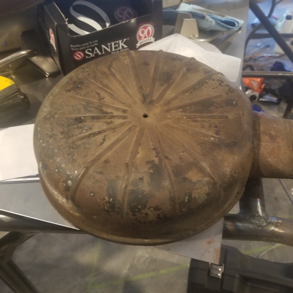

    got some parts in.
    new hubcaps for the front, rear air back, shoebox central camber adjustment plates
    Rebel wiring harness
    new radiator
    front dominator bags
    air cleaner from a 58 impala
    I also go my shaved door handle and trunk kit, plus a set of universal suicide door hinges and some bear claw latches. Plus led rear tail lights, some cal custom valve covers, a set of peep mirrors and some fender skirts, along with a few other things

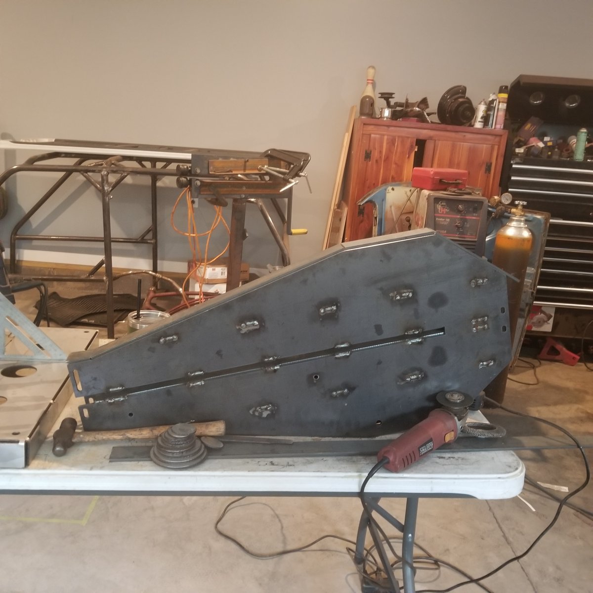

    I've also been building my own bead roller with a 36" throat depth. the body is made from 1/4" plate, the stand is made from 1/8" stainless
    It isn't complete yet. I still have to machine the shaft guides and order the spur gears. And finish weld the stand and add some adjustable foot pegs.

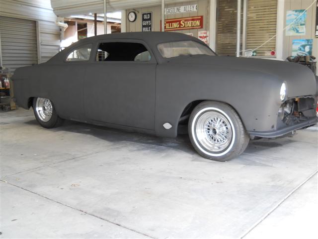

    A few shot from when I rolled her outside so I could clean up the garage
    20200517_110739 (1).jpg 20200517_110750.jpg 20200517_110811 (1).jpg 20200517_110829.jpg
