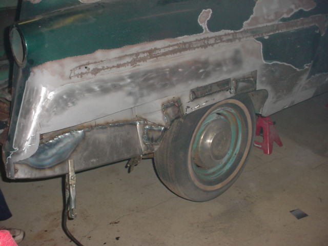

    This car has been in the family since it was new,,
    here are a few pictures of what got accomplished today after
    sandblasting...UGH!

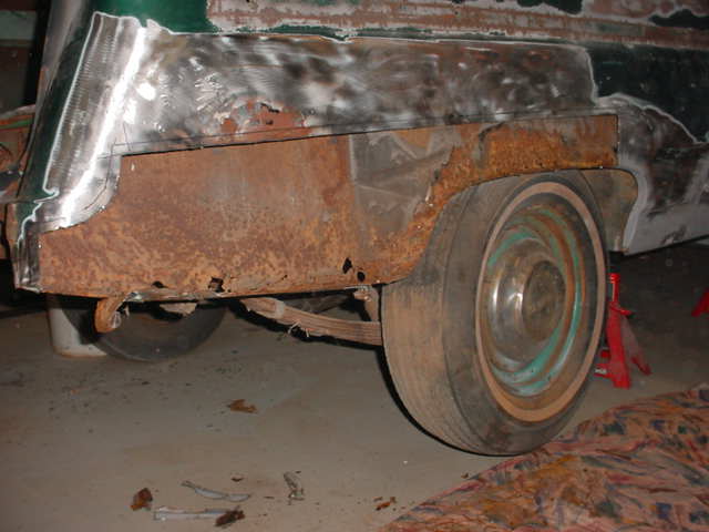

    and another

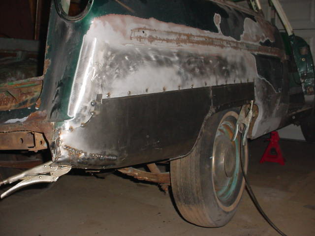

    wheel lip had to be made,,,,that took a lotta strechin' and twisting to get the shape correct.

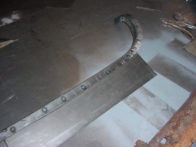

    tacked in place.

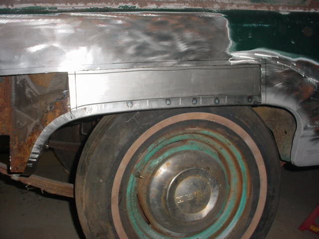

    a new inner panel was formed with a hammer and a few choice words.

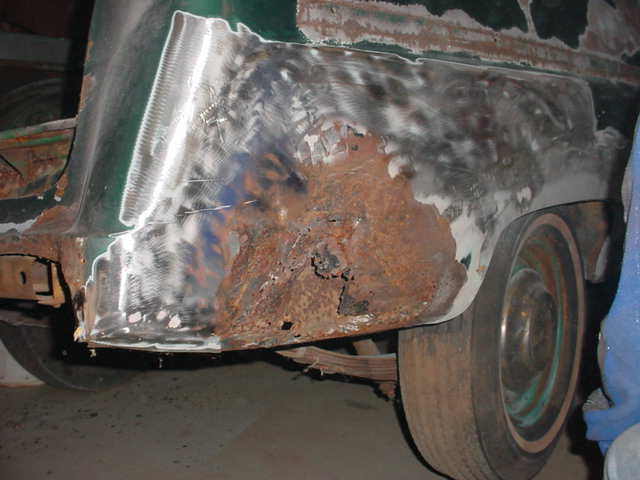

    this is the picture that makes it worth all the hard work,,,,My son-in-law even learned how to use a mig this weekend,, [​IMG] HRP

    wow thats impressive for a days work! How did you make that wheel lip? Outta a straight length of 90 degree bent stock? Looks great!

    Thanks,,,the curved piece for the wheel well was formed using a Eastwood tool,,,a hand operated shrinker/strecher....it takes a lotta effort but it works.
    the metal is 20 guage and using the strecher side of the tool makes the metal curve one way and the shrinker side of the tool pulls the metal the other....
    This is not the work of a trained body men,,,just a couple of ol' greybeards and my son-in-law trying to bring a family member back from the dead........did I hear a groan? [​IMG] [​IMG]HRP

    I will have to bow the next time I see you... that is a lot of work for one weekend.. When I say the pic of the quarter panel cut out.. I said Holly Shit that is never going back together without a replacement quarter.. Damn nice job...
