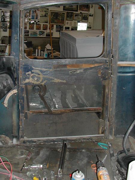

    Just to show that I ain't been slackin lately here are some pics of what I have been up too.
    First is the reason why no one screws around with old chevy trucks. Everything you see on the inside of the door here is wood! The skins are held on by a bunch of little finish nails. I am repalcing all of the nails with stainless screws. The old nails were starting to pull out. I am replacing most of the screws with stainless ones too. I don't know what they treated wood with back then, but it works! The wood is in good shape but some of the screws have rusted the threads off and started pulling out. I was lucky to find this truck in this good of shape. If the wood was gone I'd be messing with a ford too. Lukester eat your heart out!

    I have also been doing a little body work. I pretty much have the ass end done and in primer. It needs touched up here and there but I will screw with that after I get the cab in primer too.
    There is no support on the back of the door skins so I am PORing the back side and I am going to go ahead and get my insulation and stuff on there. I also have some epoxy paint that I am going to seal all the wood up with. I figure I need to do this first because anything I do the the back side will show up on the bodywork on the outside.

    On the wood, DON'T attempt to seal it up completely, because it needs to "breathe" somewhere or it will dry rot. It will gt moisture in and out of it no matter how hard you try to seal it and if the moisture has no way to get out it will rot much faster than if you left it bare.
    Witness a picket fence, painted white on both sides doesn't last nearly as long as the wood frame house siding that's only painted on the outside and allowed to breathe on the inside.
    I only varnish the top side of my truck bed for this reason and have no rot problems and it's been over a decade with the rear tires throwing everything on the road on the bottom side of the bare wood.

    Dr J, that is good to know. Perhaps I need to reconsider my plan.
