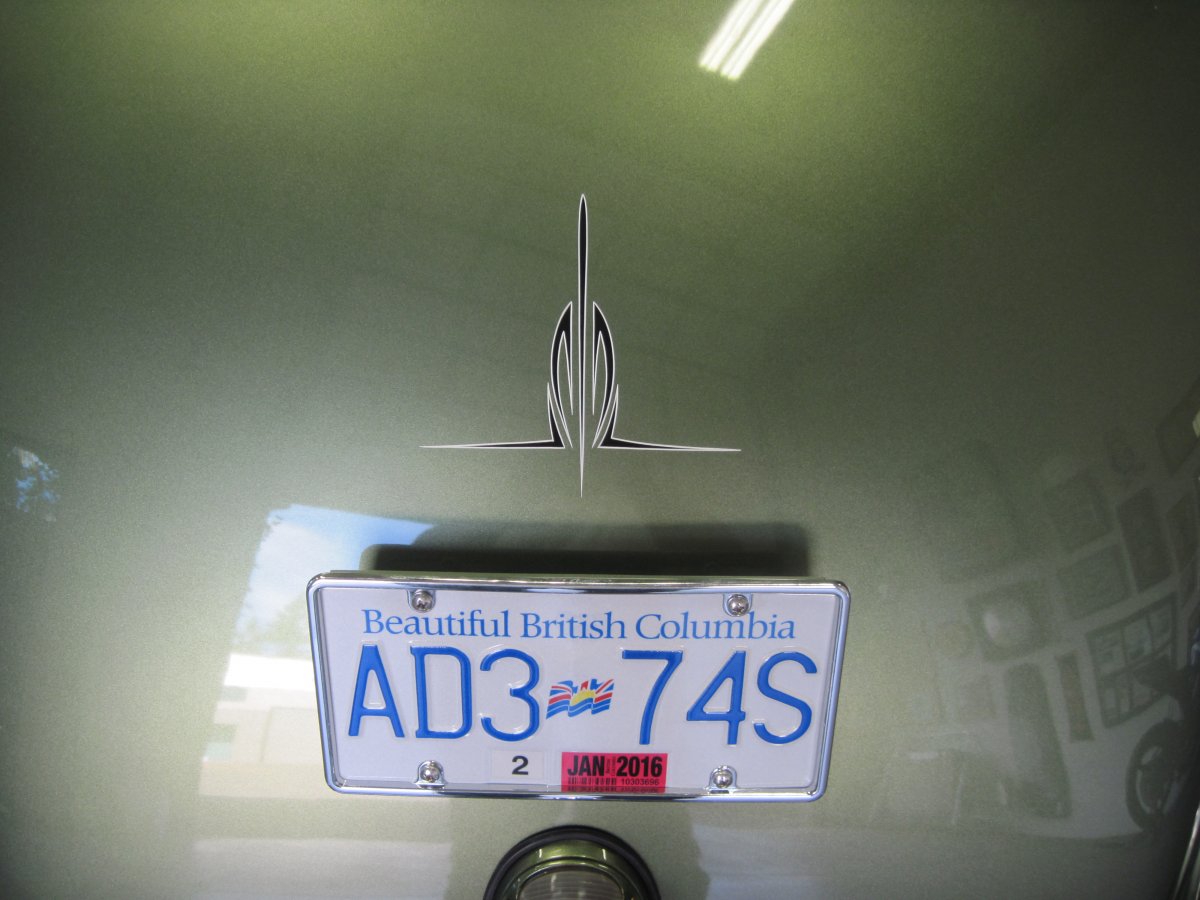

    Just trailered my avatar 39 down to Portland for Mitch to do his magic........att'd pic shows rear trunk lid masterpiece applied, a****st others........my only request to Mitch was "do it like it was your own car, including colors".......he did just the right amount & colors to enhance the finished car.......it's a real pleasure to spend the day in his studio and watch him free-hand lines...........
