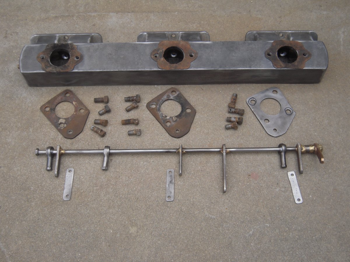

    wmd14.JPG wmd16.JPG How come things take three times longer than you think they will? Multi-tasking is part of it. But two weeks ago I said I would show you some rare Wayne Chevy 12-port parts, so here goes.
    This project started with the engine, which I got nearly 30 years ago. I'm pretty sure the owner's name was Earl Haskins, and he had it in a track roadster in the late '40s. He was from that group (Knight Riders) who had the Hallock-windshield roadsters in Fullerton. I got it from his widow, who had it in a garden shed (with the roadster) in her backyard. She didn't know details, but they had thrown a rod (I have pieces) and put a flathead V8 in the roadster.
    But they had gathered all the parts to rebuild the Chevy. It had a new '48 Hi-Torque block, fully drilled and polished pressure-oil crank, new GMC rods, new JE pistons with hand-cut domes, what I thought was a Spalding cam, Buick straight-8 rocker arms, Wayne sprint-style headers, finned valve and side covers, and a Wayne intake with three Stromberg BXOV-2 carbs with crude home-made linkage. The cast-iron head was bare, and had lots of brazing around the outside (no cracks in deck, chambers, or ports). The very early head and covers say "WMD 225." This stands for Western Mechanical Design, Wayne Horning's original company. With steel billet #2 & 3 main caps, aluminum rocker pedestals, and parts of a dual-coil Nash ignition, this six had all the good parts, identical to the Spaldings when they ran 3 carbs (HRM cover, Feb '50).
    After storing all this for years, I decided to ***emble it, since everything was "new," to see if I could sell it. I gathered new rings, bearings, Cadillac flathead V8 NOS valves, NOS chilled iron lifters, gaskets, etc. With absolutely no interest from anyone in buying it, and my Iacono dragster finally getting done, I decided to build the Spalding Bros. car around it. Yes.
    I started by taking the head to Bob McKray to pressure test, fix any external cracks, install the Cad valves, and do his usual thing. You see photos.

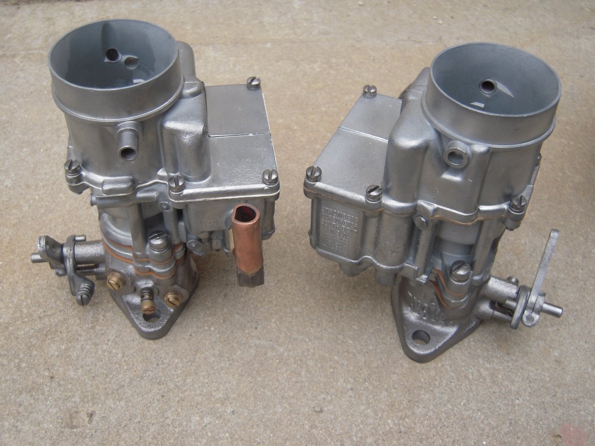

    I should have taken a "before" photo of the carbs/intake. But Tom Taros (former Ike dragster owner) did a beautiful job rebuilding and rejetting the carbs for alcohol, and I am making new mounting plates and linkage with Hilborn parts.
    Next I took my cam to Isky's to have Ron check its specs, and it turned out to be who-knows-what with .225 lift and less duration. Ed thought there were none of these forged steel blanks left, but found a case the next day and Ron made the cam with a Z-25 grind. Thankfully I found the now-rare chilled-iron lifters it needs, along with new Zoom gears.
    Meanwhile McKray and I decided if I'm going to build and run this thing (I've joined WRA), we'd better put some better forged pistons in it, so they are on order now at Ross. You see one of the cast, full-skirt JEs in one photo.
    T wmd01.JPG wmd03.JPG wmd05.JPG wmd06.JPG wmd07.JPG wmd09.JPG wmd10.JPG he front cover I had cast from an original when I made the one for the Iacono GMC. I machined it myself as well as hand-cut all the gaskets you see, other than the custom head gasket. I've also acquired two Nash 12-plug, dual point distributors, but haven't decided how to make a Spalding-type ignition yet.
    I think that covers the following photos. Next stop is the chrome/polishing shop. Ask if you have questions.
    Cheers, Pat

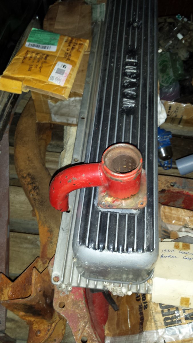

    Sorry to hijack this thread, but where else would 12 port guys go to wett their appe***e.
    As you can see, this valve cover has only one breather/filler hole.
    Might it be a 1st generation Wayne cover, post the WMD 225 period?
