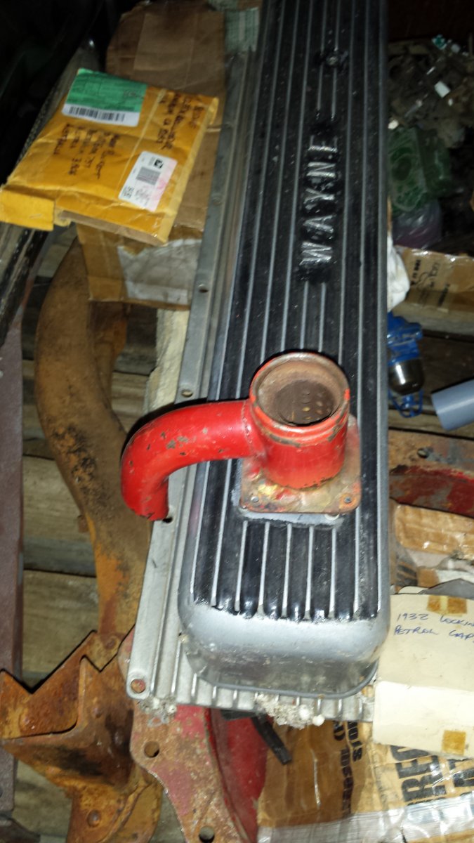

    There has been nothing--that I know of--that I would call "definitive" in the way of information or history of Wayne 12-port heads and related parts. Frank Oddo did a "Wayne 12-Port Head Story" in the Nov. '76 Street Rodder, and there have been similar--though rare--pieces in Inliners International's 12-Port News, but none that were much more than superficial, or even wholly accurate. One problem stems from updates/variations in parts during their short production life. Another big one is the split between Wayne Horning and Harry Warner, with Wayne making "Horning" heads and Warner making "Wayne" heads. This of course was followed by California Bill Fisher's acquiring the Horning GMC head (with 2-piece valve cover), and naming it the Fisher head. Plus there was a Howard GMC 12-port, and others. Someone like Keith Young might be able to put together a good lineage/history of early Wayne 12-ports. But the original principals are gone, other memories are old, and written records seem to be non-existent. In my case I figure you use what you've got, keep it as original as possible (or practical), and make it work as best you can.
    Pat G.

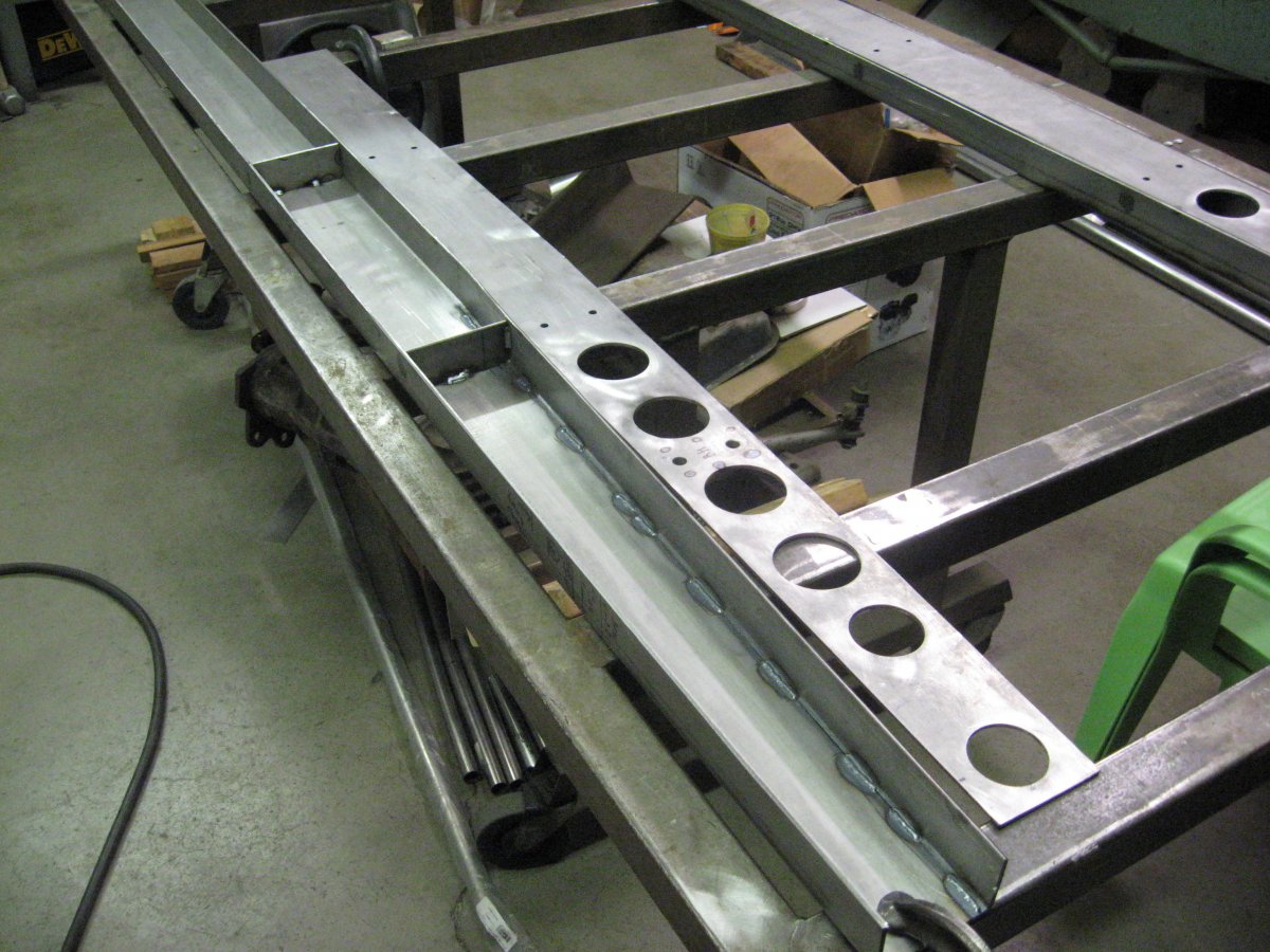

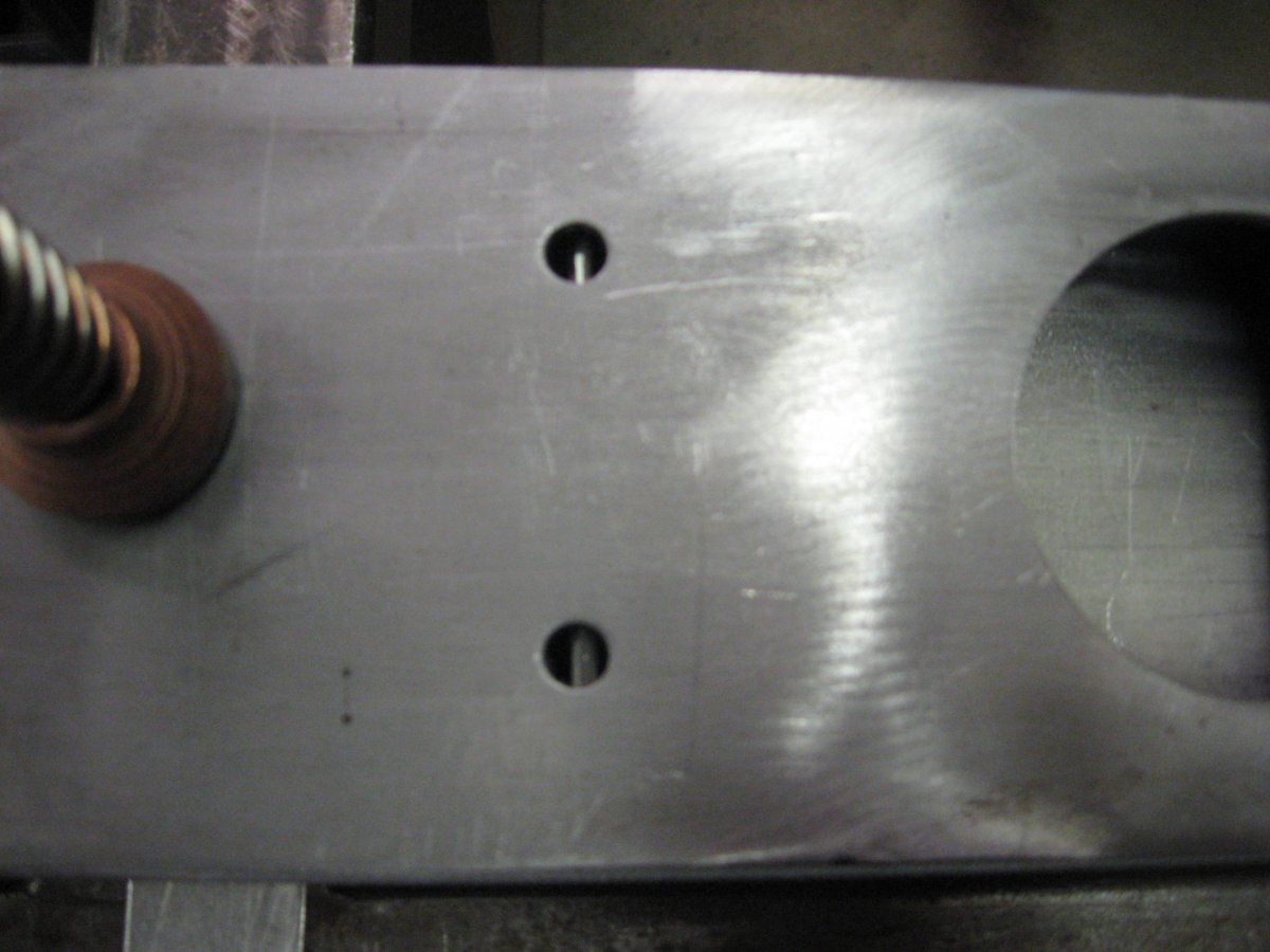

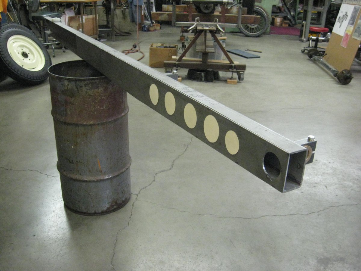

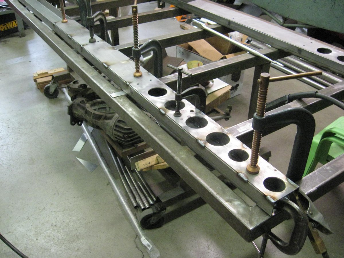

    Well, it's been a month since I have had anything to post, haven't felt too well for the last 3 weeks. After finalizing the engine location, the next thing was to layout the lightning holes and the support plates for the front engine mount. I also welded vertical plate gussets in the area of the rear torsion bar anchors, and bell housing mounts, so as to plug weld them to the boxing plate, making those areas as rigid as possible. IMG_6667.JPG IMG_6668.JPG IMG_6671.JPG IMG_6677.JPG IMG_6679.JPG IMG_6681.JPG

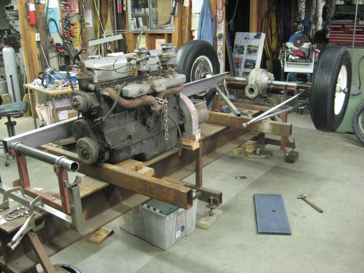

    Tearing the frame apart was a necessary decision, as it was the only way that I could weld and straighten the tapered front section of the frame rails. I skip-welded them on the inside, beveled and fully welded the outside. Then came the straightening of the front section in a press, as it curled to the inside. Next came the welding of the boxing plates, that put a bow in the rails in the boxed area. I am fortunate to have a Brother with a 70 ton - 10' press brake, we used some wood blocks and carefully straightened both rails. I then ground and finished the rails, before re***embly. Now I can proceed with the installation of the rear & center crossmembers, and install the engine mounts, along with the re-attachment of the torsion bar mounts. The steering box was shipped back to Schroeder for final ***embly, when it returns I can make the mount at the dash and build the firewall. Good things to come ! IMG_6688.JPG IMG_6690.JPG IMG_6692.JPG IMG_6693.JPG IMG_6695.JPG IMG_6696.JPG

    Sorry to hear you were under the weather,, 3 weeks is a long time when one feels out of sorts. Hope all is well now,, judging from the pictures you are back up to speed.
    Sure looks as tho you are healed. Progress is evident,, and so is the quality of your work.

    I built the transmission crossmember today, starting by machining a pair of aluminum spacers and some capped sleeves. The lower hoop is 1" X 1.20 wall tube, bent to a 4" center line radius. It was handy to have the rear mount and "clam shells" on the table, for fitment. After installing the mount ***y on the back of the transmission, I sheared a 1" strip of thin aluminum to make a template to match the angles and fit around the sleeves, it makes it simple to get it right the first time. With the triangle flanges on inside and outside, it should support the area well, and provide a place to weld a threaded bosses for the rear radius rod attaching points on the outboard side. With this complete, I will fab and install the mid-mounts at the bellhousing, and on to the front straddle mount. IMG_6697.JPG IMG_6699.JPG IMG_6700.JPG IMG_6702.JPG IMG_6704.JPG IMG_6705.JPG IMG_6706.JPG IMG_6707.JPG IMG_6708.JPG IMG_6709.JPG

    I am still alive, and have been working on our project. Right after my last post, my computer ****ped out, and I was unable to keep you up on the progress. I cut out and welded the gussets in the rear radius rods, and bolted them to the rails. I also sawed out some 3/8" aluminum plates for the mid-mounts. More to follow. IMG_6710.JPG IMG_6711.JPG IMG_6714.JPG IMG_6715.JPG IMG_6718.JPG IMG_6719.JPG

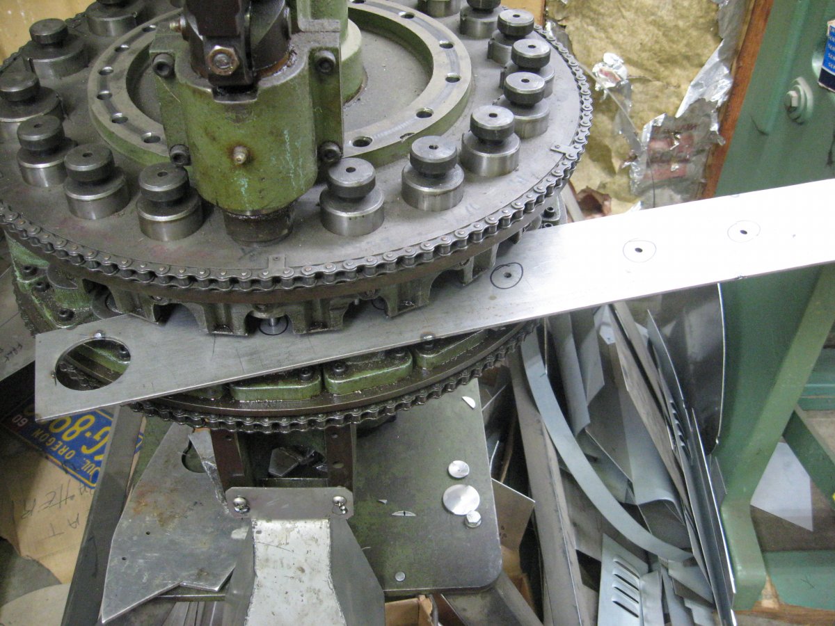

  26. falcongeorge
    Joined: Aug 26, 2010
    Posts: 18,339
    falcongeorge
    from BC
    Nice turret punch, Marty. Man you have some nice equipment.
