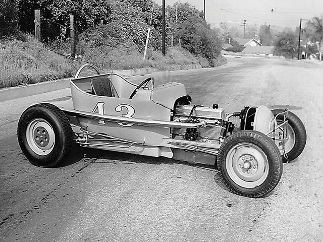

    Gary, I was waiting for someone to notice, my money was on you ! Here is the contrast, for folks to see the difference. IMG_5313.JPG IMG_5315.JPG

    I took this picture a couple of months ago, thinking I would send it to Pat, and let him know it's not too late to put a Flathead in it. My thinking was it would be the Harold White version of the car. But I chickened out. IMG_5613.JPG Spaulding.jpg

    Thanks for the great pictures, especially the color one. You are spot on, about trying to capture the elements of a "center steered" race car for the street, setting on the left changes everything.

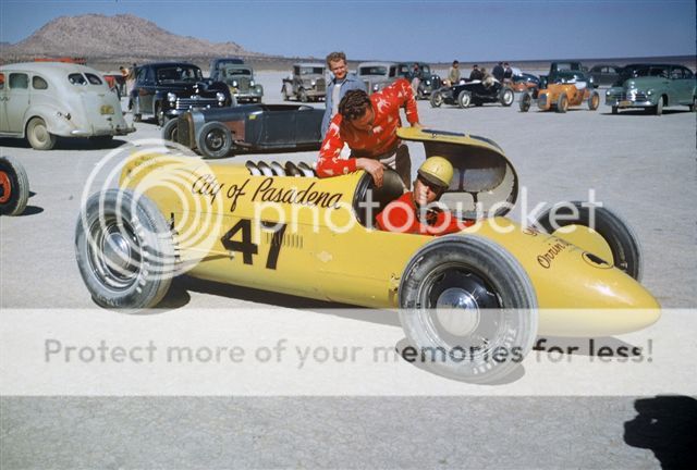

    Now I'm really s****ing the bottom of my picture barrel. If you look hard and squint a bit, I'm sure that's it in the background. At least it's in colour. You're definitely the man for the job, Marty.

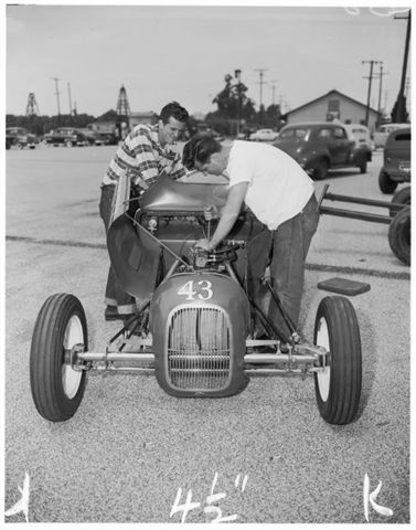

  20. Very exiting build ! I have been a fan of that car since I bought the track roadster issue of R&C back in 1973. Go Marty Go!
    Here are a couple of pics of Pat with his dragster I took at the Antique Nats.

    Kev, you are correct about that issue of R&C, it's very informative, I wish Grey was still alive to follow us along. I think it would bring him joy, he was a track roadster fanatic. Thanks again for the Auto Butchers plaque.
  25. Marty Strode
    Joined: Apr 28, 2011
    Posts: 9,682
    Marty Strode
    Great picture, it must have been taken the same day as the bottom shot in my lead off photos, notice the Fleetline Aero Sedan in both pics? Do you suppose that was their push car ?

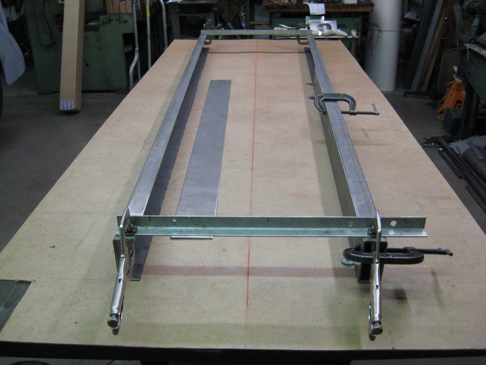

    This is the start of the frame rails, after reading Grey's article in the '73 R&C, Tom Spalding admitted having the frame rails formed up, instead of using OEM rails as the CRA rules required. He copied Willys frame channels. I picked up a sheet of 10 guage (.134 thickness) hot rolled, pickled and oiled steel sheet. My Brother Jerry sheared it down to size for the channel and boxing plate strips. My next stop, was was to my old racing buddy Gerry Grossen's shop, to have him form up the channels on his monster press brake, it sure makes it handy to have relatives and friends with big machinery ! I then, made a layout on a sheet of paneling, to dictate the width of the rails front and back. More tomorrow ! IMG_3543.JPG IMG_3544.JPG IMG_3549.JPG IMG_5433.JPG IMG_5434.JPG IMG_5435.JPG
