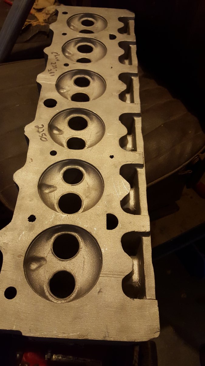

    Pat, do you think that Bob McKray could work his magic on this head - it's mine?

    I'm not very good at operating this site. I hope this is a personal message. But I called Bob McKray this morning and described your head casting to him. His reply was "Only if he has open-ended expense and time." Bob is a pretty good machinist. But he's an engine builder. And what you need with this very bare casting is a very good machinist. The one possibility I can think of might be Mike Kirby at Kay Sissel's. But I really don't know if he can do this sort of thing. I would strongly suggest that you find a good machinist near you. But I've never seen this type of head layout for a 235/261 Chev. What is it? Who made it? Has anyone machined a finished head from one of these castings? The machinist needs to know things like where exactly the water jacket is, and where the spark plug holes need to go.
    Good luck!
