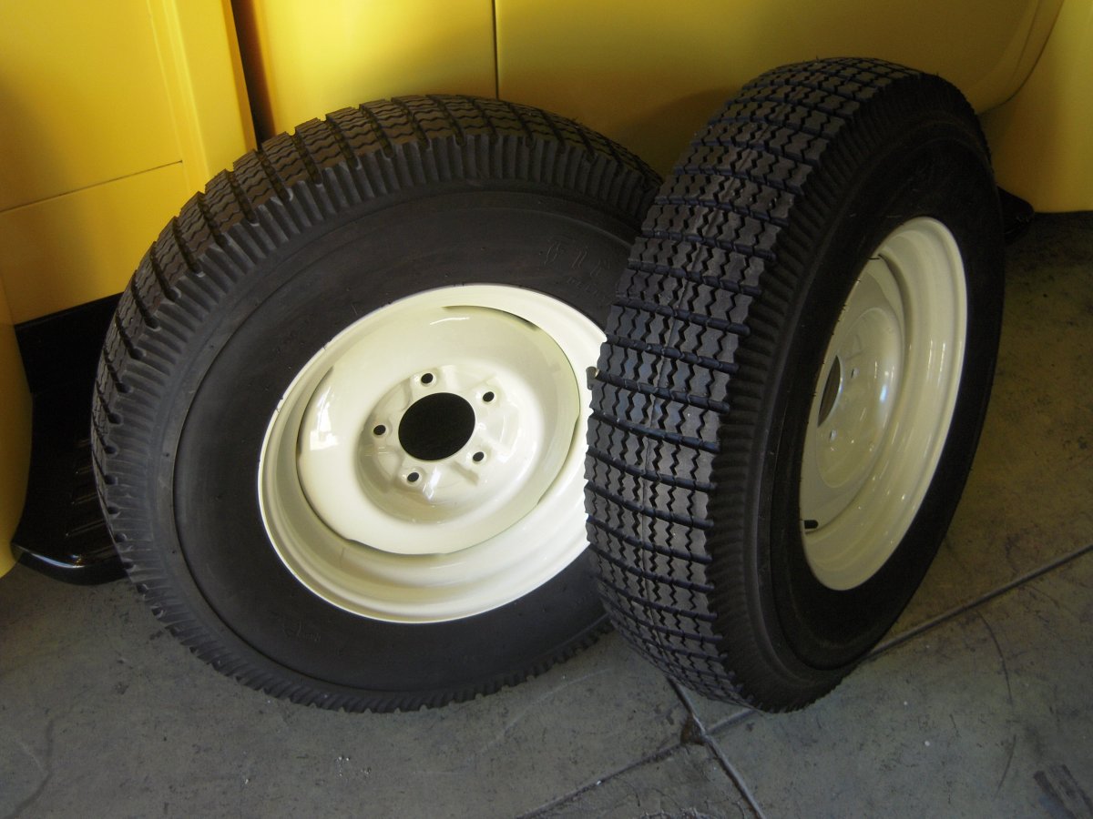

    The front wheels and tires are already on the car, at Marty's. For the rear, the original car had Firestone 7.00-16 "Grooved" dirt tires (blockers) on Lincoln rims. So I got a set of Coker's 7.00-16 Firestones and mounted them on Wheelsmith custom rims. What I want to do is groove these tires horizontally, perpendicular to the tread, to make them look as much like the blockers as possible. So far I haven't found anybody with a grooving tool that will work.
    Thanks,

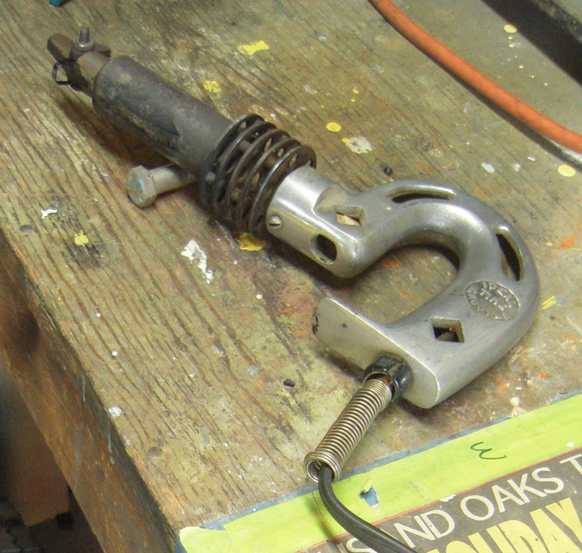

    First I did a whole lot of calling to find anyone who had a tire groover. If you need anything for a vintage circle track car, the first person to call is Glenn Necessary (661-714-3854). He's already supplied a few things for this project. Unfortunately the fancy German groover he loaned me didn't work at all, just like the similar one Rich Hart had. DSCN0016.JPG DSCN0017.JPG DSCN0022.JPG
    However, long-time midget racer and collector (and former Cyclone Header and Autobooks owner, etc.) Chet Knox said he thought he had a couple old ones, if he could just find them amidst his several garages full of neat old stuff (wanna buy a complete Offy engine in a gl*** case? He has one for sale). Well we spent a couple hours looking, but finally found them. They look like they were made in the '20s, but one had a few different "snouts" and lots of different size/shape cutting blades. And they worked--much like a very old soldering iron.

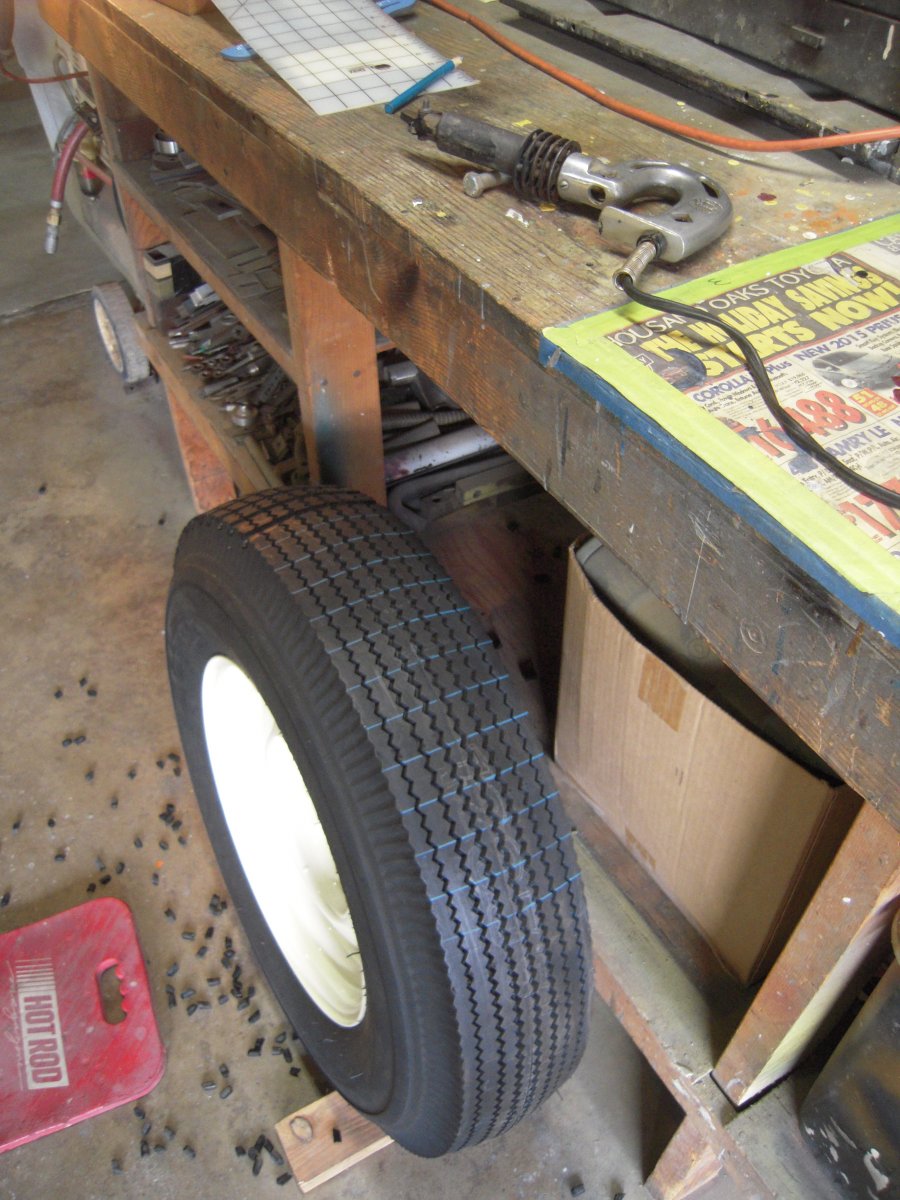

    Fortunately I had gotten a used tire for testing and practicing. I used that to decide what size and shape cutter to use, and how deep to set it.
    Next I had to figure how to measure and mark a pattern. By the second tire I discovered a light blue China marker (grease pencil) worked the best on black rubber, and I stole a wide, pliable ruler from my wife's sewing cabinet.
    These groovers don't cut like a hot knife through ****er; more like a dull blade through hard rubber. With plenty of sweat. Each tire took more than a day to layout and cut.
    Looking at the photos, you might think they look more like snow tires than dirt trackers. But they look pretty good in person. I'm happy with how they turned out. And it's as close as I'm going to get to a usable set of dirt-slinging blockers.

    When I used to do a lot of re-grooving, I would resharpen the blades with a very fine cut needle file to keep that good razor sharp edge.

    And yes, Pumper, you can see each blade has one razor-sharp edge--it has to be installed the right way. And they must wear out, because the groovers came with small packets containing not only different sizes and shapes, but many (new ones) of each. The one I used stayed sharp through this job. Best part is I just convinced Chet to sell me these two old groovers, and all the extra blades and accessories for next time.

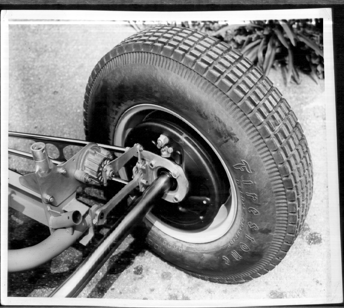

  28. Gofannon
    Joined: Feb 8, 2007
    Posts: 996
    Gofannon
    I can see the word "grooved" on the sidewall in this pic. They were made that way.
    1947knuck, volvobrynk and Drewfus like this.
