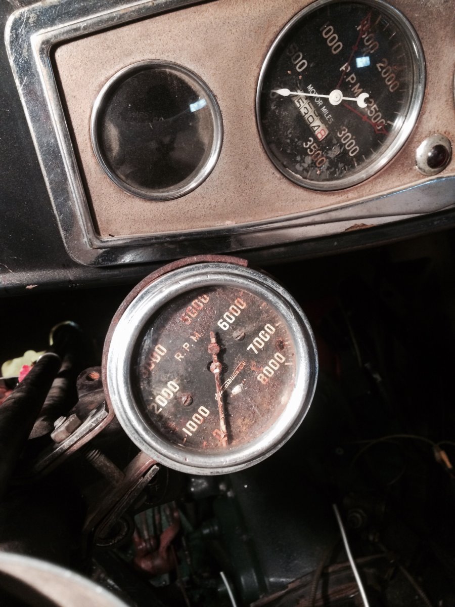

  9. image.jpg image.jpg Hello Marty,
    I have the same tach as the original car. I'm not sure if you have one but I can measure mine if you need and exact size. Sorry I haven't read all the pages on the build but I'm starting now. Just wanted to throw it at yea in case you need the size. Mines going into my roadster. By any chance do you know what year the tach was made???
    1947knuck and loudbang like this.

    I think Pat has a 5,000 RPM tach for now, perhaps down the road he will find the correct one, but as he says, "it's not a restoration of the original". Welcome Aboard !

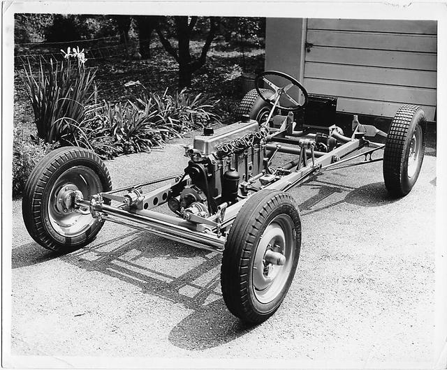

    Looking good makes me want to build one. Questions could you have run the front bars inside the frame rails, or did you need the with. I am following with great interest Have you got plans? Thanks Frank

    It would have been easy to have installed the bars inside the rails, I did one like that 40 years ago. This had to be like the original. Spalding 2.jpeg
