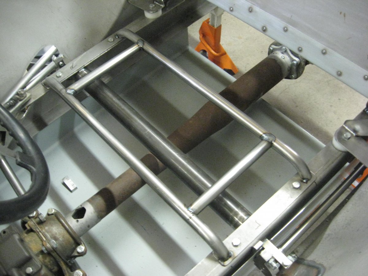

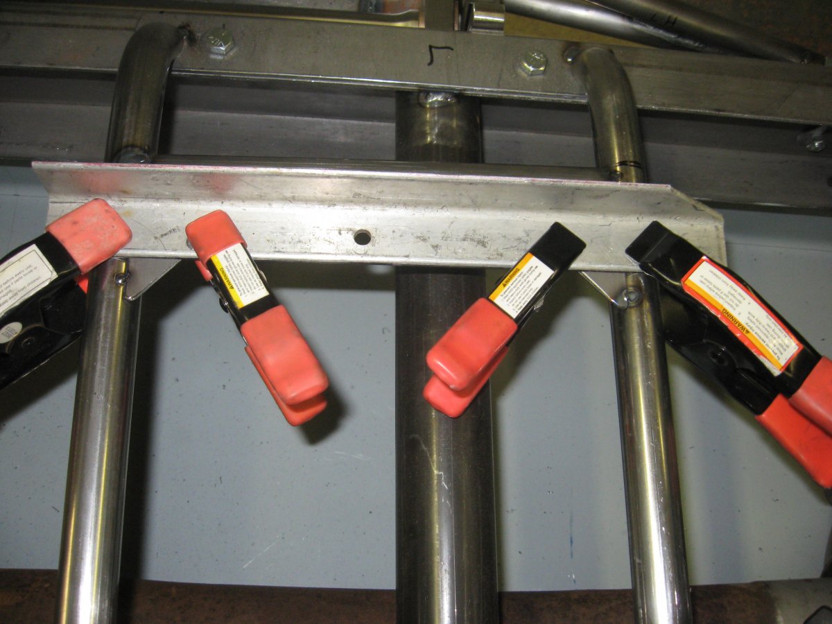

    Today, I cut, sleeved, drilled, and tack welded the roll bar in place. Next will come the gussets on the lower sleeves, and fab the mountings for the rear shocks and the rear bumper receptacles. IMG_7277.JPG IMG_7283.JPG IMG_7279.JPG IMG_7285.JPG IMG_7281.JPG IMG_7286.JPG IMG_7282.JPG

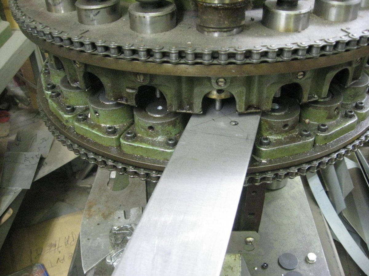

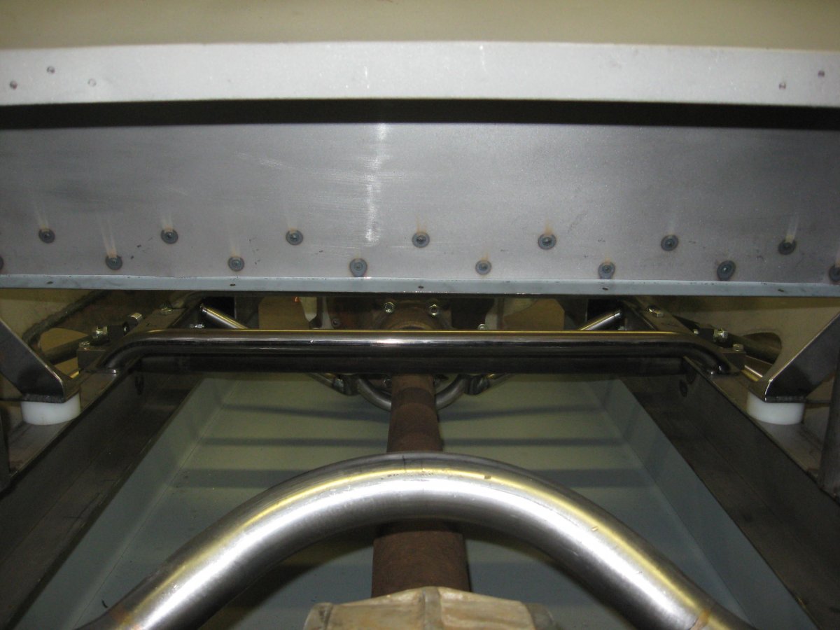

    While getting ready to gusset the roll bar stanchions, and before removing the turtle deck for better access, it was time to reinforce the rear body panel. Using some 18 ga electro-galvanized sheet, I punched holes for plug welding and formed a 3/4" flange to stiffen it up. I also added some 3/16 holes to the flange, to attach a lower skirt, if needed. It really cleans that area up, along with adding rigidity to the panel. IMG_7287.JPG IMG_7288.JPG IMG_7289.JPG IMG_7290.JPG IMG_7293.JPG

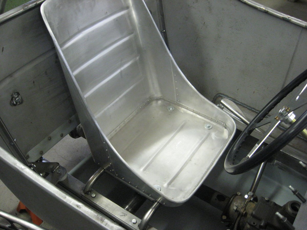

    It's nothing earthshaking, but I completed the seat mounting today. Using a tube notcher, with Kool Mist for cutting and coolant, I coped two 1" tubes. For the mounting tabs, I keep 10 ga P & O steel in strips of various widths, as it makes it simple, to layout, punch, saw, and handle. You also get the benefit of having 2 parallel sides to keep things square, with less grinding. With everything racked, tacked, and drilled, it's finally mounted. That Dennis Webb seat, is a thing of beauty ! IMG_7302.JPG IMG_7305.JPG IMG_7306.JPG IMG_7309.JPG IMG_7310.JPG IMG_7311.JPG IMG_7312.JPG

    I like your turret punch.
  26. alchemy
    Joined: Sep 27, 2002
    Posts: 22,777
    alchemy
    If I had one of those punches think of all the time I'd saved instead of drilling holes. And all the Dr. Pepper I could drink for free by putting the punches in the machine! Marty you are definitely Big Time!

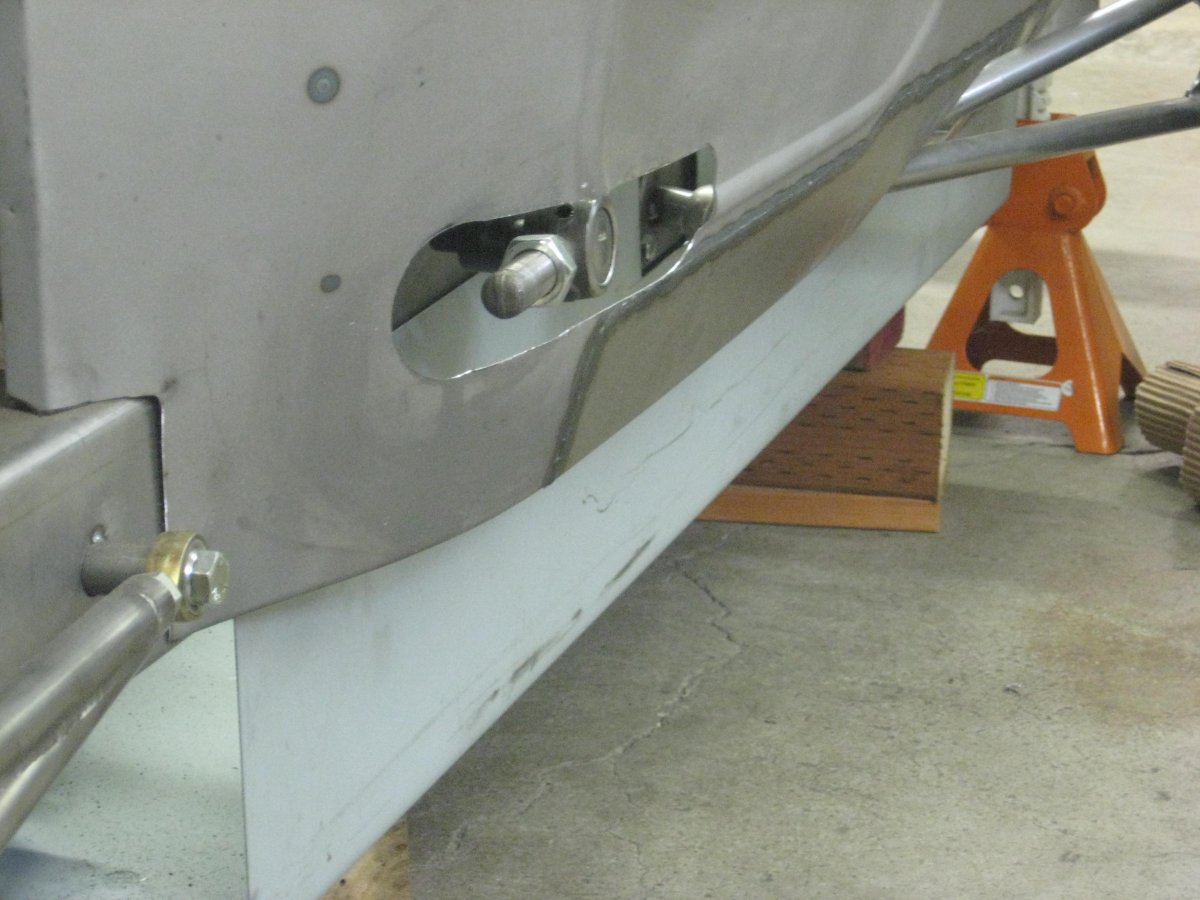

    Another unique feature of the Spalding, was the slot for the pitman arm and drag link to operate. While most had the arm on the outside of the cowl, having the arm on the inside, kept the drag link nicely tucked in. The arm from Schroeder came milled down for lightness, and had a 3/8" hole to fit a small heim joint. The original car used the larger, "truck" tie rods that are 3/4" thread on the shank, and have a 9/16" NF thread for attachment. I welded a .300" boss on the outside, and bored and reamed the taper to fit the "big ones". Next was cutting the slot, it will surely need a little more m***age, when the drag link is completed and installed, but it is a place to start. IMG_7325.JPG IMG_7330.JPG IMG_7332.JPG IMG_7337.JPG IMG_7338.JPG IMG_7339.JPG IMG_7342.JPG

    With all the meticulous attention to detail the creator of the original car did I am a little surprised he did not fab a nacelle to cover up the gash in the side of the body. Certainly he would have been up to the task. He must have had a reason - like easy access to the tie rod end should it need servicing, or the threat of locked-up steering should it take a hit there. For me, "function" will always win out over "form".
  29. gnichols
    Joined: Mar 6, 2008
    Posts: 11,413
    gnichols
    from Tampa, FL
    ^Wrecks? Hard to make oval cars as nice as dragsters or lakes cars, eh? Or keep them that way after the first weekend. Gary
