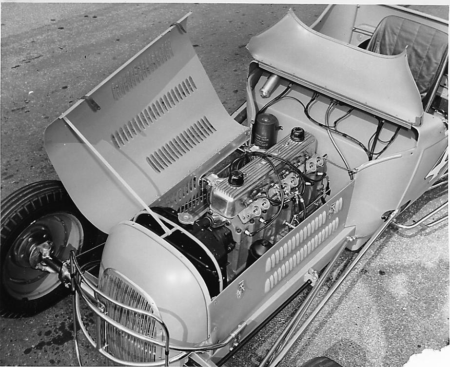

    I have been told, he built around 10 or 12 of these shells and grilles, Barney Navarro's (shown) was quite a bit deeper than the Spalding. Other notables, who used this grille set-up, **** Kraft and the Wes Cooper car. IMG_3909_1.JPG IMG_3911.JPG

    will you be converting the cowl to a hinged panel?
    Although this picture shows injection, this car was initially run with triple carbies, which would suit pat's version for a driveable vehicle.

    Yes, we will be hinging the cowl panel and Pat has carburetors to start with.

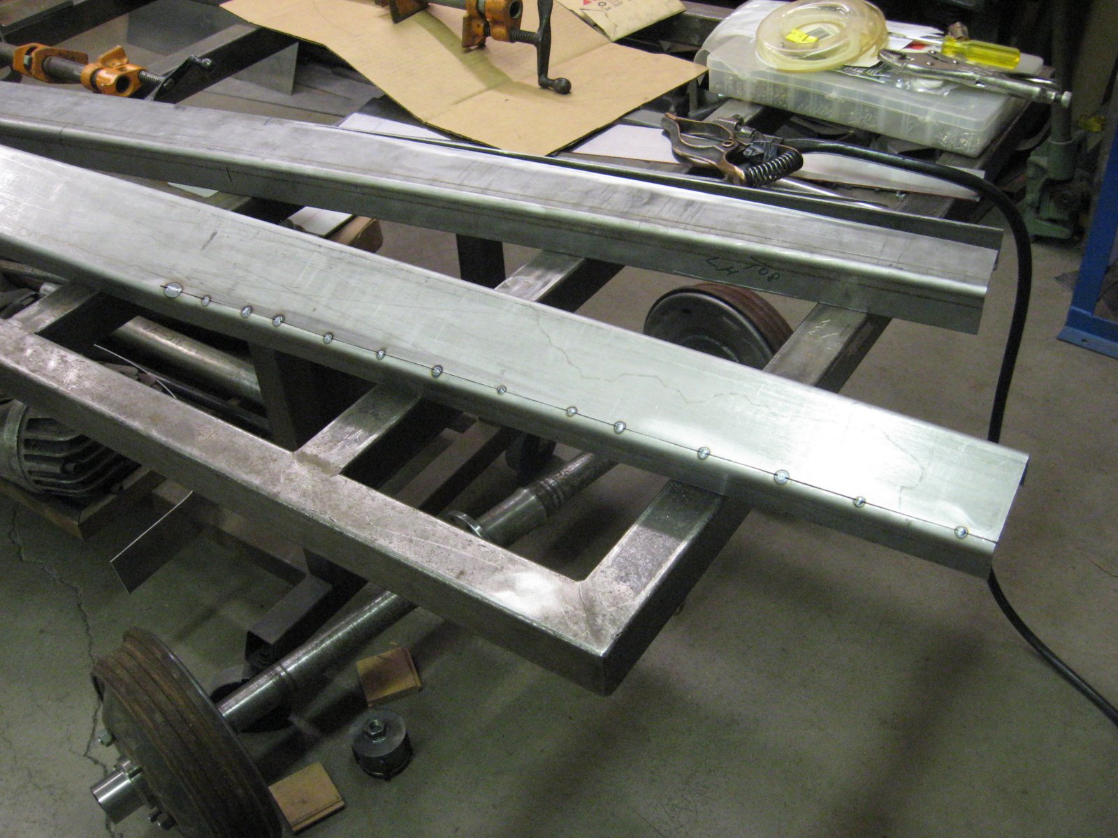

    Tapering the rails, is anyone bored yet ? IMG_5673.JPG IMG_5675.JPG IMG_5678.JPG IMG_5679.JPG IMG_5680.JPG IMG_5683.JPG

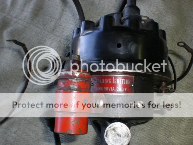

    The Spalding ignitions were, as you most likely know, modified Nash Twin 6 distributors. Knock 3 lobes off the cam, 2 coils and a m***ive dwell angle gives better spark than a mag. I've been putting one together for my GMC. The one I have was an early 30's unit which had the wrong rotation, but I found the advance unit from a standard Delco distributor can be adapted. If you check GMCBubba's posts on converting Delco's to electronic you could then eliminate the points, because the phasing of them is critical and would be hard to reset at the track. By using the Delco advance you can then use a standard off the shelf recurve kit. There is an article around somewhere on the Nash conversion.

    Correction: Spalding Ignition is a Nash cap and rotor on a twin point Delco?

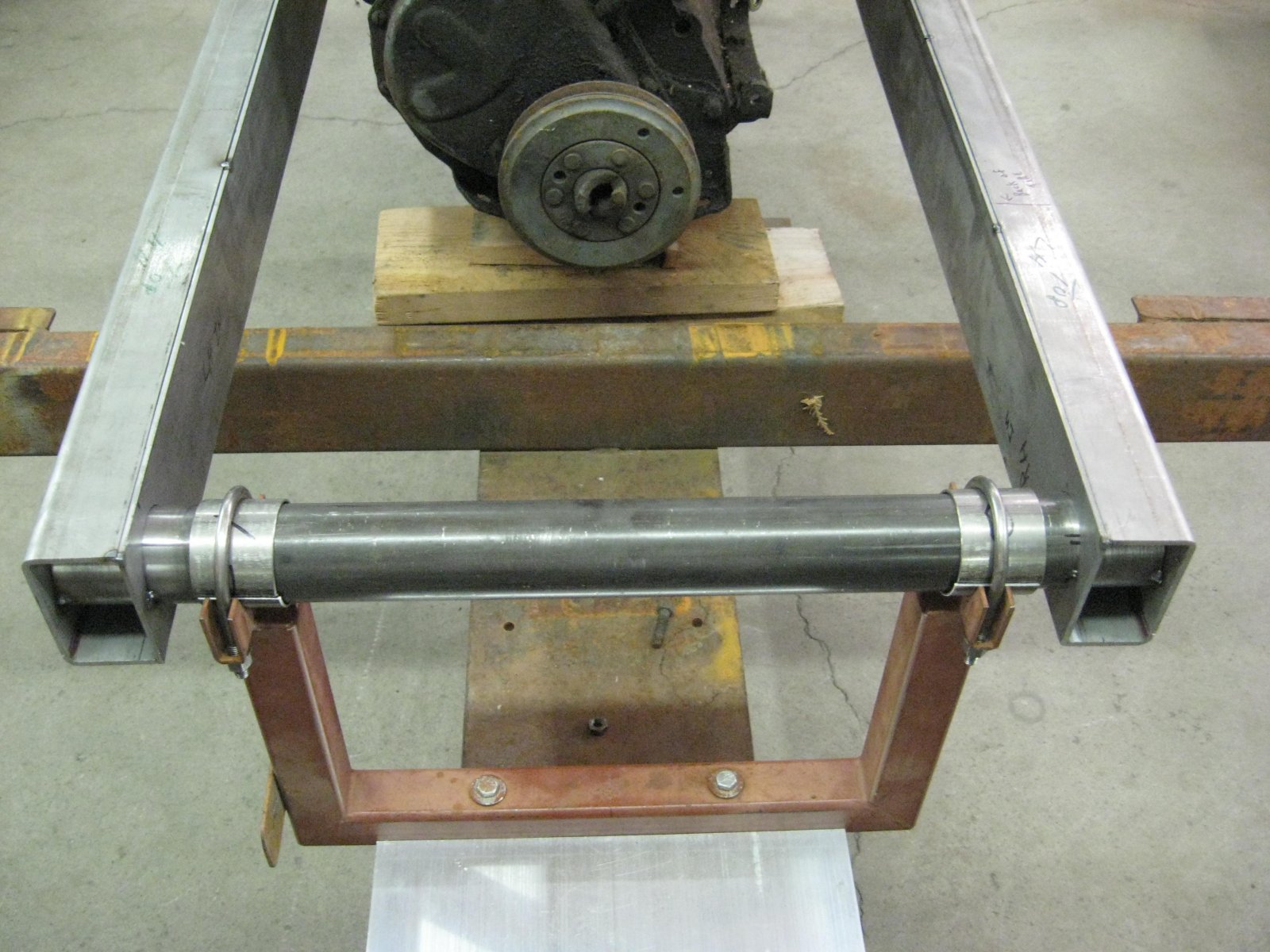

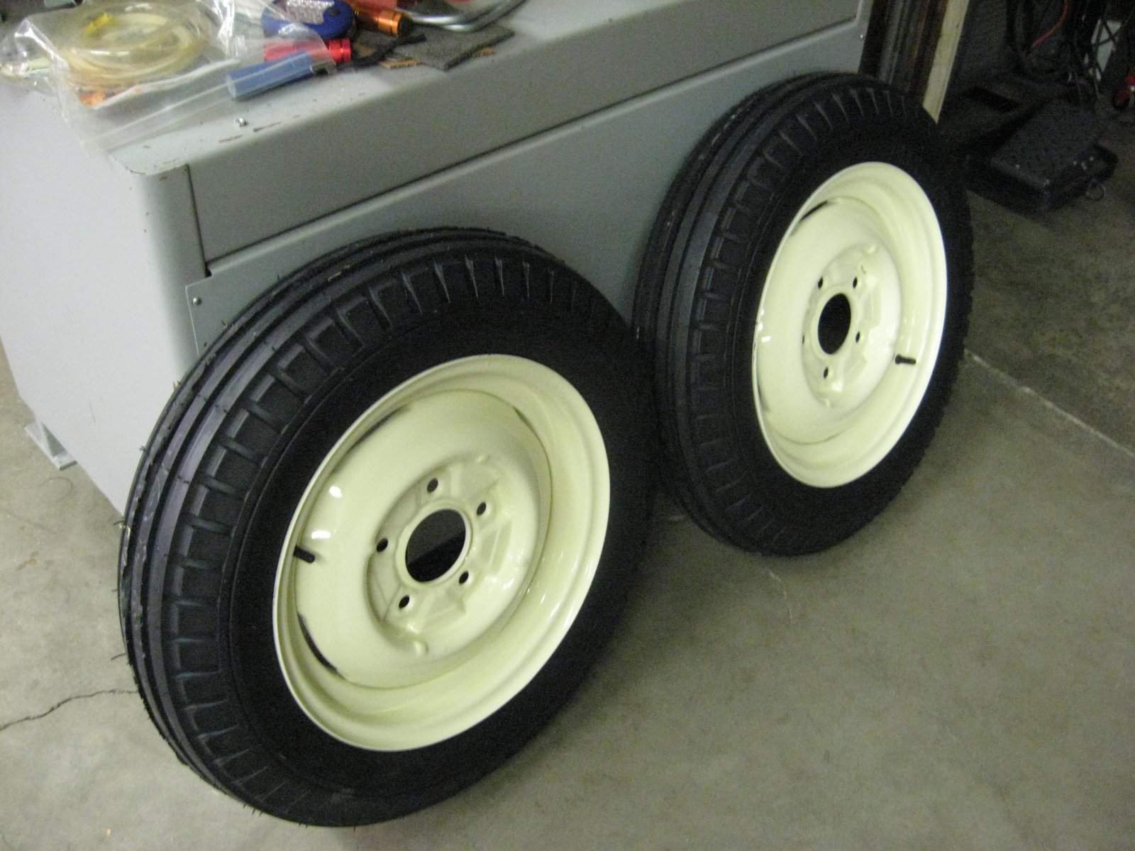

    Alright Mike, you twisted my arm. Now that I established the width, front and rear, it was time to trim the tapers on the boxing plates and fit the front crossmember. Pat ordered some 16" ribbed fronts from Coker Tire, I picked them up at the Portland Swap Meet. He also found a nice pair of 4" wheels and quickly painted them, in time for my friends to haul them back from LARS, it worked out well. Those wheels and tires really stir the enthusiasm. IMG_5691.JPG IMG_5694.JPG IMG_5699.JPG
  27. Marty Strode
    Joined: Apr 28, 2011
    Posts: 9,682
    Marty Strode
    It's now in the ch***is fixture, with the boxing plates and front crossmember tacked together, only temporary. I am juggling the engine for height and set-back. Oh yeah, you never know what I will work on next, the tank belongs to Lonnie Gilbertson, and the Cushman is my Bonneville ride ! IMG_5741.JPG IMG_5742.JPG IMG_5746.JPG IMG_5747.JPG IMG_5735.JPG IMG_5766.JPG
