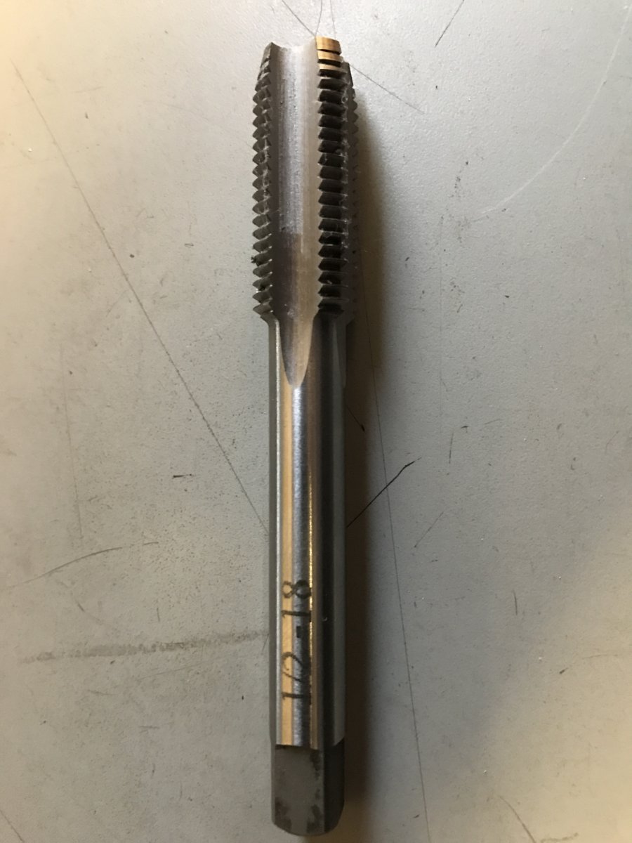

    I am not sure if they all are, but some of the early Ford pedal pads are an NPT thread.(can't remember which size, but maybe 1/4 NPT?)
  5. Marty Strode
    Joined: Apr 28, 2011
    Posts: 9,685
    Marty Strode
    Simon, I tried to screw a 1/4" pipe ****** into a stock pedal ***y and it didn't seem to fit. But after your post, I took a pedal pad and it fit perfect into a 1/4 pipe bushing. Thank you, and thanks for tagging along with us.

    The thread for the Ford Bullseye pads is actually 1/2 - 18
  8. They sure are. I just figured that out about two weeks ago. I want to tap my 32 pedals because I like the looks of the bullseye pads. Iv been looking for the same tap. Where did you find yours please??? I looked through my thread pitch set for cutting threads on my lathe. And found out it was 1/2-18. And of course you can't just go to the local hardware store and pick one up.
  9. Dean Lowe
    Joined: May 20, 2008
    Posts: 22,042
    Dean Lowe
    Try McMaster Carr.

    I checked McMaster Carr first but no luck. I found it on Amazon.com for $13.98, just got it today.

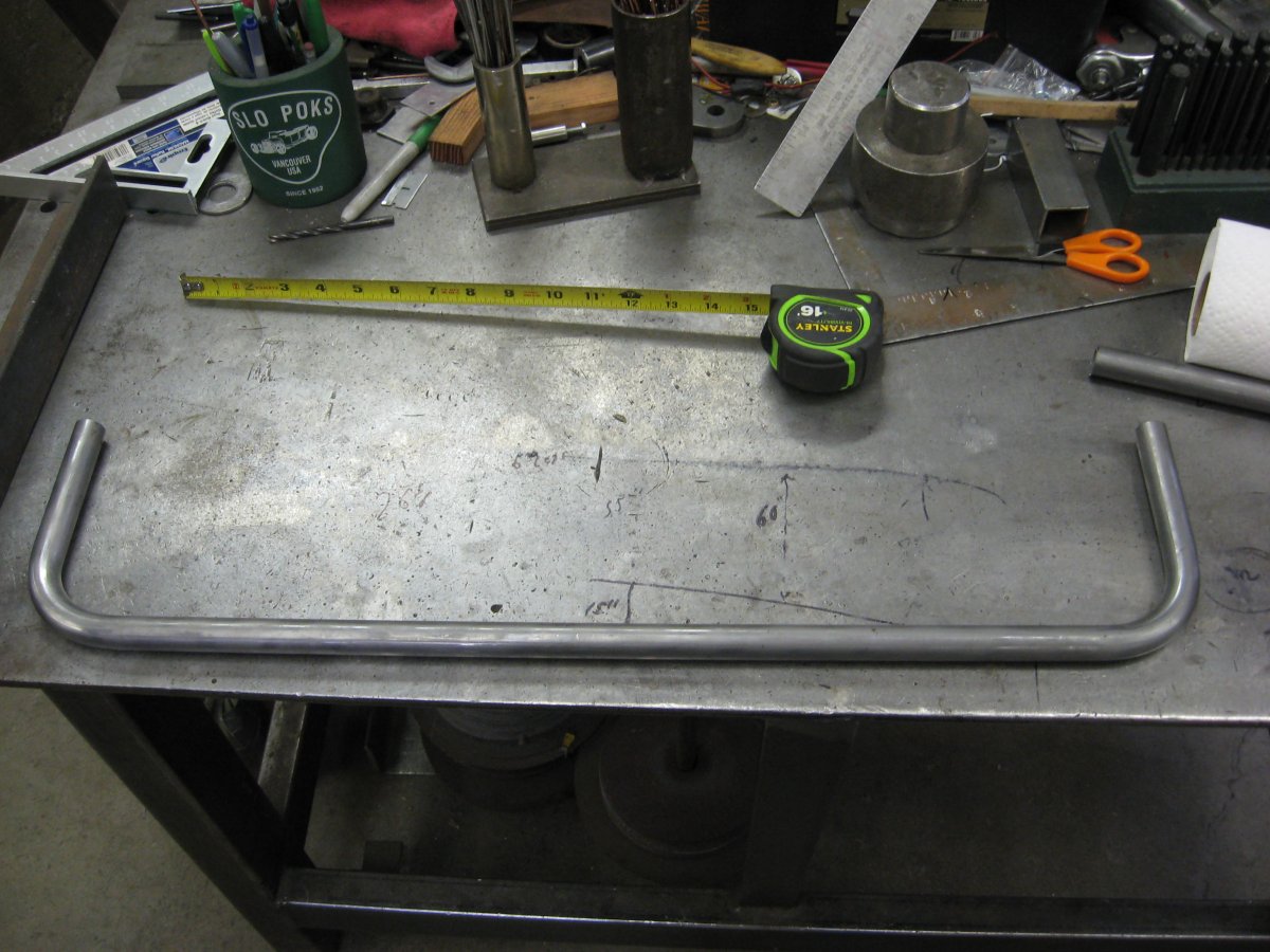

    I have been working on the COE, built some fender flairs to cover the outside dual tires. Now it's back to work the one that really matters. After fabricating the throttle pedal and pivot, (the new "Bulls Eye" pedal pads will be mounted next), the front of the belly pan needed some support. To add some protection for Pat's feet, I bent up a cross hoop and a couple odd bent tubes out of 3/4 X .120 wall DOM. After some fitment, and the addition of some mounting plates, and some tabs to fasten the belly pan to were tack welded in place. Now I can add some foot rest plates, to complete the package. Bending tubes is one of my favorite things ! IMG_7704.JPG IMG_7707.JPG IMG_7712.JPG IMG_7714.JPG IMG_7716.JPG IMG_7717.JPG IMG_7718.JPG IMG_7720.JPG

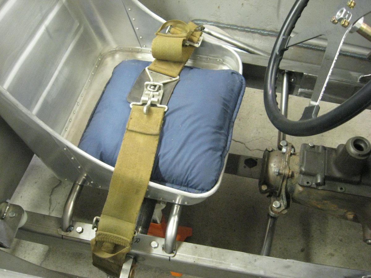

    I reworked the outer legs of the transmission crossmember. The 1st shot shows how it was, and the others show the change to the curved legs, and the belly pan support. It made a major difference, freeing up space behind the driver's heels. Pat will appreciate the extra room for his feet. IMG_7135.JPG IMG_7721.JPG IMG_7725.JPG IMG_7726.JPG IMG_7729.JPG IMG_7733.JPG
