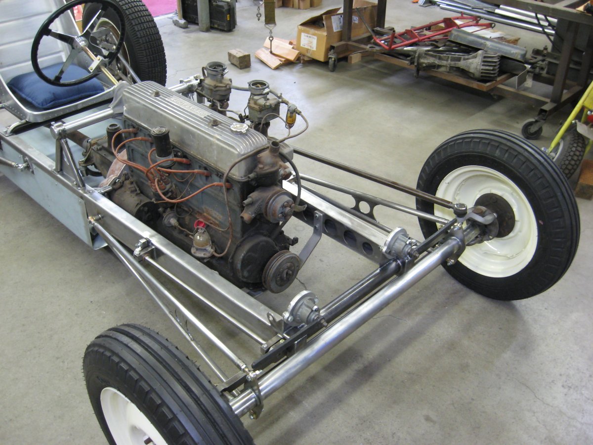

    DSCN0299.JPG DSCN0304.JPG DSCN0306.JPG It's been a while since you've had a report on the roadster, so here's just a quick teaser update. I went down to Bob McKray's in Mission Viejo yesterday in my Old Reliable parts-chaser/pushtruck to pick up the finally ***embled, balanced, and blueprinted 248-inch '48 Wayne 12-Port Chevy long block. It doesn't look like much on the stand in my garage, but what you can't see are the new Ross forged pistons, custom-made with a dome to match the cast JE pistons that came with it. I think I already showed you the cam Isky ground for me, after finding a very old forged-steel blank that he "Thought he had somewhere" in his shop--and did. I had previously found a set of n.o.s. chilled iron lifters. I also had about 20 Wayne pushrods, but the final glitch was that McKray found that only 6 were the right length. So I called Smith Bros. today and ordered a new set of tubular pushrods, plus new adjusters with 3/8" balls to fit the Buick rockerarms. Next I've got to make the oil system, and then attach the now polished/plated Wayne parts. I also got a new radiator made to match the original (turns out to be a '40 Chevy with a shorter core).
    This is just a quickie update. More news when there's more to see.

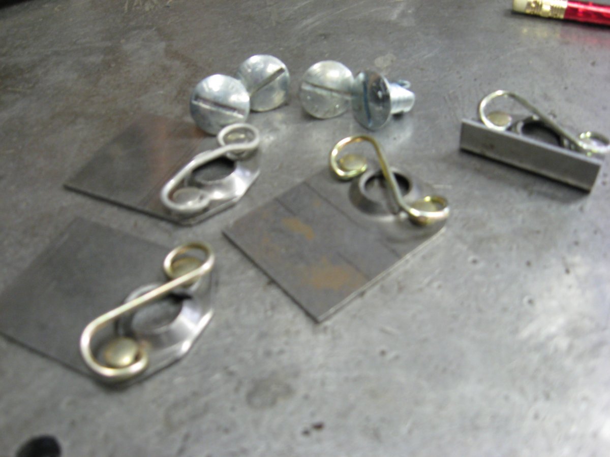

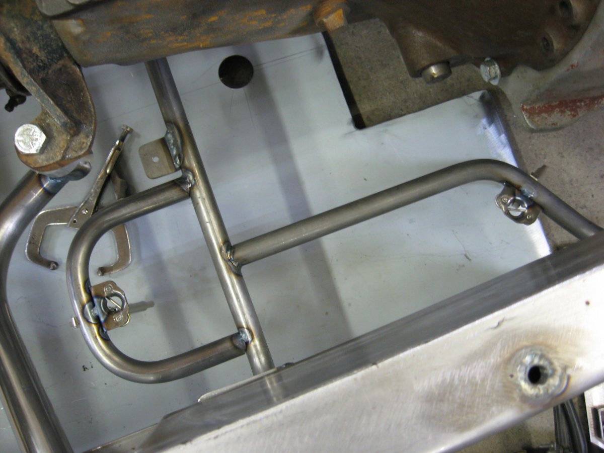

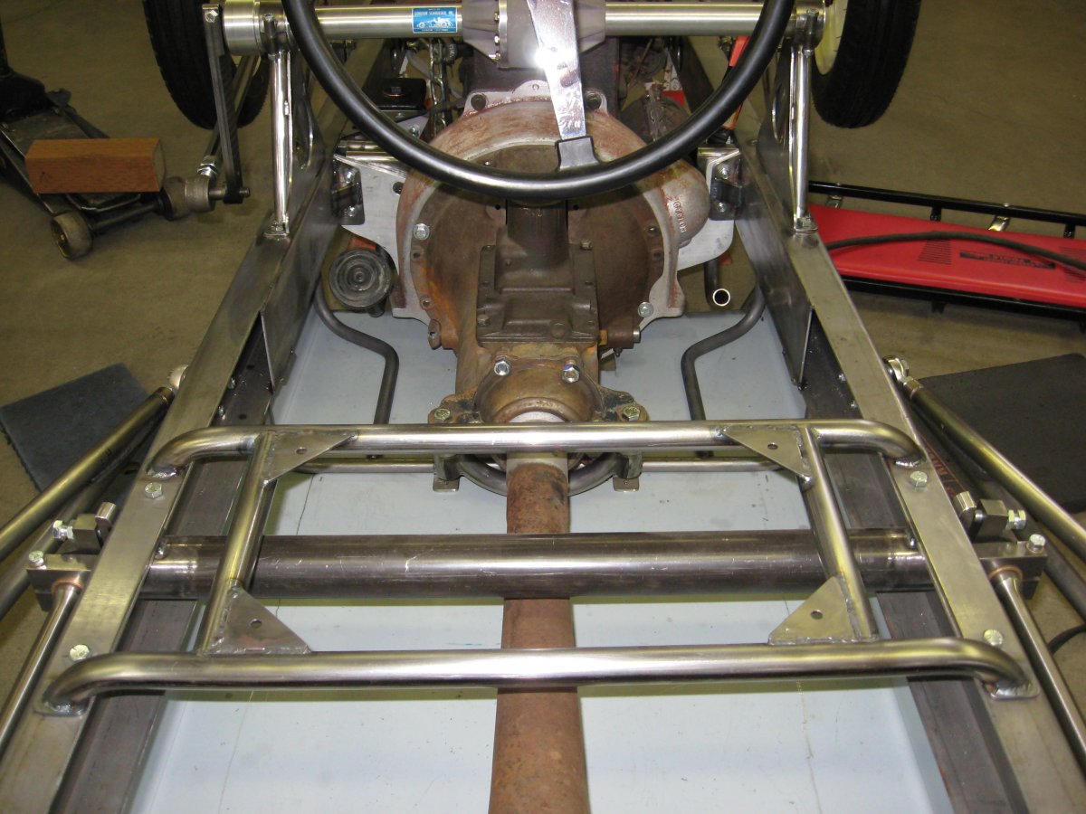

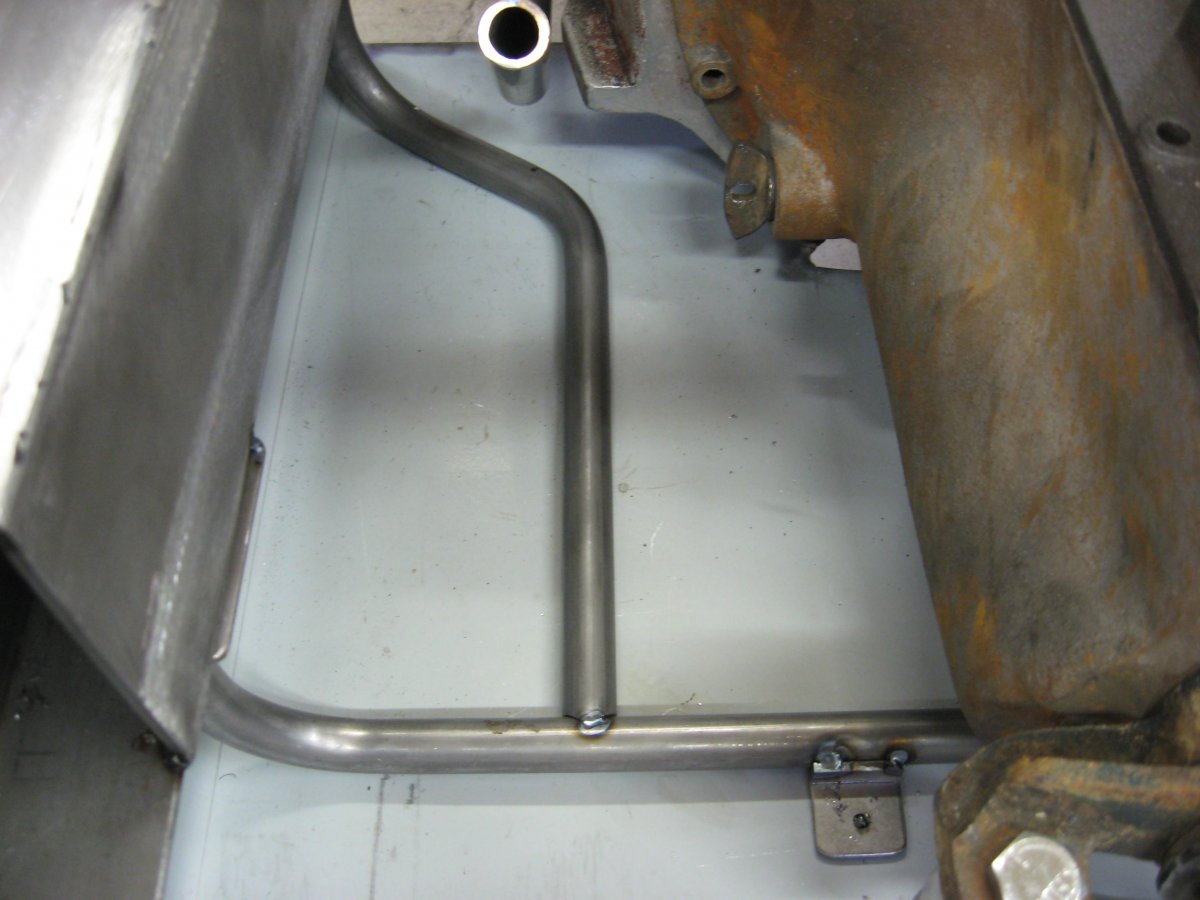

    Happy Easter Pat ! I built the foot rests we have been talking about. In my stash, I had some genuine Dzus plates and oval head ****ons. With the added heel loop, it was a natural to punch some louvers "down". I also straddled the floor support tube with a few more, of what Pat referred to as "dirt dispensers". Notice the new "bulls eye" pedal pads in place..... IMG_7749.JPG IMG_7752.JPG IMG_7753.JPG IMG_7757.JPG IMG_7758.JPG IMG_7760.JPG IMG_7761.JPG IMG_7762.JPG
    1947knuck, cactus1, HEMI32 and 11 others like this.

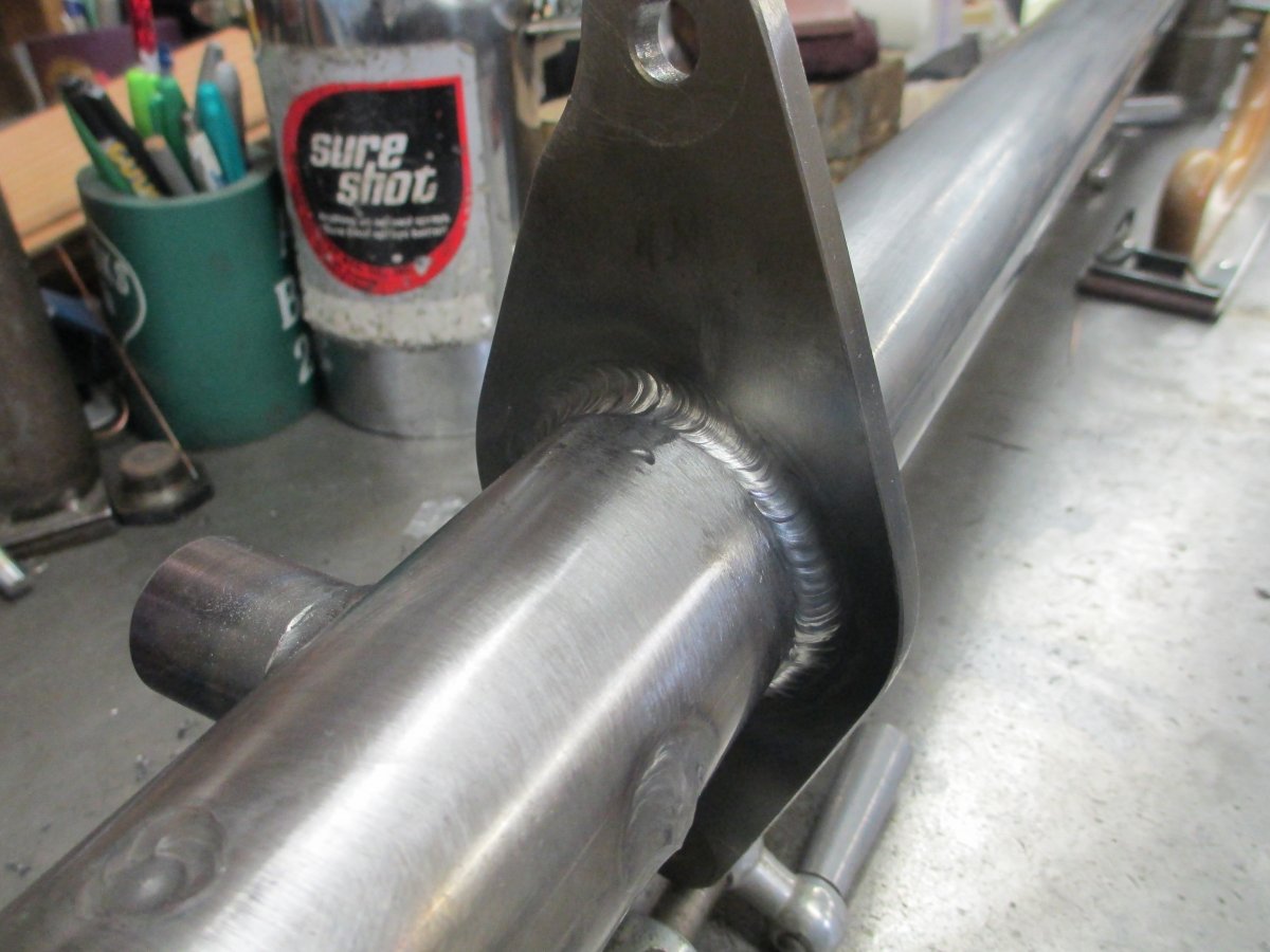

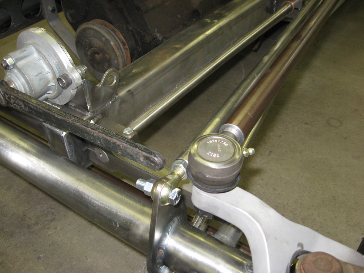

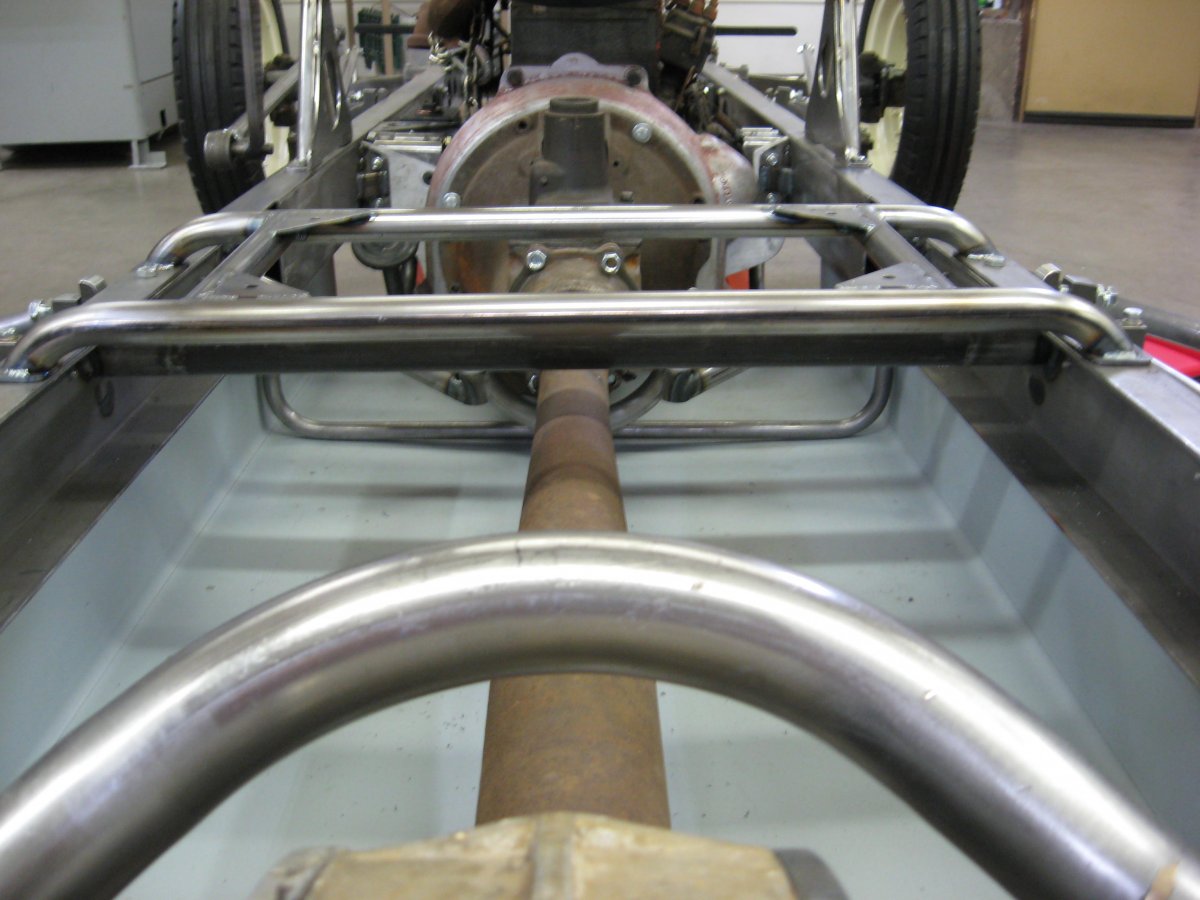

    Well, it was time to tear down and remove the front suspension for final welding of all parts, on and off the frame. I also swapped the front spindles, for the 37-41's, versus the square ones that were on the car. I reamed out the spindles to accept the 3/4" shank, truck tie rod ends. It was also time to machine the proper drag link and tie rod. I intentionally left them long, thinking I can slot them for clamps instead of lock nuts. ***embled pics are next. IMG_0299.JPG IMG_0312.JPG IMG_0313.JPG IMG_7797.JPG IMG_7798.JPG
  26. Marty Strode
    Joined: Apr 28, 2011
    Posts: 9,710
    Marty Strode
    Look Ma, no jack stands ! What a relief it is to get it sitting on it's own front suspension. With the frame rails capped, and everything finish welded, it's fun to make adjustments to the ride height. By removing and changing the clocking of the anchors at the back of the bars, then make fine adjustments on the "jack screws". Now to hook up the front shock links. IMG_7803.JPG IMG_7804.JPG IMG_7805.JPG IMG_7806.JPG IMG_7807.JPG IMG_7810.JPG IMG_7811.JPG
