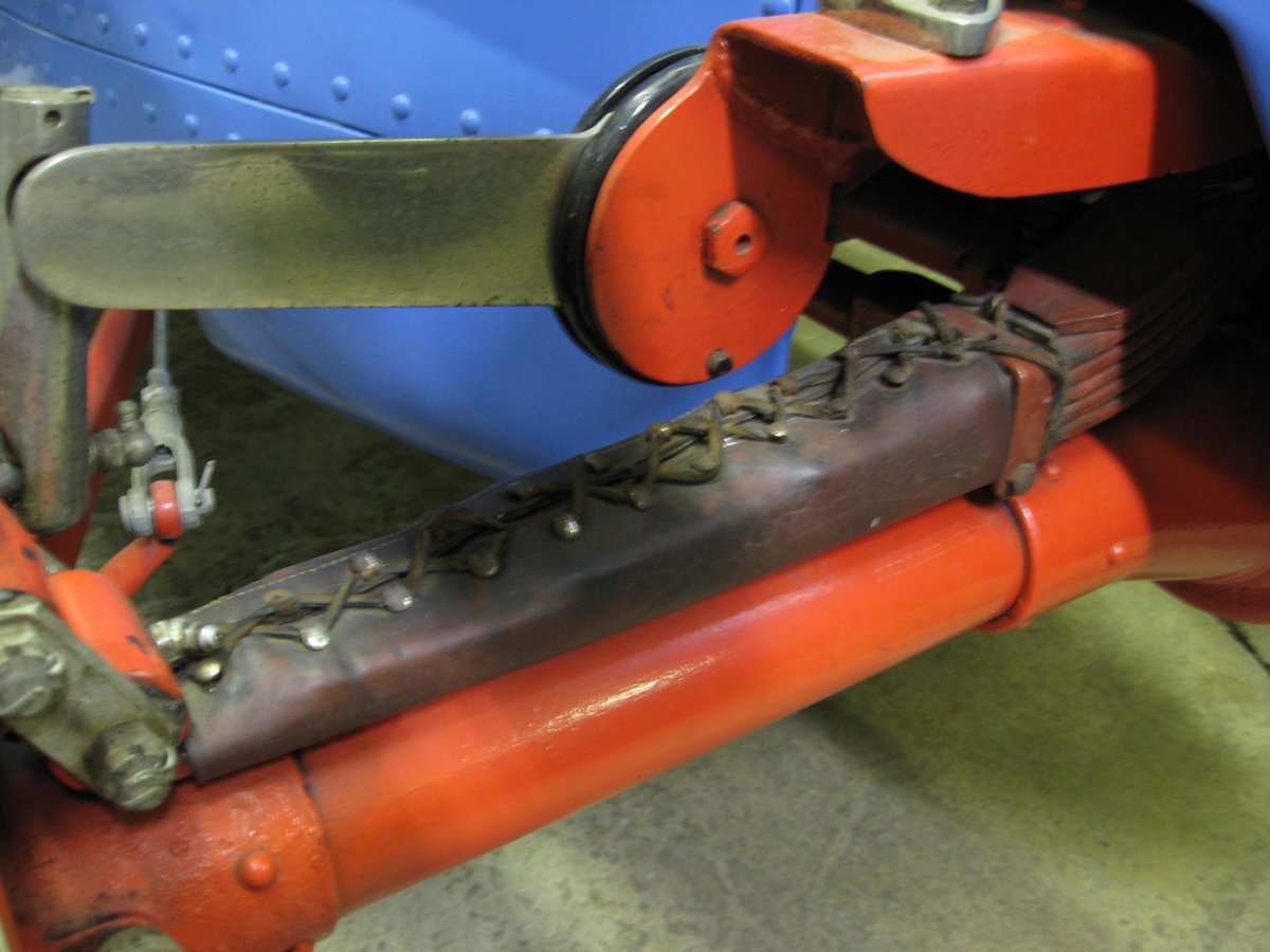

    I have a project in the shop that might be of interest to some of you. It belongs to some friends of mine, the Bradshaw family, that hold the Portland Transmission Show every Spring. It was built by Diane Bradshaw's Father, Harold Langdon, in the late 50's / early 60's. My task is to replace the seats and carefully trim the sheet metal behind the seats, to make more room for the occupants, so they can enjoy driving it. At first glance, it resembles a Bugatti, and my old friend Ken Crawford said, "Harold must have been a true blue Soup Jockey, to have had that kind of hardware" ! IMG_7905.JPG IMG_7913.JPG IMG_7909.JPG IMG_7923.JPG IMG_7922.JPG IMG_7919.JPG

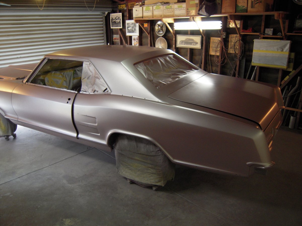

    Hello folks. It's been a little while. I ***ume Marty's busy doing something on that cool Rajo. Meanwhile, I've been doing more work than I expected on son Bill's '64 Riviera, which I volunteered to paint for him. Ninety per cent of any good paint job is prep, but it's boring and ugly. This morning I finally got a coat of Bill's custom pearl lavender shot on it. Photos don't do the color justice.

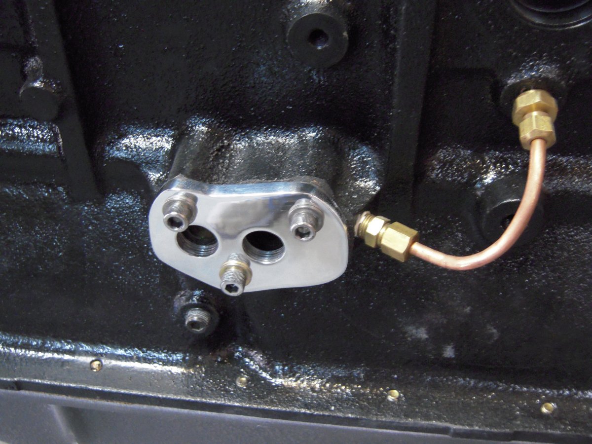

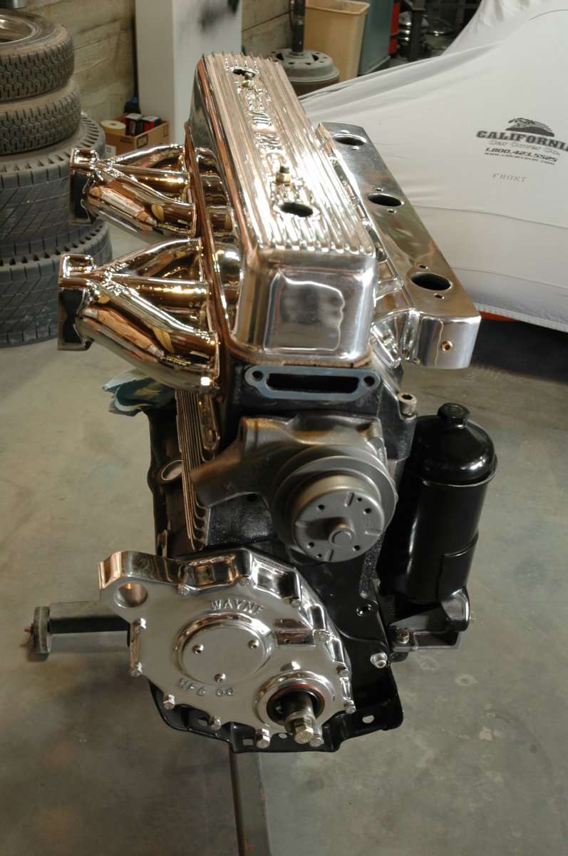

    However, between coats I've made some progress on the engine. First was a little schmunda and some hammertone paint on the oil pan, which is now bolted on.

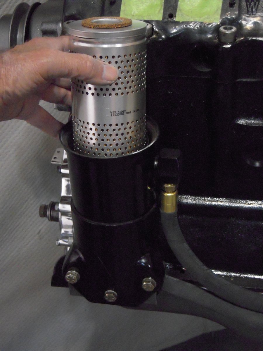

    Next was to complete the oil system, which started with cutting a gasket and then making a plate from 1/4" aluminum which I drilled and tapped for screw-in hoses, then polished. My theory is that race cars should look as good as they run. Hopefully that will pan out.
    And here's the Mopar oil filter with the new hoses attached, same as Spaldings'. From more research, I found this a '46 Chrysler filter, and amazingly my great parts store (Master Auto Parts, Sun Valley CA) had a correct cartridge on the shelf. It's a Wix 51062. This completes the full-flow oil system. Next step is to fill the pan and run the pump with a drill and long screwdriver blade to see if it works (or leaks). Wasn't ready for that today.
    Finally, I checked the fit of intake gaskets I made to fit the head quite a while ago. I can see some t******* is in order. But this is enough for today. More paint coats tomorrow. Then we'll see.
    Pat

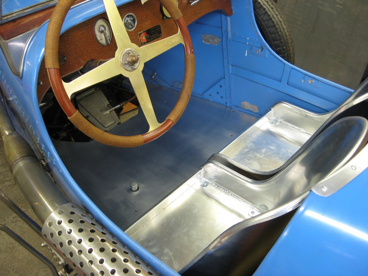

  18. Marty Strode
    Joined: Apr 28, 2011
    Posts: 9,685
    Marty Strode
    Pat, Marty got done with the Rajo today ! My task was to mount Bomber seats on hinges to tilt forward, and to carefully "moon out" the back rest area. Rather than cutting and welding,(I didn't want to disturb the paint anymore than I had to), so I formed and attached some aluminum moldings. I also replaced the gold anodized front floor skin, with a fresh one that I will have clear anodized. When the upholstery shop makes the seat cushions and covers the seat backs, they will make a snap on wrap to cover the modified area. The next thing on the Spalding will be the side nerfs, and the hand brake linkage and lever. IMG_7938.JPG IMG_7939.JPG IMG_7942.JPG IMG_7943.JPG IMG_7946.JPG

    It's been a while since you've heard from Marty or me, so here's a quick update before Anna and I take off for Wash. D.C. tomorrow. It's been an unusually busy summer, and between trips I've been trying to get final clear coats on the S.S. Riviera for Bill. In the meantime, at the L.A. Roadsters swap meet, Don Ferguson told me he thought he had at least one of the Spalding ignitions, complete with a tach drive, so I went to check it out a couple weeks ago.
    This is the first S-W "tach drive adapter" I've ever seen in person. Unfortunately it's been modified to fit a Wayne front-drive ***embly, which mounts the ignition vertically at the front of the engine and drives it off the front of the cam. The distributor is the type that mates the big Nash cap, rotor, and dual points to the original stock Chevy distributor, except this one has had the lower shaft (with cam gear and oil pump tang) cut off, and the Nash "dog drive" added at the bottom. This could be made to work in my engine; I definitely prefer this type of tach drive. But he wants big dollars for it (I don't blame him), so I'm considering....

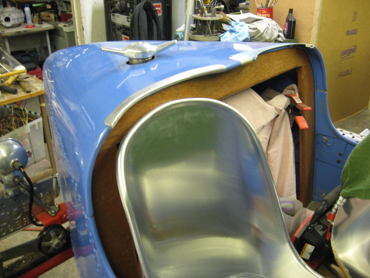

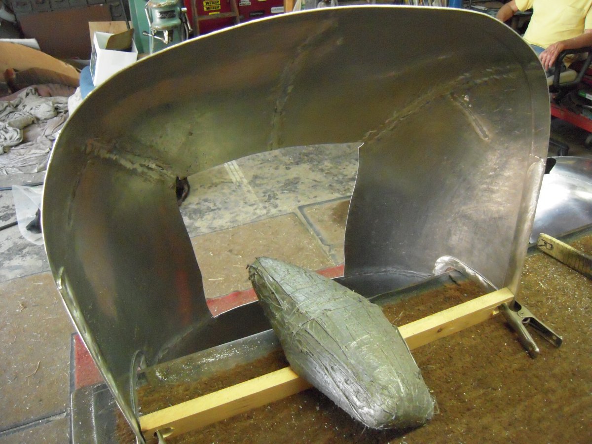

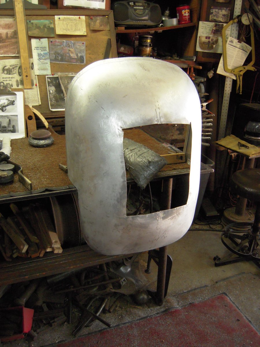

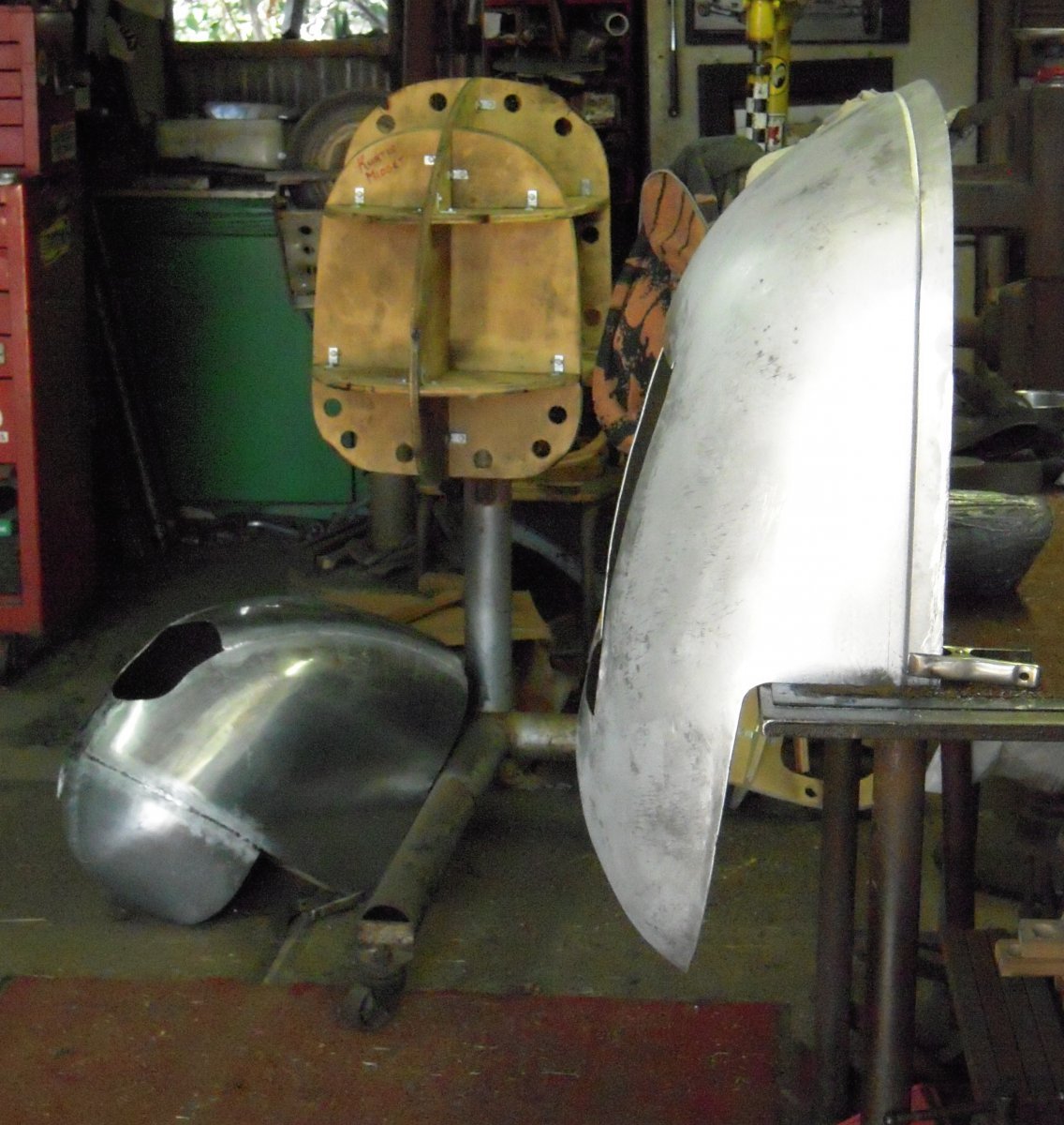

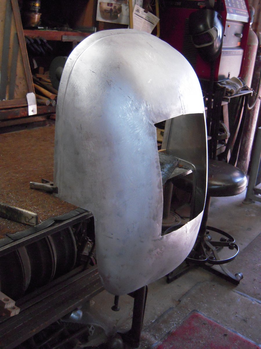

    Meanwhile Dennis Webb has been working on the nose, and he said I could come see it today.
    I gave Dennis some more photos, especially of the nose, of the real car, and said "Make it look like this." So that's what he's doing. Don't be misled by the size of the opening. The grille, which he'll also fabricate, is considerably larger.
    This profile, including doublers you see inside, will eventually get cut out to fit around the axle and torsion bars/shocks. But it was made from the duplicate of the original Ingles buck, which Dennis has. The buck you see in the background is for a Kurtis midget nose, one of which you see in progress on the floor.
    Hopefully more news soon. Pat

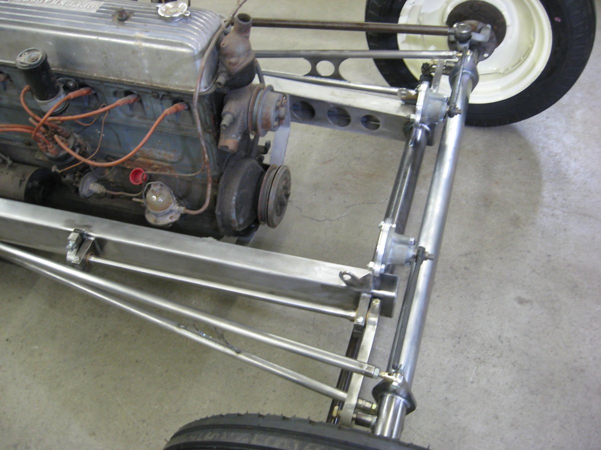

  22. fiftyv8
    Joined: Mar 11, 2007
    Posts: 5,401

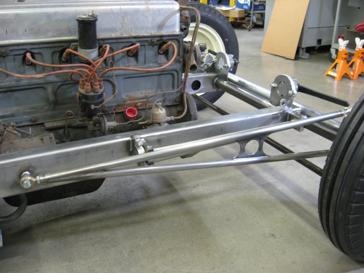

    fiftyv8
    from CO & WA

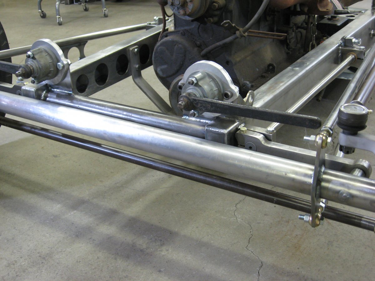

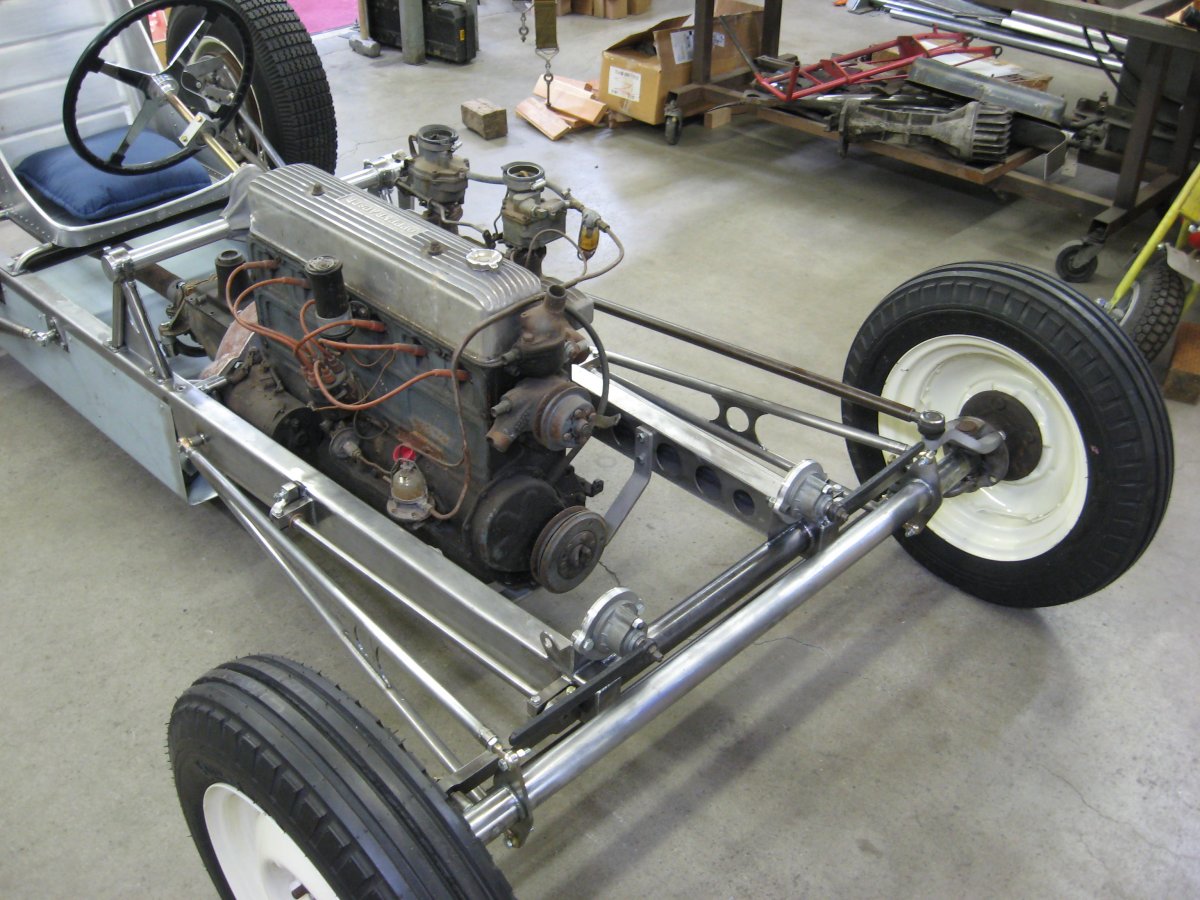

    I am just wondering how that front suspension can work since the connection between the front axle and the torsion bar arms do not have any allowance for movement, since as the arm rotates (either up or down) it will want to shorten.
    Surely a shackle arrangement would be needed on at least one side?
    I am certainly no expert on this stuff, so if I am way off forgive me and let me know how it works.
  23. Marty Strode
    Posts: 9,685
    Marty Strode
    The RH torsion arms (front and rear) are slotted and allow movement, and the driver side arm keeps the axle centered with the ch***is. That's how the original was done as well.
  24. fiftyv8
    Posts: 5,401
    fiftyv8
    from CO & WA
    Great and thanks for clearing that up, I was curious how movement was managed.
    Clean, simple setup and surely comfortable and adjustable.
