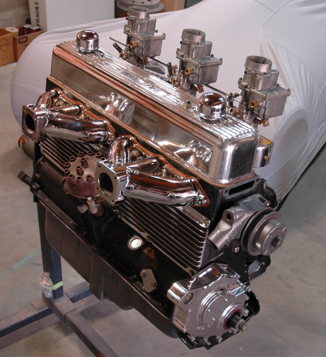

    Marty and I have been doing different things in our garages the last few weeks but, as I showed in a recent teaser, my Job No. 1 right now is to get this Wayne Chevy put together. So here's a progress report:
    I told you I'd found a couple more Spalding ignitions, thanks to long-time six racer Manny Torres. Unfortunately, these are only on loan to me (long story), so this line-up is for observation purposes. Starting at left is a stock early Chev dist., showing the stock cam gear and oil pump drive tang. Next is a Spalding unit made from a Nash dist., but converted to the longer Chevy shaft and gear. This would fit directly in the engine without a tach drive, if the large body would clear the Wayne side cover (it won't in my engine). Next is a Spalding unit (with cherry tag) made from a stock Chev dist. A machined aluminum plate adapts the Nash cap, rotor, and dual points, while the shaft has been shortened and a dual-tang "dog drive" has been added to fit in an S-W tach drive adapter. On the right is a stock Nash Special Six dist. According to my references, this was offered in '29-'30 only. The engine had two plugs per cylinder. But the distributor, with dual points and dual coils, was two separate systems, firing each set of plugs simultaneously. So not only did you get double sparks, but if one system failed, you could still drive home on six plugs. These are obviously rare.
    These photos show the Spalding converted Chev dist. on the left, with the stock Nash on the right. The big difference (hard to see) is the Spalding has every other lobe ground off the cam, making it a true dual-point dist. (increased dwell time), with dual coils firing each plug. Note the cap on right is N.O.S. What I need for my engine is the S-W tach drive adapter. Anyone??

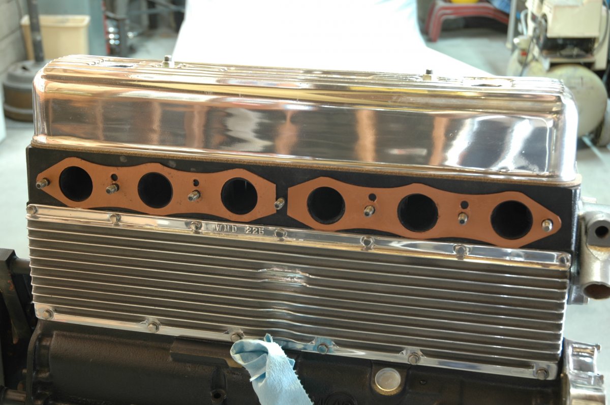

    There aren't any fresh gaskets for Wayne 12-ports, so you gotta make your own. A good set of hole punches, Fiskars, and a sharp X-Acto knife help. These are sprayed with Copper Coat. I also had to carefully relieve the sidecover under #6 port to fit the freshly chromed Wayne sprint headers.
    I made a new set of more pliable intake gaskets, with much trimming, and sprayed them with red High Tack. Note new studs, plus the fourth hole at the bottom.

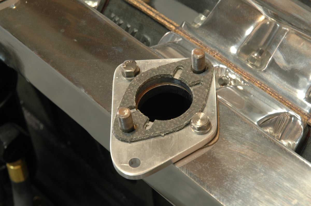

    Curiously, my manifold had no provision for the fourth stud or bolt. So I drilled and spot-faced a hole, as shown, on my mill through the carb opening. It is now secured with a 1/4-20 allen-head bolt, which needs to be sealed since it enters the water jacket. I consider this bolt critical, since inline intakes tend to leak at the bottom of ports.

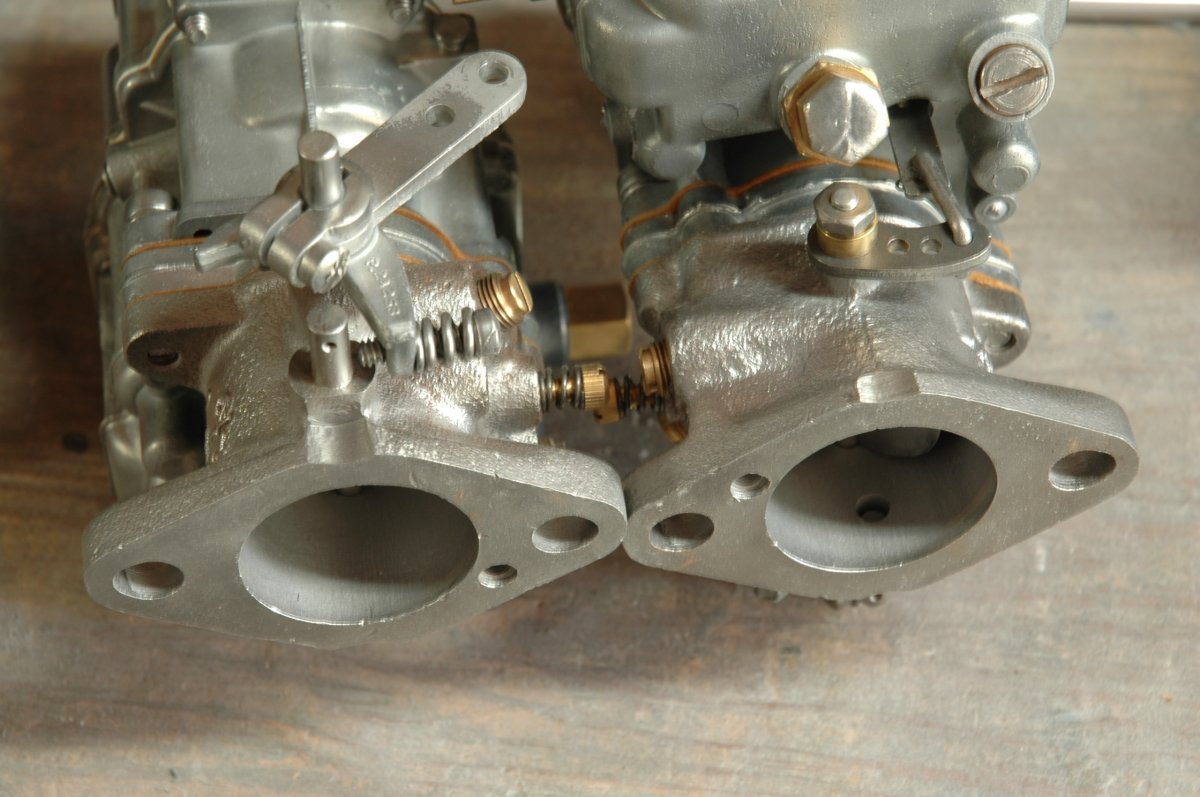

    With the manifold installed, next was making new gaskets and mounting plates for the BXOV-2 carbs and linkage. What was on the engine was quite crude, but gave me some patterns to go by.
    Fortunately Carburetor Carl had some N.O.S. rebuild kits for the carbs, including these needed base gaskets. However, these had to be trimmed to clear the "header" bolts, one of which also had to be turned down in a lathe to clear the carb.
    Likewise, both sides of the carb flange had to be clearanced for the bolts.

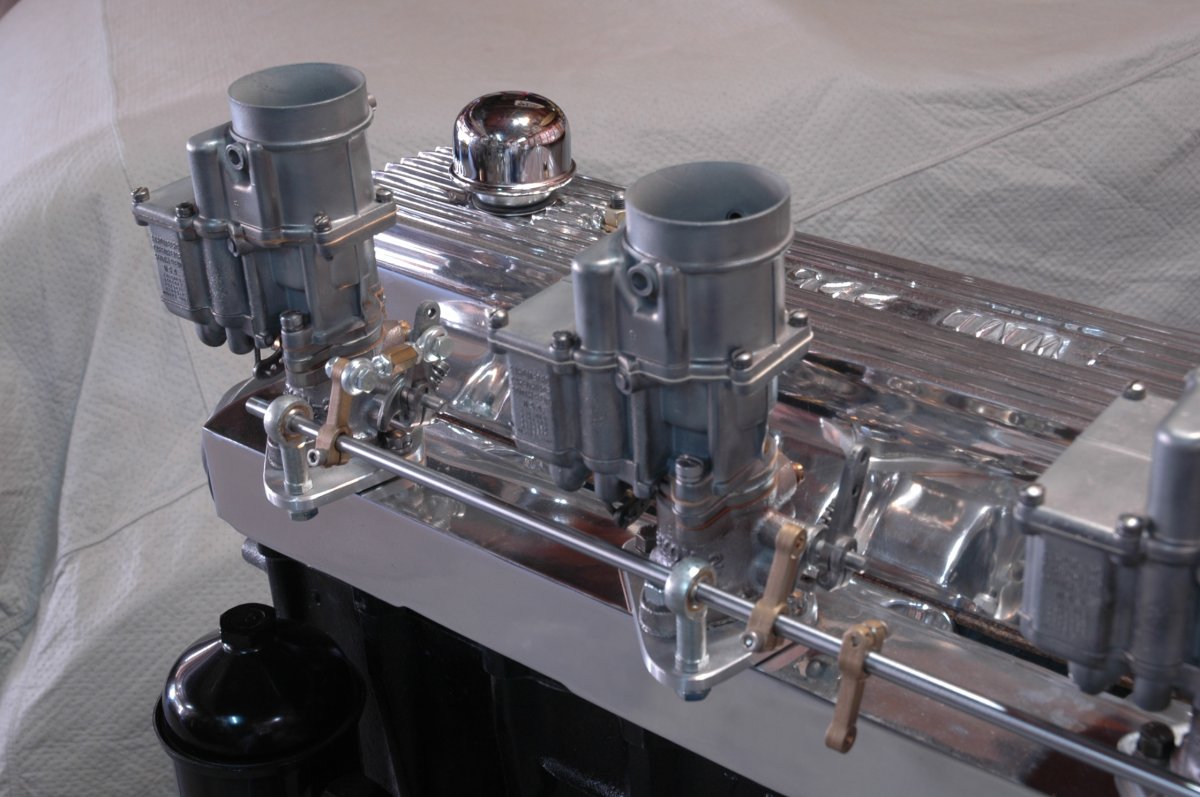

    Finally, here are the three BXOVs mounted in place, expertly restored by Tom Taros.
    The extra flange and hole in each carb plate is to mount the throttle linkage. The original was similar, but made with brazed arms and flat links. What you see here is just mocked up, but it's made from F.I. parts from Hilborn, and will be fully adjustable.
