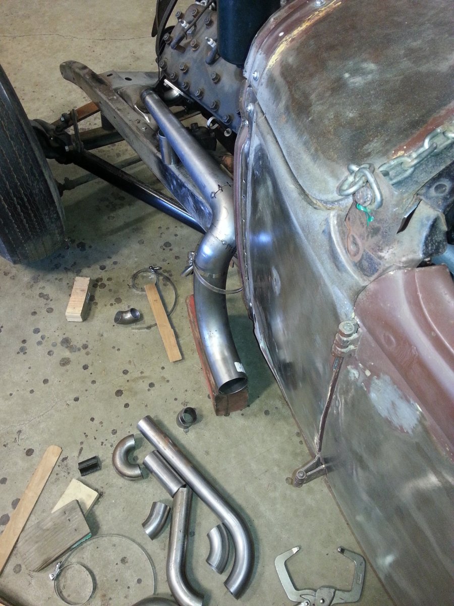

    Good thing, you only have to bend one pipe!
  2. redo32
    Joined: Jul 16, 2008
    Posts: 2,308
    redo32
    If these old eyes can make it out, it appears the pipe is in 3 pieces. Your pretty smart and a hell of a fabricator, I bet you'll figure out how they did it originally. For my 2 cents..... Heat and shrink one side & see it it will come around.

    I figured you would do it yourself with the heat and shrink method. Might be fun?!

    Maybe - if filled with sand and sealed shut...
  5. Marty Strode
    Joined: Apr 28, 2011
    Posts: 9,685
    Marty Strode
    I am going to try to get it done professionally, but if not, I will tackle it. My fear is that it will be wrinkled like me !

    I just ordered some 3-1/2" X 7" centerline radius u-bends, that might be the ticket.
    1947knuck and loudbang like this.
  8. Weedburner 40
    Joined: Jan 26, 2006
    Posts: 1,122
    Weedburner 40
    That's what I'd do, at least at the back. The long curve might be a bit of a challenge but, if you support it at each end and gently push it down in the middle you might be able to accomplish that too.

    For a consistent radius it should be supported in two places (little 'v's) and pressed on in two places (big 'V's) so the bending moment is constant between the span between the big Vs. Then add the sharper wrap-around at the back.

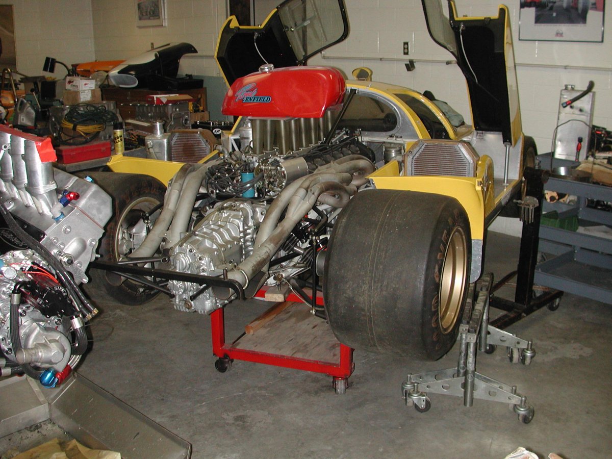

    back in the early 90's I made some curved megaphones for a pair of 512 Ferraris that I built. I rolled the cones pretty much the same way that you did and then capped and sand packed them. Used a big rosebud tipped propane torch and eased the curve into them. I ended up having to mount the cones on the post of the basketball hoop (its an Indiana thing ;)) out back of the shop to bend them as I was making enough heat in the shop that it was setting off the fire alarm.

    That's some nice work ! Did that motorcycle gas tank supply enough fuel for the long races ?

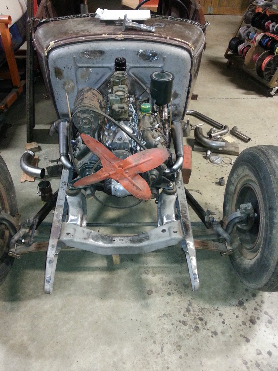

    Well, I finally got a pipe rolled. After transferring the arc of the bend to cardboard, I determined the the location for the cut on the pipe, to make the jog by rotating the joint 180 degrees. It looks like the front of the pipe needs to be a bit shorter, to get the curve that wraps around the body, a little tighter. This has been one of the most difficult parts of this build, just finding a business that would make a part to my specs. Finally some progress ! IMG_0943.JPG IMG_0949.JPG IMG_0950.JPG IMG_0951.JPG IMG_0952.JPG

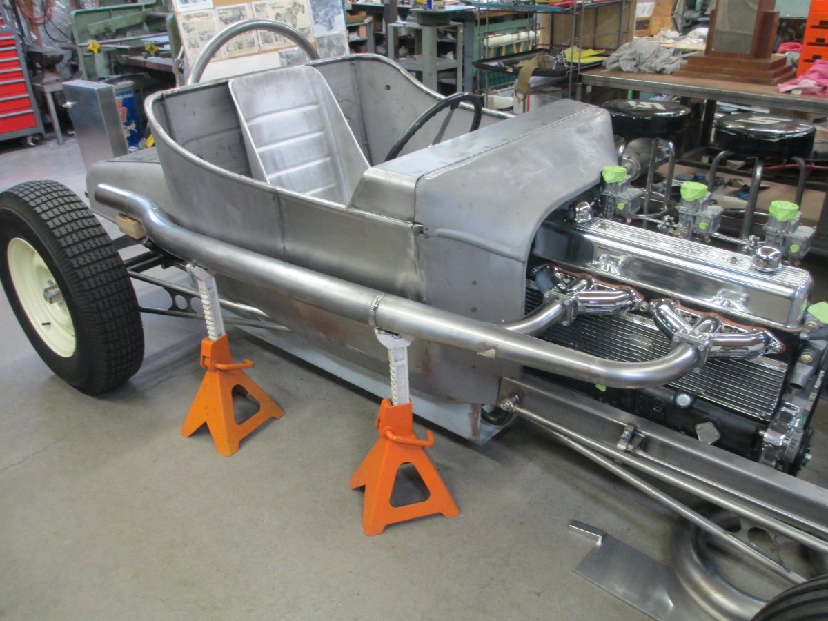

    Some progress today. My struggle with the pipe is nearly over, the rear mount is next and then time to finish the welding. The side nerfs will be next ! IMG_0958.JPG IMG_0959.JPG IMG_0961.JPG IMG_0962.JPG IMG_0963.JPG
