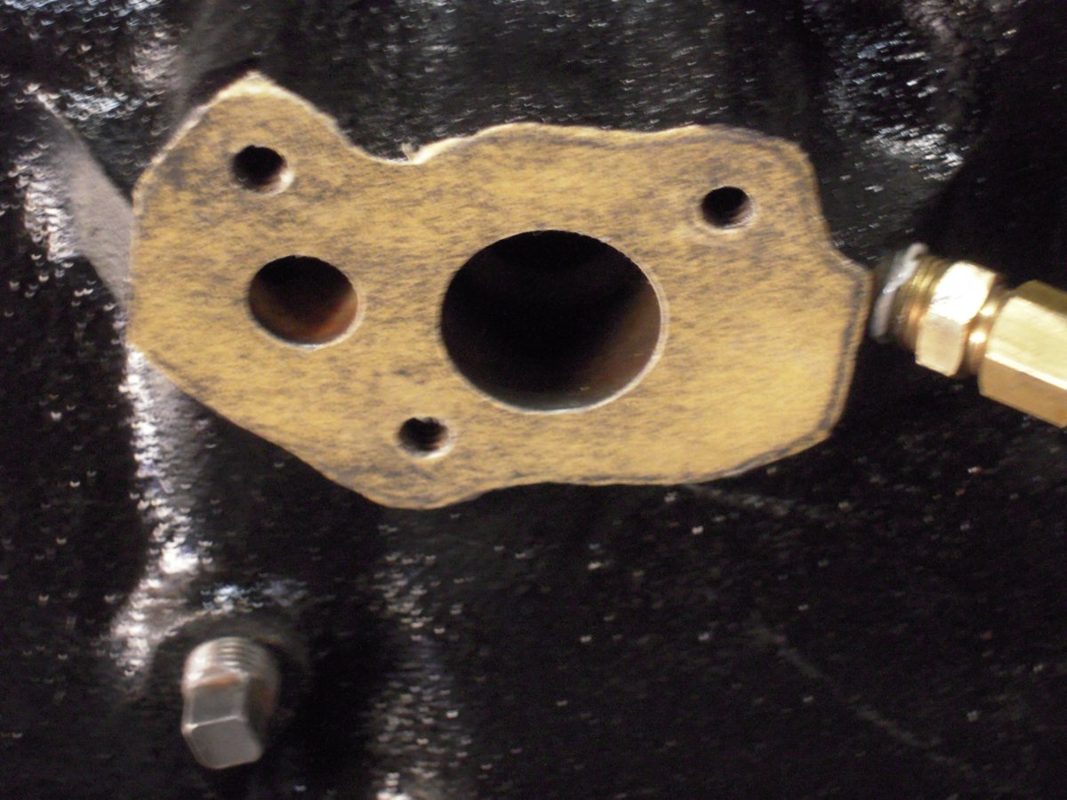

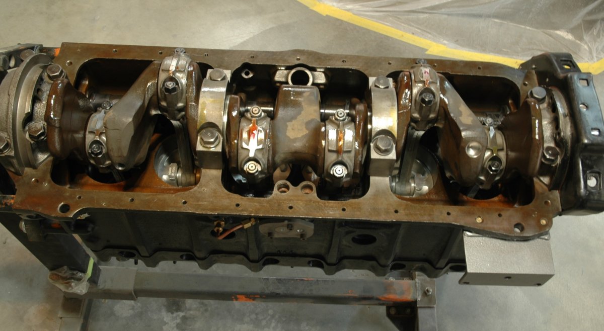

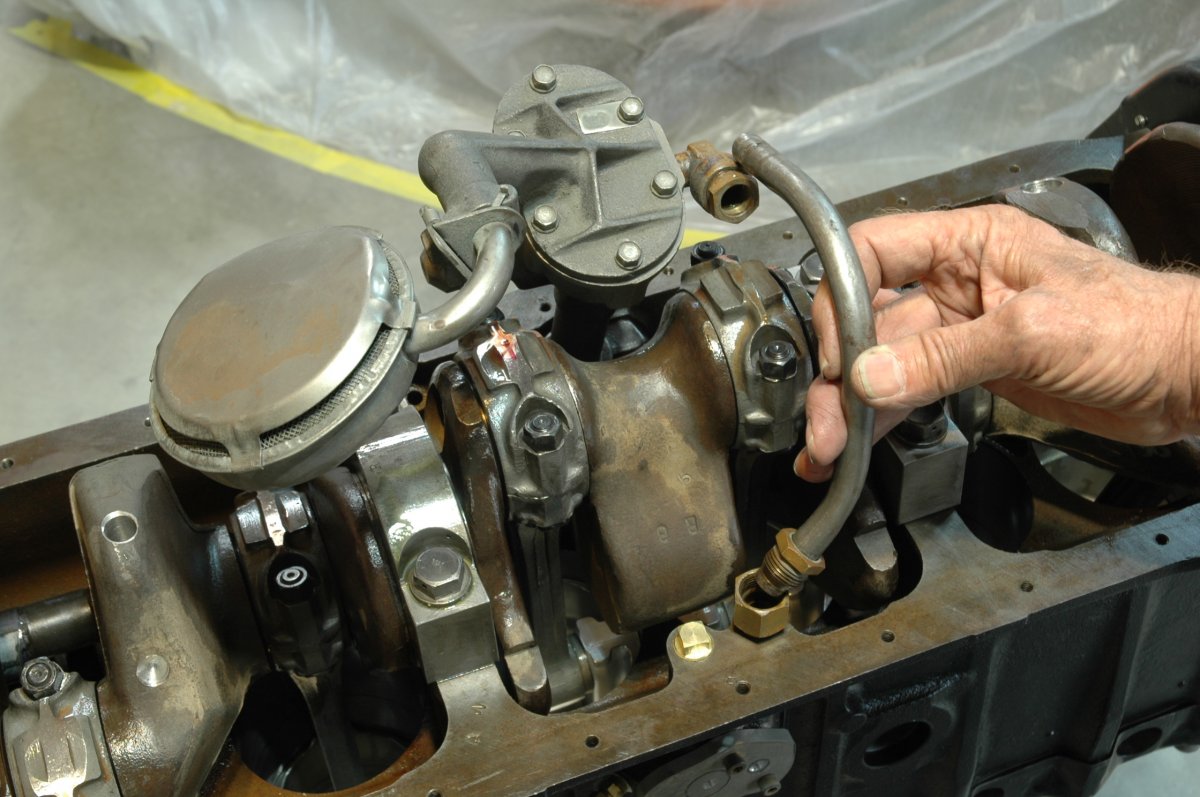

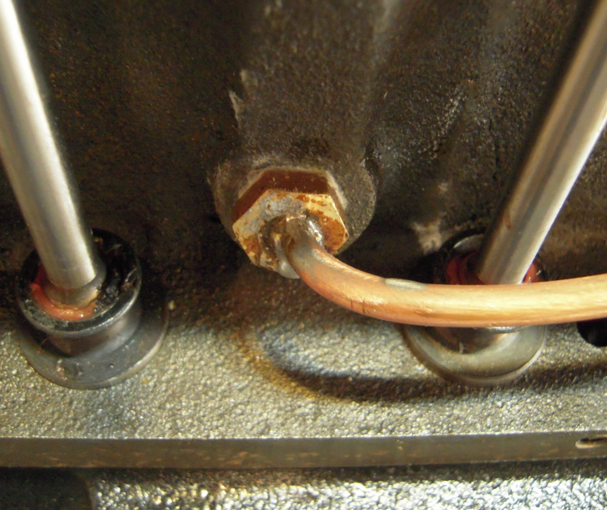

  7. Any close ups of that and the instructions?

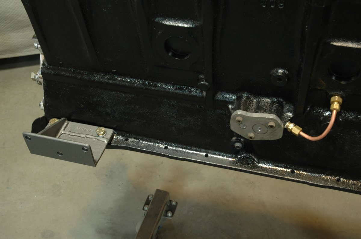

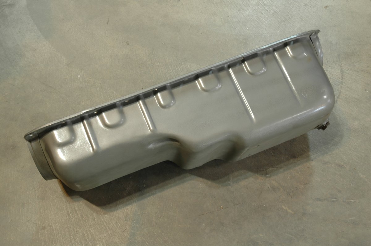

  8. pgan
    Joined: Apr 7, 2009
    Posts: 238
    pgan

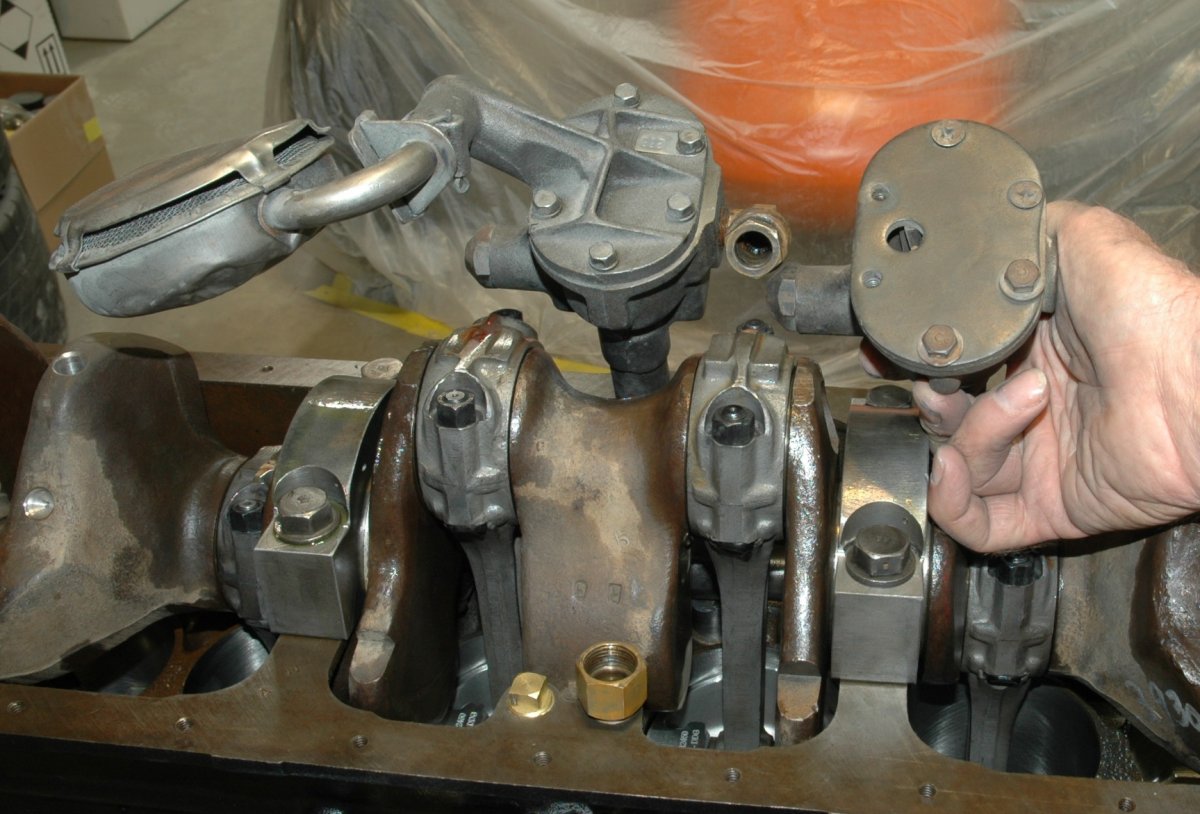

    Robert, You can enlarge the photos on your screen. But what you see is it. This was an esoteric dry sump system made using a stock pickup and a GMC pump mounted and driven off the front of the cam. There were no "instructions" for it or the modified pan. And I've never seen these in the Wayne catalogs. Not sure how you could make a dry sump with just one pump. Usually you need a scavenge pump from the pan to an oil tank, and then a pressure pump(s) to feed oil from the tank to the engine. That's about all I know. P.G.
  9. jimmy six
    Joined: Mar 21, 2006
    Posts: 17,056
    jimmy six
    Pat, when I ran a Pontiac overhead cam engine in my roadster which Vic Enyart had gotten from Eddie Meyers boat racing days had a dry sump system using 2 stock oil pumps end to end, belt driver, pretty ingenious. Vic replaced with a Weaver or Barnes but I'm sure it worked well.
    There are many cast iron stand alone oil pumps we used in power plants that I considered running as external oil pumps on my GMC's but didn't because they did not have byp***'s. You easily do one for less than $50, a far cry from a single stage from one of the many manufacturers. J.D.​
  10. Thanks, when I enlarge it the pan part get cut off.:rolleyes:

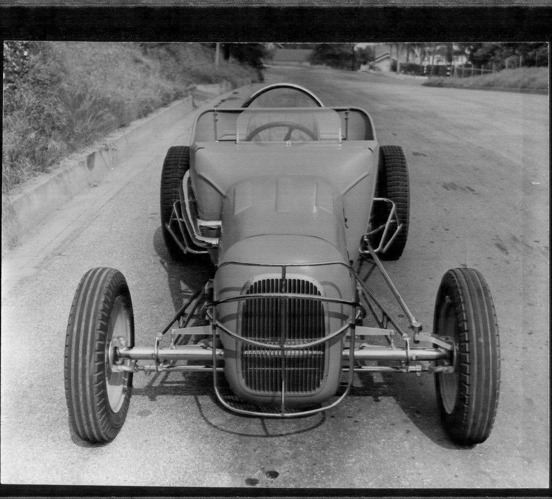

    I got started on the side nerf bars today. I love the way the p***enger side parallels the exhaust pipe. As in some of my other posts, I made a shoe liner for my 1" X 4" radius die, to bend 7/8" tube. I followed with laying out a radius guage from cardboard, to make a pattern of the shape that was required to locate bend starts on the tube. The first tube has 2 bends, one is over 90 degrees and the other is under 90, with the legs parallel. IMG_1004.JPG As always, I get nervous when drilling, or cutting holes in Pat's precious sheet metal, with the chance of making a mistake on the hole centers. So far, so good, I will tackle the lower portion tomorrow! IMG_0986.JPG IMG_0988.JPG IMG_0991.JPG IMG_0992.JPG IMG_0994.JPG IMG_0995.JPG IMG_0998.JPG IMG_0999.JPG IMG_1002.JPG Spalding head-on( best).jpg Spalding 3.jpg

    I wonder why the windshield is off center on the original car?
  19. Marty Strode
    Joined: Apr 28, 2011
    Posts: 9,685
    Marty Strode
    Because the mud off of the guy's tires you are following, will spray you in the corners.
