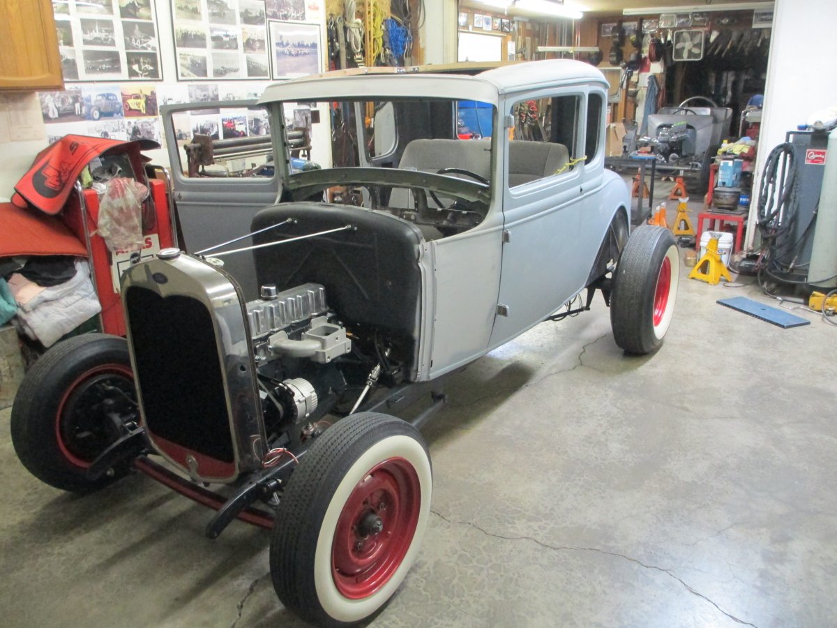

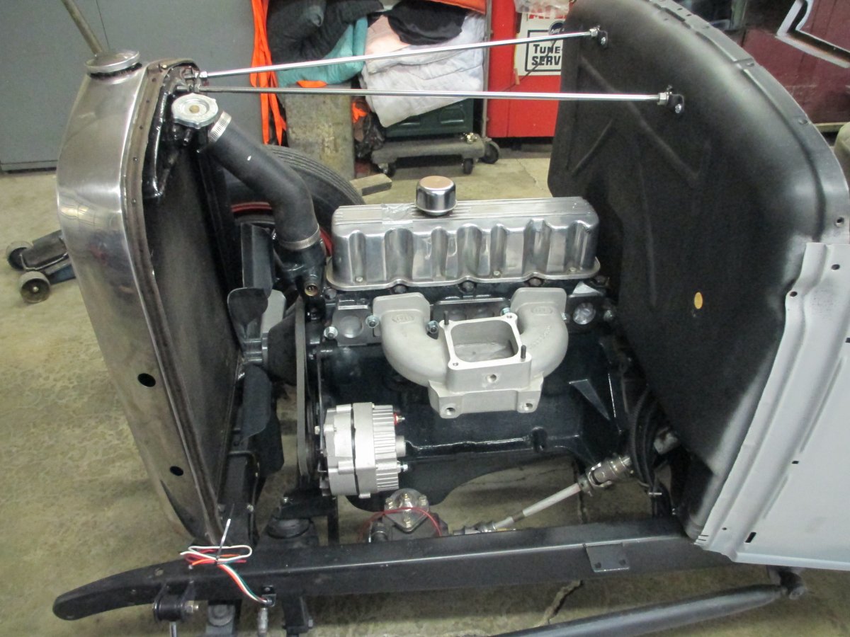

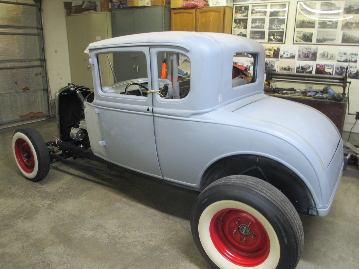

    I worked on this Model A last Summer, narrowing the rearend, setting up the ch***is, and mounting a Chevy 2 engine with a 5 speed. Over the next couple of days, I am building the header and tunnel cover. If anyone is interested, I will post the photos right here. IMG_1090.JPG IMG_1091.JPG IMG_1092.JPG IMG_1093.JPG

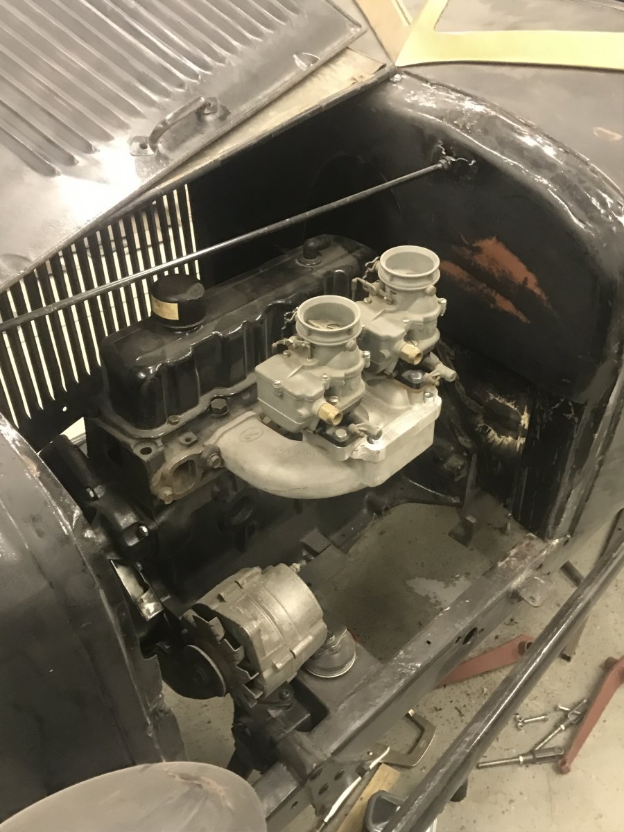

    Post the photos Marty. I like seeing your solutions to making the pieces needed for a job.

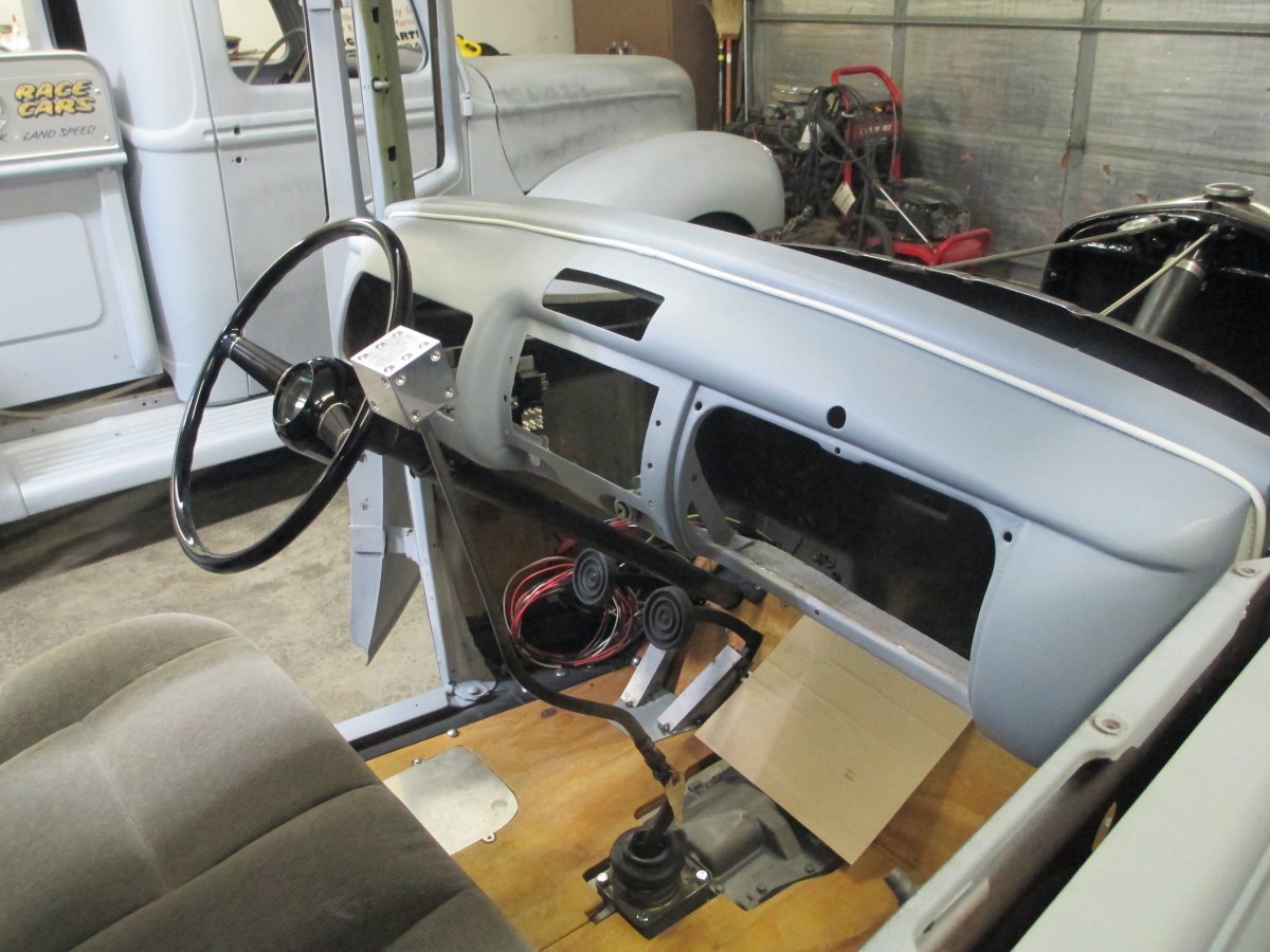

    I don't have any shots of the dash construction, as the owner and a body man friend of his, did that work. It certainly looks good in the car.

    Dean, You know there are many ways to get a job done, and I enjoy seeing the methods that others use as well. When the J-bends and the collector gets here tomorrow, I will get rolling !

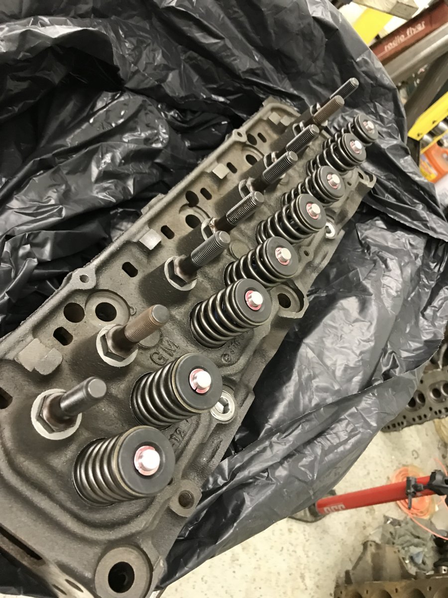

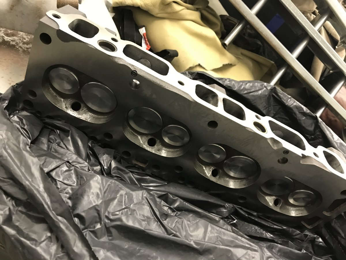

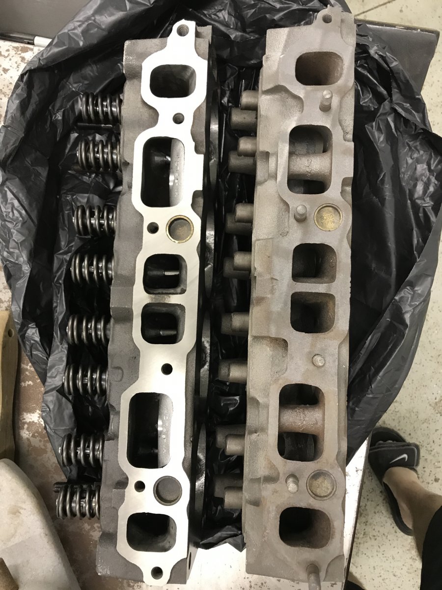

    It is a 153. This one is a place holder while the real engine gets built. Lump ported head, 9.5:1 compression, bigger cam, cutting down a 3x2 intake from a 250 inline six for a pair of Strombergs, electronic ignition upgrade and a light weight flywheel in front of a 5 Speed. Lump ported head on the left, stock on the right. Bigger valves, screw in studs, and ported as well i am still debating tri Y vs 4 into 1 for the header 33948F67-632B-4AA4-B927-49CAEF59F0D6.jpeg 110CC680-CA3E-4F47-9712-836D506F838E.jpeg 0122C14D-95D2-4E3C-9DE4-556A9DF454DC.jpeg

    That's interesting, am I gathering that the 153 is just a 250 minus 2 cylinders? (Math doesn't quite jive) if so a SBC cylinder head conversion may work for it?
  17. justabeater37
    Joined: Jan 1, 2009
    Posts: 1,837
    justabeater37
    Port spacing is the same. Yes you can do a SBC head but it’s a ton of work. Kansas racing and Fontana blocks can come drilled for a number of different heads. My ultimate plan is a 181 block which is a 4” bore with a 153 crank which is 3 1/4” stroke. The front 3 exhaust ports are the same as a 250, the rear one is different. Bolt hole and stud locations don’t line up on the fourth. Headers by Ed has flanges with starter tubes available as well.

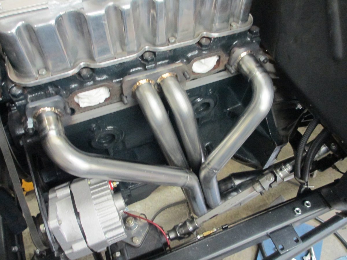

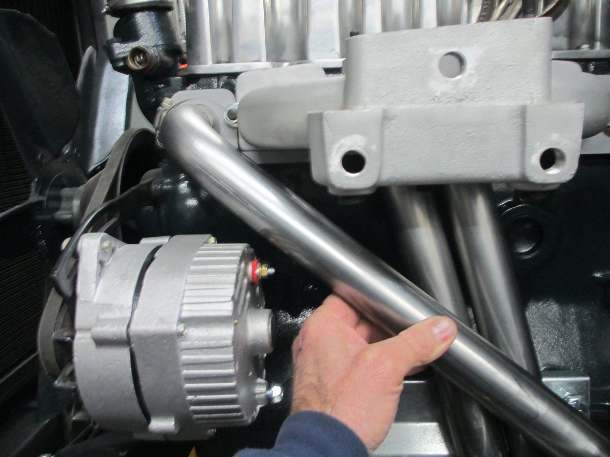

    Well, I got the header done, didn't make any attempt for equal length pipes due to the intake, and the fact that this is not a high performance engine. With the oval ports in the flange plate, I squeezed the pipe in the vice to fit the flange. I used the threaded boss in the side of the block to bolt on a piece of sheet metal to space the pipes off of the pan rail, and to use for clamping purposes. The rest was band sawing the bend sections to align with each other, to get the contour I was looking for. I use a 12" sander to match the joints, and a knotted wire wheel to de-burr the inside of the pipe sections before tack welding. I am a proponent of using silicone bronze on the outside of the flanges, after welding the tubes to the flange on the inside. I need to set up a tripod, or have someone shoot pics while I do the work, as it's difficult to work one handed and take photos with the other. IMG_1094.JPG IMG_1095.JPG IMG_1098.JPG IMG_1102.JPG IMG_1103.JPG IMG_1108.JPG IMG_1110.JPG IMG_1113.JPG IMG_1116.JPG IMG_1117.JPG IMG_1119.JPG IMG_1122.JPG IMG_1125.JPG
    1947knuck, Tim, bchctybob and 20 others like this.

    Looks great, Marty. I, too, am a proponent of the silicon bronze welding on the outside; it looks "right" and provides strength.
    How much did you stretch Jim's RMR wheelbase? And where did you make the cut?
