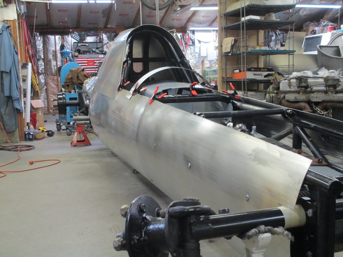

    In a former post I mentioned building a Land Speed Lakester body, I am finally rolling on the project. With it's rounded sides and cowl area it's looking a little like a submarine, and hopefully it will have 60's era look to it. The enclosed ****pit and hinged cowl will be a challenge. The Spalding is patiently waiting for the nose and grille. IMG_1380.JPG IMG_1385.JPG IMG_1387.JPG IMG_1388.JPG

    A little update on the Lakester. With most of the sheet metal (forward of the engine) in place, the hinged canopy is my current challenge, then comes the nose. We are sending it out for wiring and plumbing in about a week. While it's gone, I can finish the side nerfs and exhaust on the Spalding, while making a plan of attack on the rear section sheet metal for the Lakester. IMG_1451.JPG IMG_1455.JPG IMG_1458.JPG IMG_1456.JPG
