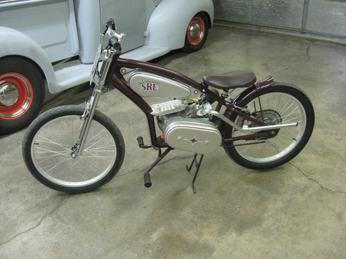

    Larry, It's great that you are spending quality time with Tyler, did you know I was a Cub Scout once ? As far as the reference to a certain metal shaper, I did get one of his endorsed bicycles for my 65th Birthday, along with a crate engine. See you soon, PIR opens in a couple of weeks ! 2015-01-10 130657.jpg IMG_4939.JPG IMG_6278.JPG

    Nice upgrade to the two wheeler!

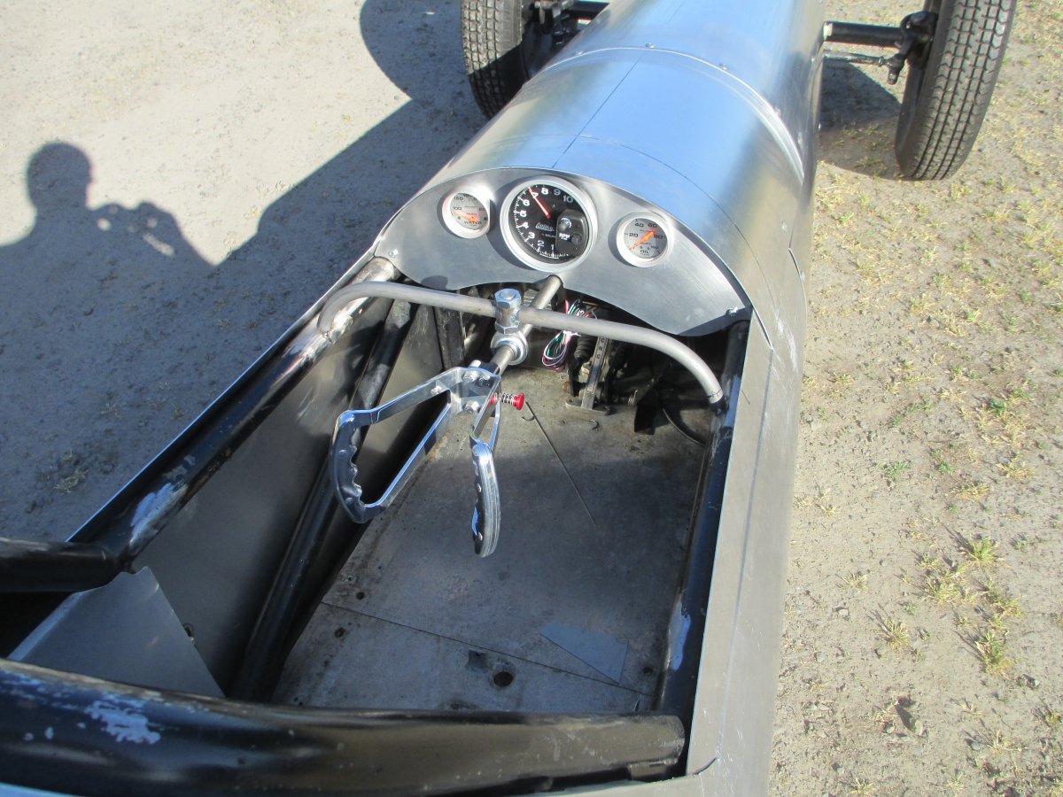

    I rolled the Lakester outside today, to get a look at a distance. The canopy and the engine cover are still in the mock-up stages, but it gave a pretty good idea of how to pursue the rest of the metal work. IMG_1654.JPG IMG_1659.JPG IMG_1663.JPG IMG_1670.JPG IMG_1672.JPG

    Posts: 35,967
    Mr48chev
    The lakester is looking good. I have one of those bikes out in the garage with one of those littl 70 CC boy go fast motors on it. Done up more as a bobber than a race bike.
  12. loudbang
    Posts: 40,346
    Looks fast just sitting there. :)

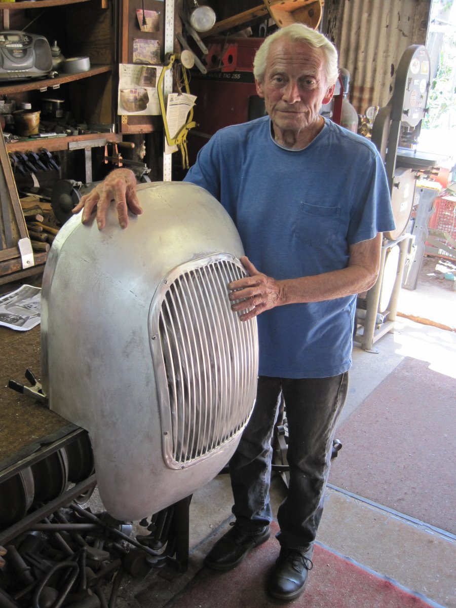

    Marty and I have both been diverted by other projects, but I'm glad to say Dennis Webb has been tediously working on the nose and grille for the roadster, and called me last week saying it was ready for me to come get. He knows Marty will have to trim the sides considerably both to make it more vertical and to clear the axle, shock arms, etc. But this is what Dennis made, all completely by hand, and I am honored to have his work on my car.

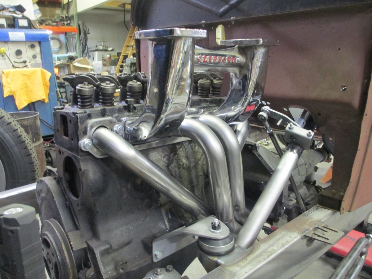

    I spent today fitting up a header for my friend Mitch Kim (master pinstriper). He is building a 29 PU shop truck, with a 181 Chevy Mercruiser. With two single barrels, and a cam it should get around just fine, and have the "banger sound". IMG_1752.JPG IMG_1754.JPG IMG_1757.JPG IMG_1759.JPG

    Hi Marty, I had a question about the motor mounts you made on Mitch's PU. I understand the gusset on the bottom, but why is the top cut away to expose it? It doesn't seem to be a clearance thing.
  22. Marty Strode
    Joined: Apr 28, 2011
    Posts: 9,685
    Marty Strode
    Joe, I thought it would look better than a large flat area, and it did get your attention. Thanks for your interest !

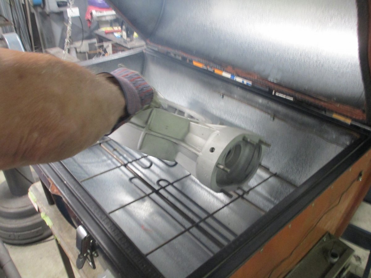

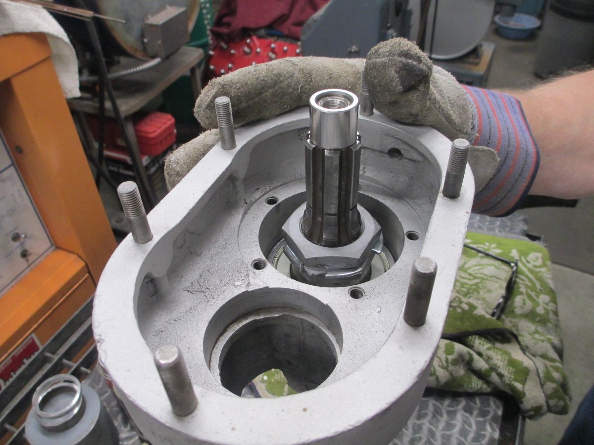

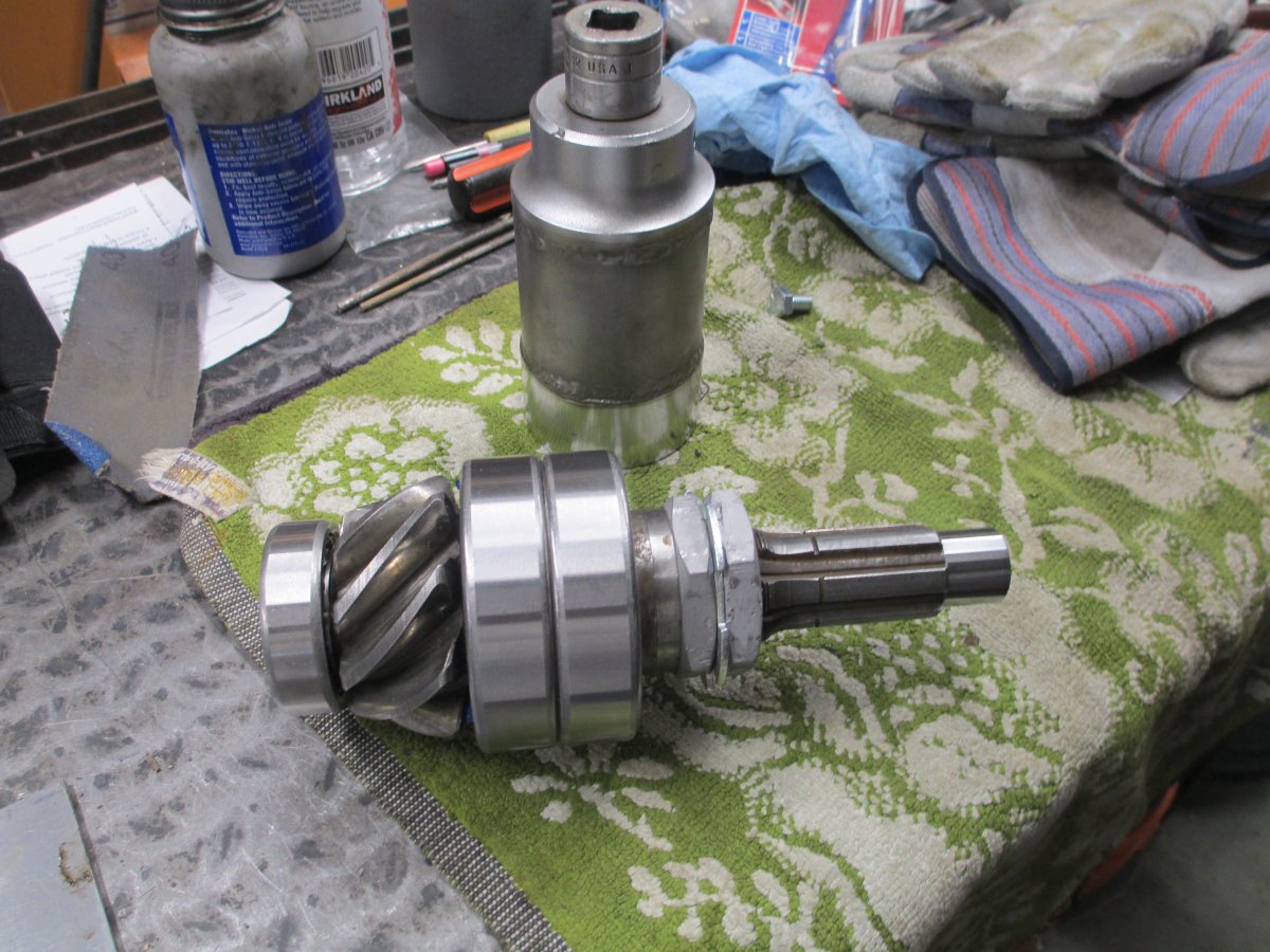

    Pat will be glad to see this post, as he has been wondering just when I was going to get the rear axle set up. I took it to my old buddy and race partner Ernie Martin, to have the pinion bearings installed, and heat up the case to drop in the loaded pinion. He had a friend build the oven, that is very handy for working on quickchange center sections. He also made a deep socket to lock down the nuts on the pinion bearings. Now I can go forward with machining the set up spool for proper backlash. The real spool will be machined to those specs, pressed and welded to the live rear axle. IMG_1794.JPG IMG_1795.JPG IMG_1798.JPG IMG_1799.JPG IMG_1801.JPG IMG_1802.JPG IMG_1804.JPG IMG_1805.JPG IMG_1792.JPG

    Kinda wondered what was going on over yonder on your side of the hill. Pretty slick setup between you and 'Ol Dirty Ern.

    Hooray! Way to go, Marty. It certainly helps to have the right stuff, and good friends who will share. And you have the right stuff! That Pat Warren center section looks better than I remembered.
