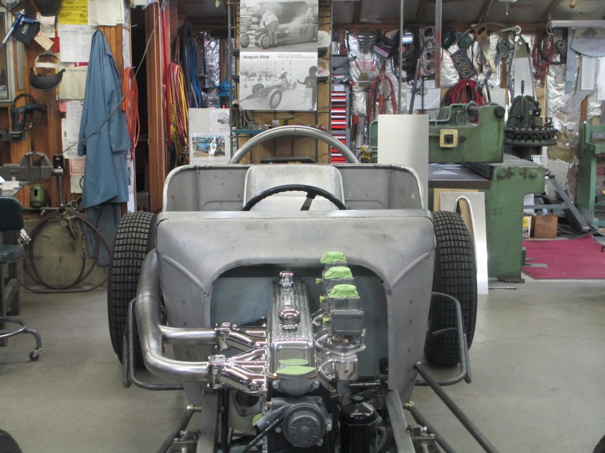

    Tim, this shot is from the Hot Rod Magazine article. It shows just how long the hood was, and all of the photos make my job easier. Now, if Pat was a little shorter (like a foot), he would more resemble Roy sitting in the car.

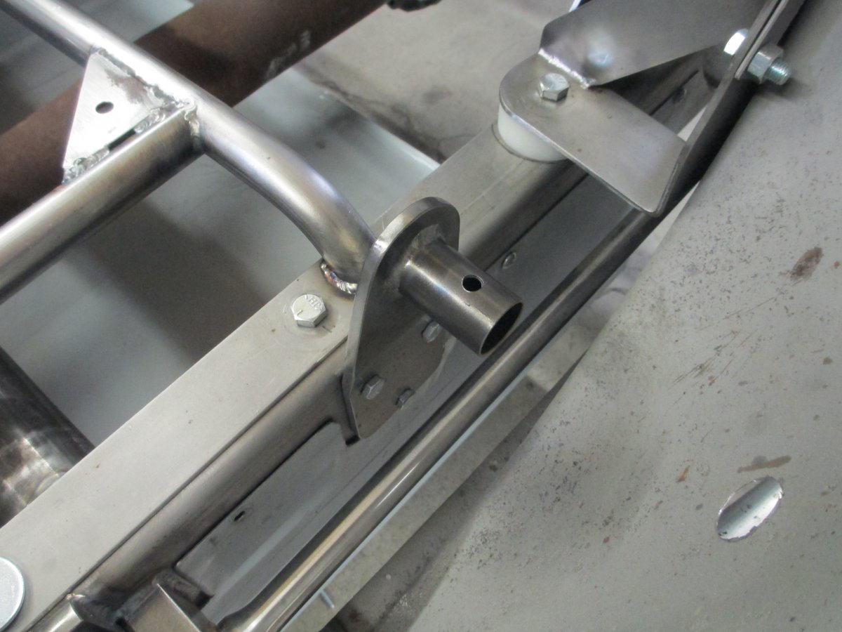

    Since we won't be going to Wendover with the Lakester,( cir***stances out of my control), I have been back on our project. Pat and I decided to install a hand brake, along with a foot brake, that work in unison. The reason is, with the center seating position and the driver straddling the the transmission, the clutch and brake pedal are right next to each other. Pat will use the hand brake, and clutch with his left foot, while driving from the pits to the oval. After pat selects the gear in the transmission, he will brake with his left foot, and throttle with his right while racing on the oval track. It is the only solution for this application. We needed a sleeve through the frame for the brake handle pivot, this is what I came up with. I have a 3/4- 36 spline shaft and coupler on order to complete the package. When it shows, I will make the handle and linkage. I got the side nerfs mounted today, will post those pics soon. IMG_1875.JPG IMG_1876.JPG IMG_1878.JPG IMG_1879.JPG IMG_1884.JPG IMG_1885.JPG

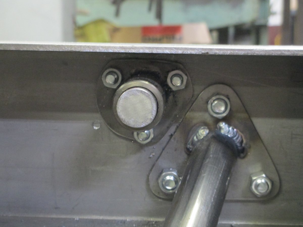

    This is how the side nerfs turned out. They required a riser bracket at the rear, rather than just a socket welded the the side of the frame rail, as it is in the front. The rear mounting will be done, when I complete the curve of the tube, to p*** under the radius rod. Tony Huntimer ( typo 41), felt sorry for me not being able to go to Bonneville, so he sent me one of his wonderful calendars, shown in the last shot. Thanks Tony ! IMG_1886.JPG IMG_1891.JPG IMG_1892.JPG IMG_1894.JPG IMG_1895.JPG IMG_1896.JPG IMG_1893.JPG

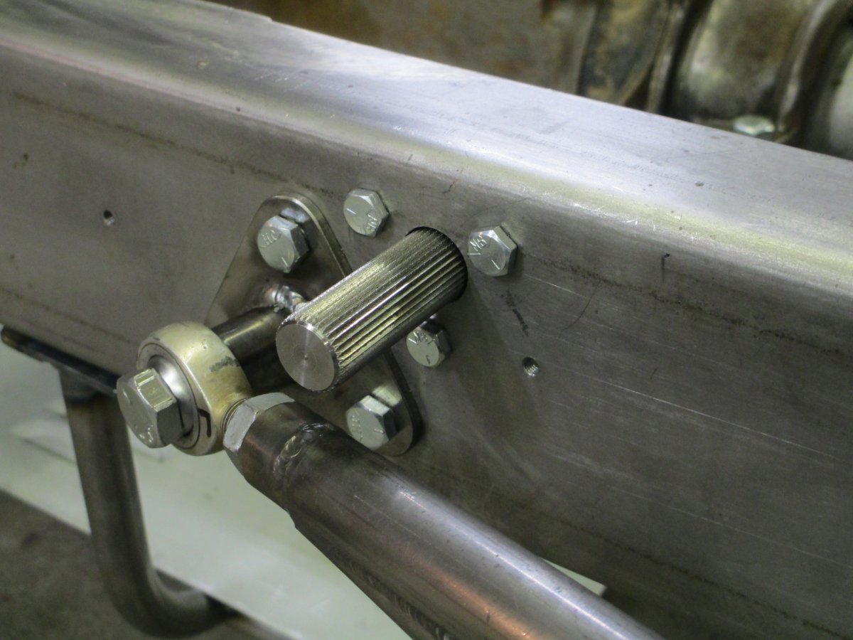

  16. Marty Strode
    Joined: Apr 28, 2011
    Posts: 9,710
    Marty Strode
    The hand brake mock-up is complete, now some welding, trim the end of the shaft, and make one spacer. The handle is attached with a 3/4-36 spline, so it will be easy to adjust for different drivers, get the hint Pat ! IMG_1908.JPG IMG_1911.JPG IMG_1912.JPG IMG_1914.JPG
  17. gnichols
    Joined: Mar 6, 2008
    Posts: 11,413
    gnichols
    from Tampa, FL
    Just wondering... why not a hand operated clutch instead? Lots of modifieds on the oval tracks used them in the midwest in the 60s. Gary
  18. Marty Strode
    Posts: 9,710
    Marty Strode
    Pat is going to run this at the drags, perhaps some hill climbs, and you cant clutch with your left and shift with your right, and steer at the same time. It was the only solution in this case.

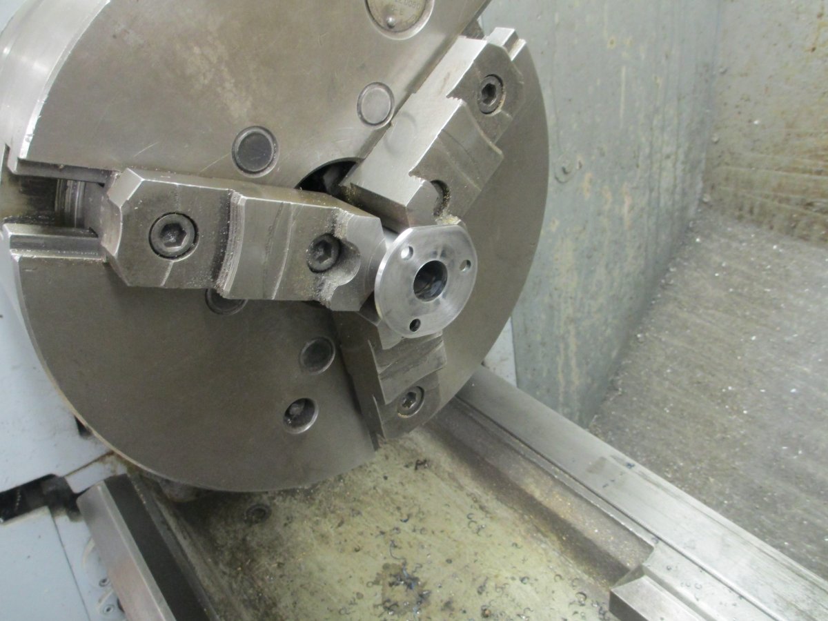

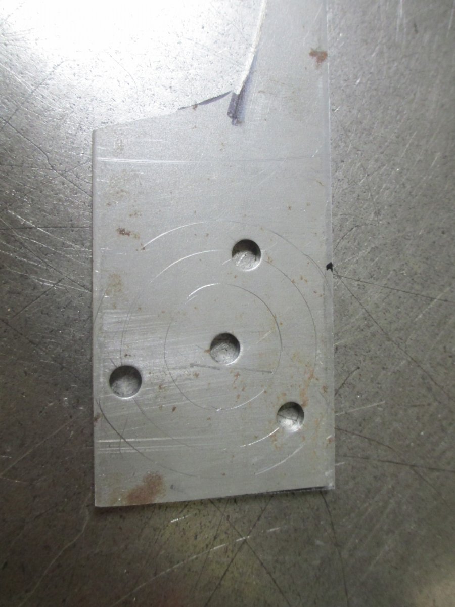

    I worked at setting the backlash on the Pat Warren rear today. As I stated quite a while back, using these sideplates, the spool area of the live axle is far different as far as offsets related to the ring gear mount, compared to stock Ford housings. Halibrand sideplates are similar to Ford housings. Without having the live axle that matched the PW parts, I had to start from scratch to get the proper dimensions. My friend who will machine the new spool to be pressed onto the 4130 tube axle, made up a test spool, as you see in the lathe. It had the ring gear flange, and a couple of sleeves pressed on, my chore was to carefully machine a little here and there, until it I could get the unit together, with the proper clearances. Another challenge was being able to keep everything stable, and not rolling around on the table. I rolled up the ring you see, that is welded to a steel plate, it holds it just fine. Usually when building any V-8 rear axle, we bolt the axle housing to a large truck brake drum, and stand it up vertical, so you can stack the parts during ***embly. Progress !!!!!!!! IMG_1916.JPG IMG_1917.JPG IMG_1918.JPG IMG_1919.JPG IMG_1920.JPG end today.

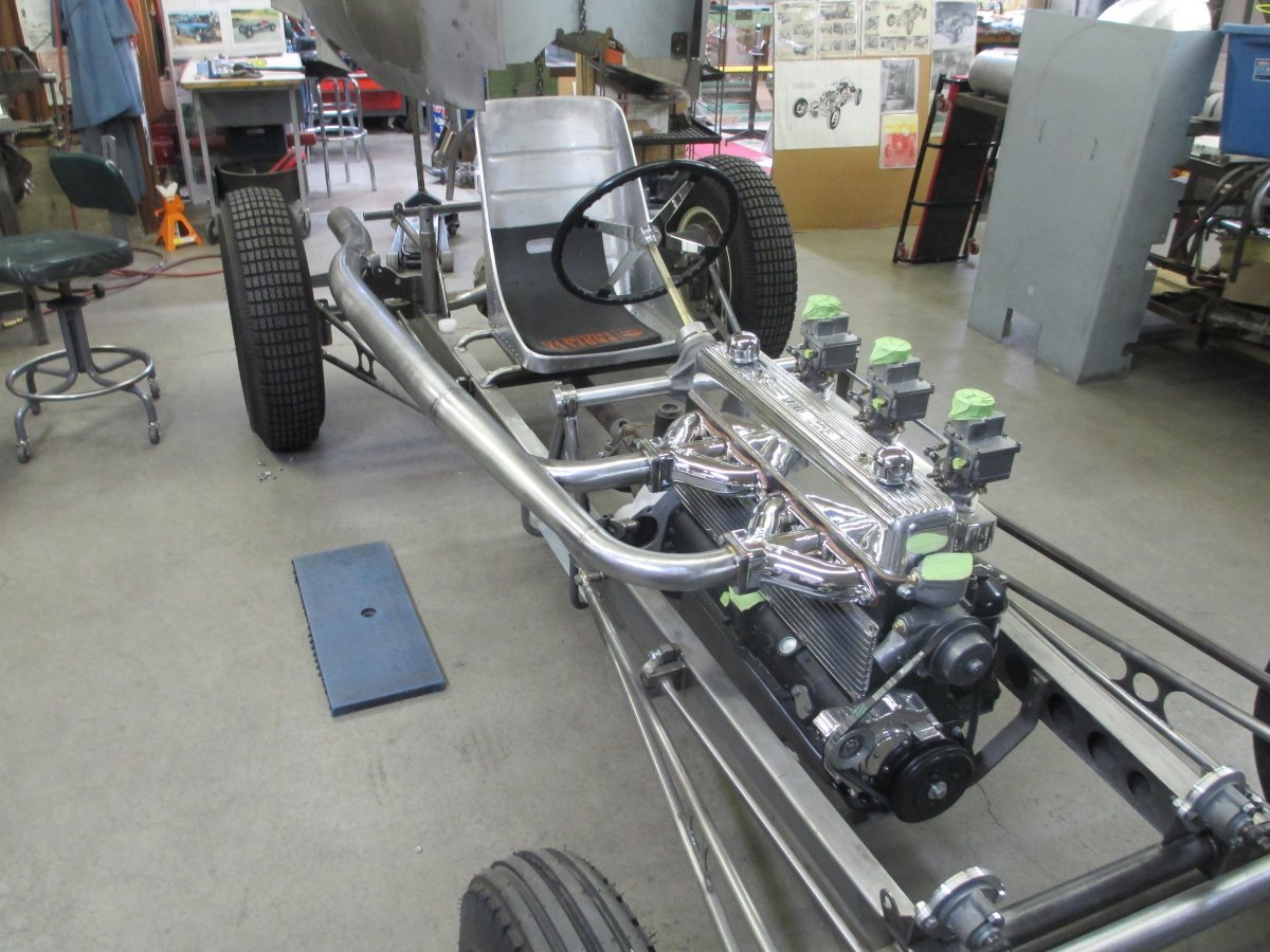

    I got the final curly cue on the side nerfs tonight. Here again without pictures of the original, I thought a triangle mounting plate would look appropriate. My machining on the real axle test spool, came out fine, the backlash and gear pattern is right on the money. Now I will turn it over to a real machinist to make the spool and complete live rear axle. The nose will be next, t******* it to fit, and get it mounted. Then mount the radiator, and build the hood. IMG_2013.JPG IMG_2014.JPG IMG_2015.JPG IMG_2016.JPG IMG_2017.JPG
