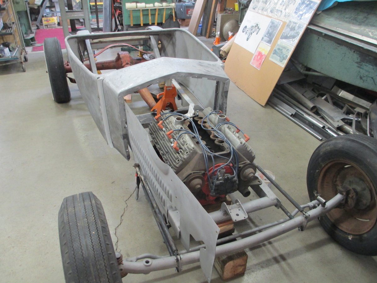

    An update on progress. Dennis Webb told Pat that it would have been better to have the car present when he built the nose, he certainly was correct. Since I am still in the learning stage on pounding aluminum, I am lucky to have master metal man Chris Kopp, to help me with the fit and finish on this phase of the car. Chris has worked at Indy shops, for and with the best names in vintage oval track cars, Midgets, Sprints and Indy cars. Men like Jerry Weeks, Don Brown, Don Edmunds, A.J. Watson, and Jackie Howerton, to name a few. The green tape line in the 3rd photo shows where the hood lap line needs to be when completed. Now for the big news, Pat and I, along with my pal Jim Lindsay Will be sharing a booth at the GNRS, in the main hall. Jim graciously agreed to exchange his 10 X 10 space for a 10 X 20, so we would have room for the car. Jim will be selling his book "The Little *******s", and his latest "Swerve", along with Pat hawking some of his books as well, we hope to meet some of you in person ! IMG_2239.JPG IMG_1869.JPG IMG_2196.JPG

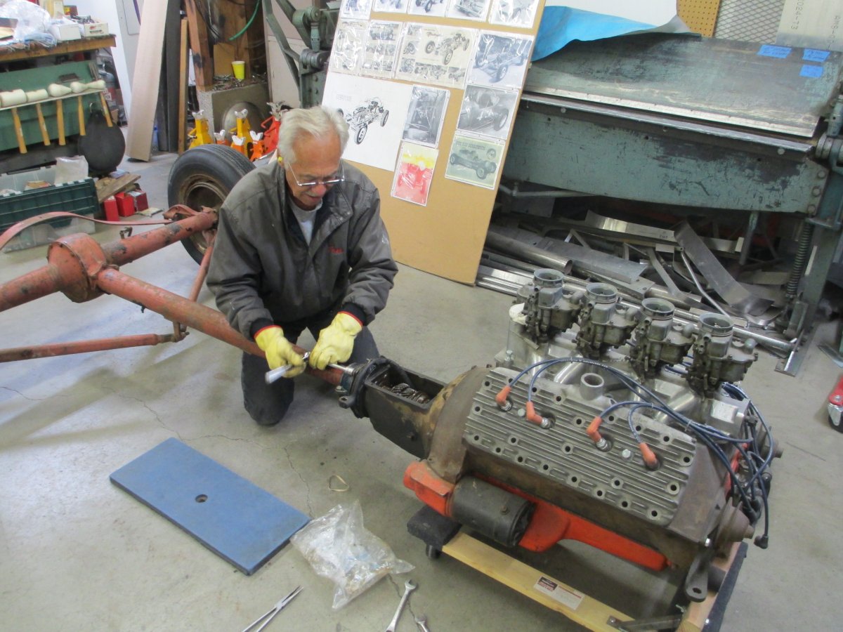

    I got the radiator mounted, using 10 ga lower plates and base clips. All pieces connected to the side channels will be tig welded with silicone bronze. The 3/4 round tube hoop will be used for the grille shell, upper mounting support. IMG_2240.JPG IMG_2245.JPG IMG_2251.JPG IMG_2252.JPG IMG_2253.JPG IMG_2256.JPG IMG_2257.JPG IMG_2259.JPG IMG_2260.JPG

    I have been working on the front shock links, and getting started on the hood. The hood mounting required a flange added to the cowl for the hood to rest on. Some 18 guage CR steel and the shrinker took care of that. My slip roll is only a 36 ", and the hood will be around 38" long in the finished state, so I used a friend's 48" roll. By getting some shape started to match the front and rear contours, I can carry on with the English wheel, and some arching by hand. Time is running out, but we will be at the GNRS, in the main hall, stop and see us if you are in town ! IMG_2313.JPG IMG_2314.JPG IMG_2315.JPG IMG_2320.JPG IMG_2321.JPG IMG_2322.JPG IMG_2323.JPG IMG_2325.JPG IMG_2326.JPG IMG_2327.JPG

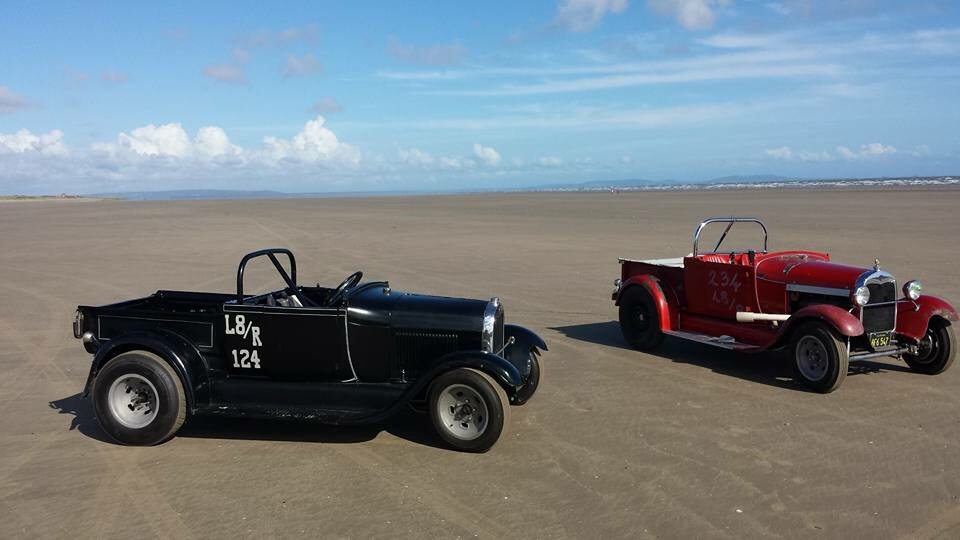

  23. Marty Strode
    Joined: Apr 28, 2011
    Posts: 9,684
    Marty Strode
    Dale, Do you have a landing strip that will handle a 737 ? With Dean's being the ultimate, I might have to settle for something similar to the black one for a while, at least. Dean Lowe 5.jpg Dean Lowe 6.jpg
