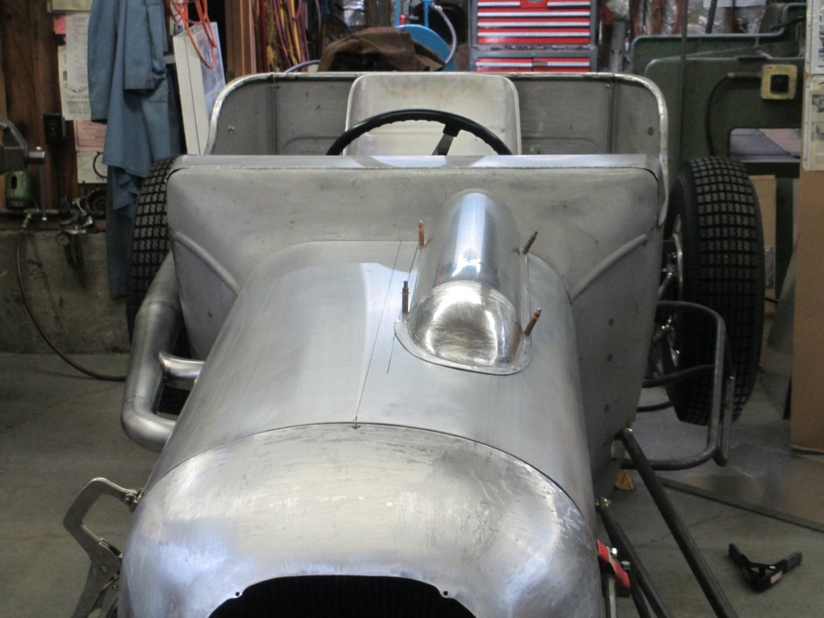

    Grille shell is in position, Chris Kopp came yesterday and finished rolling the joggle for the hood rest. Now, I am mounting the shell, and getting ready to do the final shaping and t******* to the hood top. IMG_2372.JPG IMG_2374.JPG IMG_2375.JPG IMG_2376.JPG IMG_2377.JPG

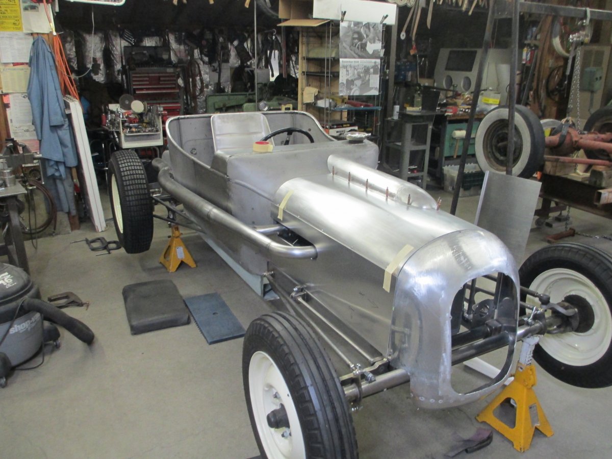

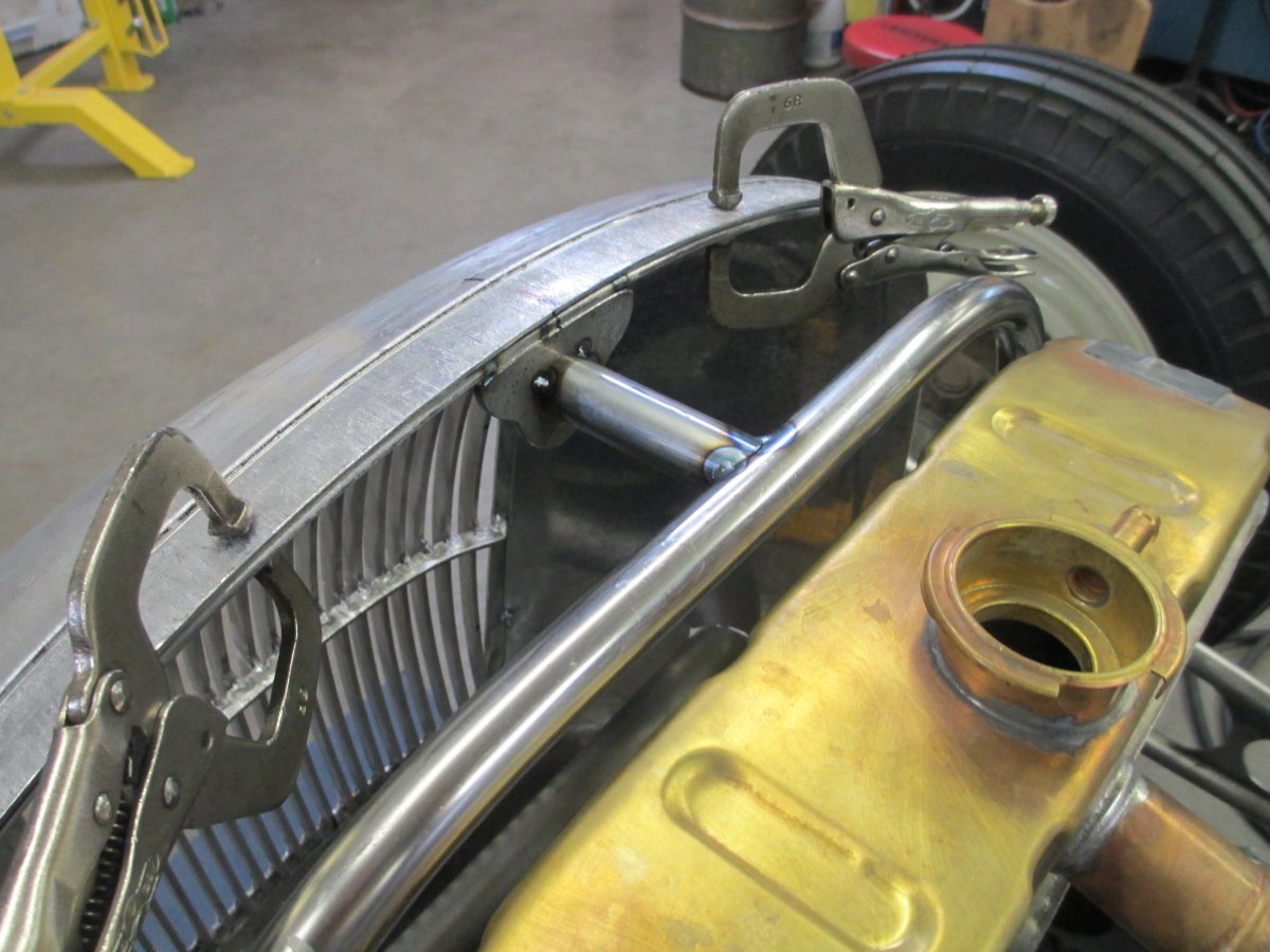

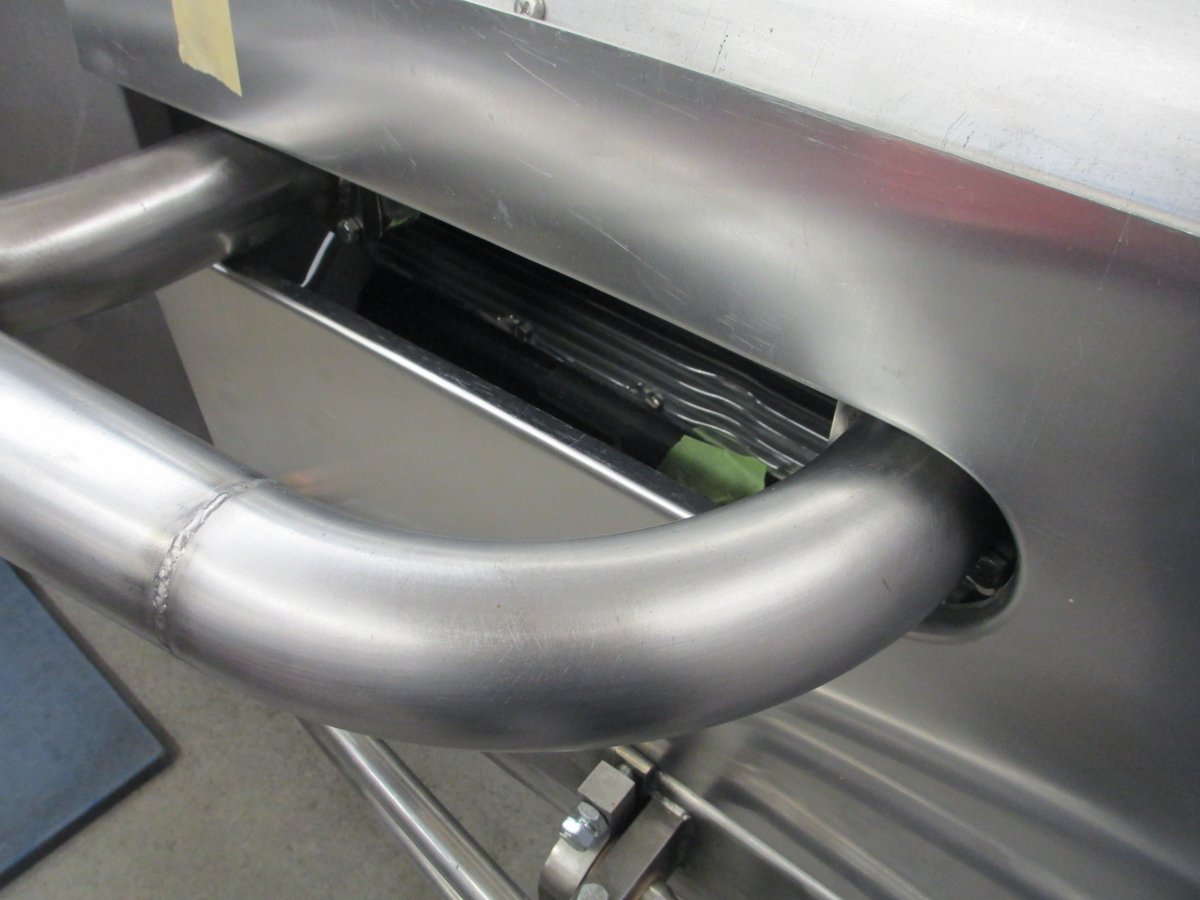

    When I awakened Christmas morning with something gnawing at me, I went to the shop and rectified the problem. When I mounted the radiator in reality, the grille shell/nose, should have been mounted first. The problem was, the space between the radiator/grille support hoop, and the nose was too narrow. So I clipped the base brackets from the frame, extended them 1-1/2" and re-installed them. To mount the nose, I rolled up a 1" wide 10 ga steel strip to fit under the hood rest lip, and built a bracket, an connected it up with a tube. I secured the shell to the strip with flathead #8 -32 screws. Notice the difference between the first and last photos. Hood is next. IMG_2361.JPG IMG_2379.JPG IMG_2380.JPG IMG_2381.JPG IMG_2383.JPG IMG_2384.JPG

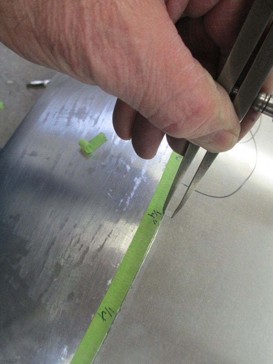

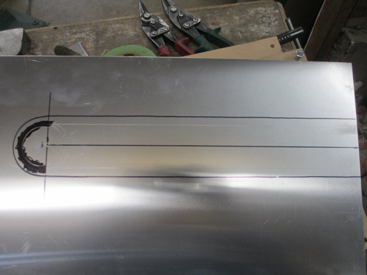

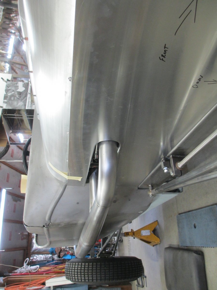

    Now for the hood. I usually start by getting the general shape established, and fit, trim and shape the rear seam. To do the final trim on the front seam, this is the process I use to transfer the trim line on the hood. It takes some careful action with aviation snips, filing and sanding for the final fit. The material is 3003 alloy, .063. Happy New Year ! IMG_2394.JPG IMG_2395.JPG IMG_2396.JPG IMG_2397.JPG IMG_2399.JPG IMG_2400.JPG IMG_2401.JPG IMG_2402.JPG

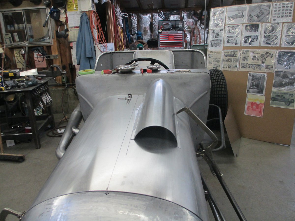

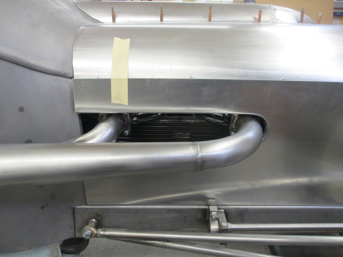

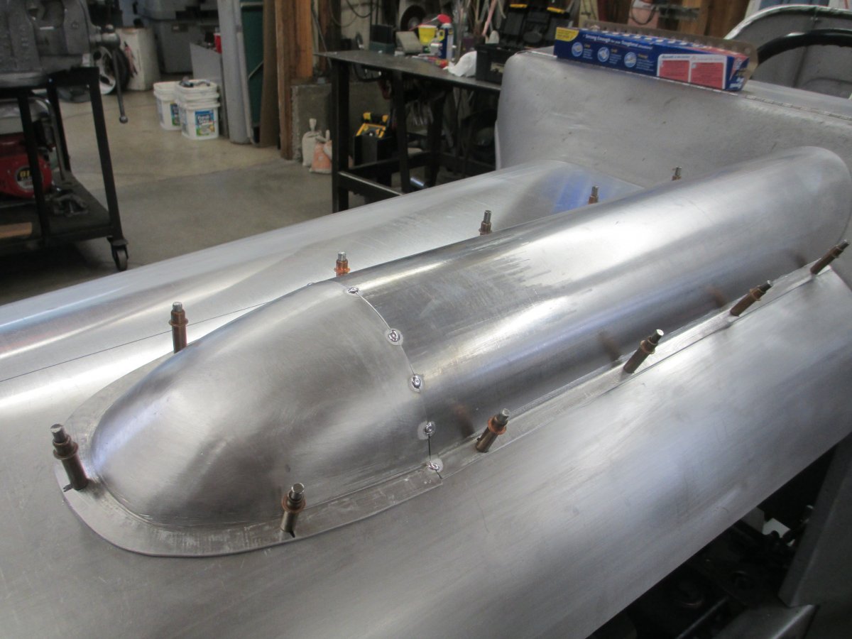

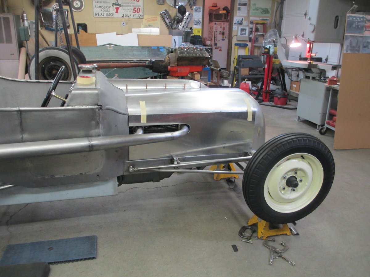

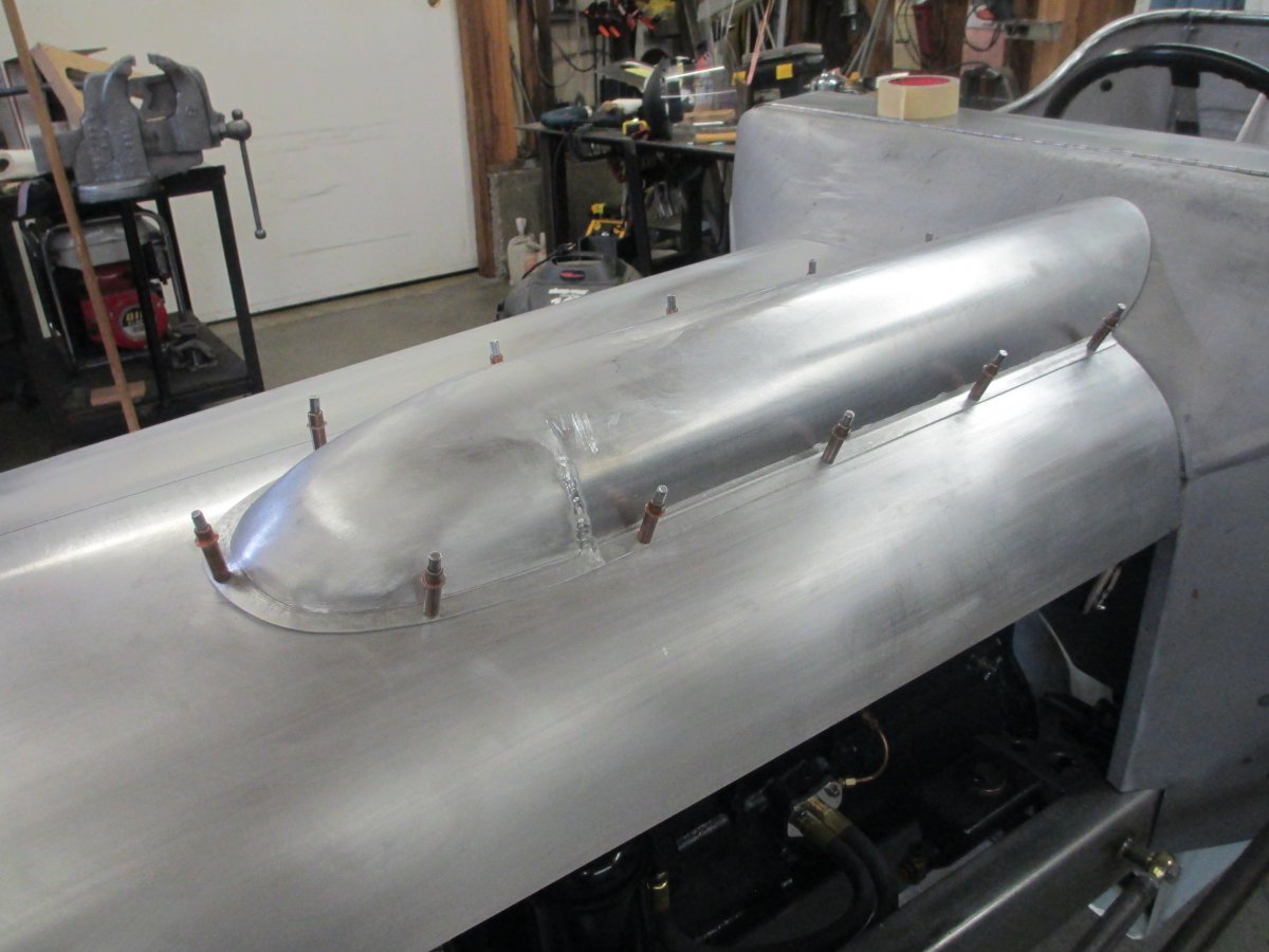

    Today I worked on getting the hood ready for the side panels. First, I sheared off the excess on the bottom edge, and mounted a stainless hinge on the p*** side. I have been thinking about the bubble on top, as was used when it ran carburetors. Using a remnant of .063, thinking it might work as a pattern, I rolled it, bent the edges, trimmed the contour at the back. Remarkably, I think it fits the bill, now I need to anneal the front and beat it into submission, and hopefully the shape of the front will turn out the way we want it. Tools used, shear, slip roll, brake, hand punch, snips, stretchers, and belt sander. Oh yeah, a drill, and band saw. IMG_2403.JPG IMG_2404.JPG IMG_2405.JPG IMG_2407.JPG IMG_2409.JPG IMG_2411.JPG IMG_2413.JPG IMG_2414.JPG IMG_2415.JPG IMG_2416.JPG
  22. Marty Strode
    Joined: Apr 28, 2011
    Posts: 9,685
    Marty Strode

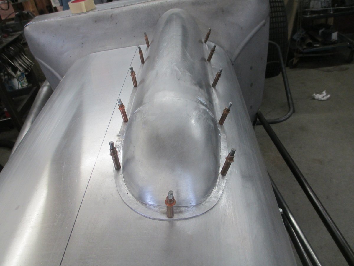

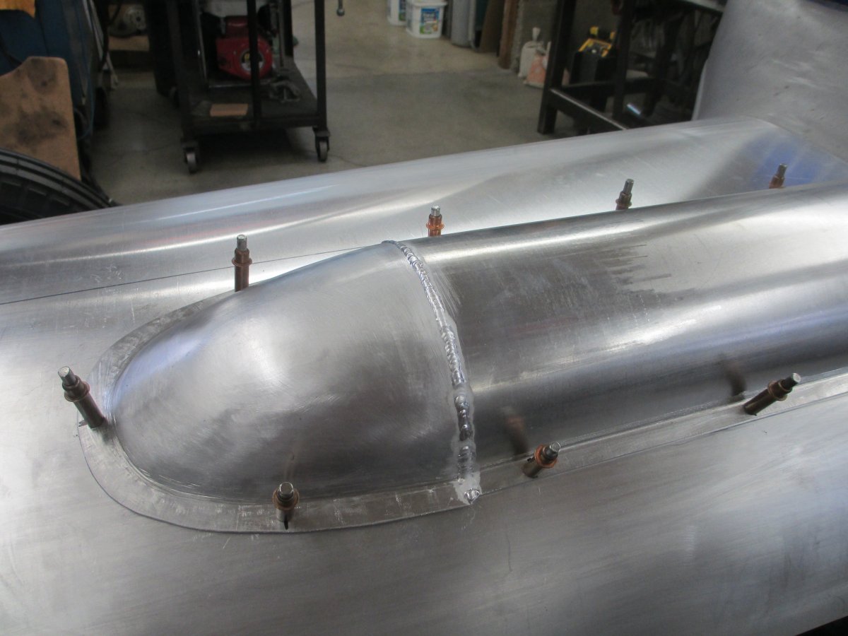

    I worked on the nose of the bubble, thought I could shape the front of the existing part, but ran out of talent. So, I sawed off the damaged section and started with a new piece. My method is always the same, start with an annealed sheet, with plenty of excess material, and tuck shrink it on the stump. Then move to the sandbag, English wheel, planishing hammer, tipping die, and stretcher. If it meets Pat's approval, I will weld it together, and move to the next item on the list. IMG_2421.JPG IMG_2422.JPG IMG_2423.JPG IMG_2425.JPG IMG_2426.JPG IMG_2427.JPG IMG_2429.JPG IMG_2430.JPG IMG_2431.JPG IMG_2432.JPG

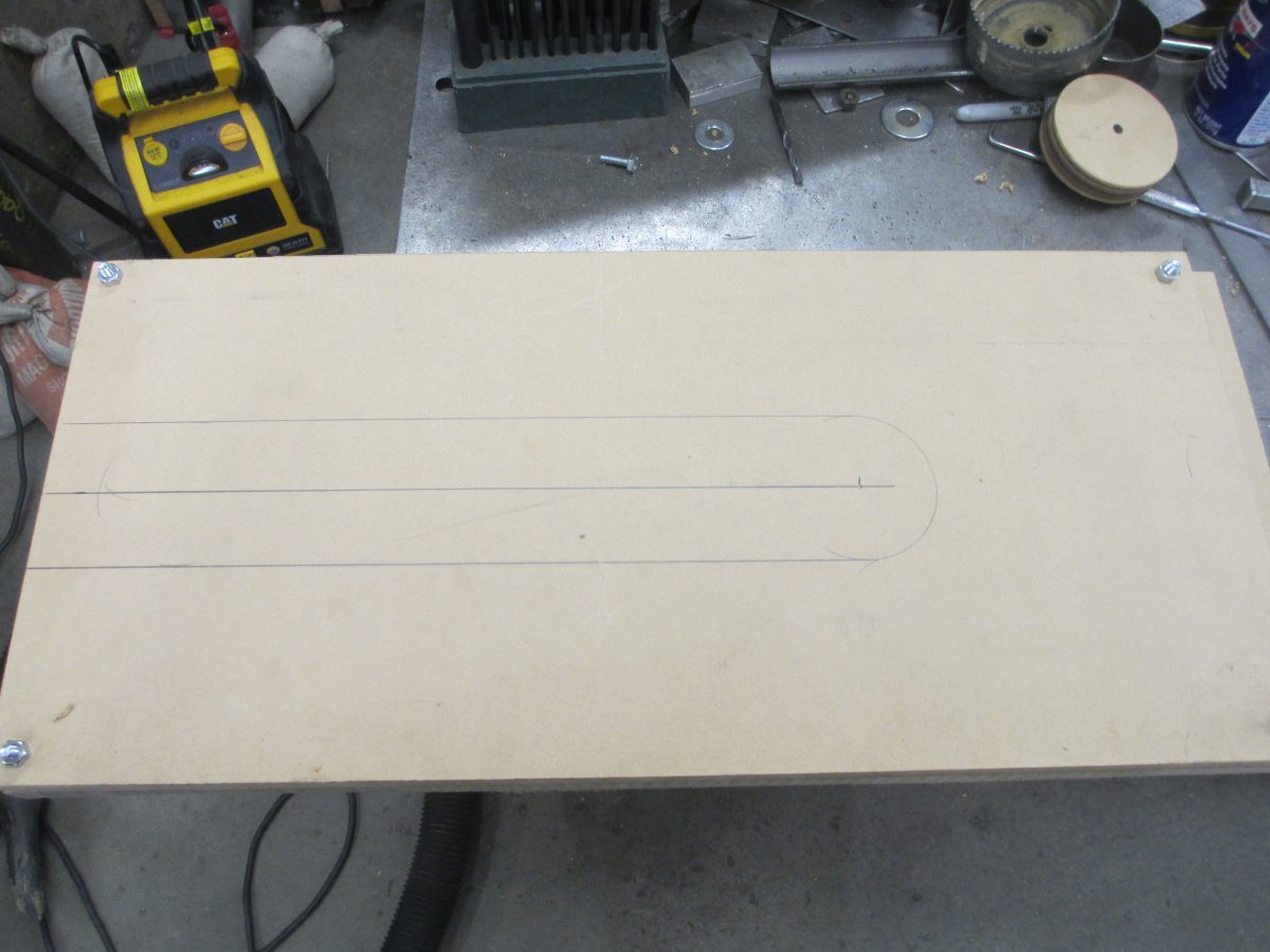

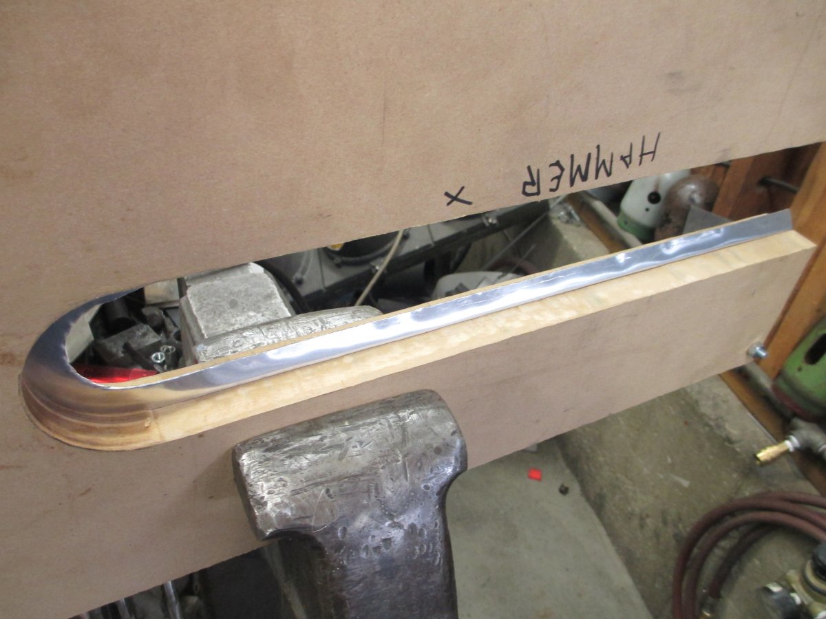

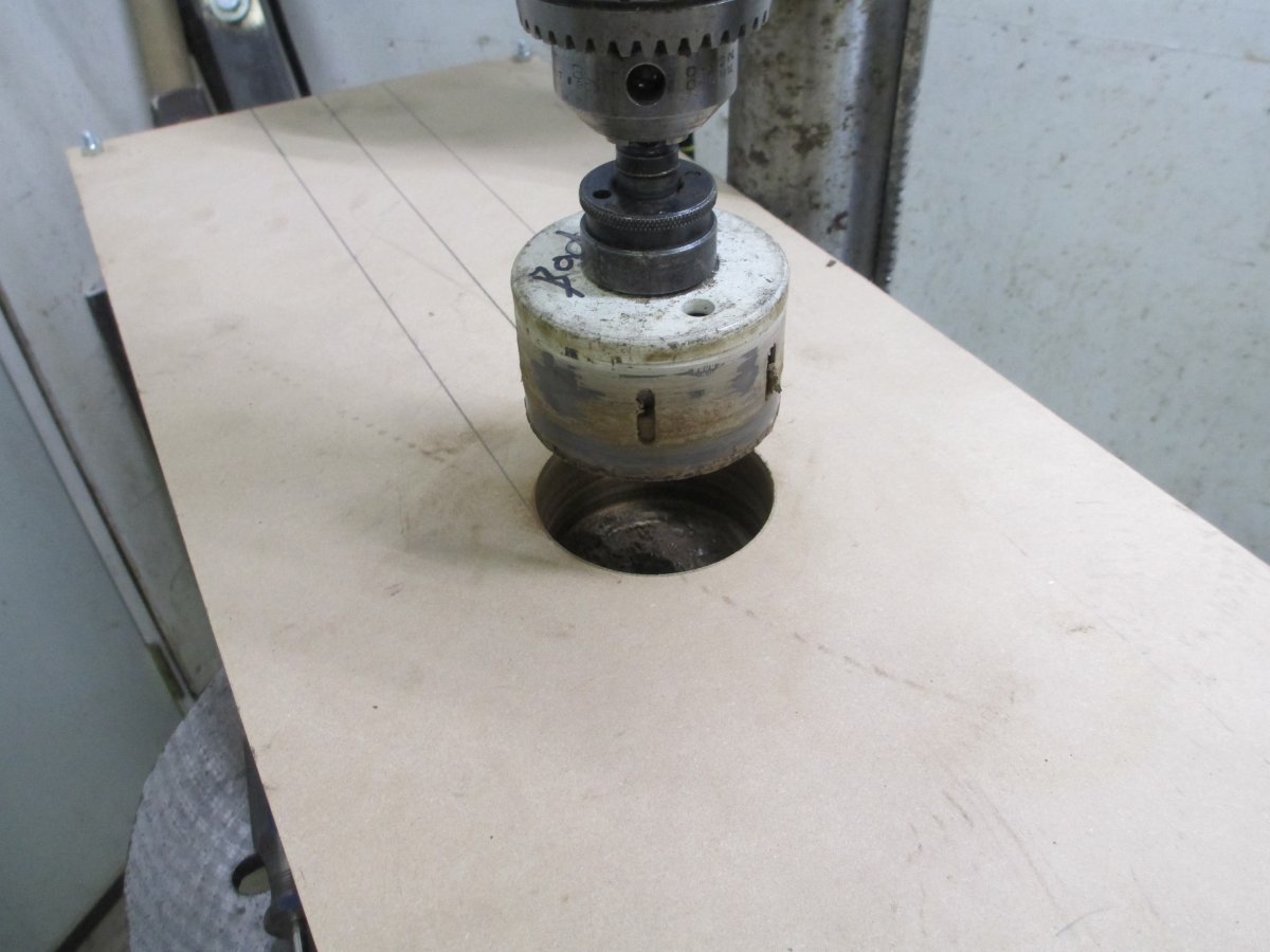

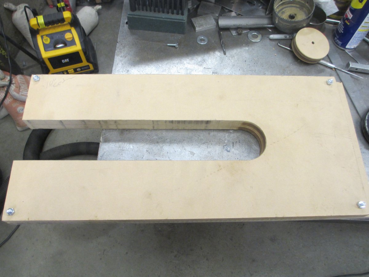

    I built a hammer form, for the RH hood side. Tomorrow I will shear the panel to the correct size, and start getting it mounted. IMG_2439.JPG IMG_2441.JPG IMG_2444.JPG IMG_2445.JPG IMG_2446.JPG IMG_2447.JPG IMG_2448.JPG IMG_2451.JPG IMG_2452.JPG IMG_2453.JPG

    Got a photo of the front of the bubble welded on? You do just amazing fabrication Marty!

    Rich, ask and you shall receive, it still needs final grinding. I got your email, Friday should work just fine, it would be nice to see you and the boys. Did Tim share my video with you ? Stogy, Thanks, and Happy New Year, to you and yours. IMG_2434.JPG IMG_2435.JPG IMG_2455.JPG IMG_2456.JPG IMG_2457.JPG
