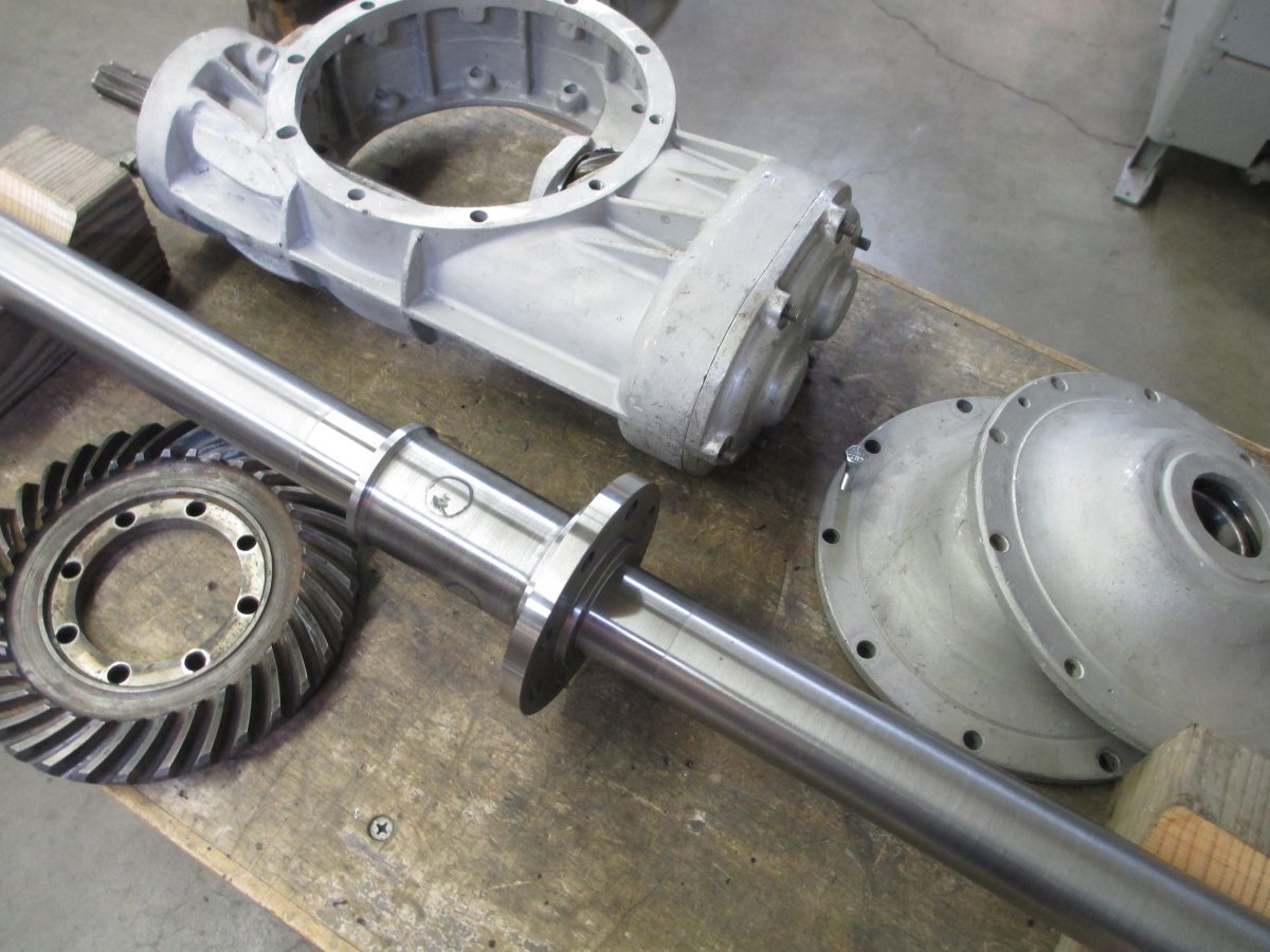

  5. Marty Strode
    Joined: Apr 28, 2011
    Posts: 9,689
    Marty Strode

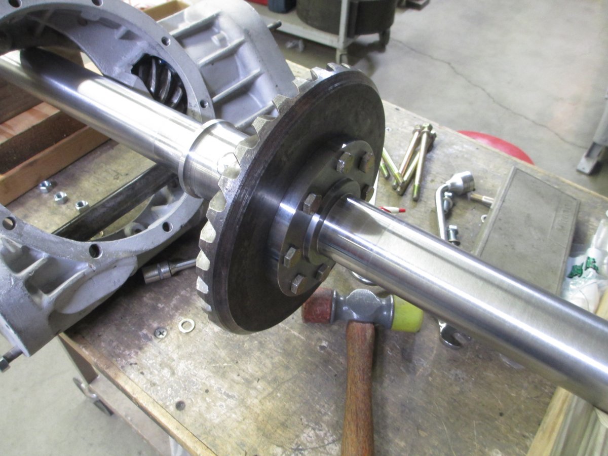

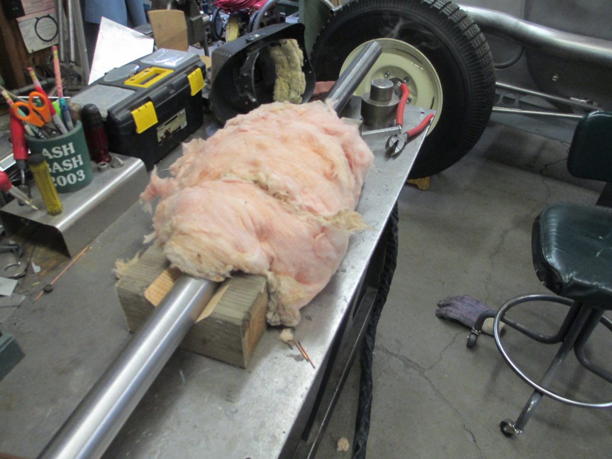

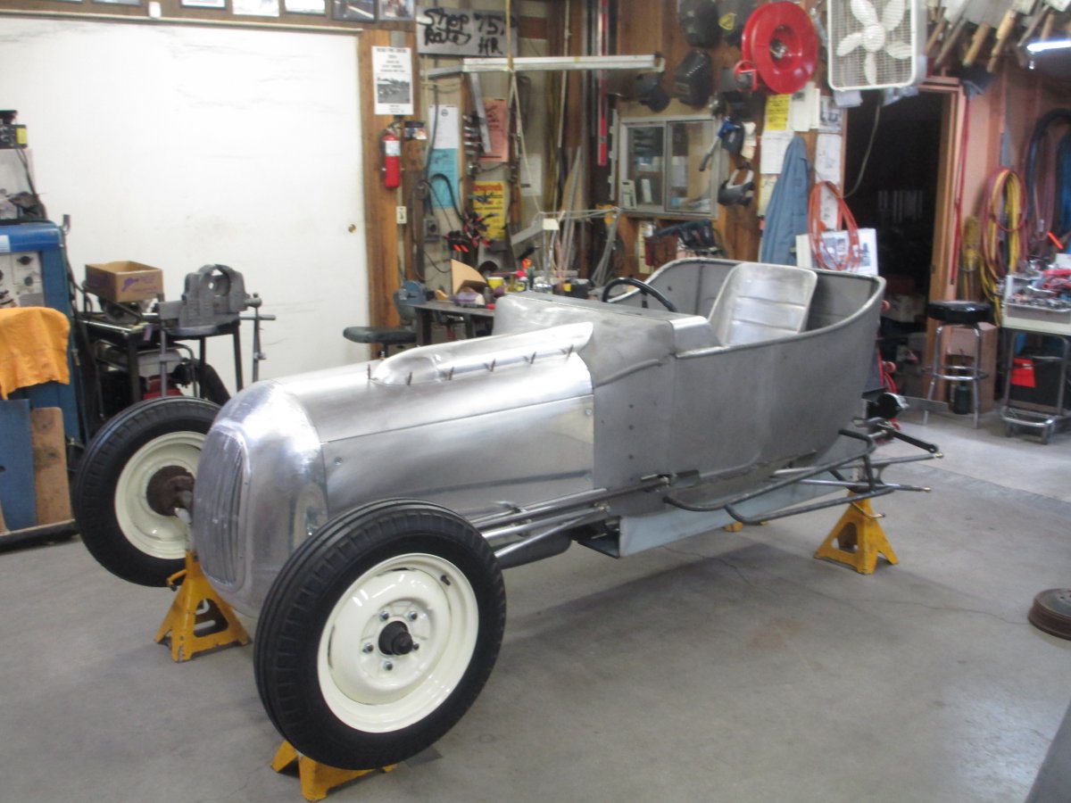

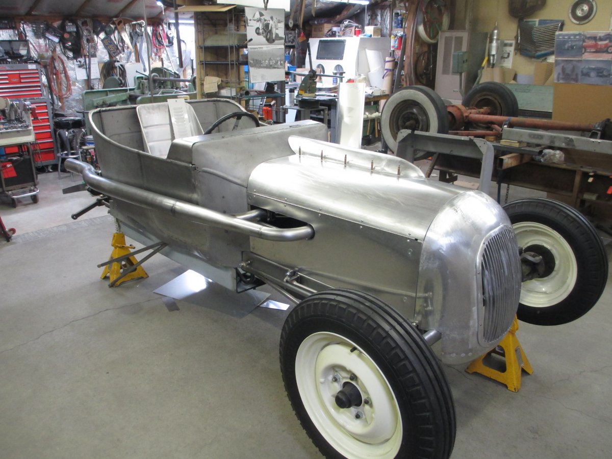

    19 days until I have to have the car loaded for GNRS, busy times around here ! My machinist got the new ring gear mount machined, and sweated onto the 4130 CM tube. I welded it, and am cooling it slowly. Now I am going to pull the setup rear axle out of the car, so he can determine the total axle width. He will machine and install the end stubs, for me to weld. Some final machining and I can ***emble the Pat Warren rear axle unit complete. IMG_2469.JPG IMG_2470.JPG IMG_2473.JPG IMG_2476.JPG

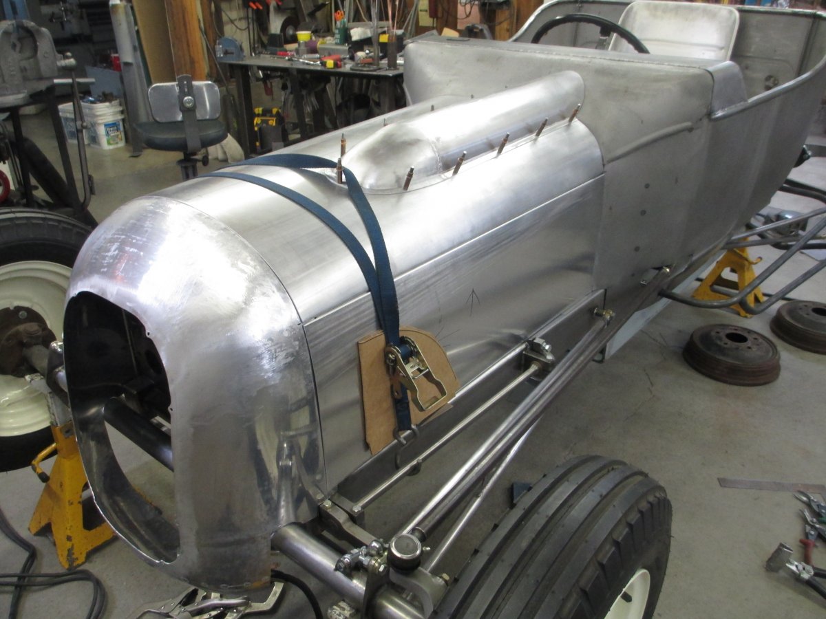

  11. Marty Strode
    Posts: 9,689
    Marty Strode

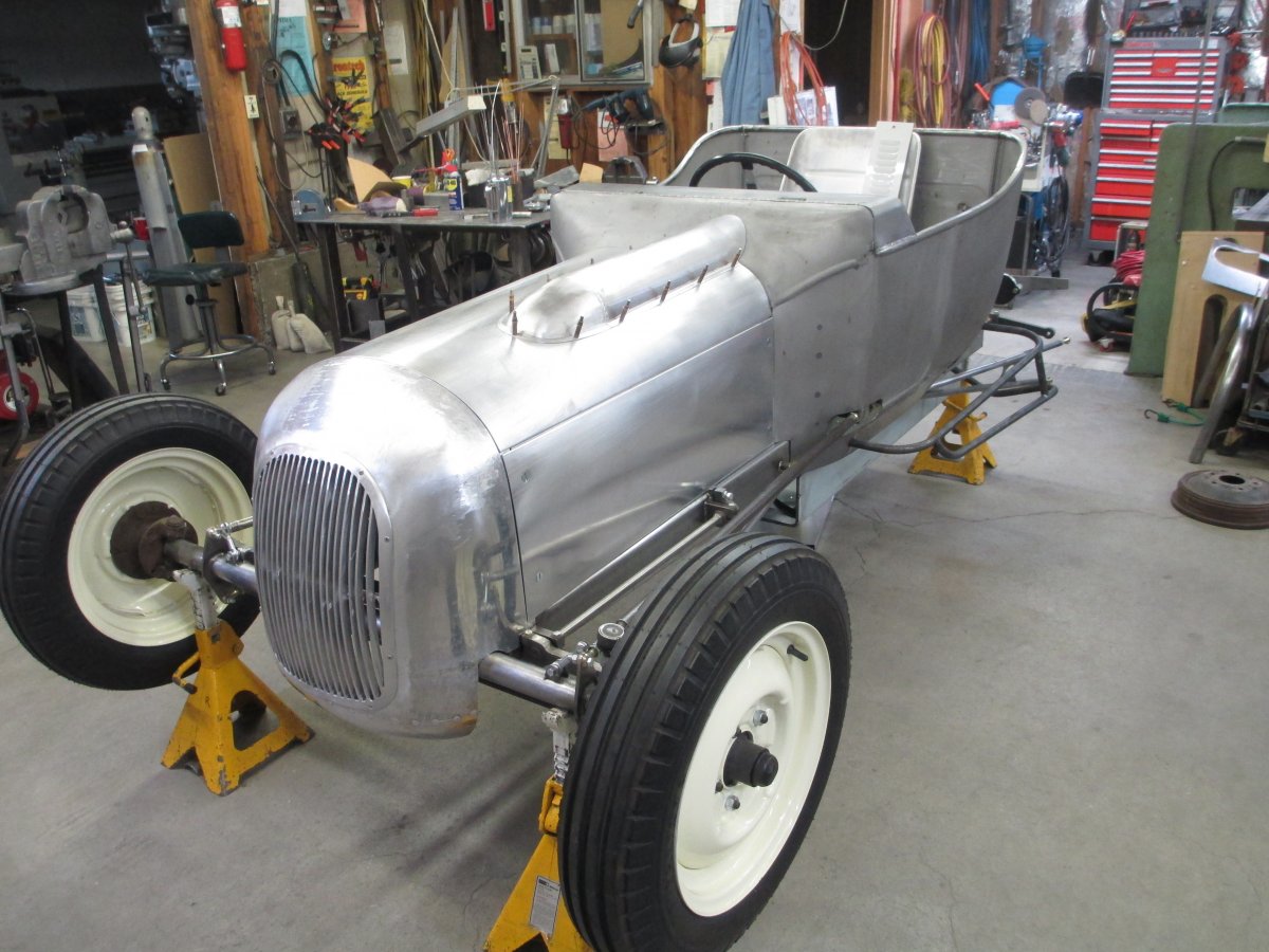

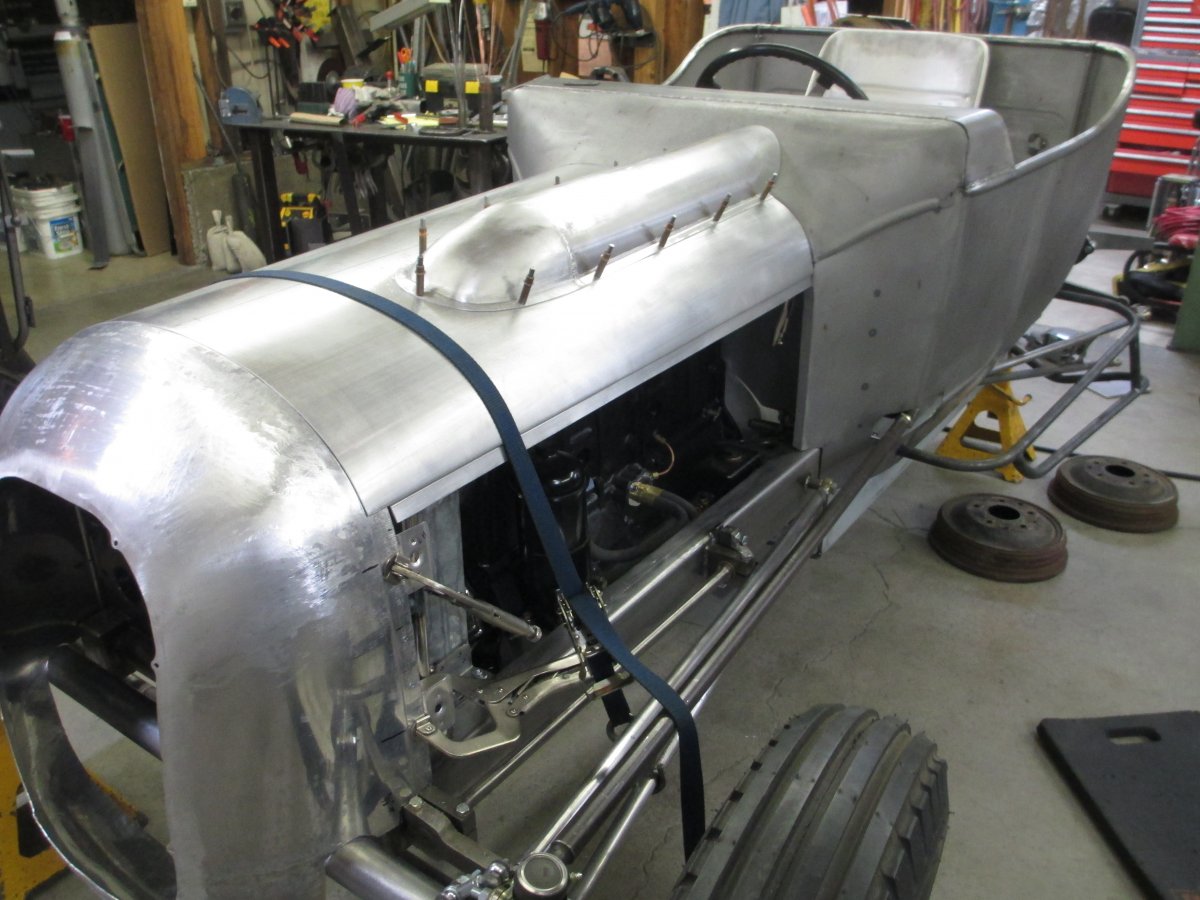

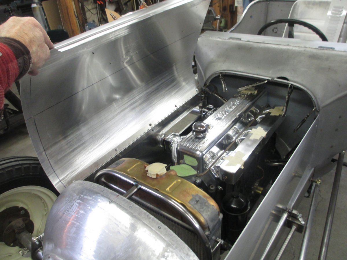

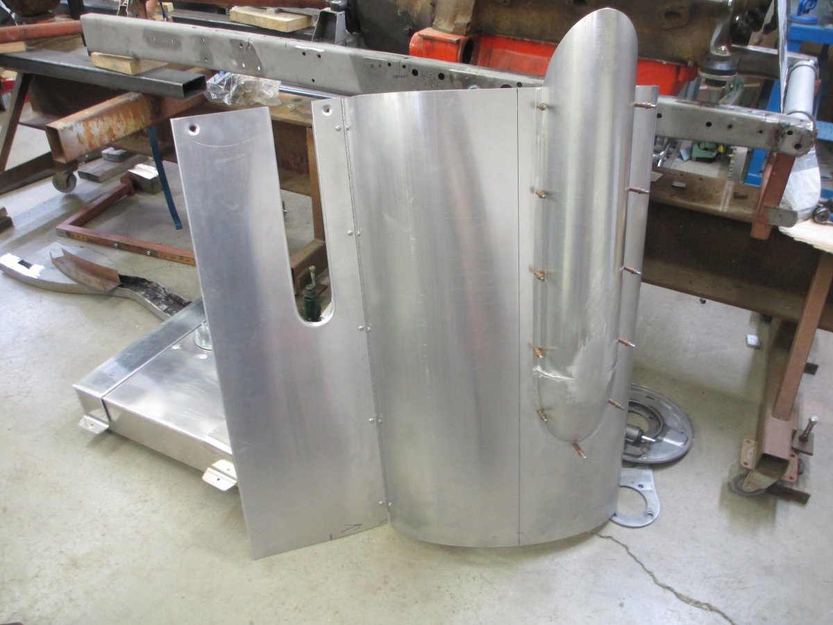

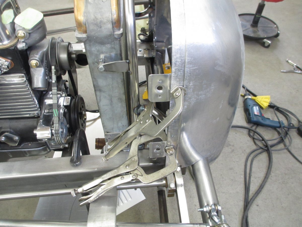

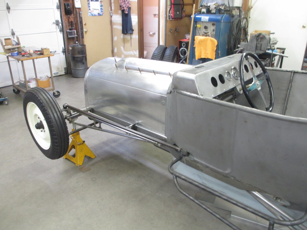

    I finally got both side panels done and hinged on the right side. Buckles and louvers tomorrow ! IMG_2499.JPG IMG_2501.JPG IMG_2505.JPG IMG_2506.JPG IMG_2508.JPG IMG_2510.JPG IMG_2512.JPG IMG_2513.JPG IMG_2514.JPG IMG_2515.JPG IMG_2516.JPG IMG_2520.JPG

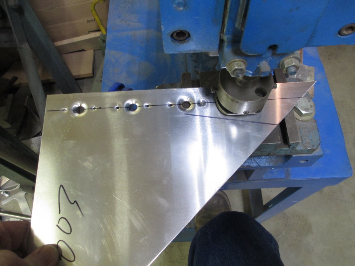

  19. Marty Strode
    Posts: 9,689
    Marty Strode

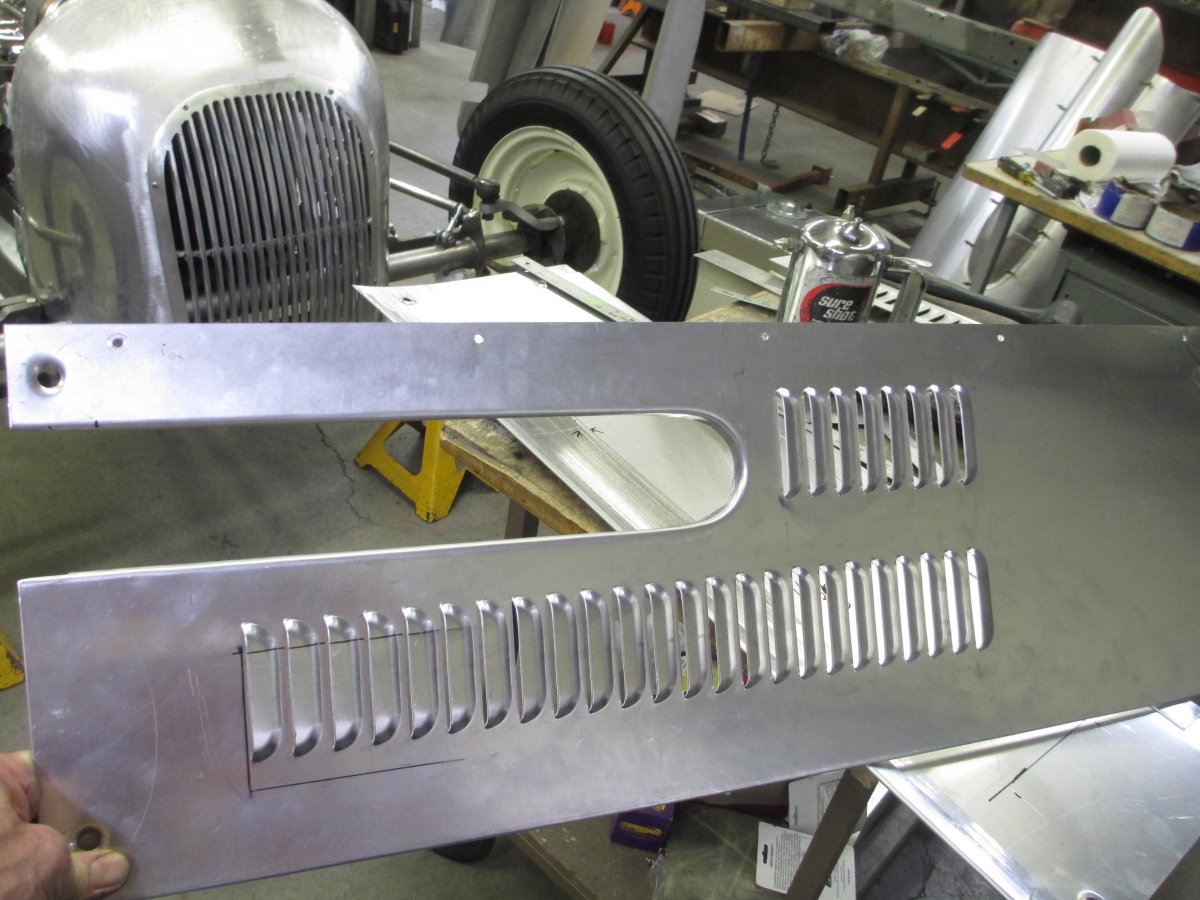

    Thanks for the kind comments, my friends ! I dug out my old louver press, that belonged to my late friend and mentor Jerry Hill, and put it to work. Quite frankly, punching louvers is not fun for me anymore, especially when doing parts you have some time in, it's nerve racking. All and all, they turned out as planned. The rear axle is getting the final machining today, I hope to be ***embling the quickchange this weekend, as time is running short. More later. IMG_2521.JPG IMG_2523.JPG IMG_2525.JPG IMG_2526.JPG IMG_2528.JPG IMG_2529.JPG IMG_2532.JPG IMG_2534.JPG IMG_2533.JPG

  30. Marty Strode
    Posts: 9,689
    Marty Strode

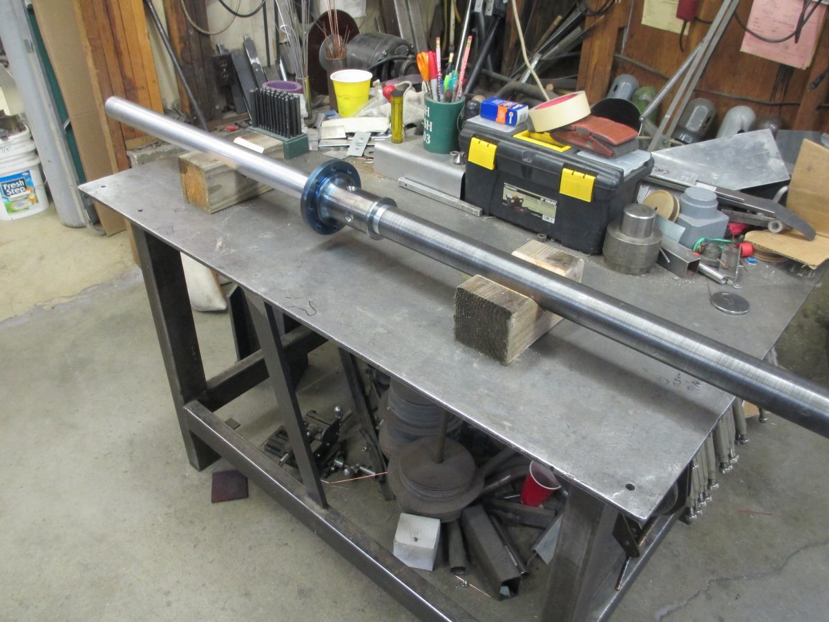

    The rear axle adventure is nearly over, my thanks to my friend Lester Knorr for finding the time to machine this masterpiece live axle. It will be under the car today. IMG_2574.JPG IMG_2576.JPG IMG_2577.JPG IMG_2590.JPG IMG_2584.JPG
