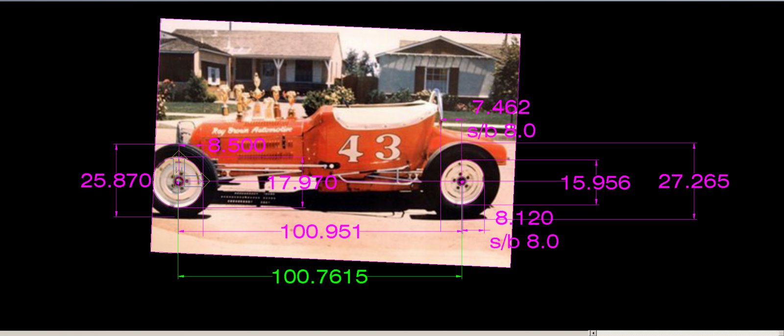

    Well, it has been a week (almost to the minute) since the start of this thread, Pat and I are amazed at the interest and support of this project, with over 6,000 views, 5 pages and generous offers of ***istance. I have had an almost "uncanny" sense of timing, for most of my life, and last week wasn't any different. Ever since Pat and I started this project, I have been trying to get the wheelbase length figured out. About a week and a half ago, a friend stopped by my shop with another guy named Tony Briski, who is an engineer and car builder. Tony offered to help me scale the wheelbase (with his computer), if I could come up with a true side shot of the car. Shortly after the thread started, Gofannon posted this great side shot. I sent the pic to Tony, and this arrived earlier this evening, it's pretty close to what I was thinking. Thank you all, we are going to make this fun and interesting !!!!! Spalding wheelbase analisis layout..jpg

    Yeah it looks 101". After a while you can eyeball pretty close. Grabowski's first black version was 101 with the spring on top of the differential. When he put the newer rear end in it changed to 96. I'm sure Ivo copied the black version. He told me his T had a 101" W.B.
