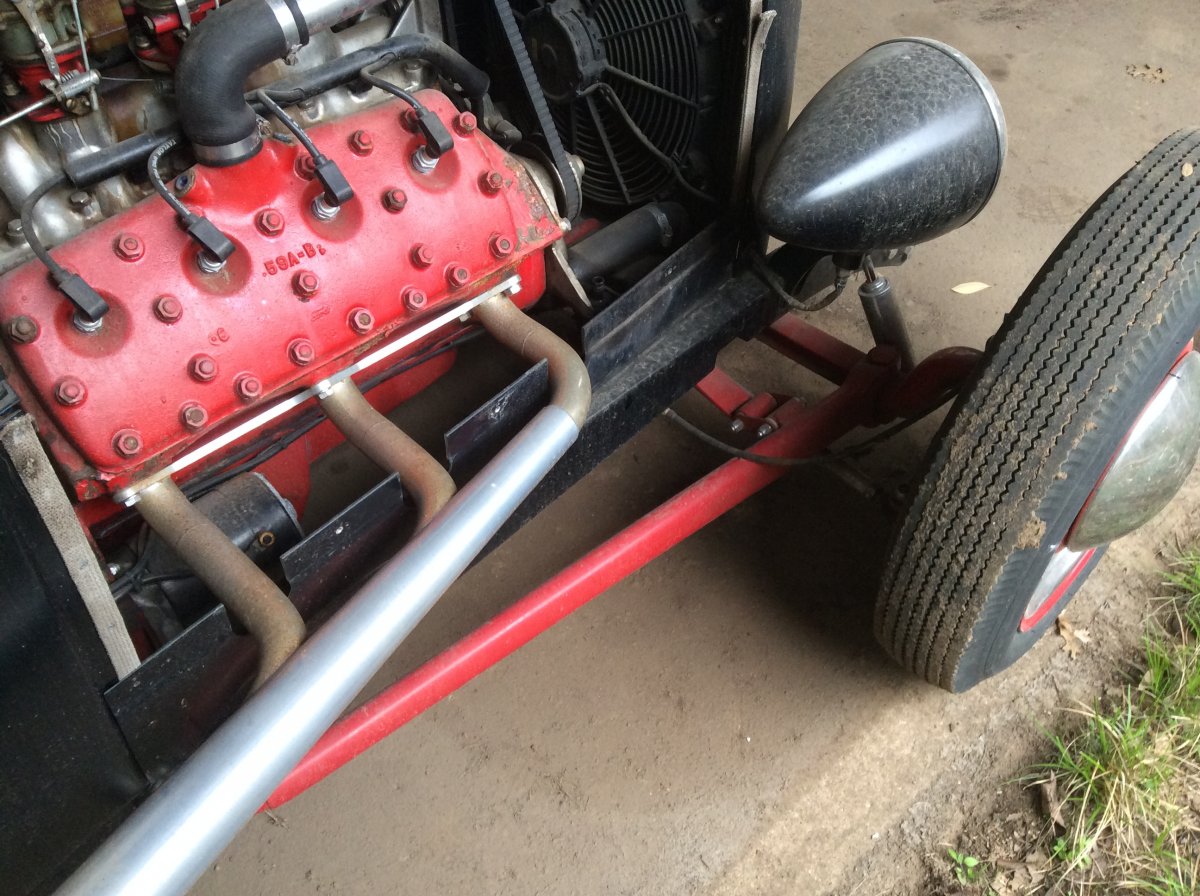

    Going back and looking at the construction of the front axle it looks like a sleeve is inside the axle where the ends weld on. What wall thickness is that inner sleeve? I made my tube axle for one of my projects using 2 inch 0.250 wall dom milling the ends for the kingpin bosses. Of course I welded them in before making brackets. I made clamp on brackets, one of which pivots like Kurtis did on Indy roadsters, but they are heavy. I want to make bracketry similar CAE had, and your axle construction method will allow me to ket them on the axle. Thanks

    Dave, The front axle was built by BC Choppit on here. The ends are built with a flag welded to the boss, wrapped with a sleeve, fully welded, and machined. The king pin bosses are honed, for a perfect fit. He then inserts the ends (with a minimum of 2" inserted into the 1/4" wall tube, and welded. I had him leave one end off, so I could slide the link plates on, and weld the one end. I can't find the photos of the end, prior to the install. If you contact Bill, he will show you how he does it, and build one if you desire.

    Thanks. I can picture what it looks like from your description. I guess I'll be making a new axle that way, or using the heavier swing sleeve already made.
