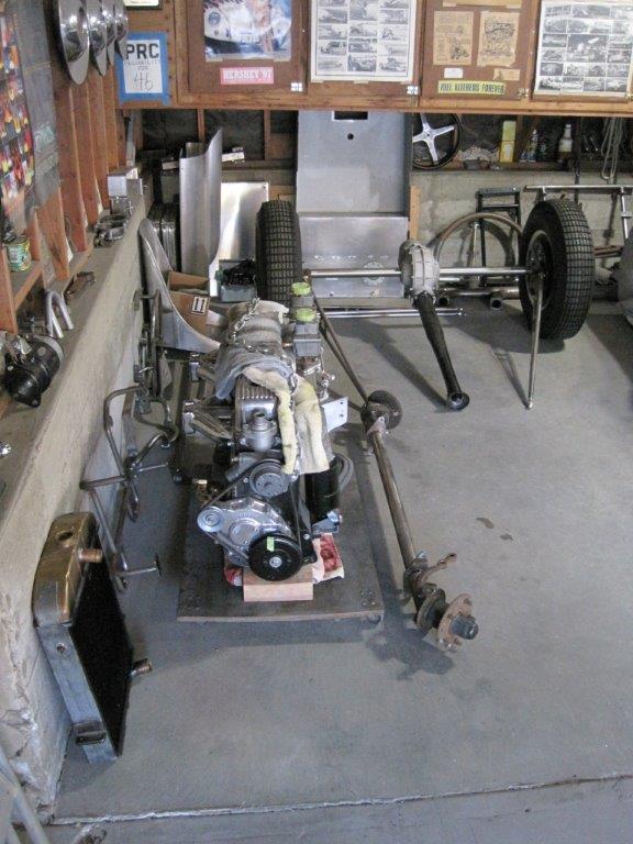

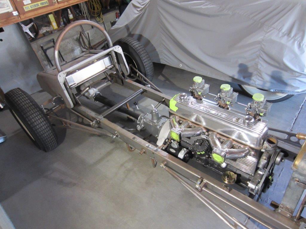

    We have some progress to report, and since Pat is busy with his Blog, and working on the Spalding, I am going to post some of his pictures. Now that his 33 Sedan is finished, he has been finalizing, linkages, plumbing and details. He has it torn apart, to paint the frame and make his decision on chrome plating. Pat 8.jpg Pat 7.jpg Pat 6.jpg Pat 5.jpg Pat 4.jpg Pat 3.jpg Pat 2.jpg Pat 1.jpg

    Hey Marty, Thanks for posting these, as well as this whole thread. I just got some fresh DP primer/sealer yesterday and will primer the frame today, hopefully make it orange early next week. Also took the first load of chrome (axle, hairpins, drag link, etc.) down to Buena Park yesterday.
    But I have one problem, and I'm cautiously asking HAMBers reading this to hopefully help me out. My engine came with three Stromberg BXOV 2 1-bbl. carbs, same as what Spaldings first ran. They haven't been run since '48-'49, so are in excellent condition. I got rebuild kits from Carburetor Carl, and Tom Taros cleaned and rebuilt the carbs "as is." He also measured jets, air bleeds, dump tube, etc. and I have those measurements. However, these carbs were run on alcohol, which I was going to do. But not being able to find a "right" alcohol-friendly elect. fuel pump, and knowing what a h***le cleaning everything is with alky, I decided to run the car on gasoline, which will be simpler and more practical all around. The problem is that I can't find anyone who really knows anything about these carbs today. I can't even find a good stock "core" to see what jets, etc. it has in it for gas. I'd even settle for a manual (or copy) with an exploded view, and hopefully spec charts for jets, etc., for different stock applications. Then, once I can get a good idea of what sizes I need, I need a source to obtain these components (I can get main jets--same as 97s--but might need bleeds, tubes, etc.).
    I've been told about CarbKing here on the HAMB, and will try calling him Monday. But if anybody here has any actual experience with these carbs, on gas, and can give me either good specs, or even a good stock carb to see what's in it, or maybe even a copy of a Stromberg factory manual covering the BXOV 2, I'd be very interested in learning or obtaining it. I'm talking actual experience or hard info, not "I had a friend once who ran those." I'd certainly appreciate it, and of course I'm willing to pay. You can PM me here, or email RPGAN@Charter.net. Thanks HAMBers.

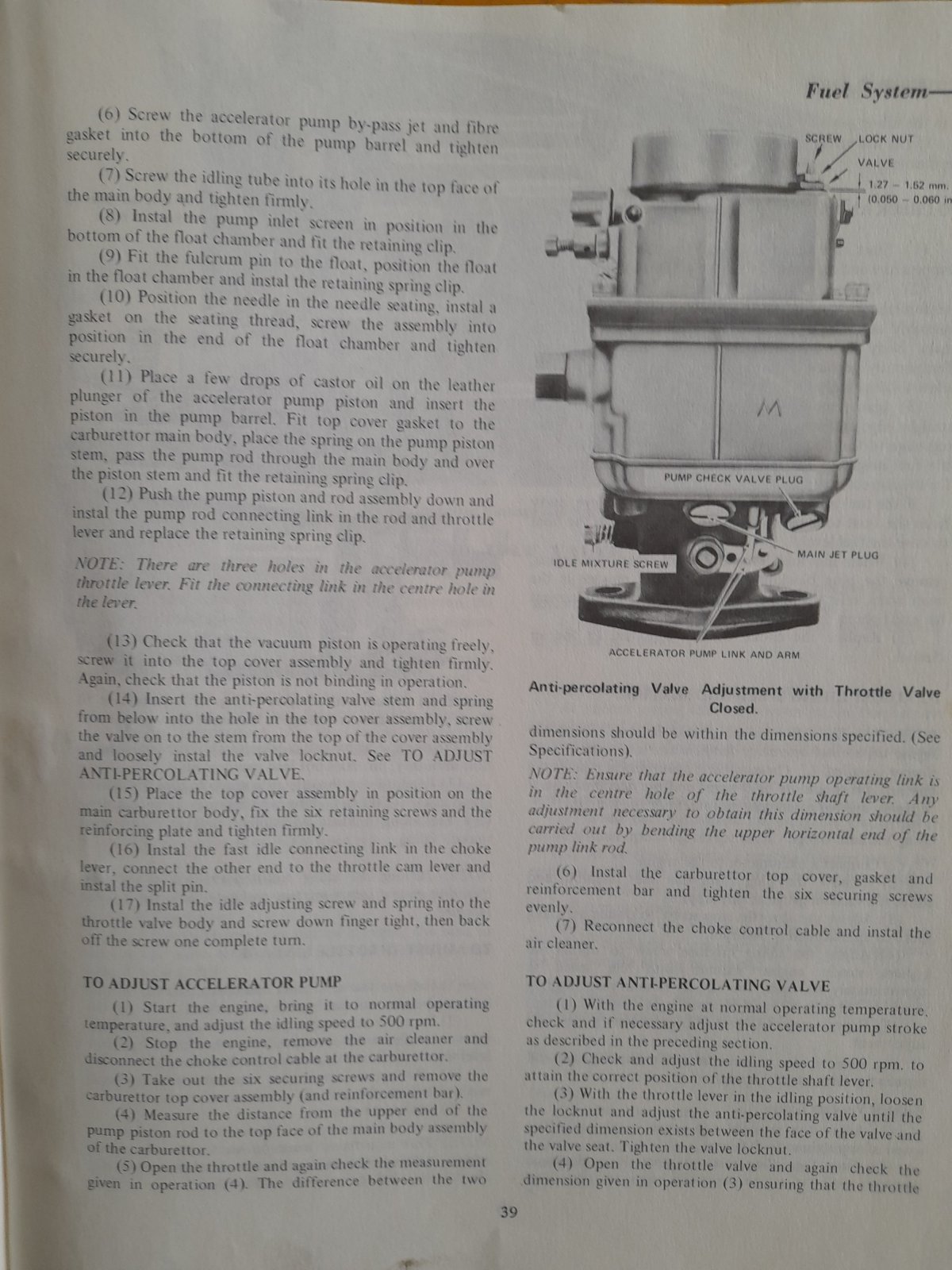

    Holden HQ used BXUV-2 or BXV-2. I have an SP Workshop Manual for HQ-HJ Holden that covers those.
  29. Gofannon
    Joined: Feb 8, 2007
    Posts: 993
    Gofannon
    I don't know if this will help, but here's the relevant pages from the HQ-HJ workshop manual.
    302GMC, Blues4U, Hamtown Al and 4 others like this.

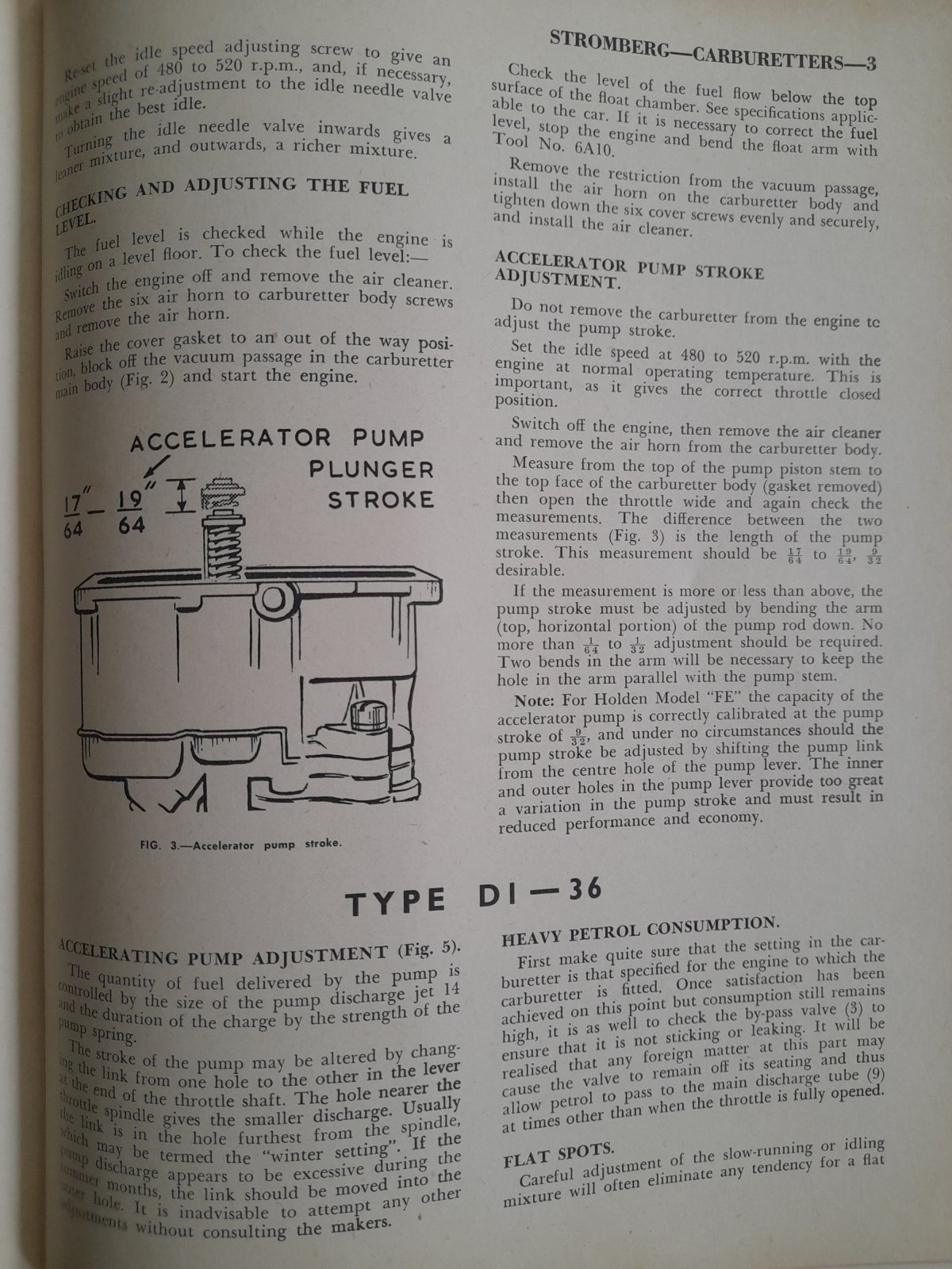

  30. Gofannon
    Joined: Feb 8, 2007
    Posts: 993
    Gofannon

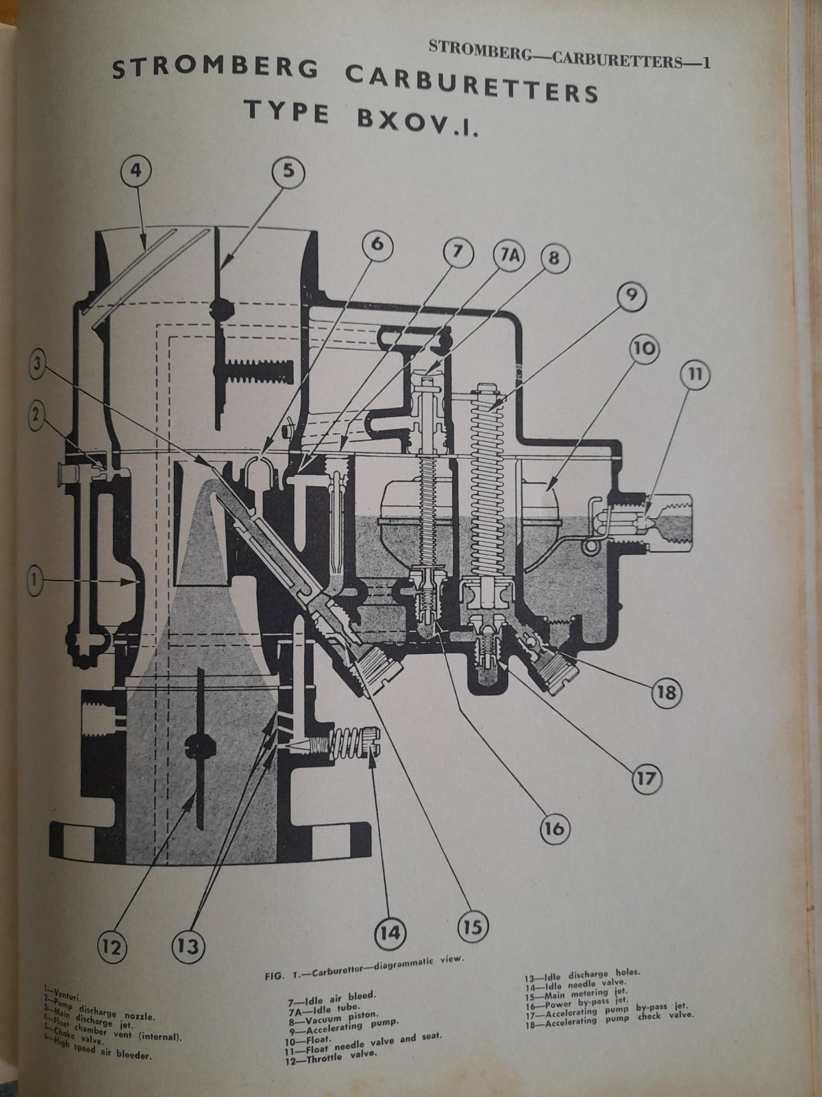

    And a BXOV-1 from a 1958 copy of AutoServ Book II.
    brEad, Blues4U, Hamtown Al and 6 others like this.
