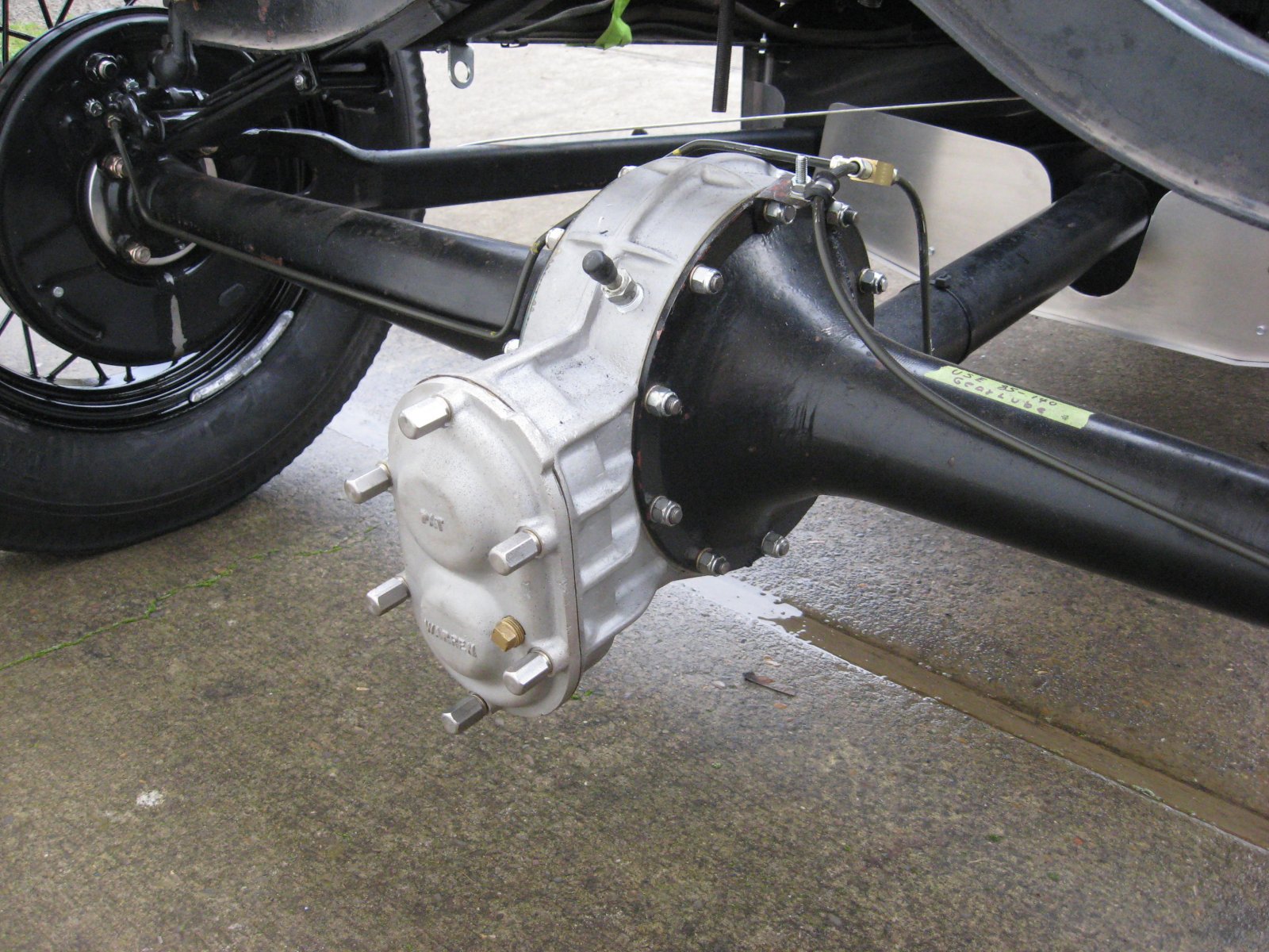

    Jeff, did you have the PW sideplates ? These came from Hamb Member @ Les Moran from Perth, Australia. He gave them to us for the freight cost. Thanks again Les !

    No, not really. That one looks like a Halibrand with a Warren rear cover (they fit just fine). Mine didn’t have ribs going over the top.

    Just to answer a couple of quick questions: Like Halibrand, Pat Warren (Downey Machine Co.) made at least three different size QCs, for midgets through Big Cars. Fortunately Halibrand V8 gears fit my Warren rear. I think Warren also made a 2-speed QC, which are quite rare (I've seen two). If you look way back through this thread, you'll see how sorry my center section was when I got it. It had been broken a number of times, poorly welded, rewelded, then even had some extra "fins" added on the bottom. I cleaned it up as best I could, then Marty (and friends?) rebuilt, and/or replaced, internals, converted it to a live axle, and made it look and work right. Thanks again Marty.

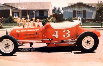

    Here you go Pat! I saved this from the HAMB but I've never been able to find the thread to see who originally posted it. This is the pic that Marty used to get your wheelbase dimensions.

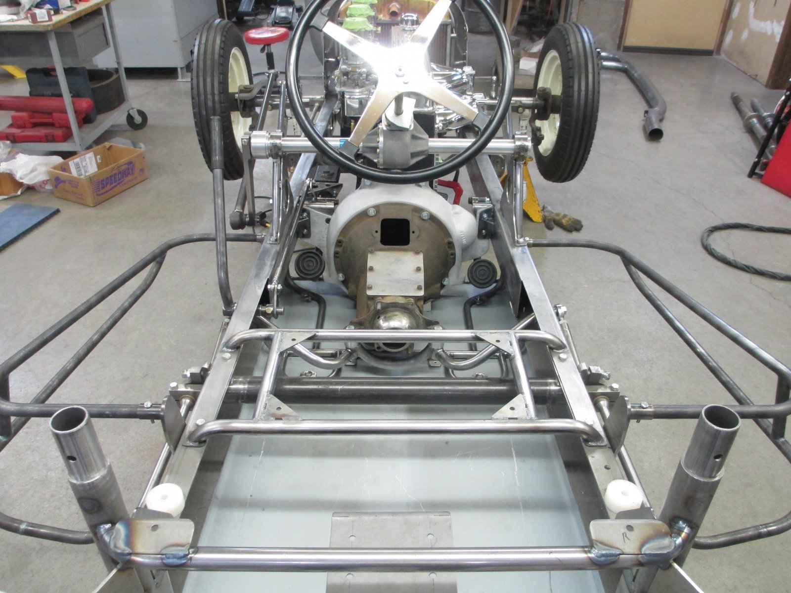

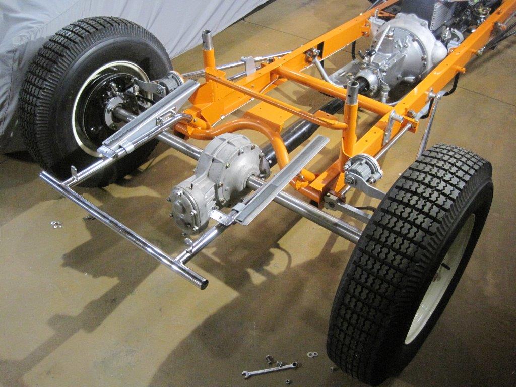

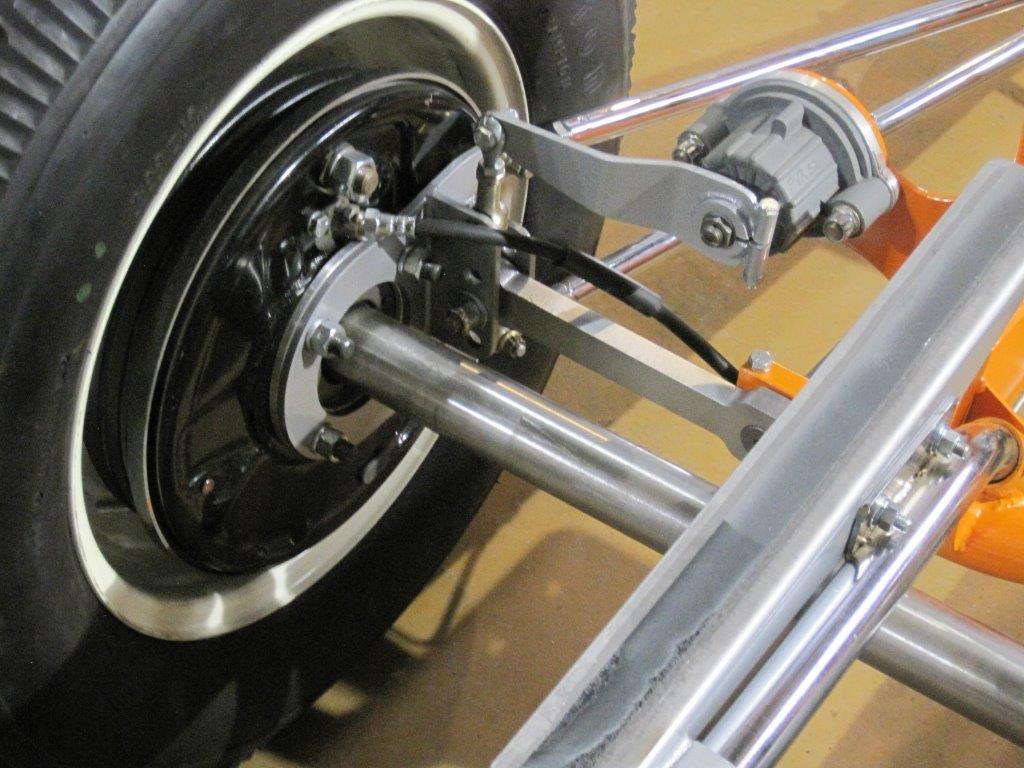

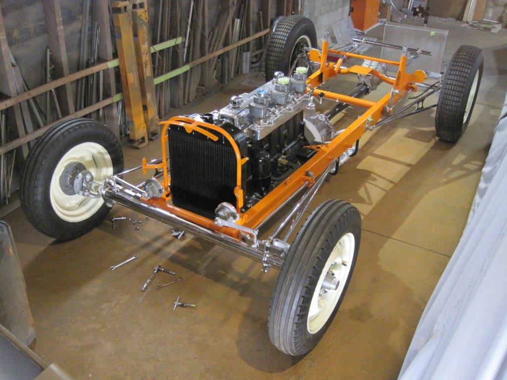

    Sunday morning update. Great to see it with all of the running gear installed ! The last shot reminds me when Pat wondered why I went to the trouble of doing the trans crossmember the way I did. Once he sat in the car he realized why. Pat 27.jpg Pat 28.jpg Pat 29.jpg
    brEad, Bowtie Coupe, Tman and 19 others like this.
  13. AmishMike
    Joined: Mar 27, 2014
    Posts: 1,426
    AmishMike
    Looks like crossmember leaves room for feet either side of trans. Looking forward to your build of belly pan & attachment. Following closely of great build

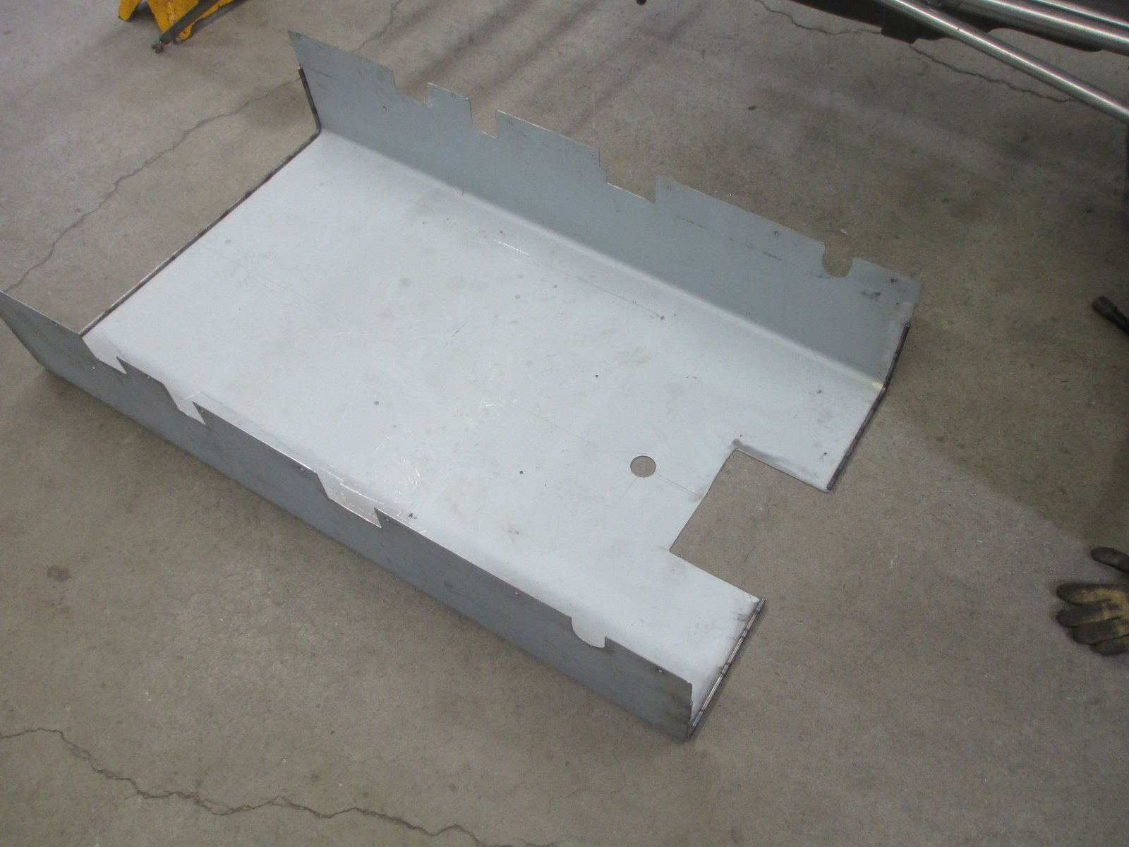

    The belly pan is the orange part in the background of the first picture, it fits snuggly to the outside of the frame rails. IMG_2589.JPG IMG_2592.JPG

    Thanks, I forgot about this one. I saved it to my file. Since it says Ray Brown Automotive on the hood, this is after the White Bros. bought the car. There's no engine in this pic. But I can't figure why it still has the circle track parts: nerfs, and especially shaker grille. I thought they only drag raced it with the flathead V8. That also looks like a Downey-type neighborhood in the mid-'50s, but I can't track down who the White Bros. were or where they were from. Whose trophies? Bill Spalding wrote a whole autobiography and gave me a copy when I interviewed him not long before he died, but it only had one paragraph on the roadster. His brother talked about it in a couple of interviews, somewhat. But there's just not much history on this car, and none after the Spaldings.

    Pat, I seem to think Harold White worked at Ray Brown Automotive.

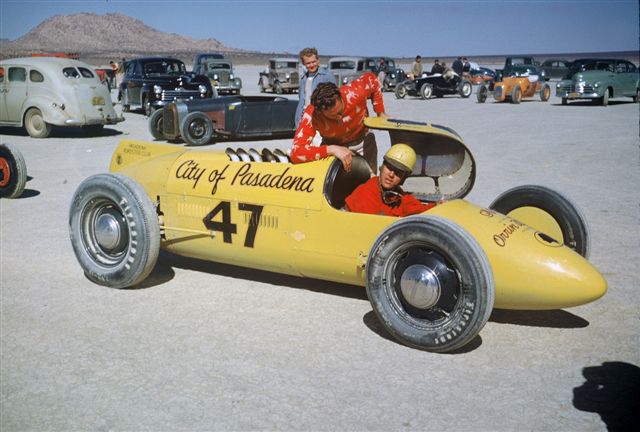

    The only other colour pic I know of. Orange wheels in this case. Maybe there were other photos with it in the background?

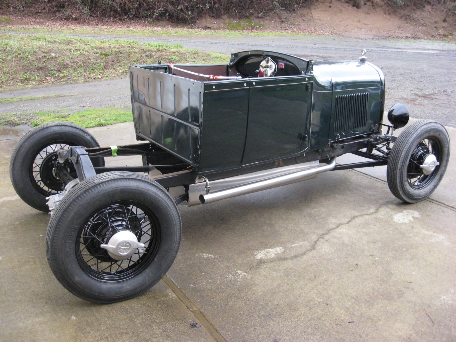

    PatWarrenModelA.jpg Here is a (and Alchemy's) old Pat Warren Midget center section back in 2002 when I had it. A Halibrand cover fits with no problem. There are no ribs on top of the case. It is just smooth. When I got it it was out of an old midget with a live axle. PatWarrenMidget.jpg

  20. AmishMike
    Posts: 1,426
    AmishMike
    In that second picture I can see black tubing either side of trans going to hoop. Is that mounted to floor pan or welded to frame? Is that enough to support drivers feet, full weight of driver? Obviously, in my street build, considering & love look of belly pan, or do I do it easy with flat plywood floor. Thanks for posting many great builds & helping the unskilled

    That framework bolts to the frame, it also has sheet steel that mounts to the top, with louvers to let the dirt and mud drop through. IMG_7762.JPG

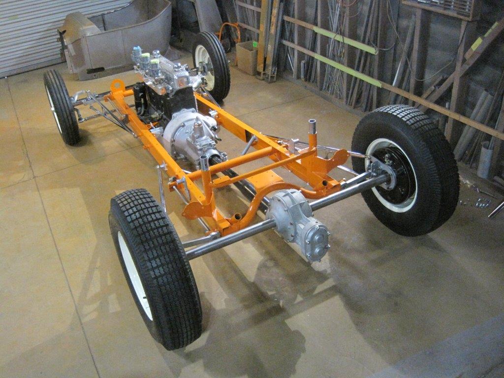

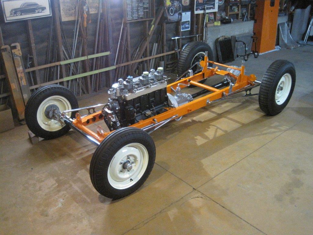

    More ***embly going on at Pat's place. Pat 30.jpg Pat 31.jpg Pat 32.jpg Pat 33.jpg Pat 34.jpg

    Can't wait to see it with the steering gear mounted. It is looking close to the original. Spalding 2.jpeg
