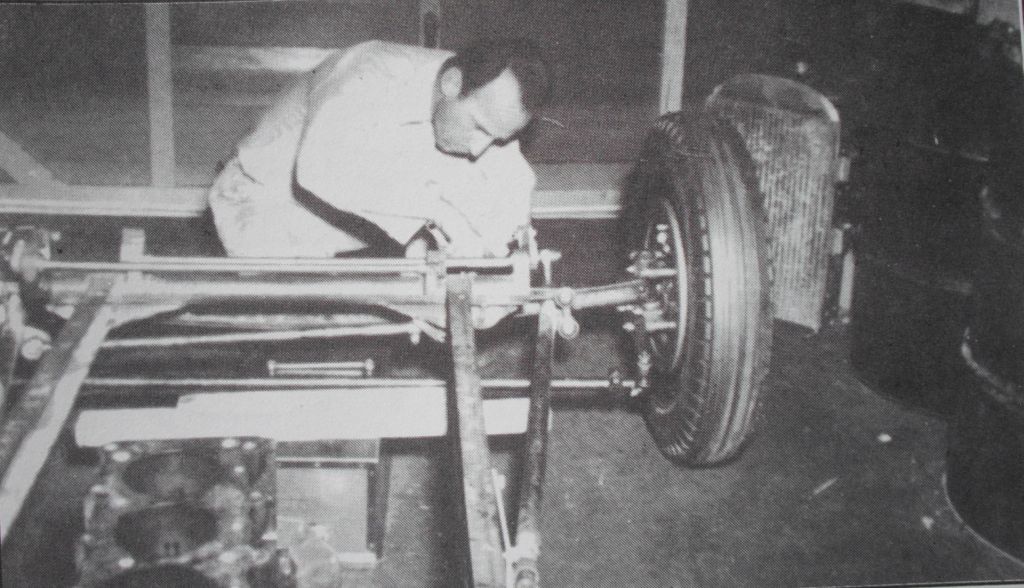

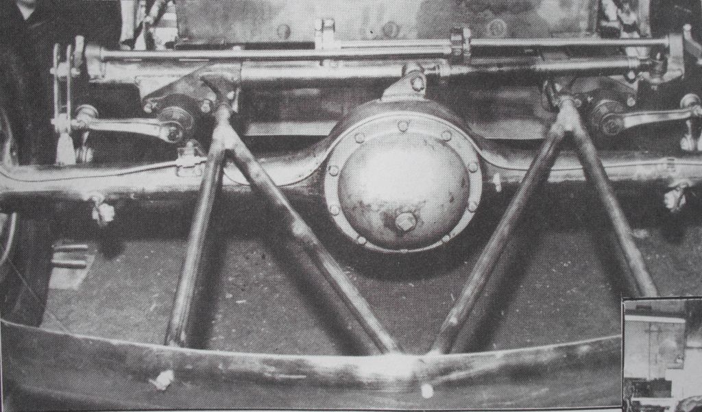

    Hartman ran the torsion bars transversely in his car. If Spalding's was the first to run torsion bars, Hartman's would have to be the second.

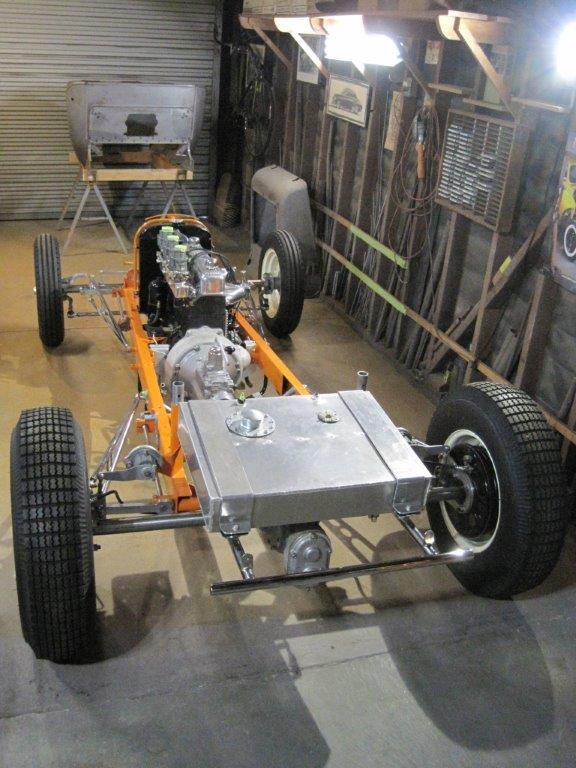

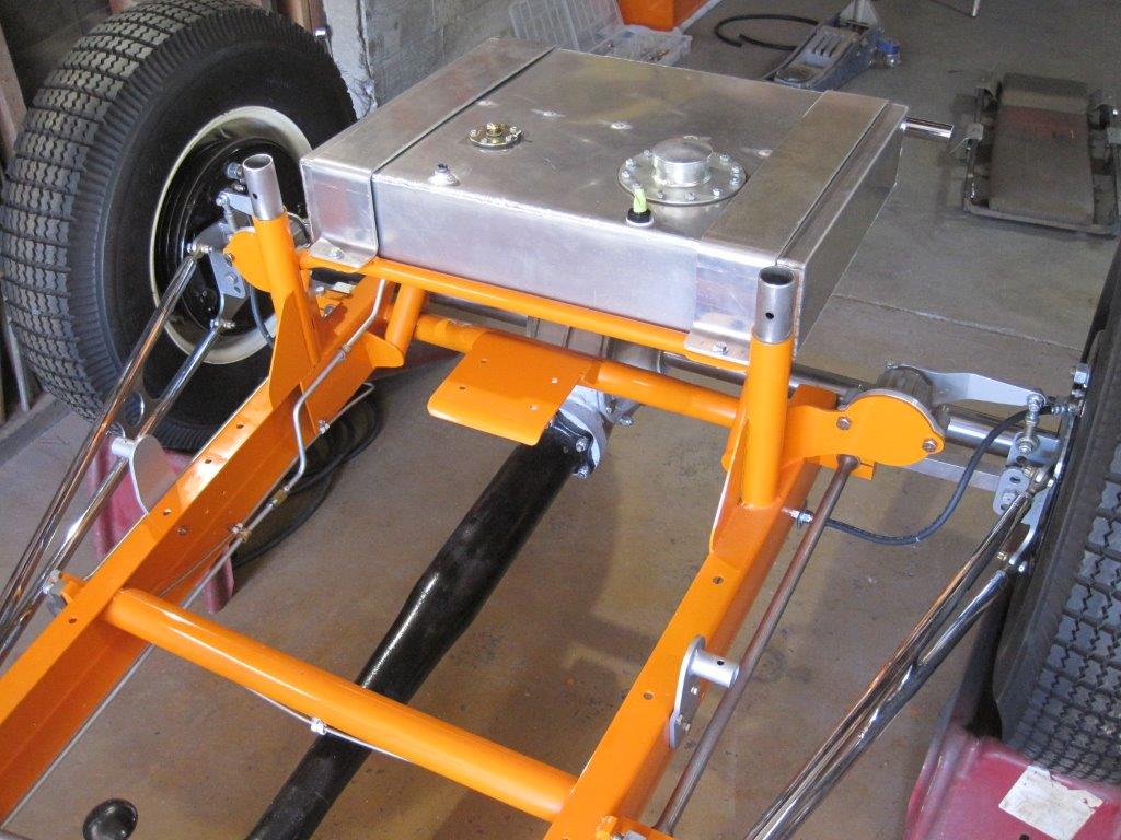

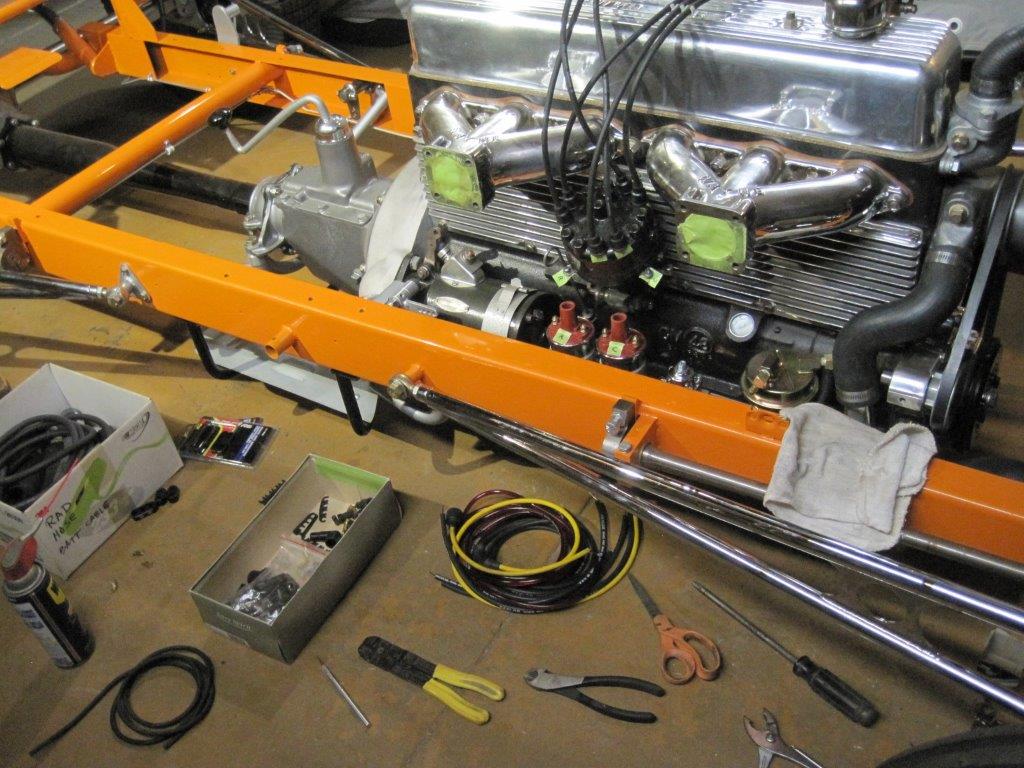

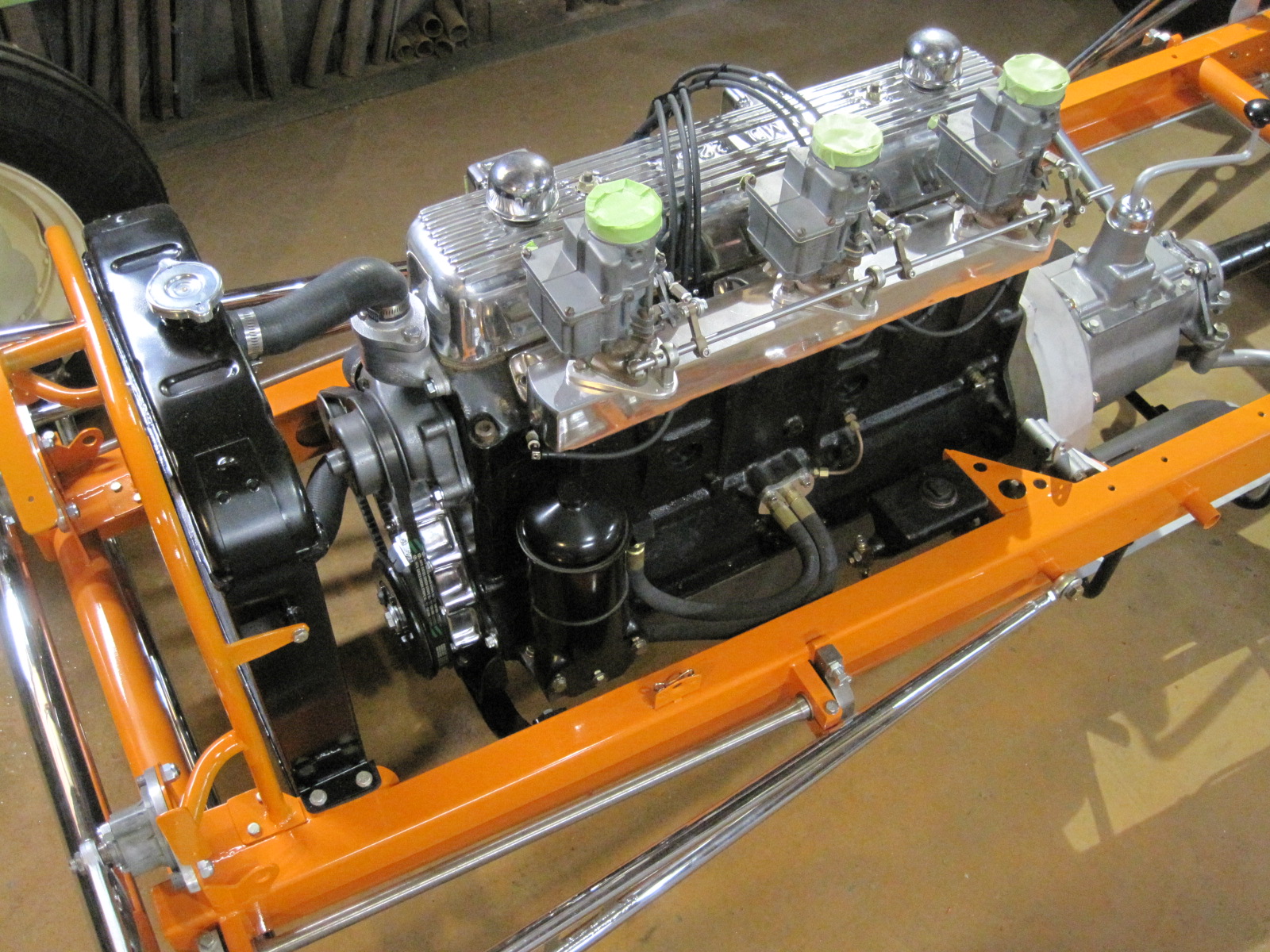

    Another shipment of photos from Pat. Also, make sure and tune in to his Blog Tomorrow. Pat 35.jpg Pat 36.jpg Pat 37.jpg Pat 38.jpg Pat 39.jpg Pat 40.jpg

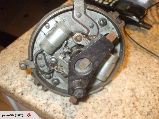

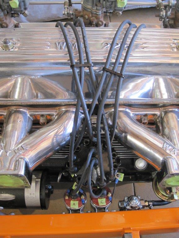

    Maybe I'm missing something, but as I look down on the plug wire arrangement it seems the #5 and #6 plug wires may be crossed, unless they do another crossover near the spark plugs, no?

    Complicated plug lead order. Rotor looks like this, one set of points does 3 cylinders. It depends on which coil is firing and which leg of the rotor is being used, and what lead it lines up with. It makes my head explode.

    I get that its a twin coil arrangement.
    I am looking down at the wires coming from the distributor cap and where they seem to be headed on their way to the spark plugs.
    If you ***ume the standard inline six arrangement firing order of 1-5-3-6-2-4 and ***ume the rotor moves in a counter-clockwise direction and ***ume the wire's position routed over the valve cover matches the order of the spark plugs 1-2-3-4-5-6 I end up with 1-6-3-5-2-4. Any other way I try to figure it , it does not compute. I realize that's a lot of "***umes" so somebody school me.

    Mr. Flyer, I was thinking it was Gofannon who wrote the above reply--where things do rotate in the opposite direction (and yes, my head exploded a couple times trying to figure this wiring). But on all of my engines (Chev, GMC, Cad) the distributor rotates clockwise. And do not ***ume the wires attach to the plugs in the order they cross the valve cover.
    I had a photo showing the wires attaching to the plugs with Rajah terminals, but I dumped it because it didn't show much. But several wires cross under the manifold. And I just switched two in the separator clips to get them farther away from the exhaust manifold. The big problem was I could find no diagram on how to wire this Spalding distributor, nor anyone around here who really knew anything about it. So I just picked a no. 1, and then arranged the plug wires in the 1-5-3-6-2-4 order that has been etched in my brain since high school, going by which set of points was opening, which coil those points were wired to, which rotor tip that corresponded to, and where that tip was pointing. But I am notorious for getting my wires crossed. We'll see.

    This setup looks very similar a W&H Ducoil distributer, there is a post somewhere here on the HAMB that lays out the firing orders for those units. You might also see if you can get a reply fron GMC Bubba on this.

    Pat and Marty, the car is looking great! Much needed inspiration for me to get mine done. From what I worked out, clockwise around the cap it goes 14**36**52**. I'll have to double check that when I get to firing up for the first time. I can barely read my own notes! The coil lead needs to be in the right hole for which set of points it's connected to, and the points need to be in phase. I think a buddy of mine has a Distributorgraph, otherwise I'll fab some sort of pointer device to phase the points.

    Thanks for setting the record straight. I know you know your six bangers. I made one too many ***umptions I guess.

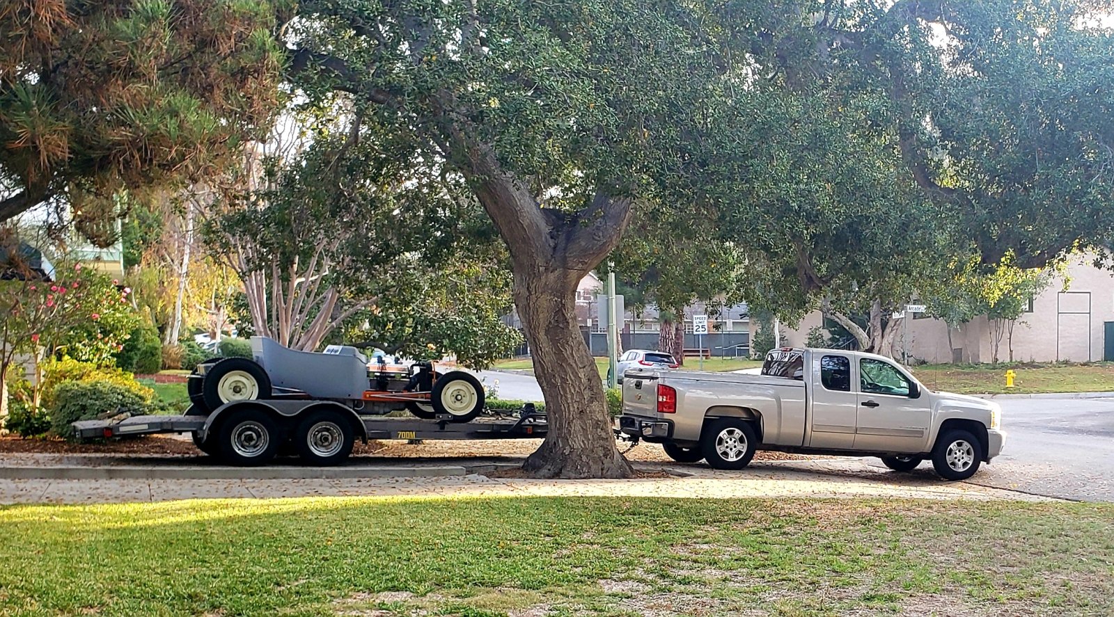

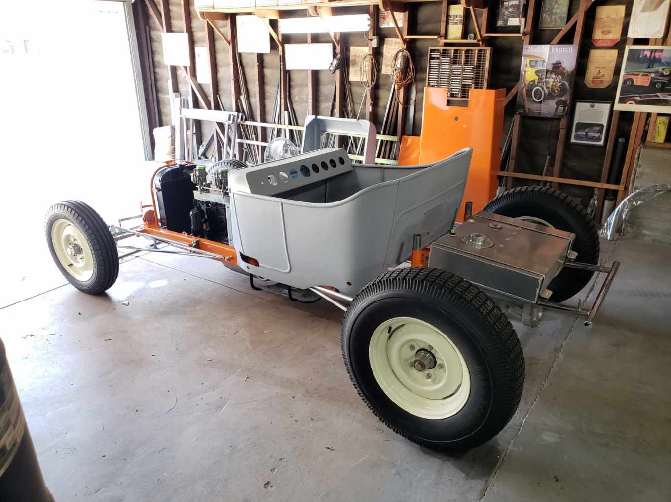

    Bill picked up the Spalding over the weekend, set the body on for the trip up to his Hayward, Ca shop. He is very busy readying a couple cars for the GNRS, and then he will be getting the paint work on the body, deck and hood finished and do the final ***embly, later this Winter/Spring. It will be nice to see and hear it run. Spalding 200.jpeg Spalding 201.jpeg
