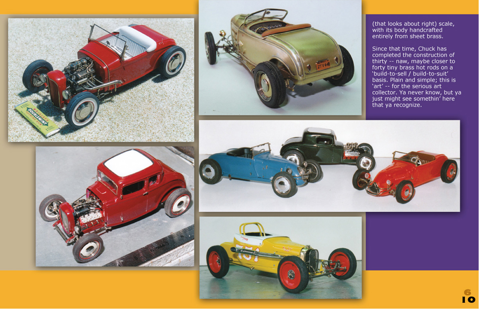

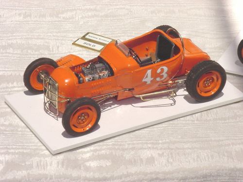

    trackrdstrmodel.jpg trackrdstrmodel.jpg trackrdstrmodel2.jpg trackrdstrmodel3.jpg trackrdstrmodel3.jpg Finally found these pics I was sure I'd saved. They were on a hot rod CD from '04, the model mentioned earlier. I wish they were bigger. Thanks Pat and Marty. I love track roadsters and this is a favorite.

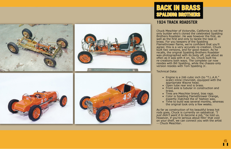

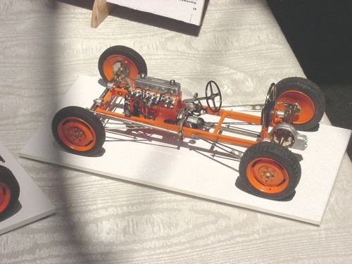

    Sorry for the doubles, don't upload pics often trackrdstrmodel4.jpg trackrdstrmodel5.jpg trackrdstrmodel6.jpg

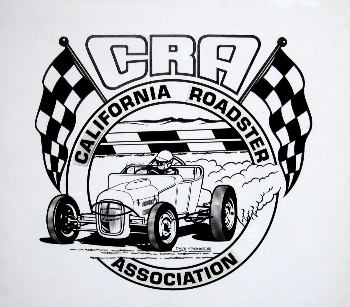

    I to have a love for this Roadster, Pen & Ink I did back in the 80's IMG_1376-001.jpg

    Clean line art from Dave Wagner (top version)! Why did someone let another artist sign it on the bottom version?

    Lowlife: Where did you see these models? What scale are they? They look about 1/25. The one Bill Spalding showed me was larger.

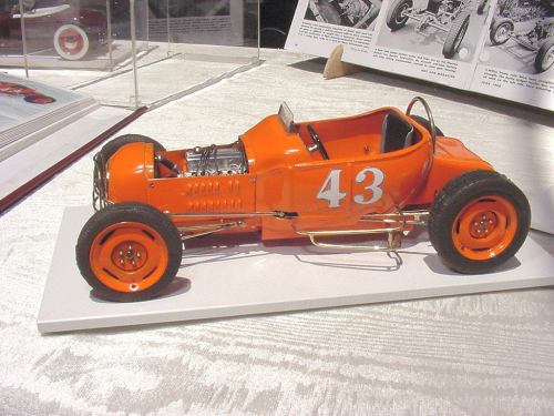

    Pat, I don't remember where I saw these pics, either scanned from a magazine or from the Internet. I do know I was tickled cause I'd never seen it in color...I love orange! Your question this morning caused me to do another search. I found mention of Merchants Of Speed, which I have, so I checked that out and found this pic of Bill with the model. It's definitely bigger than 1/25, also looks like the same display board it's on in my pics above. Chuck Meschter built it in 4 months at a cost of $3,000. Also, while searching, I kept noticing mention of Benchrace.com. Sorta rang a bell so I checked my bookmarks and sure enough there it was. Clicked on it and that cool little ezine is still there (wish he was still at it). I believe it was issue 7 I found this article about Chuck and the Spalding T. That's all I know, love ya, man!

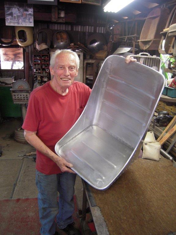

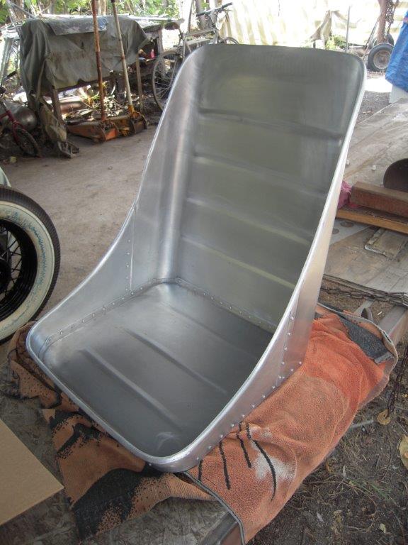

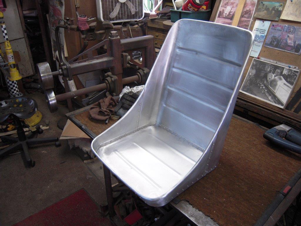

    Pat sent me some pictures to post. Master craftsman, Dennis Webb got the seat finished, Pat will fill in the details. Spalding seat 3.jpg Spalding seat 1.jpg Spalding seat 2.jpg

    Well, Marty's thrown the ball to my side of the court. If you look at the photo of Dennis Webb holding the seat I picked up this morning, you can see several track noses and wooden bucks hanging on the walls behind him. He works out of the same one-car shop where his dad, Marvin, built hot rods for **** Kraft and many others, often with the help of his good friend Art Ingles. That's where Dennis learned to be a meticulous metalman. Midgets and things with track noses are his favorites. Dennis is the guy Arlen Kurtis uses to build noses, tails, and tanks for the midgets he builds today.
    You might not have seen The Rodder's Journal No. 56. In the RJ Times I talked about Dennis, his shop, and how Don Borth bequeathed the original Ingles Nose wooden buck to Dennis, the one Art used to make the distinctive noses for the Spalding Bros., Barney Navarro, Wes Cooper, and blue **** Kraft roadsters. When I asked Dennis if he would make the nose for my Spalding duplicate, he said he didn't think the old buck would hold up. So I borrowed it, took it apart, and exactly copied each piece to make a new one, so he can.
    More recently I showed Dennis photos of the Spalding car and asked if he could make a seat like the one in it. He said, "Sure, I know exactly what that is, a B-25 bomber seat. I've made lots of them." He made patterns from an original B-25 seat long ago, and has made a couple hundred by now. I'm amazed that people can make things like this out of flat pieces of aluminum. Anna and I will deliver it to Marty as we head up to the smokey Northwest in about three weeks for our annual vacation trek. This will be my first chance to see the car in person. We hope it's not so smokey by then...

    I've only seen that particular style of seat in B-17's. They used a short-back one like you have shown that was the radio operators seat, mounted on a pedestal ...and taller-back versions that were pilot/copilot seats. Could they have used them as radio operator seats in B-25's?...who knows, but I do know that this type seat was not a pilot/copilot seat in B-25's...they were much bigger and were mounted on their own frame.
    here's a pic of a B-17 radio operator seat...

    OK, OK. I can see that nothing gets by HAMBERS. The thing you have to understand about me is that if it's not going into print that'll end up in the library of Congress, I'm not always so precise about fact checking. I don't lie. My wife calls it exaggeration. But I didn't take notes on this one. I thought Dennis had said B-25 or B-29, so I guessed B-25. But you're absolutely right, it's from a B-17. And Dennis says he's "only" made about 50 of 'em.
    As for the English Wheel: Dennis has a nice big one on the other side of the shop that someone in Anaheim made years ago with a big, cast "C" type frame. But Dennis found he needed to wheel certain parts in a tighter radius, that would hit the legs of the big machine. So he designed and made this one, that can actually wheel parts in a 360-degree circle. It stands on a pedestal that can be moved out into the room, away from the table.
    That's all I can tell you about that stuff. I was figuring someone would comment on how niece the seat was.
