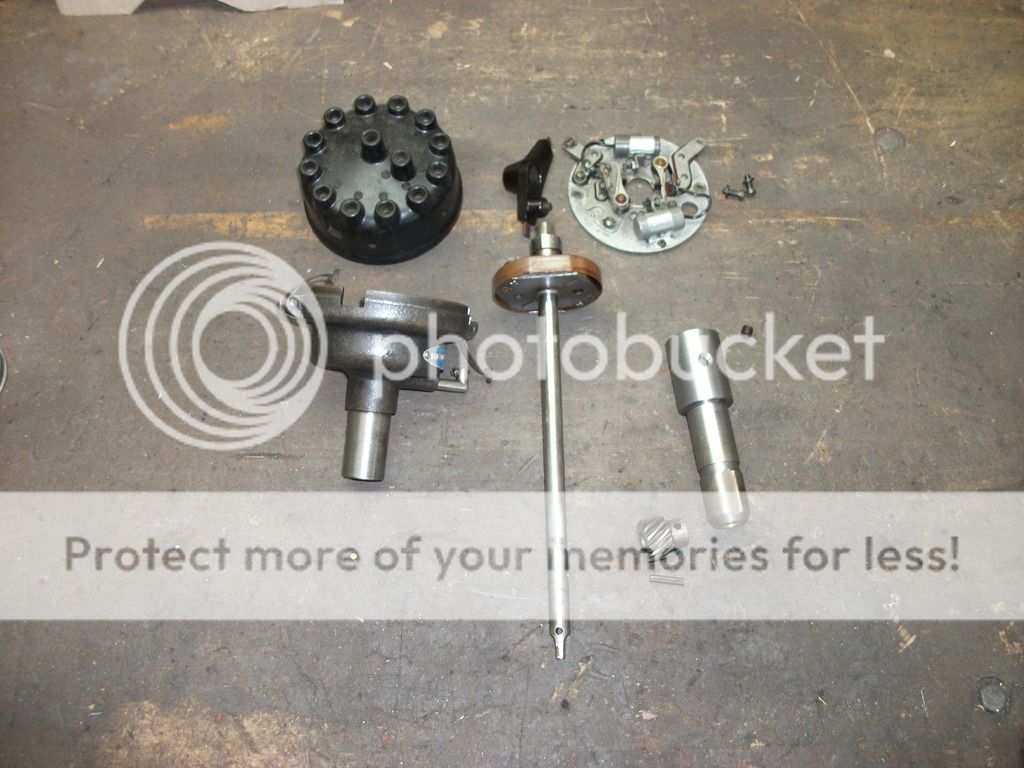

    Pat, here's how I adapted mine. I went this route because mine had the wrong rotation, and the SW tach drive is near impossible to find down this end of the earth. The cap and rotor are the same whichever rotation it has. The distributor shaft and advance are from a SBC Delco points distributor, the Nash cam drops straight on but is machined to take the lugs for the advance springs which came off the Chevy cam. The distributor shaft fits right into the Nash housing and sits at the correct height. The drive gear has to be relocated up the shaft the same as the original Chevy 6 distributor, using the correct gear for your cam. At that stage you can measure up for the adapter. The adapter is bushed in the lower end. I'm considering an electronic conversion for it.

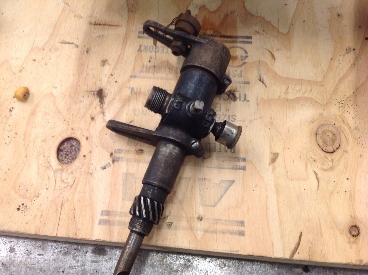

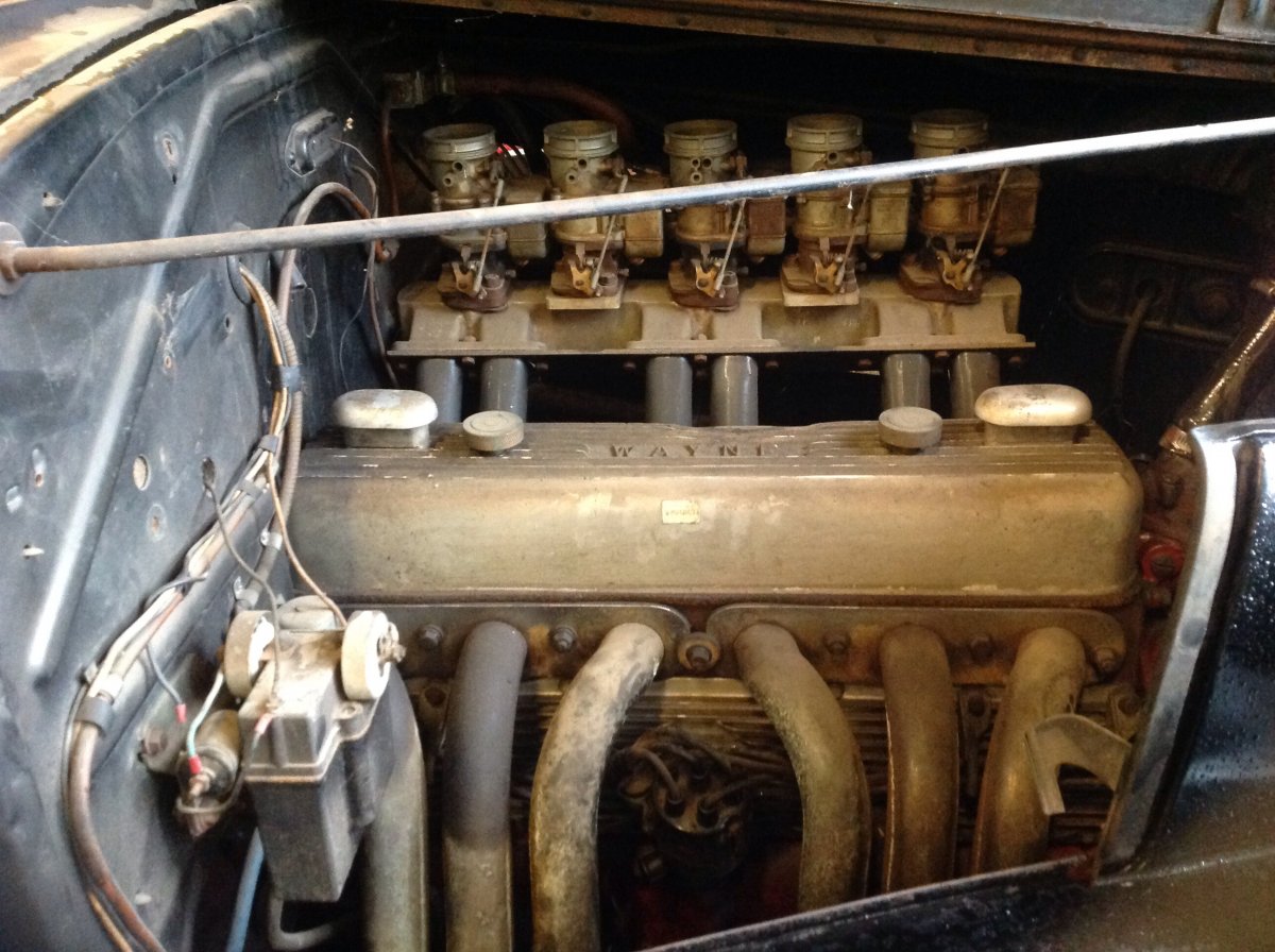

    image.jpg This is what I'm working on in the shop right now ,

    Pat - I'd love to dissect a Spalding ignition to see how they did it. I'm sure it has something to do with the interchangeability of the Nash cam and rotor onto the Delco shaft, which I rediscovered. Then it's a matter of an adaptor plate for the cap, and a twin point conversion. Nash caps and rotors are still available ($). I see there was a Fisher version as well. The extra work of my conversion doesn't bother me. Our hot rod pioneers would've spent countless hours fiddling and adapting back in the day, these days it's too easy to buy stuff off the shelf.

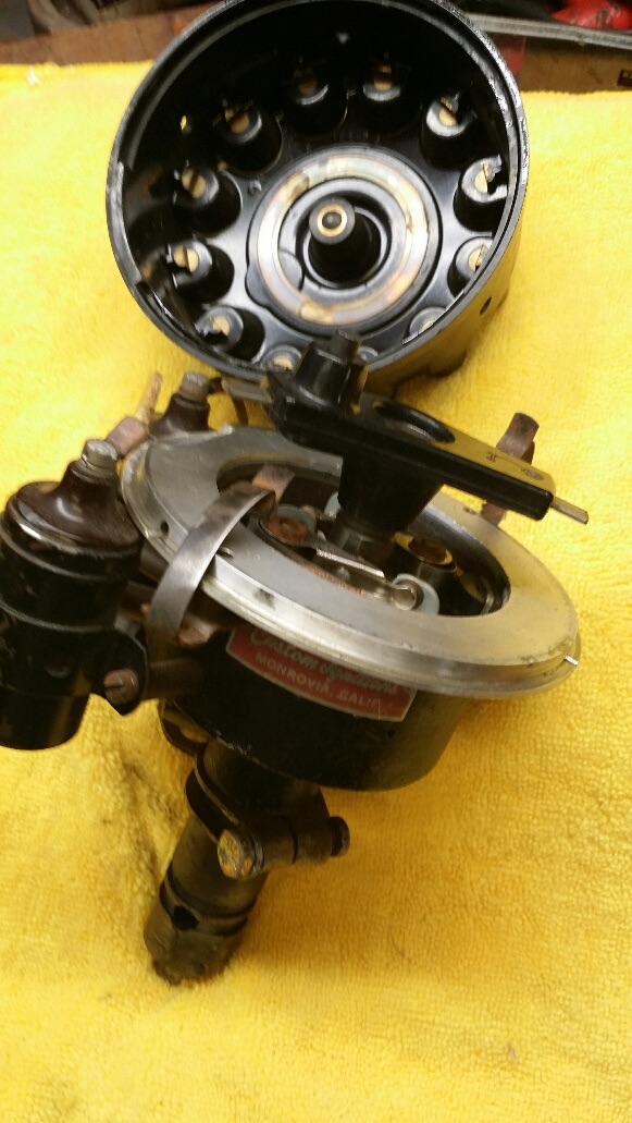

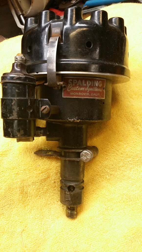

    image.jpg This is a adapted Spalding distributor
    1947knuck, ls1yj, volvobrynk and 5 others like this.
  19. Gofannon
    Joined: Feb 8, 2007
    Posts: 986
    Gofannon
    That's more like it. I don't suppose you have a shot of it with the cap off? And where the hell do you get those big ol' condensers these days?

    Let me know it you need that tach drive,I'll trade you for something .

  25. May I ask a stupid question here? I'm trying to figure out the purpose of using the Nash distributor, or least the top of it. It has 12 leads, but the engine being used only has 6 plugs? Is it just to get the dual point capability? In the article posted by gofannon it talks about grinding off every other lobe which means no spark would be generated at that point in "time". Sorry for the novice question but this build really fascinates me. I love the history of it and the struggle to use the period and correct parts in the build. Keep up the great work! - David
    bct, volvobrynk and hendelec like this.
  26. Gofannon
    Joined: Feb 8, 2007
    Posts: 986
    Gofannon
    Hivolt, the Nash distributor allows for dual coils. By grinding off 3 lobes you end up with two 3 cylinder ignitions, one set of points operates one coil only. This creates a massive dwell angle which means that the coils can generate a really good spark at high RPM, comparable to the magneto ignitions of the time.

    Well, I get it that on an historic replica build like this, one would want to duplicate as closely as possible the original setup.
    But from a pragmatic standpoint doesn't any single coil ignition system give your six as much dwell time at 8000 RPM as a V8 would have at 6000 RPM?
