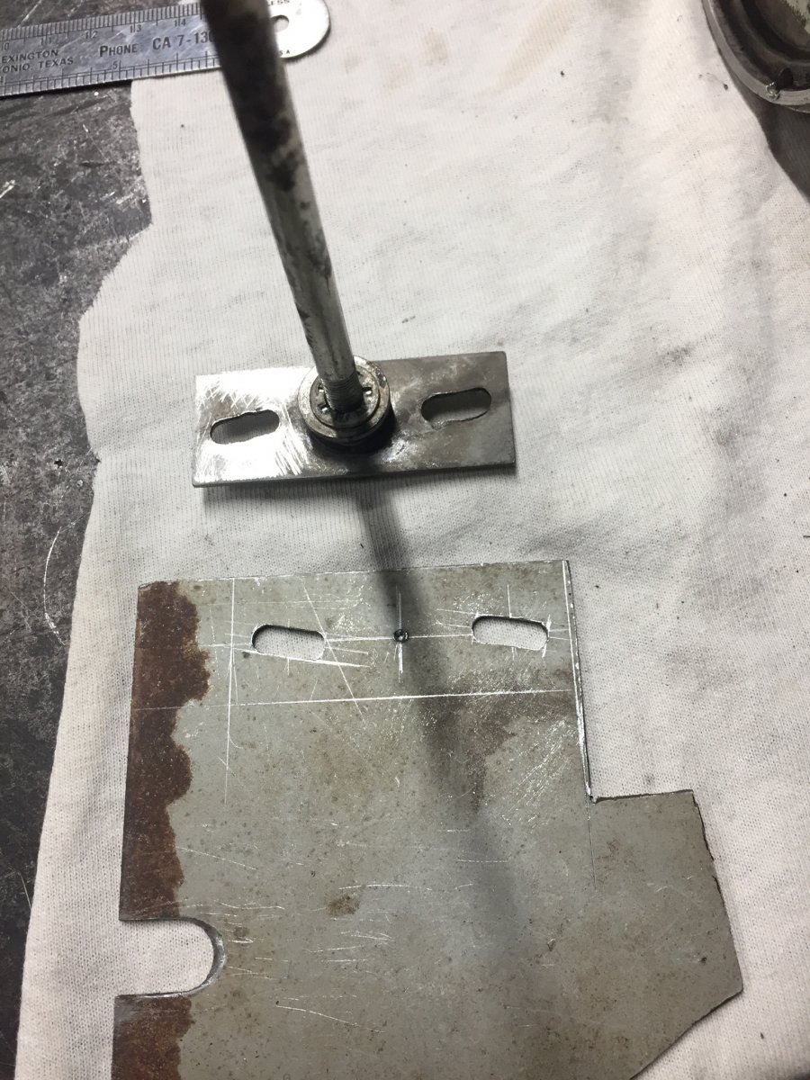

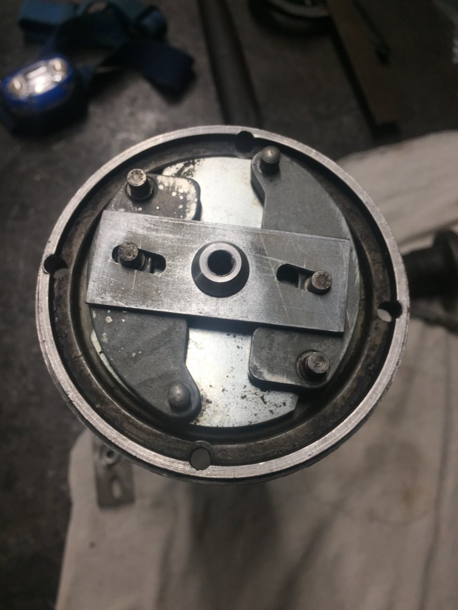

  9. Got it apart thanks to the advice and info given, Can’t be at work due to this climate we’re in so I decided to have a go at making the advance plate and reversing the bobweights, Happy with the outcome. E66810B0-A1E6-43E3-AAA6-AA352AEA0A51.jpeg 8E3E70B0-24E4-43C2-9BC6-B3137AAF21B2.jpeg FE8B11ED-FE77-470A-8F2C-1D057A581762.jpeg 5B099D83-5632-41D0-804E-5D5052D5E526.jpeg 58762B28-0207-4AC9-89D0-91F302DDA190.jpeg

    Great info on the flamethrower @Barrelnose pickup how are you turning the distributor body or shaft and great work on the plate.

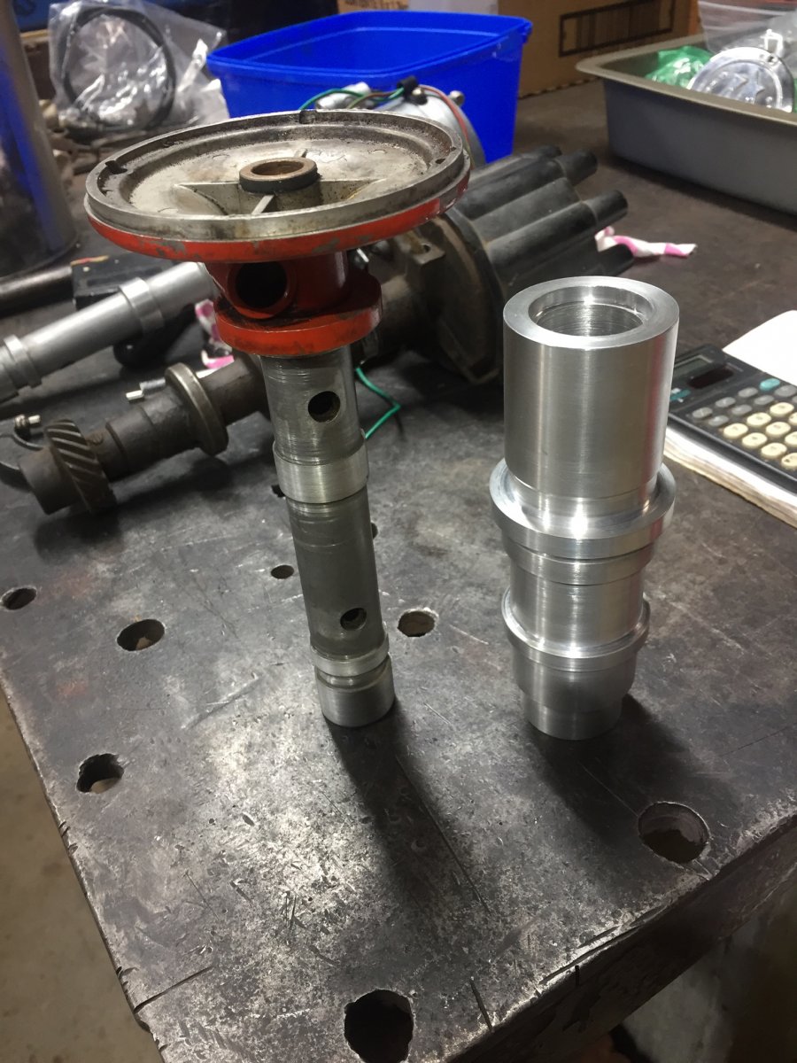

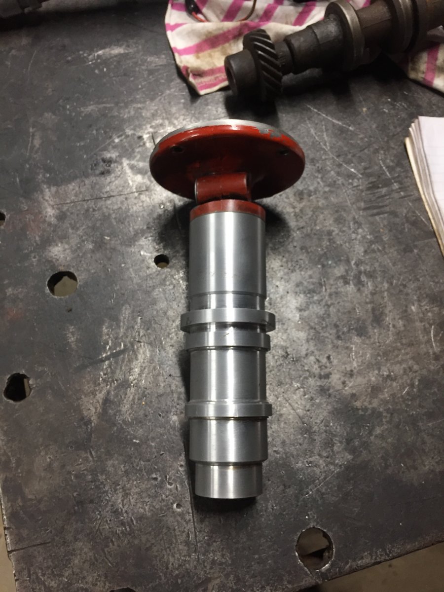

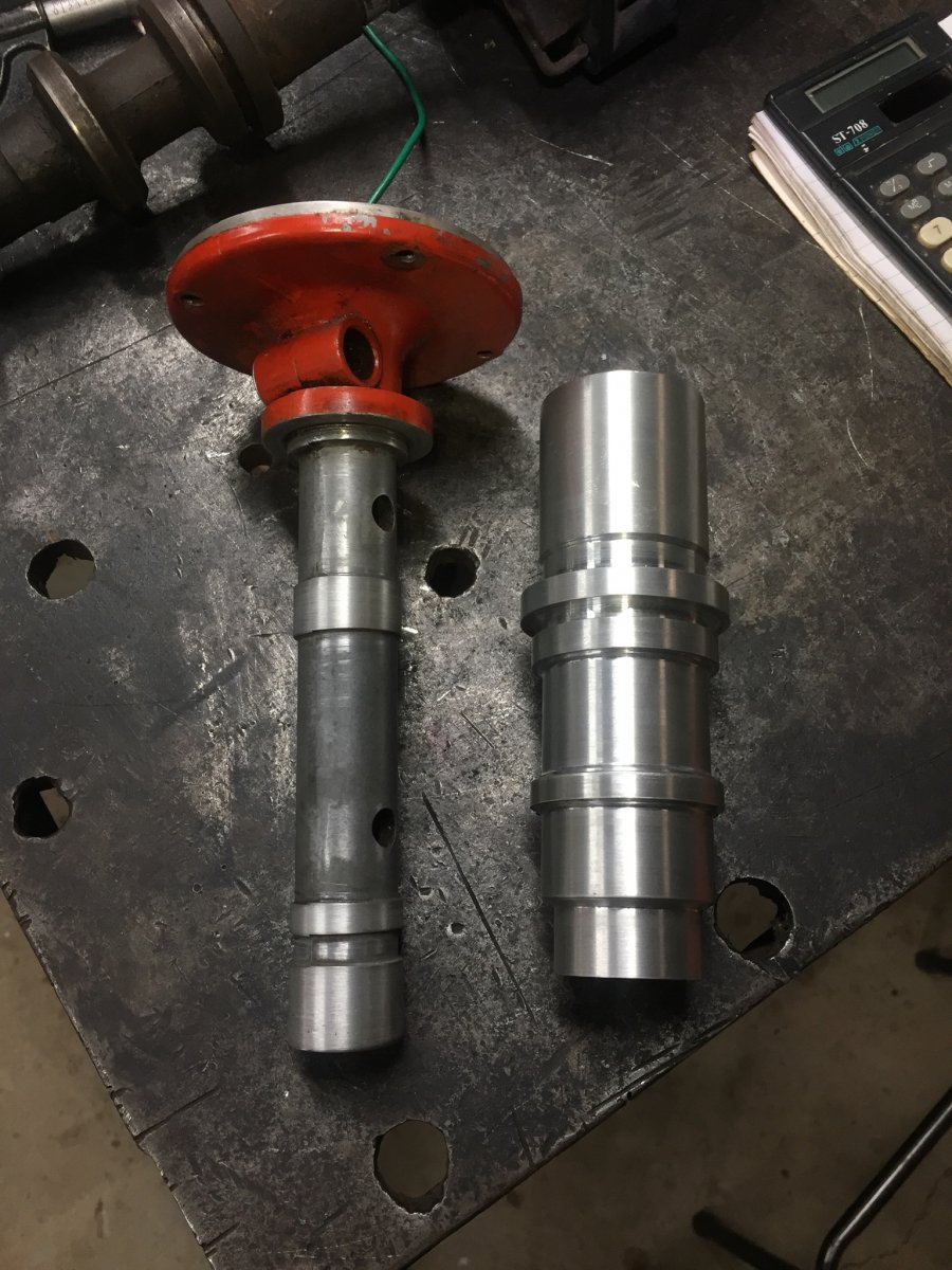

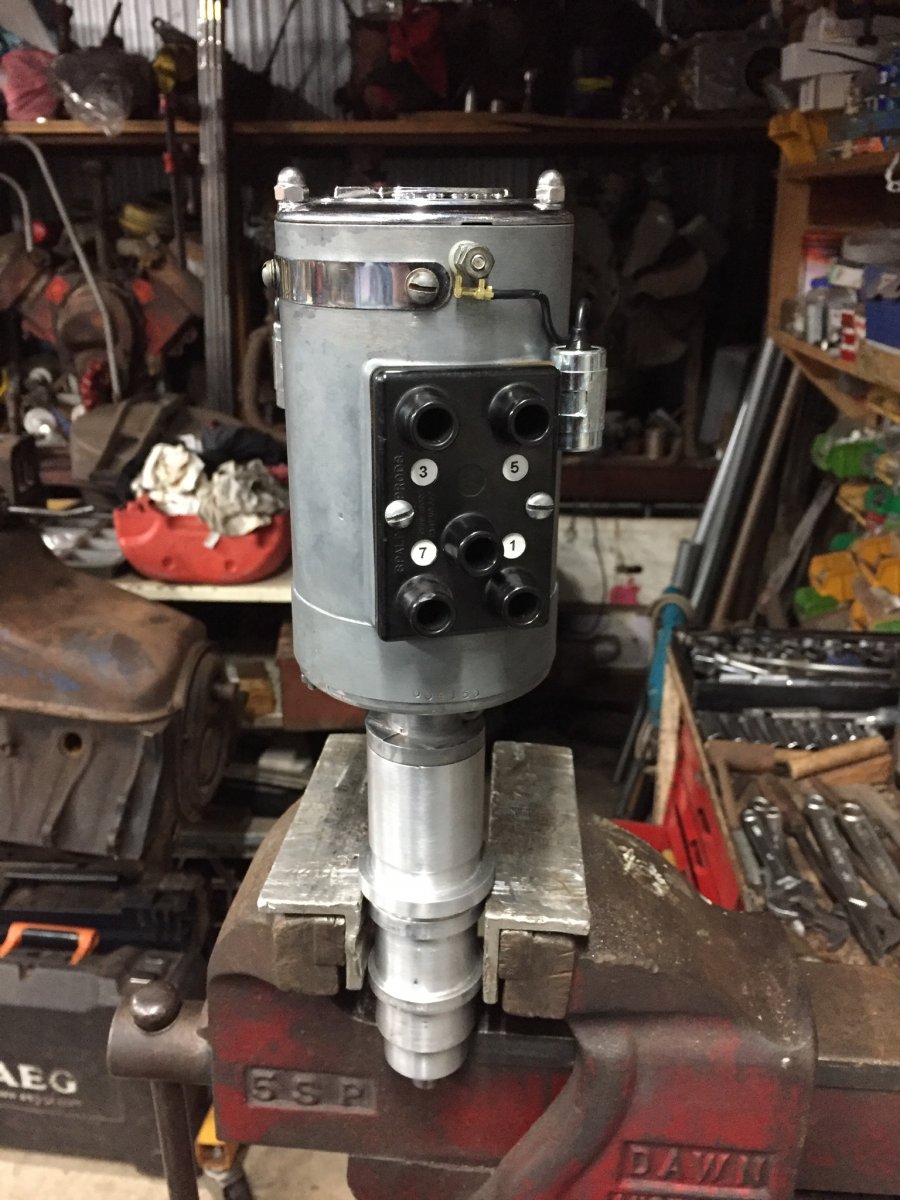

    I machined down the OD of the housing(suited a Chev) and just made a sleeve the same major dimensions as the Cad, a couple of thou interference,heated it up and slipped it on. E67B2B9E-A137-4C04-B8DA-E49F31C600DD.jpeg A10F4609-3C42-449C-B90A-63621C2482C6.jpeg 15680B59-F440-46F1-8A93-AFB7BB7935F3.jpeg

    Nice work @Barrelnose pickup, somehow I get the impression you don’t buy crate engines either.

  19. Got all the parts made, modified, sorted and cleaned, just got to drill the shaft for the Cad drive gear and drill the side of the adaptor to pick up oil to lube the bottom bush.
    Only damage was 2 very small circlips for the bobweights but I’ll get around that, happy with the outcome so far. EDB4F9C7-52F8-4BA0-BC56-B20D5FCB9A03.jpeg

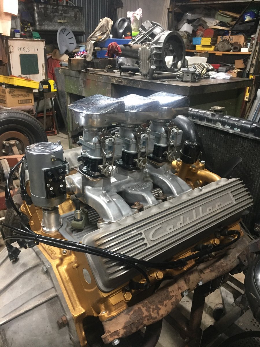

  27. Cheers, in the hole now. Was worth going through the process. Not rocket science. 5F8C0EE3-8C7F-438C-9E0A-D61B903BA45E.jpeg 2EACA260-6639-4C67-A5A5-489AA13161D4.jpeg
