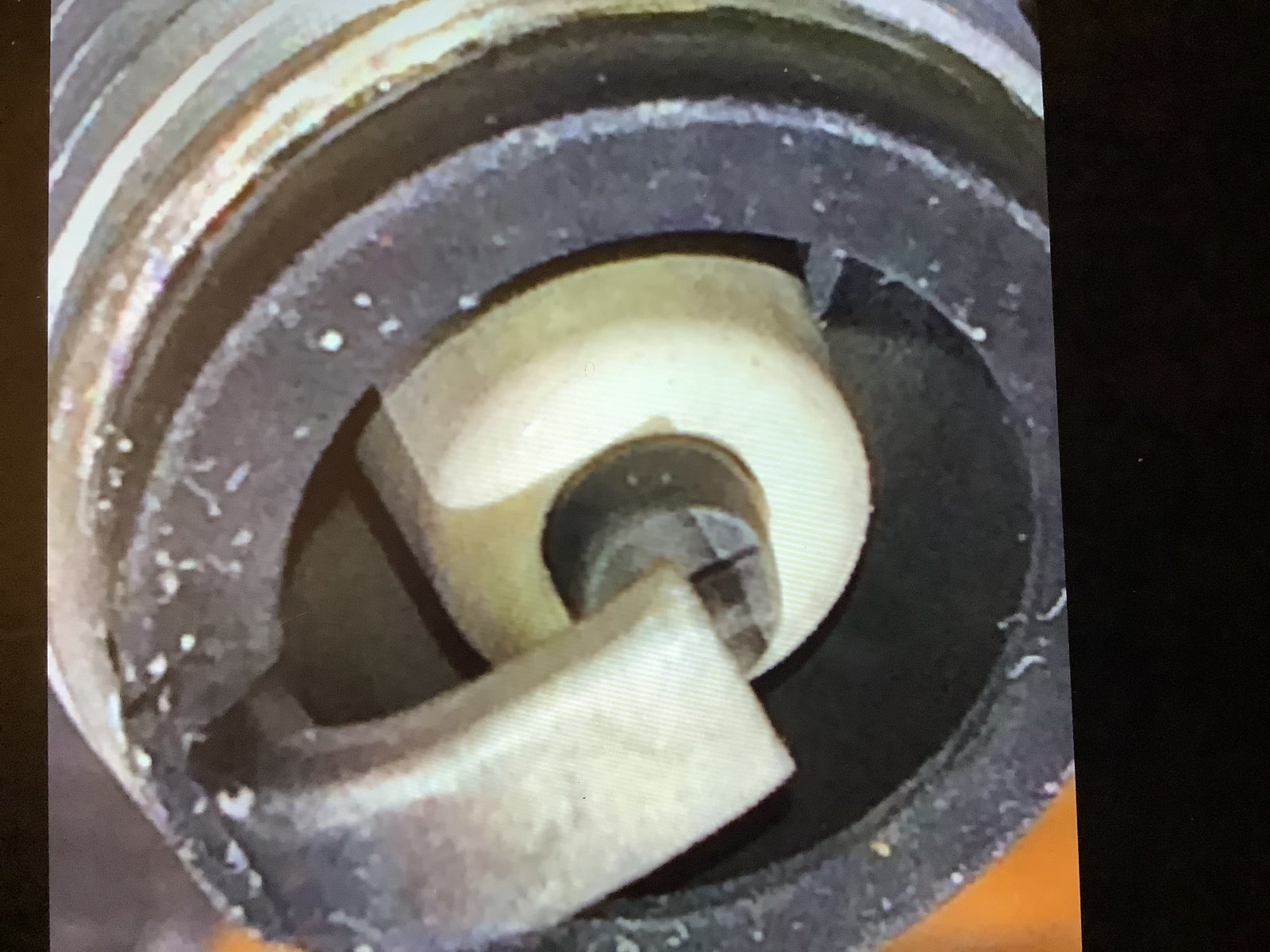

    Got a 57 Cadillac here that is all stock runs pretty good has a little rough idling. Timing is good has a pertronix in it and Autolite 85 plugs , going to do a compression test so I 16597187613698633380506216117908.jpg 16597187856494073552313757056814.jpg Pulled all the plugs to check them and they're all about the same except one. Seven of them are white and ashy on the electrode and one is a little bit red. Looking through online charts I can't really see anything in here except maybe the plugs are overheated. What are your thoughts?

    Running too lean, incorrect plug heat range or retarded timing will cause plugs to become hot and white in color.
  3. Hitchhiker
    Joined: May 1, 2008
    Posts: 8,510
    Hitchhiker
    I agree with @Petejoe. Running way lean.
    gimpyshotrods and jimmy six like this.
  4. wheeltramp brian
    Joined: Jun 11, 2010
    Posts: 3,378
    wheeltramp brian
    That's what I was thinking too. It does run fine doesn't have bad power and I can't find vacuum leaks anywhere. Going to put some new plugs in and search for some leaks and see what I come up with. Did a compression test it's equal across the board about 135 which is a bit low but they're equal so that's okay
  5. Petejoe
    Joined: Nov 27, 2002
    Posts: 12,642
    Petejoe
    from Zoar, Ohio
    Check your timing too. I’d slightly advance it.
    Don’t ignore the problem just because it’s running well. You don’t want burnt valves.

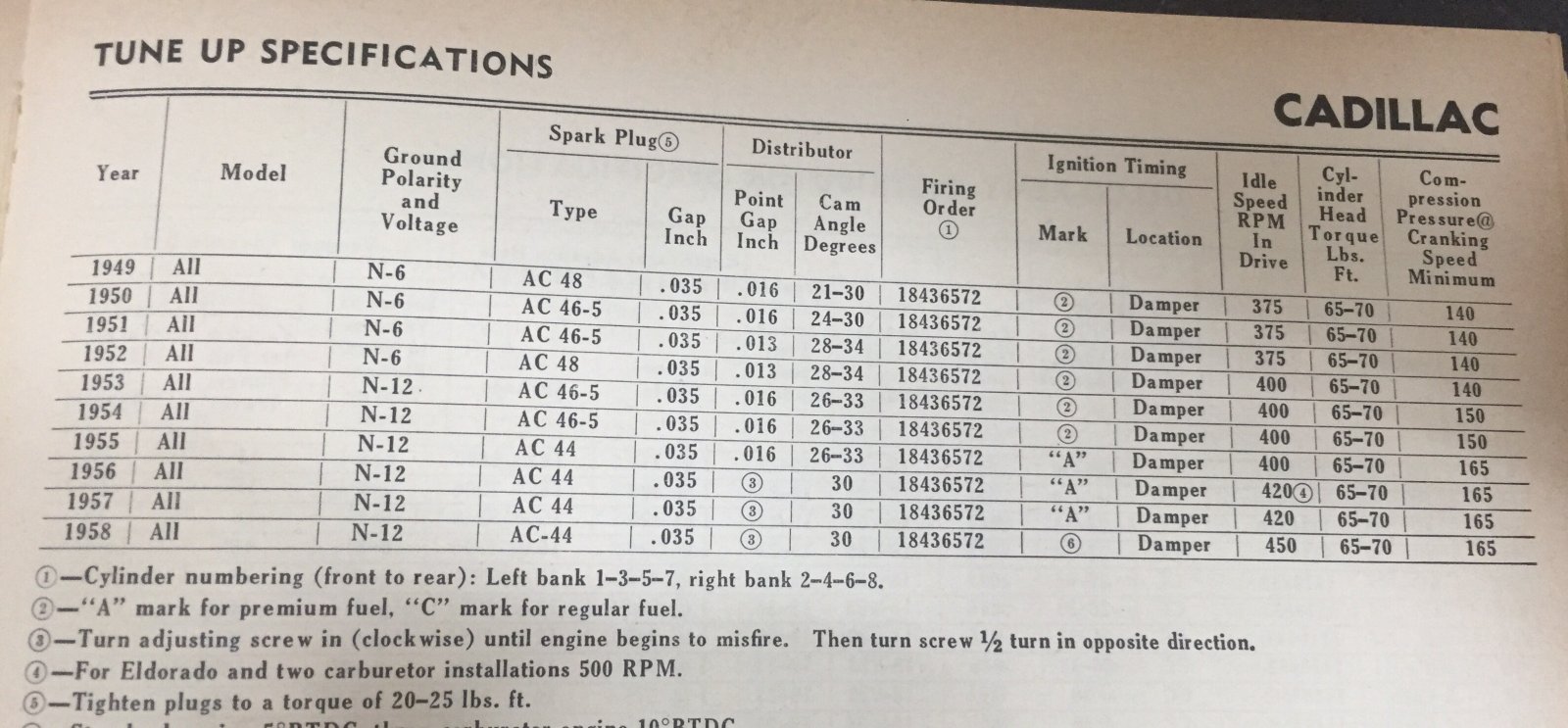

    Someone may have screwed in the wrong plugs sometime. Entirely possible that every plug change since was plugs that match the wrong ones. I would check the numbers to be sure you have the right ones instead of way too hot. Just a thought.
  7. Moriarity
    Joined: Apr 11, 2001
    Posts: 38,083
    Moriarity
    SUPER MODERATOR
    Supposed to have AC 44
    VANDENPLAS likes this.
  8. jimmy six
    Joined: Mar 21, 2006
    Posts: 17,221
    jimmy six
    Autolite 85’s are listed as the correct plug when I looked them up online and are extended tips, but I would go to an AC 44 as it was the stock plug and not extended.
    Today they say extended tips are better but were not stock in 1957. IMO Autolite’s belong in a FOMOCO not in any GM….
    J. A. Miller likes this.
  9. wheeltramp brian
    Posts: 3,378
    wheeltramp brian
    I just put a set of AC 45s in because I had them. Ran better but still a slight Miss. Found a bad plug wire and replaced them all and it's running smooth. Going to go drive it
