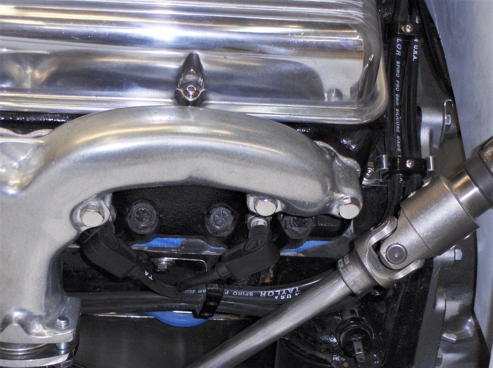

    My 64 Chevy SBC (vortec heads) wires.
  18. Blake 27
    Joined: Apr 10, 2016
    Posts: 1,551
    Blake 27
    I made a few stainless brackets to hold the wire separators in place away from the exhaust. HPIM0206 (2).JPG
