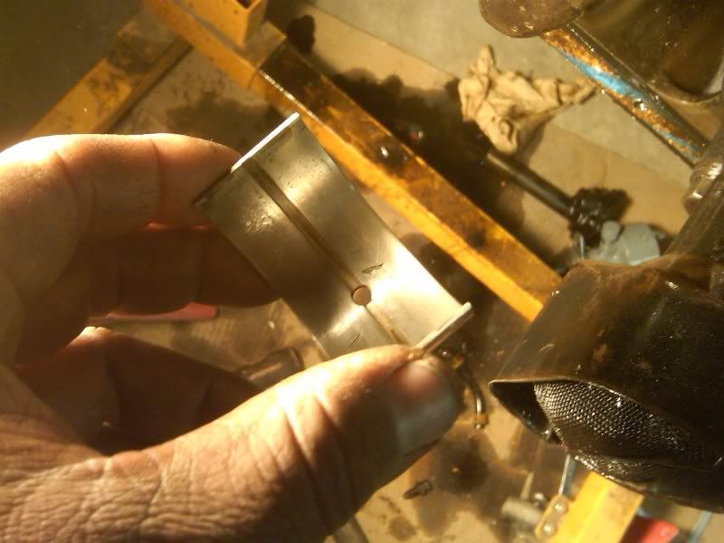

    Ok update.........
    I went ahead and pulled the # 3 piston off and this is what I seen, the wrist pin was tight as in no sloppy play, but the rod bearing looked kinda so so .
    here's some pictures.
    AND IGNOR MY DRIED HANDS I WORK WITH CEMENT
    and is this position ok with the 2 colors shown on it?

    I'll be darned, inserts. :confused:
    The two colors don't particularly bother me, are there any scratches on the lighter colored areas?
    Are the rings free in their grooves?
    I don't like the looks of the insert itself (dents on the inside), or the rod (looks like grooves in the bore, did the bearing spin?), how does the journal on the crank look?

    This is going to be a dumb question, but if this is from cylinder number 3, what is that number 2 stamped on the end if the rod bolt?

    I seen that too , but the piston rods have numbers 1-6 stamped on them.

    The journal looked good ( i think) it looked nice and shinnie and smooth with no scratiches.
    The rod bearring had a stamp 030 on it.

    Did those rods have dippers on the end??? If that is a 216 and you have insert bearings it is not a "babbit" motor. Somebody has converted it. A babbit rod has the bearing material poured permanently into the rod. Does the crank journal have an oil hole drilled in it??
    "Yea its a (babbit) I didnt know Chevy made high pressure 216's and its out of a 51 according to the # on the block."
    There were no factory made insert 216s that I ever saw or heard of.

    The bearing looks good, but the discoloring on the cap doesn't look right - wish I could see it in person
    The .030 on the insert says the crank's been ground.
    As somebody else said, how does the crank journal look?
    Get some Plastigage and check the rod clearances.
    I'm going to dig into my old books and see what I can find out about converting babbits to inserts

    The crank being ground (if they are in fact 216 rods still) could be the rods weren't put back in order, or maybe they are from a different engine.
    I seem to recall reading somewhere about dipper 235s with inserts, but I thought they had larger journals.
    It may be that the bearings are from another engine, so the 30 under, may just be to make them fit.

    If I were you the first thing I would do is fix that thrust problem. The amount of movement you have front to back is entirely too much and should be corrected. Take #3 main cap off and see what it looks like.
    If you can find a part number stamped on the back of that bearing I can tell you what it is for and that will clear up some mystery about the inserts.
    Also, a shiny crankshaft is not necessarily in good shape. I have seen worn cranks look real nice, just not the right size.
    To me the bearings look old. there's been trash in the oil at one point. It almost looks as if the bearing is flaking which is usually caused by long term fatigue, but too much clearance can cause contribute to it.
