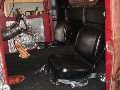

    Inside 3wLarry's old coupe:
    Malcolm
  5. Malcolm
