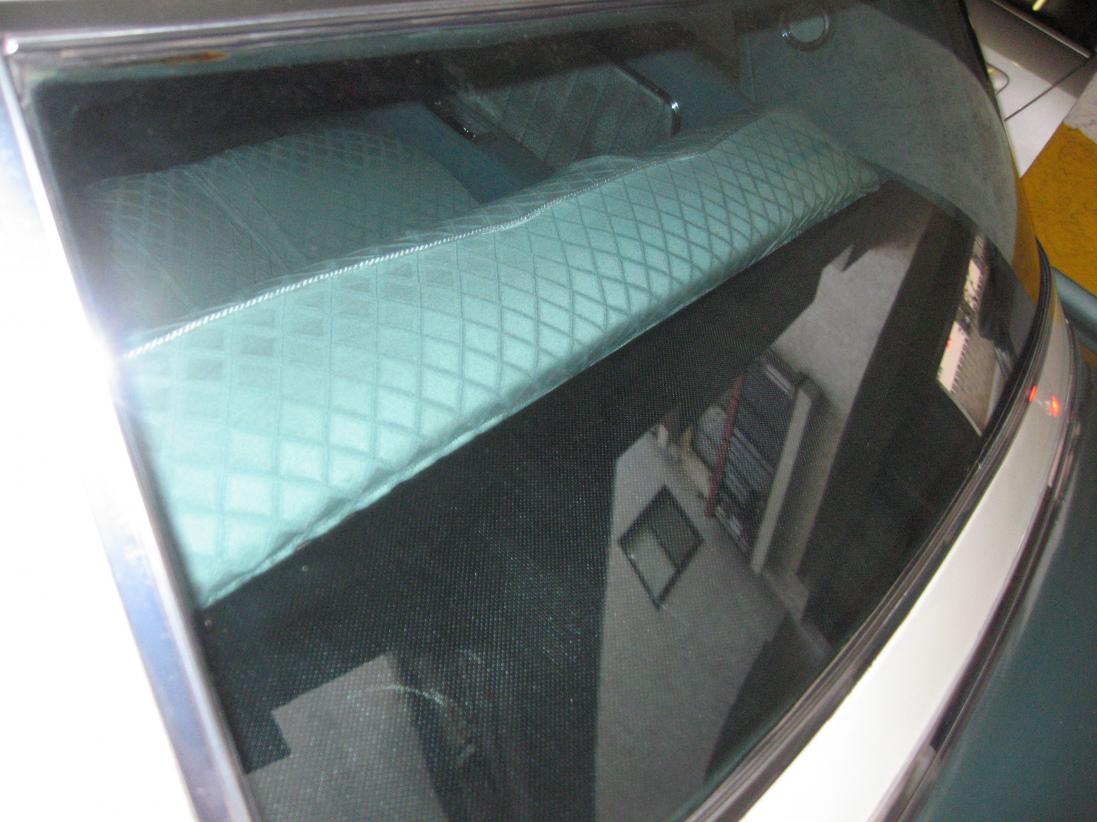

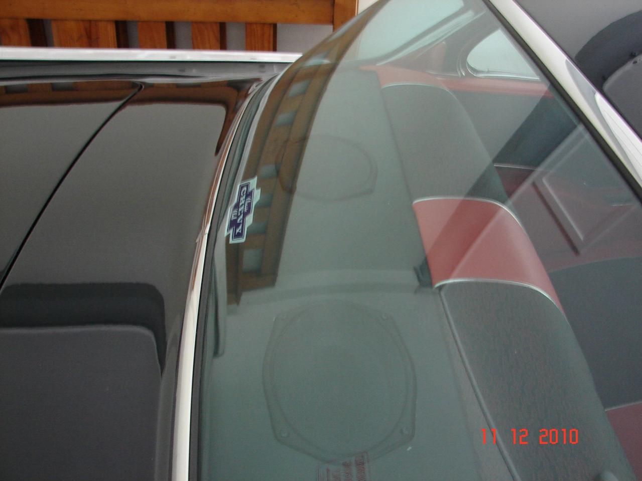

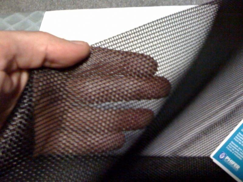

    Well I'll break it down for you as best as I can.
    Believe it or not, I used heavy duty window mesh to cover a piece of wood I cut to the same shape as the package tray. You can find the window mesh at Home Depot but make sure to get the heavy duty kind, it's very similar to what a speaker grill looks like. Double up on the layer to make sure nothing shows through. This isn't going to mute your sounds and looks pretty stock.
    Here's a few pics just to give you an idea.

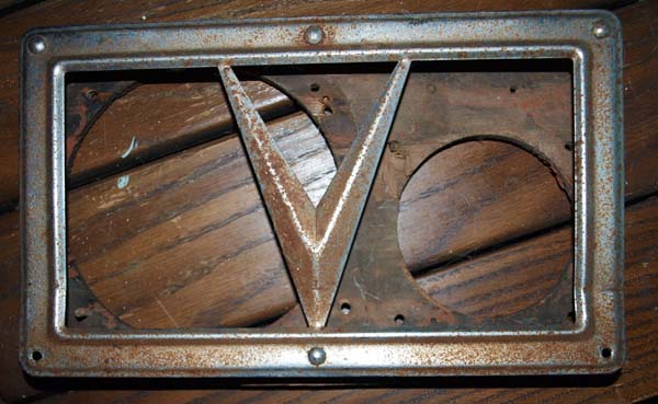

  16. You could take some stainless sheet and make something that resembles this.
    Its a genuine old school piece I found in a box of parts here at the house. Sorry I only got one.

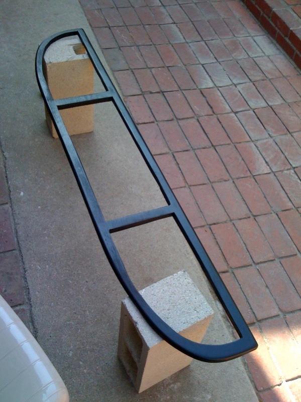

  19. I guess you could make them like mine out of aluminium but made from stainless I'm going to guess it wouldn't way more than an ounce. You could make a plywood spacer for it or back mount the speaker?
    There is plenty of .030 stainless in the garage when you comming up next?

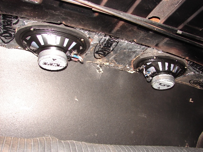

    I just used repo 57 Chevy rear speaker grills. $19 each. They look similar to the one Spity put up.
    Speakers are modern 6" x 9" with all the fancy pants tweerty stuff sticking up in the middle. They are 'under-slung' on customwood rings (don't know what it is called in The Stares, reconstituted timber stuff, basically sawdust and glue).
    The grill screws hold the customwood rings, and the speakers are screwed up from the bottom. Sound is awesome, but that's really just down to spending a little more on the speakers.
    I like how it has turned out, but it might not be what you are after.
