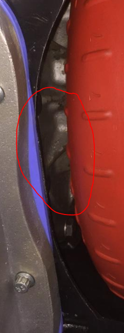

    The converter is NOT all the way in.
    If it were, you should not be able to get your finger in here:

    I’ll try to get the converter farther back but I took the converter with me when I picked up the transmission from the builders just so I could make sure it was in all the way into the transmission. After we slipped it in, he was agreeing that it was in all the way since we couldn’t get our hand in between the converter and the bell housing at the top. The converter was purchased from Summit and was not listed as being for a motor with a mid plate...

    This distance between the converter and the transmission housing is only about 3/4”. I messed around with it today and that’s as far back as it will go. It’s a hard stop and I believe that the converter is against the pump cover.
