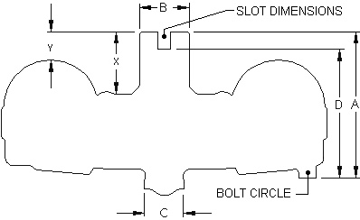

    It’s measurement A from the graphic.

    Flex plate mounting surface to end of hub, overall ‘height’.

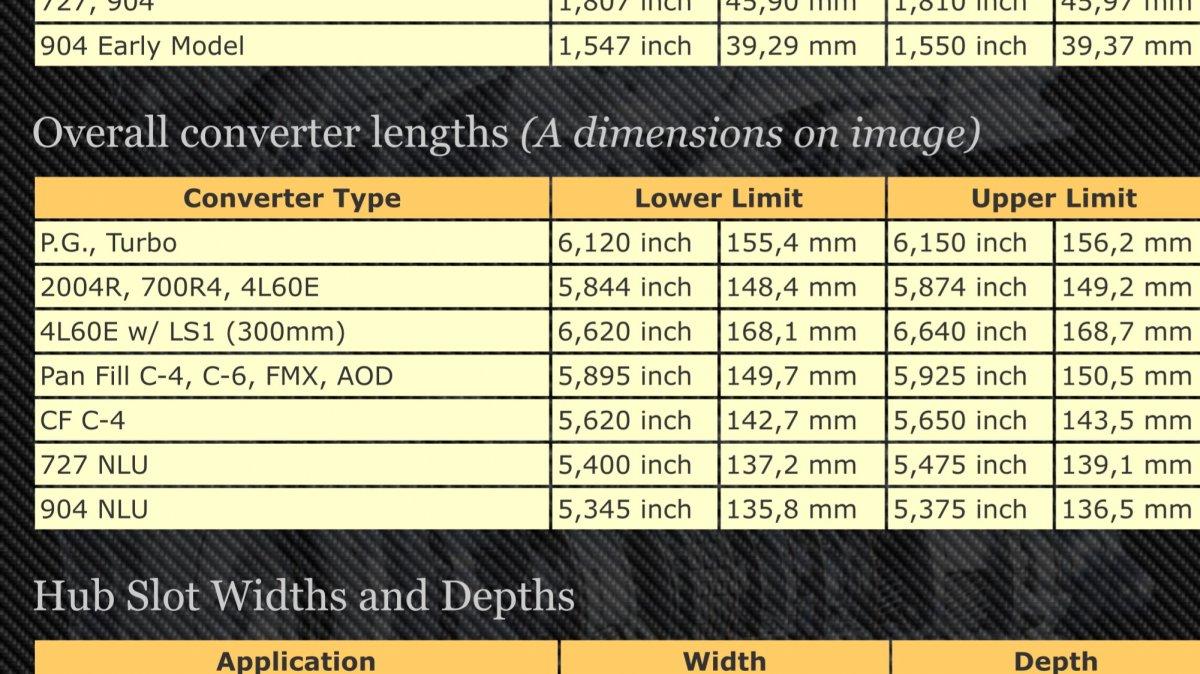

  6. Nov wonder it doesn't fit . It's 3/4 of and inch too long. Better check that again, at another machine shop.
    6.125 to 6.150 " . (period)

  9. Again, for the last time I don't know where you're getting those measurements but they are not correct. You don't have to believe me. I've only built about 500 race converters. Ask somebody that built a lot of them then.

    Take the machine shop word on measurement of 6.865 and mark’s word and website confirmation of 6.120 to 6.150

    The distances I quoted are distance “A”.

  14. And that also seems impossible without heavy mid plate. Seeing as dimension A is supposed to 6.120 to 6.150

  17. No, power glide and turbo 350 or th350 and turbo 400 or th400 are same same same. 6.120-6.150

  19. I gave you the link
    http://non-stoptransmission.com/en/info-converters.php
    Brought over the pic from the link
    I brought over the chart for dimension A
    I can’t read it for you but I can pull it out again.
    You’re going to have to look at the link too.
    P.G. , turbo ,,, Power glide and turbo 350 & turbo 400 dimension A is 6.120-6.150.
