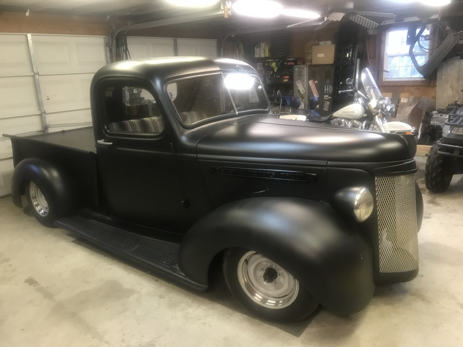

    F93A210D-3428-40F7-AF99-85BC7DA4574B.jpeg I like the John Deere Blitz Black, it’s been on the 39 for 15 years, cost me less than 50 bucks to paint it back then.

    I have painted one with the JD Blitz Black. It has been 12 years now and it looks just as it did the day it was painted. Very easy to touch up s****es, scratches or dings. It is offered in an aerosol that blends in unbelievably well if or when you need one of these touch ups.
