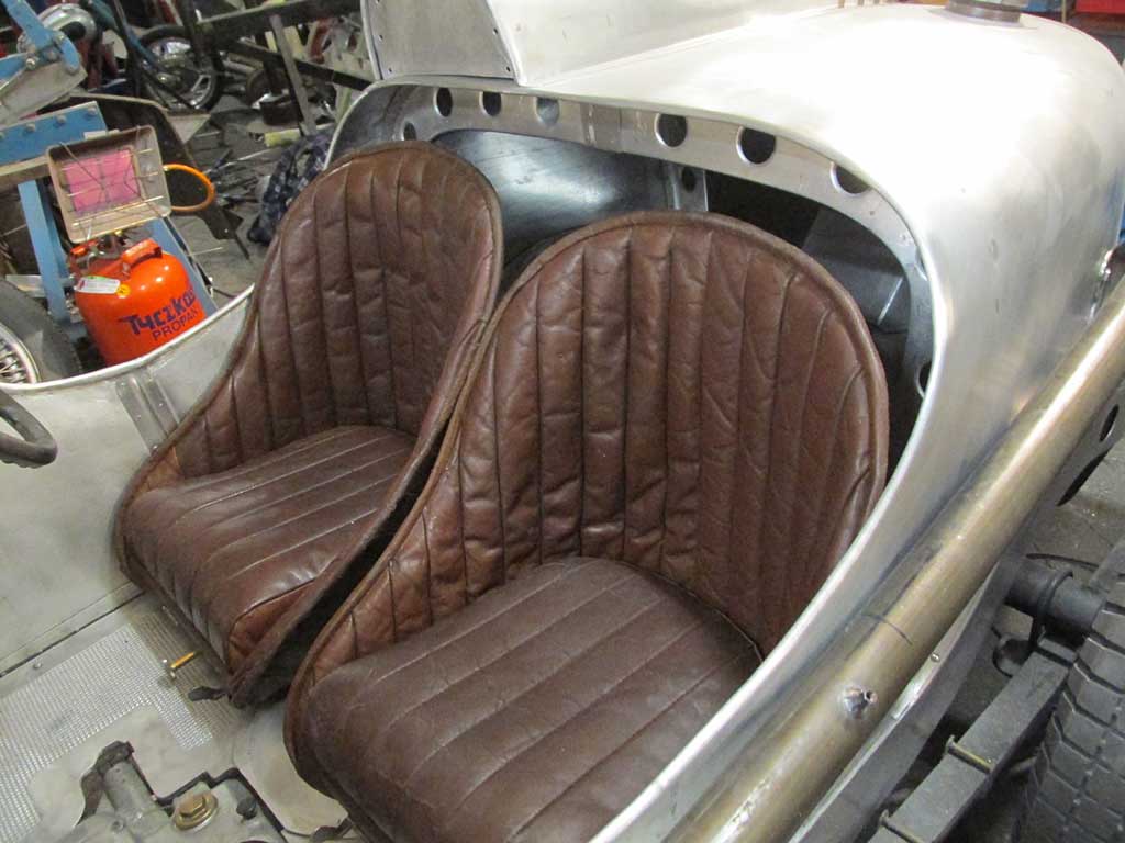

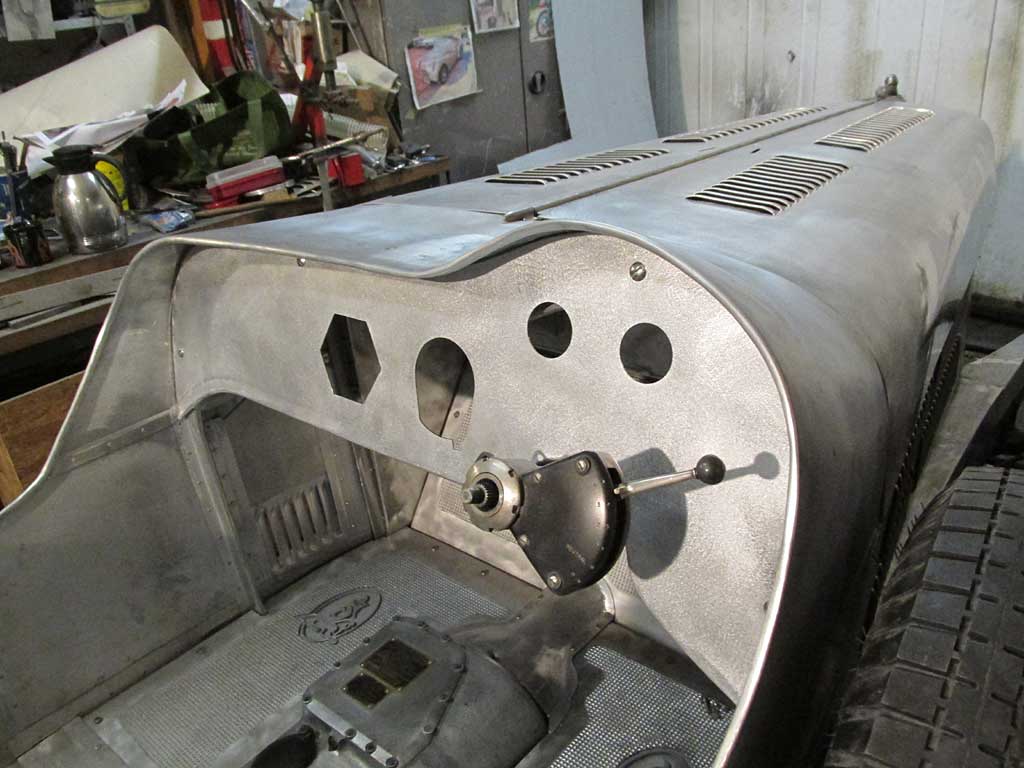

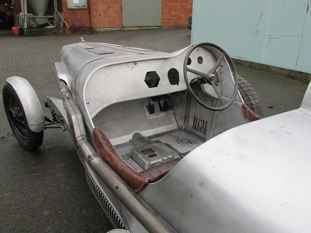

    Next one is an Armstrong Siddeley.
    British again - used to be a limousine but body was rotten.
    It's a 6 cylinder with a supercharger.
    It has a cast aluminum floor with the transmission exposed.
    aluminum bomber seats upholstered with the original leather of the former limousine.

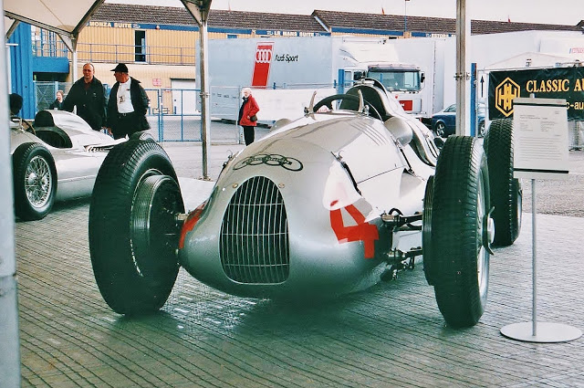

    1930s Auto Union GP cars did indeed use a torsion beam front virtually identical to a VW.

    ^ No surprise: both designed by Ferdinand Porsche.
