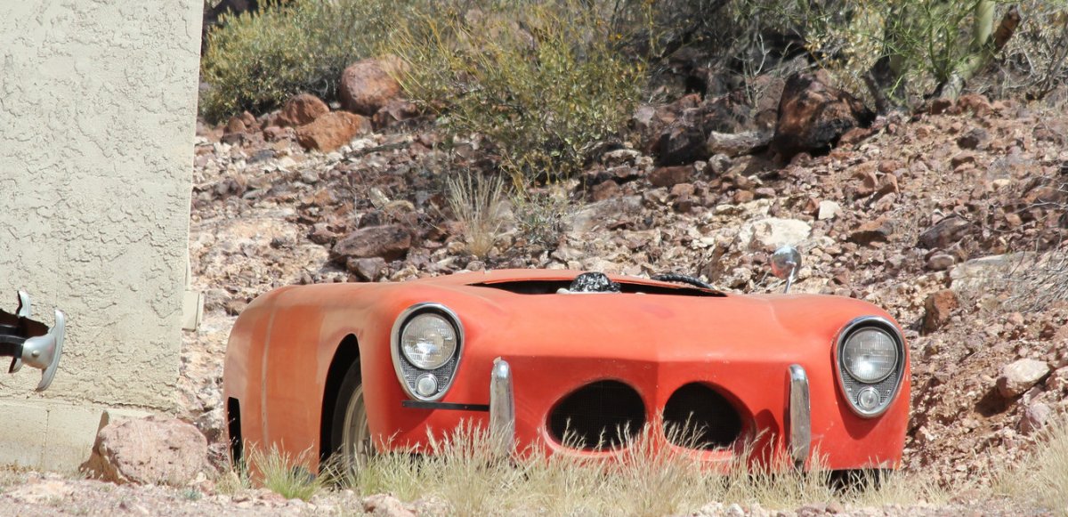

    Ok Joel, what's the little red cutey with the Buick looking headlights? Maybe a few more pictures?

    It is an Irwin Lancer. Powered by a 59A Flathead. It has a true Lincoln transmission (not just the gears) and a Columbia 2 speed. 148c6a7a-fdda-4bb0-8636-92678f1f2d3b.jpg 2.PNG 3.PNG

    Good eye, its a Manning clone/recreation I'm making from his blueprints. I'm trying to be as accurate to the original as possible, all the way down to the b17 anti ice tank and seats as well as the p38 rear view mirror.

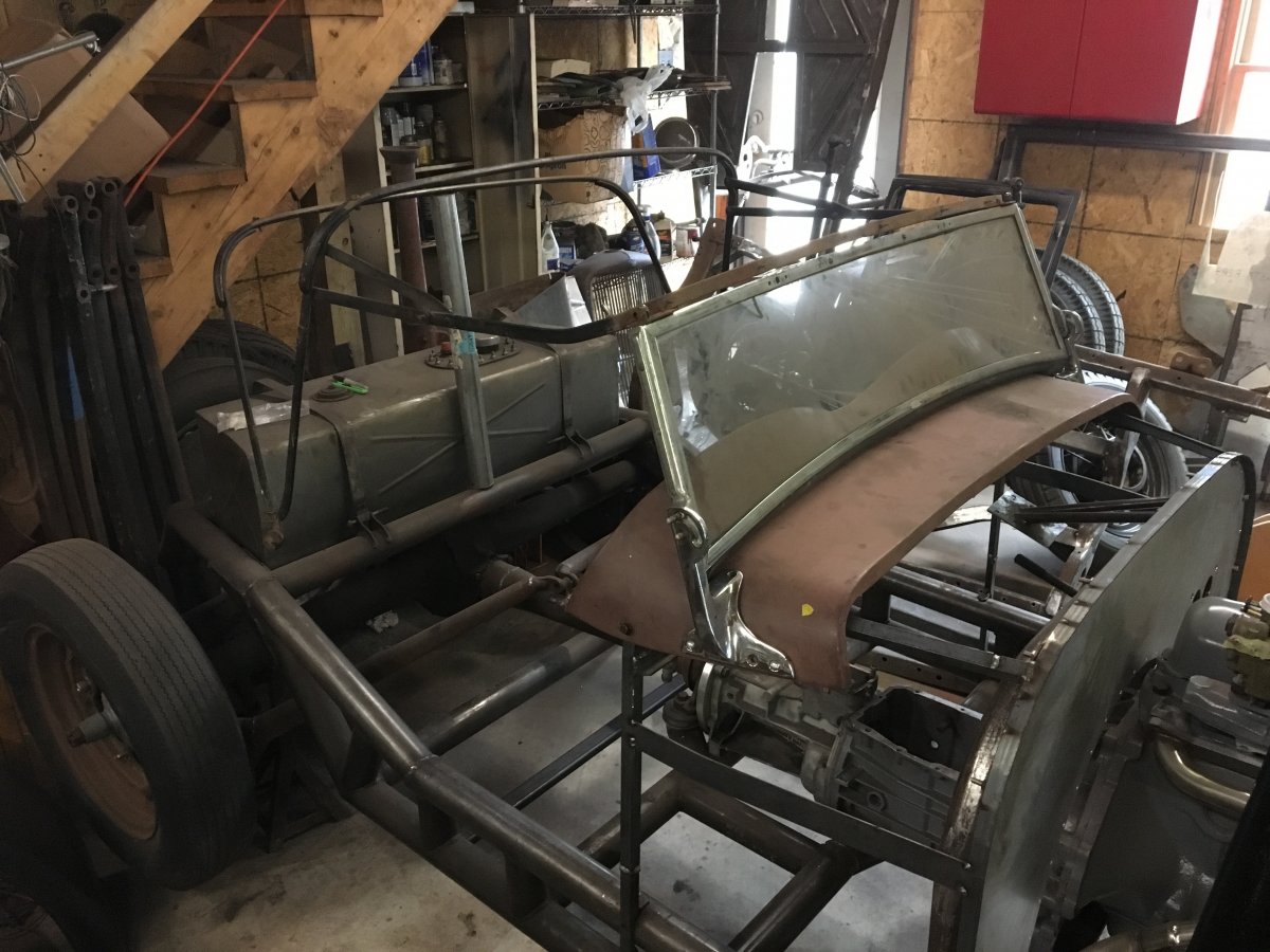

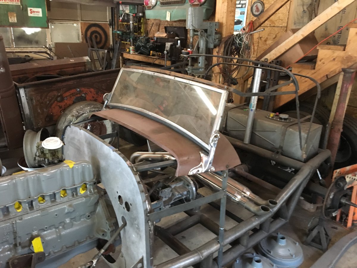

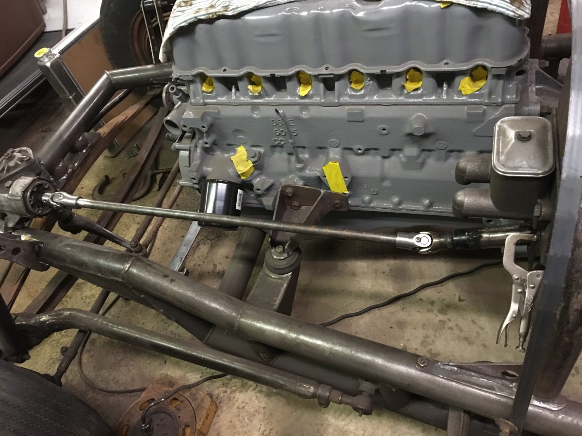

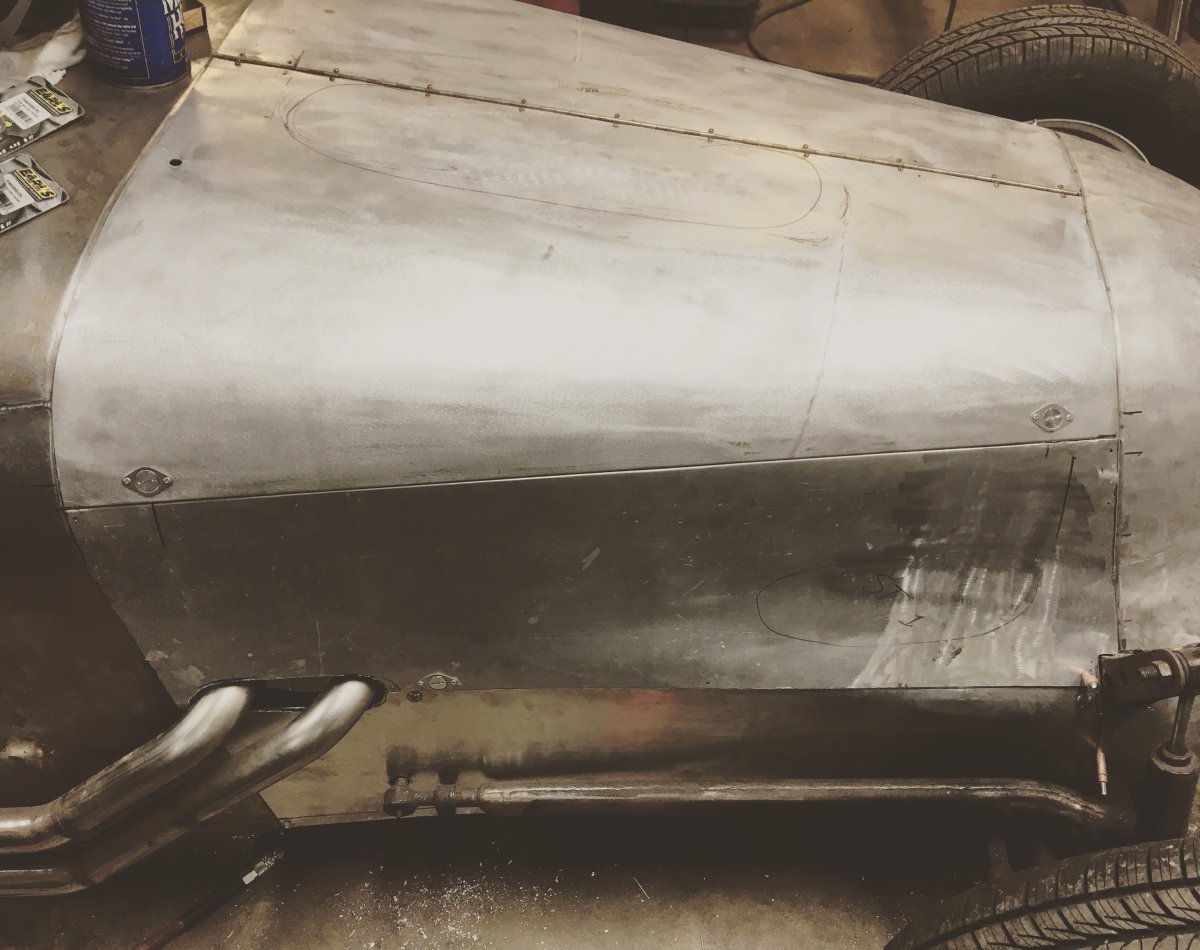

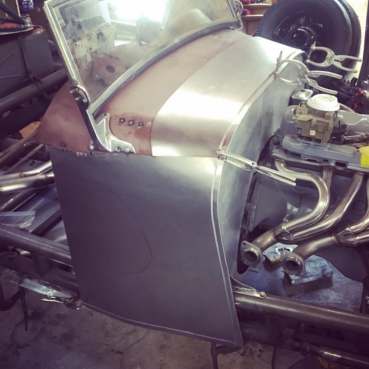

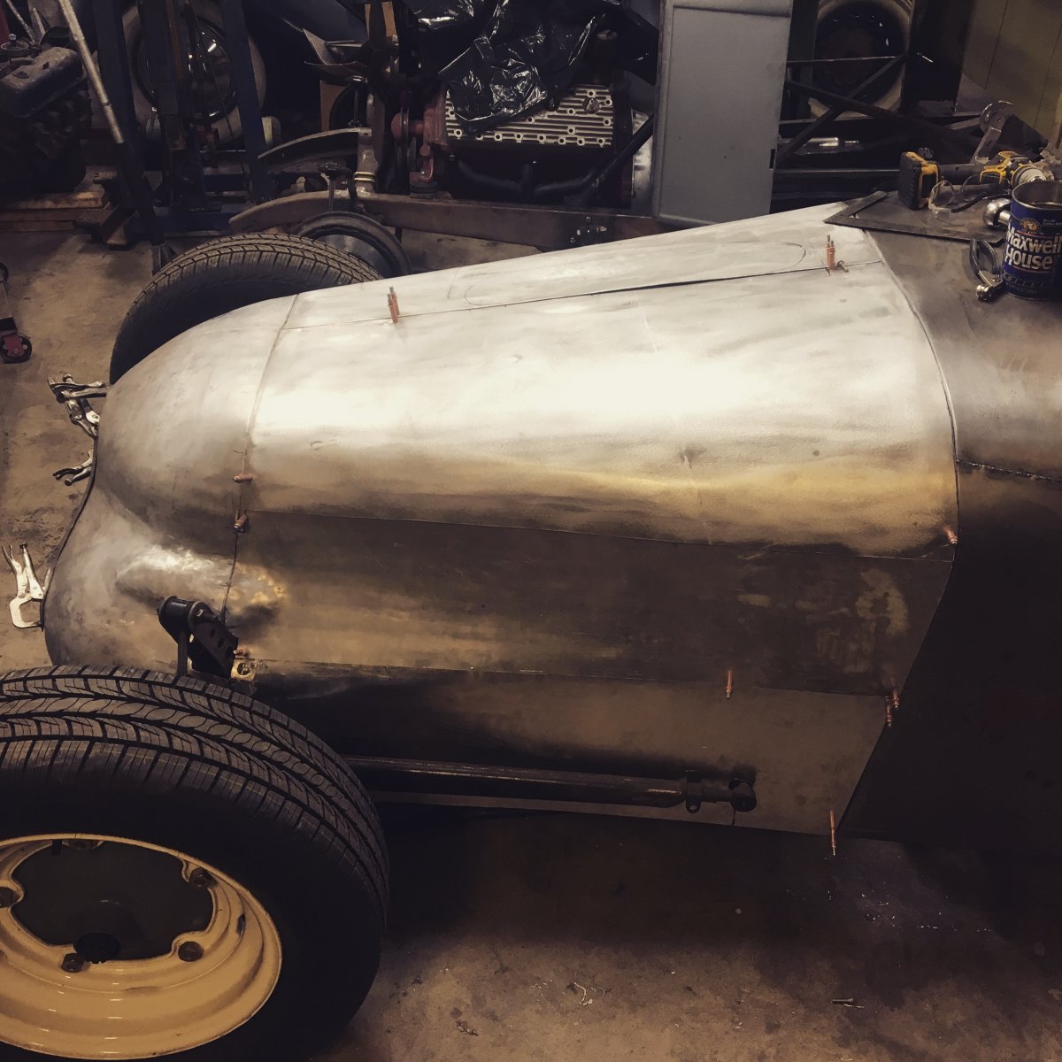

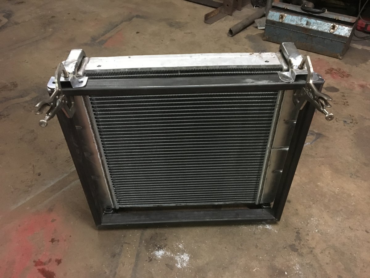

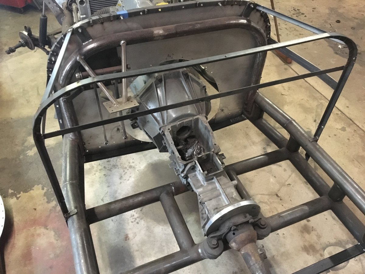

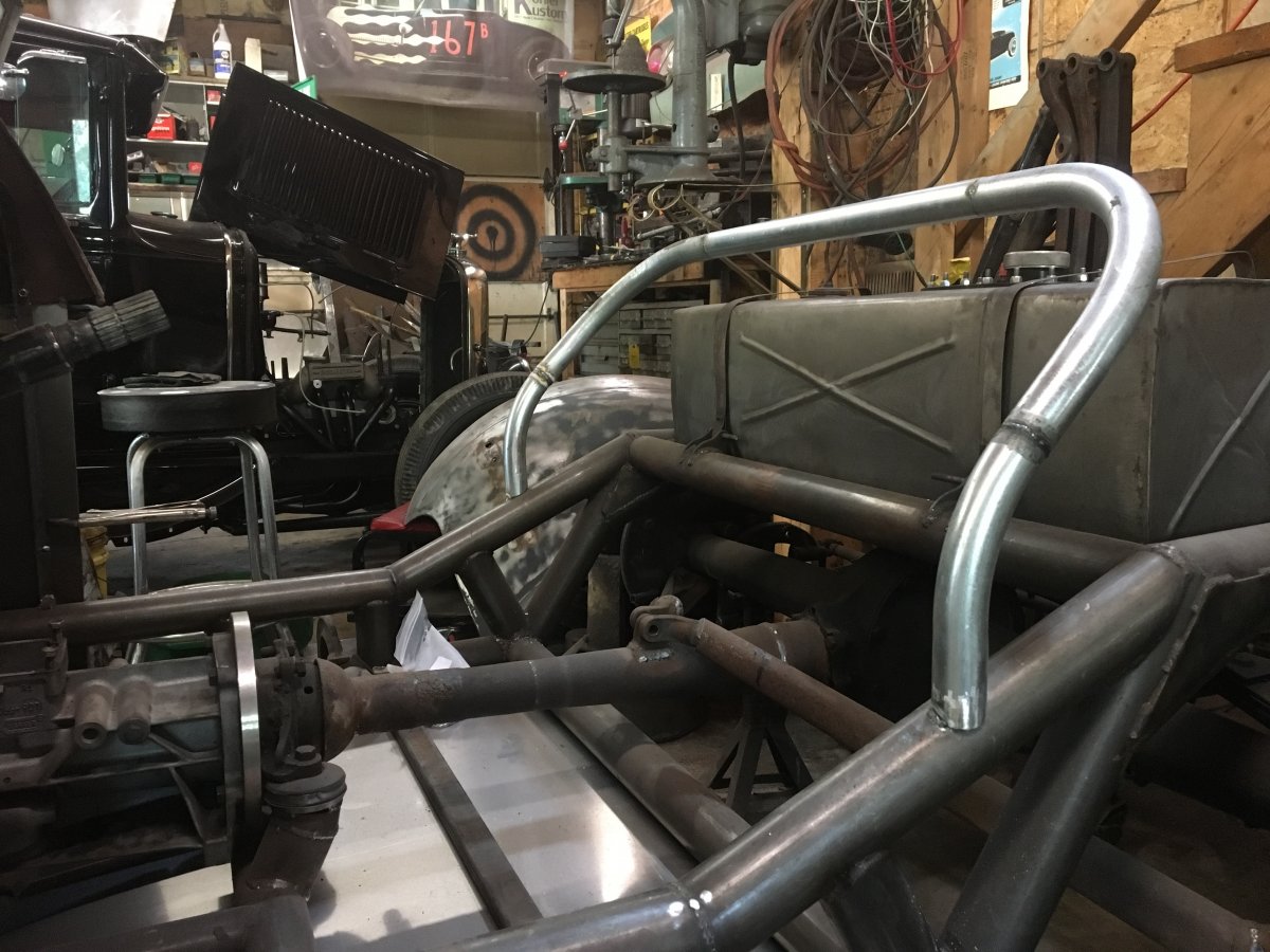

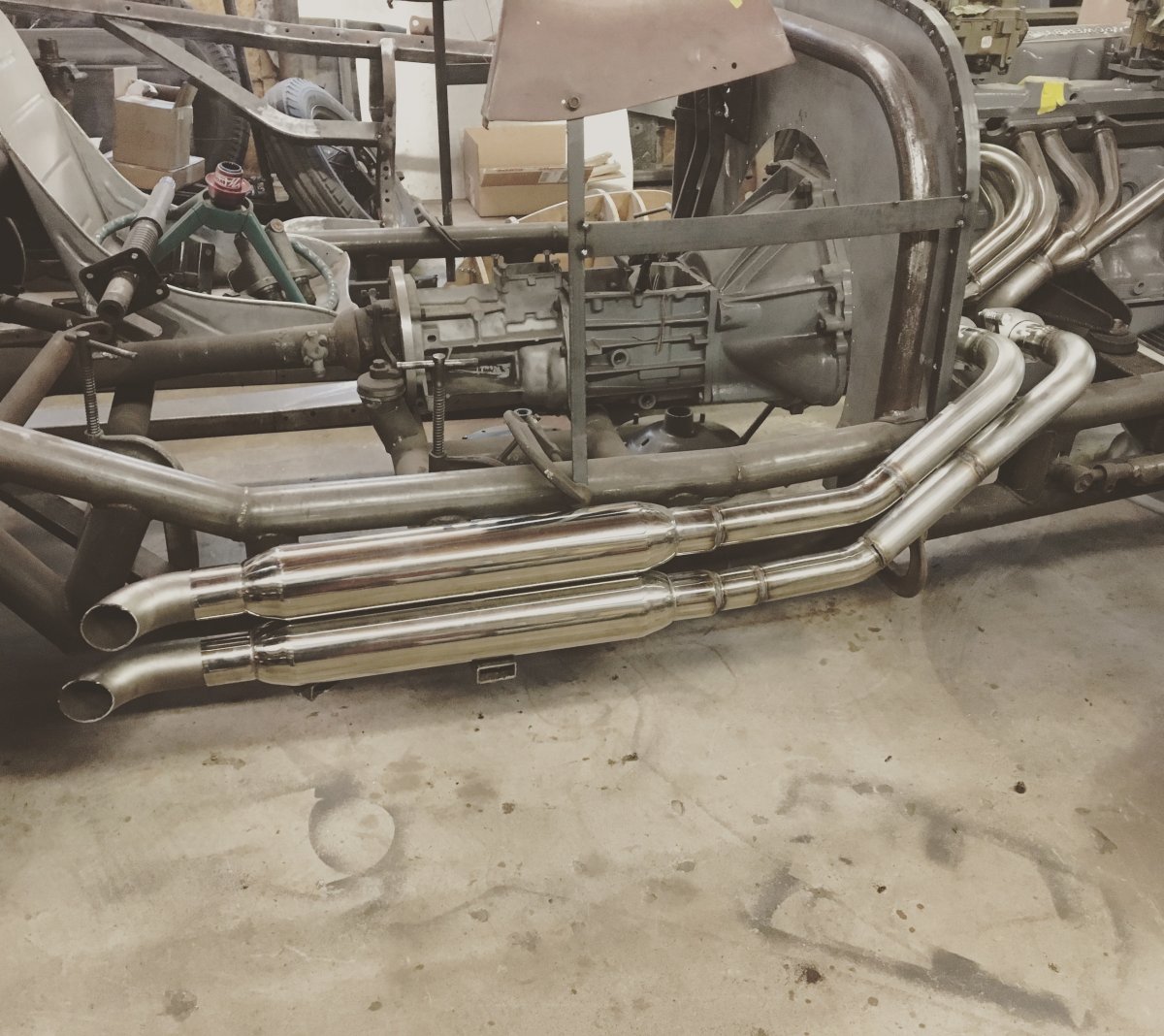

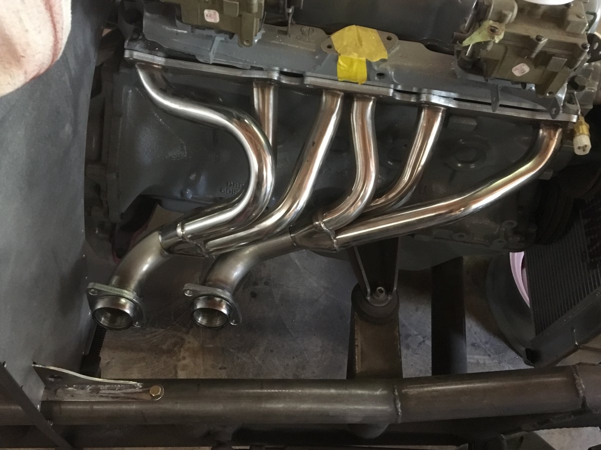

    More progress shots on the Manning inspired special.

    That looks really good. Is that an MG TD or TC cowl and windshield?

    Dude, your manning build is going to end up so much nicer than mine. This is why I was embarr***ed to post pics of mine. What type of steering box is that? I just noticed that the rear radius rods are on top of the torque tube, why? Did you guys go with a longer wheel base and is that why the spacing of the center cross tubes are further apart? If so that was a very smart move, I almost don't fit in mine.

    Thanks yes it is, the only factory sheet metal we will be using.

    Joel no way, yours looks fantastic, keep up the good work!
    It’s a 70s dodge van manual box, same as the 60s-70s p***enger car boxes but with a beefier sector shaft. The radius rods are on top to prevent them from interfering with the lower crossmember when the rear suspension drops and it also helps steer them out of the lower seating area. Yes the wheelbase is a few inches longer to facilitate a bit more ****pit area.

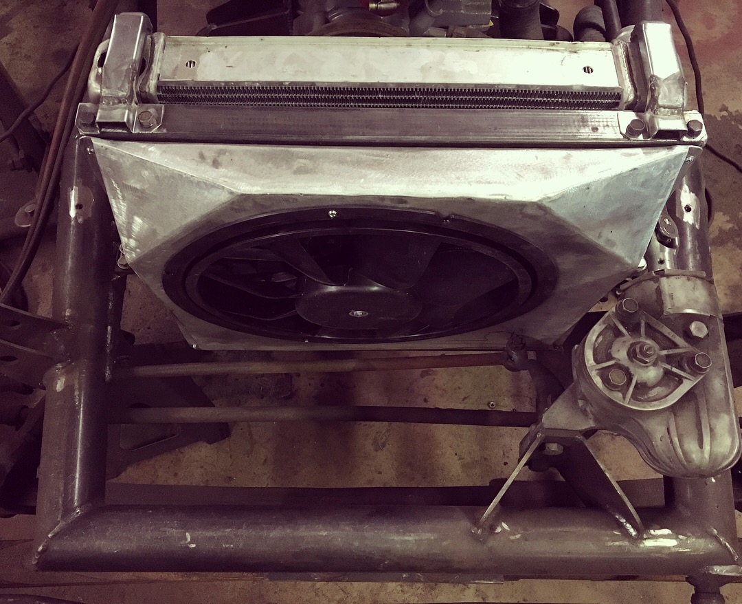

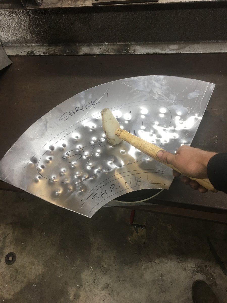

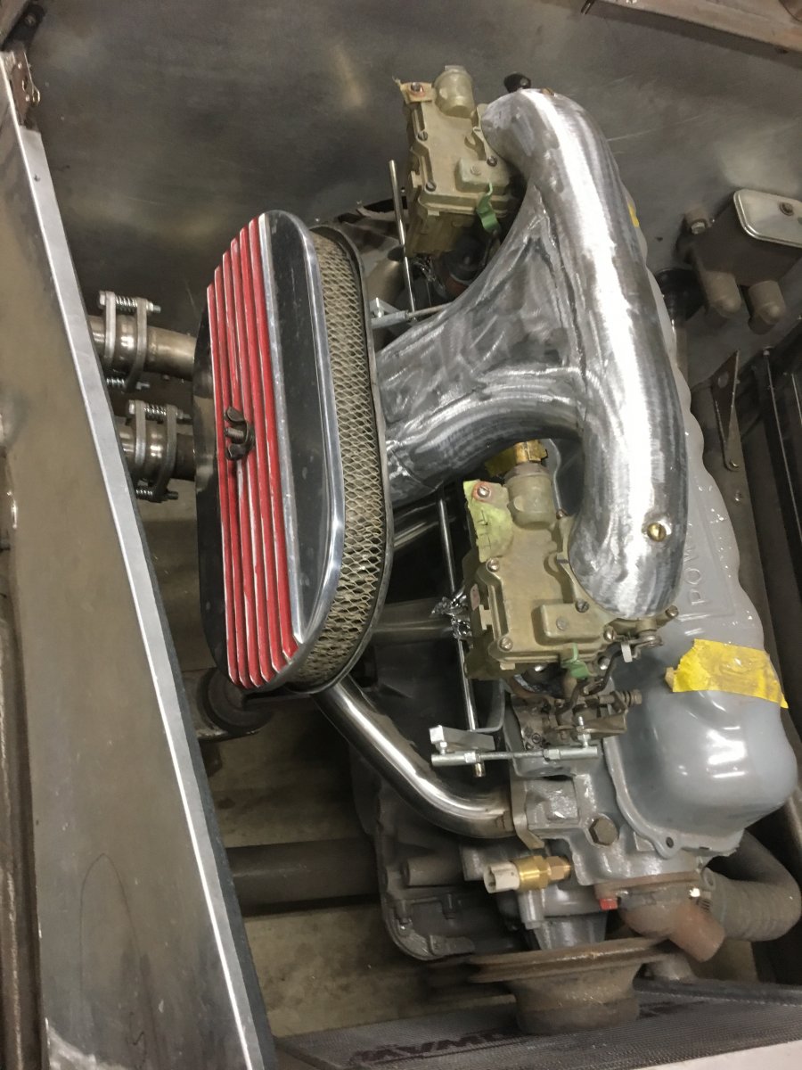

    Hood and filter box progress

    Very nice work on that air cleaner manifold!
