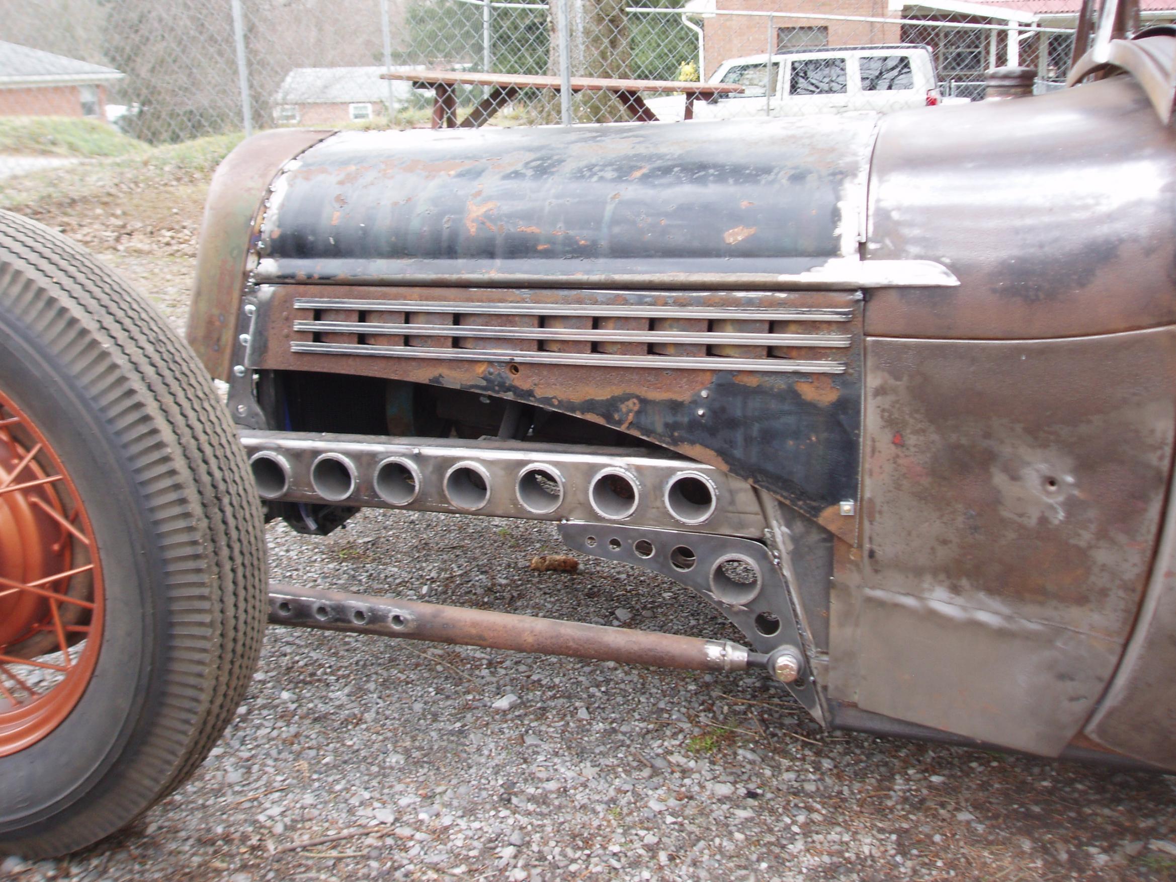

    doin speed holes on my model a coupe build, 2x4 frame tapered to 3 inch and made some frame horns.

    Thats pretty cool.How did you drill those?

    4 hours on the drill press. for each rail

    Dam,you have a 2" drill bit?how much was that?

    Rotabroach?CAn that be used on the drill press?Or mill only?

    Don't know about him, but I use Hole saws and cutting oil. Going slow I could use the same hole saw from Home Depot on the whole axle and bones and its still sharp when done.

    Lots of cutting holes with a drill press, ruining numerous 3" hole saws, lots of cutting oil, and many sections of tubing cut.
