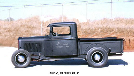

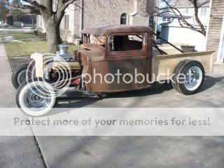

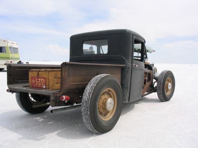

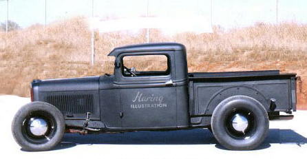

    i borrowed a picture off the hamb here and altered it (i like the 3rd one)to get an idea of where i want to head once i start building mine.i like em shorter in the front as well,but i also like the model A tray (with a filler panel at the front)as i'm going to run a quickchange and the A tray being shallower shows it off better.(last pic also borrowed).
    if you alter a few pictures and save them in sequence then you can view them one straight after the other and it gives you a real good idea on the difference.ie click on the below pictures,load them all and then click through them quick,the changes become more obvious(mainly the 2nd and 3rd pics)
