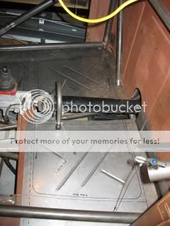

  27. Started fabricating the floors. Using 18ga sheet metal that will be bead rolled and have multiple steps in them. The original cab floor structure is still in the cab and in very good condition. These new pieces are basically just skins.
    I'm in the measure, cut, bead roll, trim, cuss, cuss some more, and repeat stage. :D
    Seems to be the most challenging piece of this project so far but fun non the less. I'll keep updating as I progress.

    Nice Brian, you've done well working around the difficult areas we looked at. Toe board looks good too. From this photo, perhaps a narrower drive shaft loop could give you some more width to work with. Tried to fit seats yet? Nice work, keep it up!
  29. The seat just clears the drive shaft loop. The black sharpie lines that run along the driveshaft indicate where the Sheet metal will have a 90* brake upward. I'll weld the driveshaft tunnel Sheet metal to that 90* lip. The driveshaft tunnel Sheet metal will land under the loop which will give me a couple more inches of room on each side. I'll take every inch I can find.
    I still need to put a 90* brake on the pans from the firewall back once I get her fitted right. Thanks for the compliments too.
